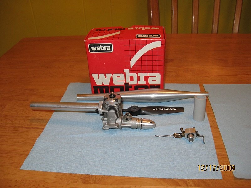

The Webra 2 ccm (.12) ABC RE Speedy (#1008) - a ducted fan engine:
I caught a glimpse of this little jewel on RCU a few months ago and immediately gravitated toward it. I contacted the seller but eventually the communication vanished into thin air. A few weeks ago, Isaw it again with some new pictures and Irealized it had to be the same beauty. This time around com didn't break down and it finally arrived at my door step today. I unwrapped all the goodies that came with it from the shoe box, and extracted the engine and carb from the box - both were extremely tight - oops! I immediately thought new bearings and cross your fingers on the carb. I went to work on it and slowly but surely after cleaning, lubricating and re-assembly she's as good as new. A couple of runs will eventually tell how well the front bearings are going to hold up.
The 0 degree header and 10" Macs straight tuned pipe are definitely designed for DF applications. If I could somehow retrofit the header to angle it at 10-15 degrees or find a suitable fuse top header, perhaps add a muffled pipe then we'd be ready for some serious planning. So, with that objective in mind, the simple question is:
What little pattern ship would you build for it? All suggestions and recommendations most welcome!
David.
