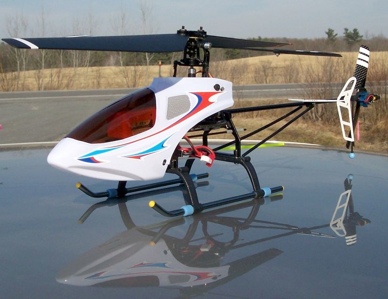

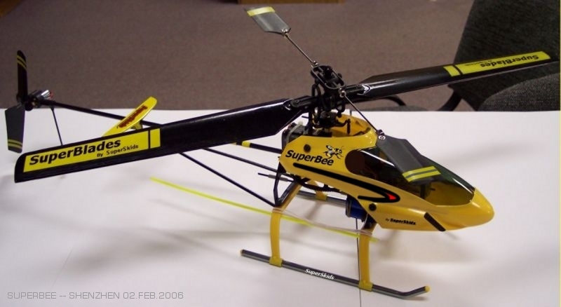

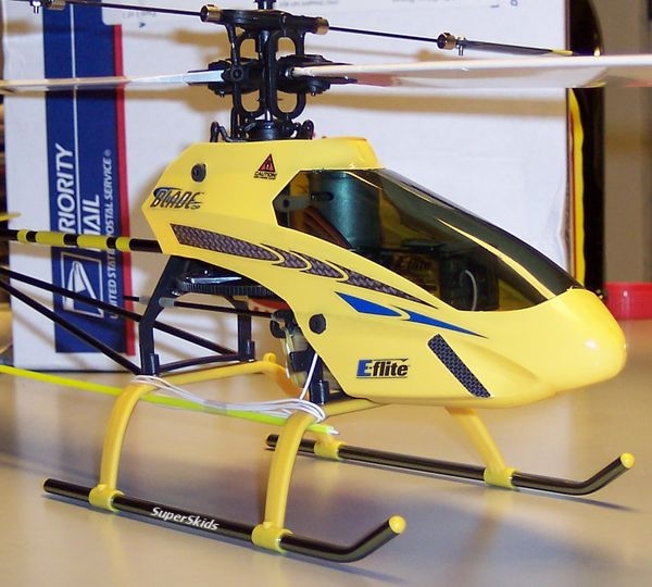

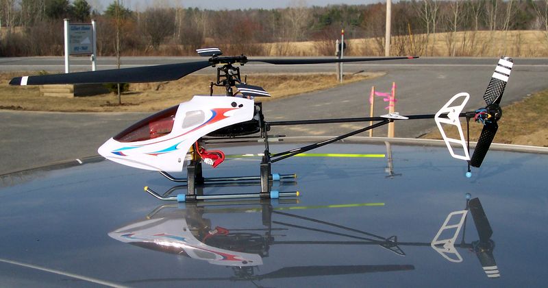

GTX SlotCar's Avatar
Joined: Oct 2005
Posts: 2,585
From: Gorham, ME
Default RE: E-FLIGHT BLADE CP
Here's some pictures of my DF4 and a couple other things we're working on.
