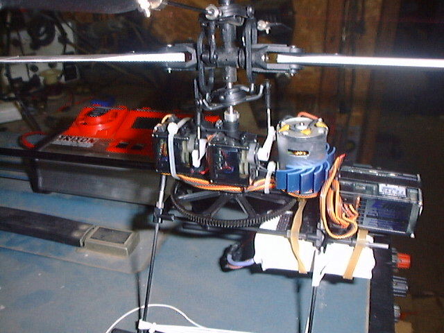

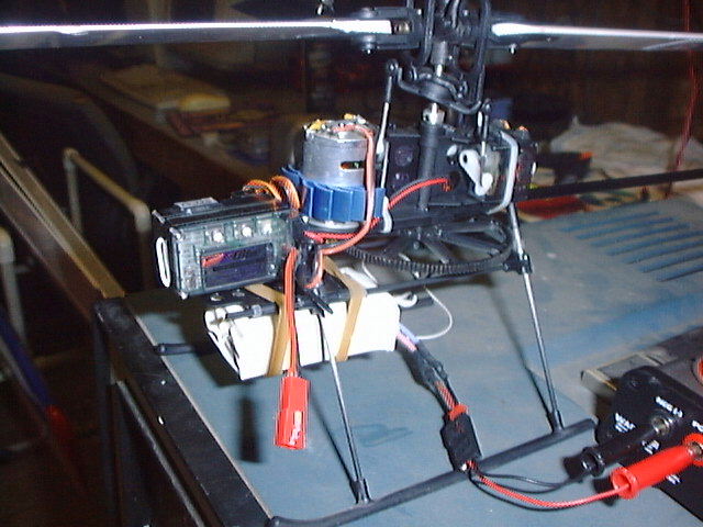

My suggestion to anyone that wants to go brushless don't. But if you really want a brushless blade then purchase the basic kit for 99.00 and start for there.
You see to go brushless means a whole set of new componets the 4in1 is for a brushed motor setup and simply will not work for a brush less setup.
I did some research on this and it you are looking at a pretty big investiment to do it...
Let me give you a little breakdown in the parts cost...
You will need a seperate heading gyro best price I found was around 50.00 for a little GWS one probably not the best one but it would work, a good one will run 100.00
You will need a 6 channel RX GWS has one for around 30.00
You will need a Brushless motor that will run in the 50-70 range.
You will need a Brushless speed controller that will run you about 60.00
You will need a brushed speed controller for the tail motor that will run you about 25.00
You will need a lipo battery that will run you about 50.00
You will need a 6 channel computer heli TX that will run you about 150.00
You will need 3 BB micro servos that will run you about 60.00
So you are looking at about 575.00 and thats on the low end, not including things like lipo charger etc. And all that said you could even spend a lot more then that on high end stuff.
Yea it's funny how a quick it adds up, the one postive is if you went this route you could upgrade to say a T-Rex and reuse a lot of the componets. Myself the blade flys great with a brushed setup and at 10.00 a pop for a motor who cares if you have to replace one and from what I have been reading there are guys with hundreds of flights still using the same orginal brushed motor.
The only thing I wish is that someone would come out with a carbon fiber flat blade for it, because for me I like how stable and easy it is to fly with the flat blades but I would like a little better grade blade then the balsa one that comes with it.
Hope this helps

your right that all makes sence now, what other brushed motors are avalible for this little heli and what batteries do you reconmend to up my flight time
cheers
cheers
#1016
Well depends on what you want to do... For just hovering and simple forward flight with the flat blades, I would suggest going to a 1000-1200 3s1p lipo pack and 8t 370 motor, which the motor eflite sells for 10.00 that's what I am running and I am getting 25 minute flight times. The heli is nice stable with this setup, I think that head speed with the flat blades seems to really make a sweet spot for hovering...
Now for more aerobatic flight I would suggest the 9t 370 motor and the same lipo with a the semi-blades... I really dont care for the semi blades so far, just seems to make the heli less stable for a hover as I am basicaly a newbee to micro-heli's I have about 6 months experance on these micros and a lot less on then that on the blade.
But that said I have tried all these setups on my blade stock battery with flat blades, enhancement kit with the 9t motor lipo's and semi blades, 9t motor and flat blades, 8t motor and semi blades and the one I am running now which is a 8t motor, flat blades and lipo's which to me is the best for me right now. I get great flight times and she really stable of course I also have the gain turned up on the gyro as well. I think it's all in you skill level and what you want to do with the heli. Myself I just enjoy slow flight and long hovers for right now.

Well the more I think about going brushless now the uglier it looks. I'm just going to get the aluminum frame, a new 2-in-1 and a second tail motor and call it a day.
A guy with no heli experience walked into the hobby shop I worked with, he brought in a T-Rex he bought new off of Helihobby, they assembled the whole thing for him and he also bought a Hitec Eclipse 7, and he wanted some help on final setup. The first thing I thought was "whoa...this guy has NO IDEA what he's getting in to". It cost him about $1000. Anyways this was my first opportunity to really look at a T-rex. Granted, it was not the CCPM version I am looking to buy (a shame too he shoulda gotten that version considering all the high-cost components on it), but I must say it is quite an impressive little machine. It looks much simpler than I had originally thought (although looks can be deceiving...) but it was an interesting experience. And that Hitec Eclipse 7 was a whole different world. I looked at the thing and saw more switches, buttons and levers than any Frankenstein movie....
Anyways to get to the point, after getting his receiver mounted and his crystal in place and trying to see how to set the Spectra module to channel 57 (no luck, the manual didn't even mention it in the contents) I told him to check out a dedicated heli dealer an hour or so away and that was that.
And then I thought about how complex it would be to make a Blade brushless. It's not worth it. I'm going to save my money and get a T-Rex and get the most out of brushless power.

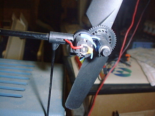

i know some people were talking about shaving the tail rotor to make it smaller. well i tried using a tail rotor from a helimax rotofly, and this seems to work well. it's not too much smaller but small enough to make a difference. and until the new CF tail comes out this is what i will be using. have made 4 flights with this tail rotor and it seems to stick well, even during FFF with no tail stabilizers. with the stabilizers i would like to assume that this would be a stable setup. And yes a brushless setup is kind of silly on this heli, why not move up in size if you are going this route. if you are ready for that type of performance then you are ready for a bigger heli. but i will be buying the new upgrades as soon as they come out. our store already has them on order, so the day they come out they will be on my heli.
This question is for Jason. On the aluminum swashplate, are the ball links shortened any to increase sensitivity, or is it just the same as the stock but just upgraded to aluminum?
