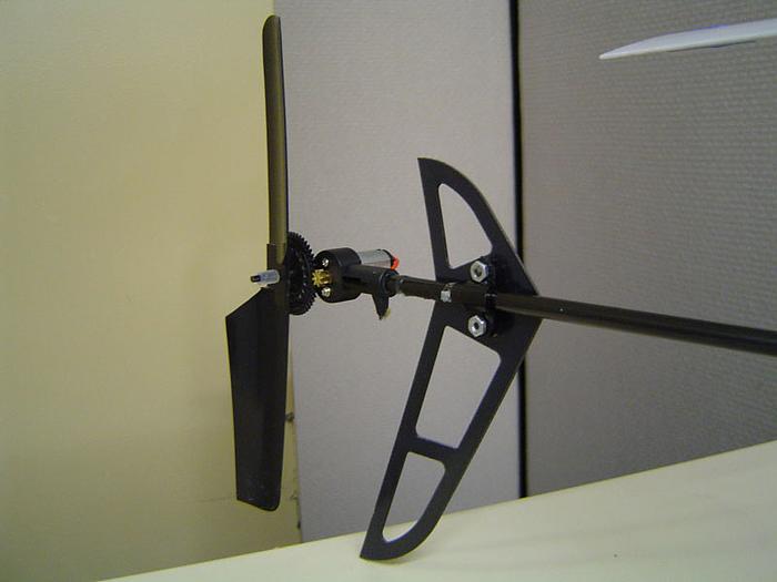

Broken tail support rod.
Any one got an idea of a tail support ?????? zooland, doug,
All and any ideas and help are appreciated.
Bob
dignlivn
Old 06-11-2006 | 08:38 AM
  #3514
djdavidcp's Avatar
Joined: Dec 2005
Posts: 264
From: Naperville, IL
Default RE: E-FLIGHT BLADE CP
ORIGINAL: dignlivn
Bob
dignlivn
Bob,
I broke mine twice right off the bat and got sick of it. It is a poor design. I replaced it with the following tail fin from helidirect.com:
http://www.helidirect.com/product_in...roducts_id=751
I mounted it to the tail with a Dubro 3/16" landing gear strap:
http://www2.towerhobbies.com/cgi-bin...?&I=LXVJ28&P=0
Here are a couple pics of the tail fin on my Blade. I never had anymore tail hit problems after putting this fin on. A great fix, and looks great too.
Doug

If you've broken any landing gear, use a leg off them. Cut it off with a Dremel cutoff wheel, drill out the old tail support (a Dremel and a small bit work very well) and glue the new one in with CA.
Chris

Thanks Doug, thats a great idea.Ive replaced everything except the 4 in 1 , servo's and canopy
on this thing.I agree it's a bad design.(tail support). Thanks again. BTW i saved your video
and watch it often.
Chris
I tried drilling it out but know luck. Got my finger pretty good though. i do
have parts from old landing gear. I think i'll try a piece of that an some
fuel tubing to hold me over till i get Dougs parts. my battery is charging
and I would like to get some stick time in. Subject to the wind of course.
Thanks again guys
Bob

dignlivn--I tried cmassa's method twice and figured it wasn't worth it. Too easy to break again. I use the same one Doug (djdavid) has.

I tried that exact tail fin but I found it too flexible. It would bend out of the way and my tail rotor would strike the ground or the tail fin itself. I guess it didn't work as well for me as it does for Doug.
If you put a bead on the end of the rod, it won't dig into the ground or flooring, and may never break. With the current version of superskids, we use the fin to support the tail rod strut as shown in the attached picture. It really helps to strengthen it. In the next superskids revision (due out in about 6 weeks), the tail fin will be clipped to the rod and the bead will be included.
If you think you can drill out the old rod and put in a new one, I think I have an extra fin and bead I can send you, free.

Zooland and gtx slotcar
thanks guys for your help.
I have an extra motor mount and support rod. i am to lazy to un solder and re solder
the tm wires to replace it with the same POS set up. I took an old piece of landing skid
with the groove on the bottom and slid a piece of rod into it. At the other end i took a
piece of fuel line and ca'd it to the stub that was left where it originaly broke. It may only
last a little while. the wind here usally dies down later in the afternoon. in some was I
thinking, Do I really need it? My tail boom is loose where it inserts into the main frame.
I lke it that way because it does give on rough landings. just have to be sure it is square
before each flight.
slotcar I like the idea of a bead, Ive been using a piece of foam from a beer coozie on the bottom end.
Thanks again
Bob
dignlivn

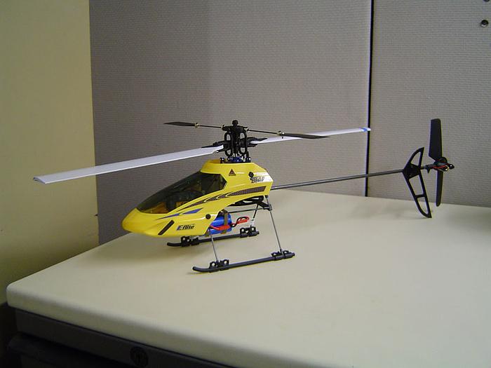

I have a Nexus 30, and I just love it !!! I have had no trouble finding anything for it so far, and today it's cherry... I don't know the difference between the Concept 30 and the Nexus 30, but I have heard that alot of the parts are interchangable. Whoever told you that the Kyosho Concept 30 was cheap, obviously don't know what he's talking about. All Kyosho stuff is top quality, and my Nexus is built beautifully. There is no comparision between the Nitro and the Micro. My Nexus is 100 times easier to fly than the Blade CP, and the tail control is amazing with the Nexus by comparrision. I wish I never wasted my money on a Micro Heli with a tail motor...
