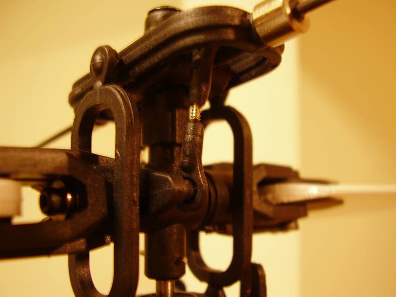

The blade grips have a linkage that is connected to it from the flybar part. Pop that off and when you shorten the linkage it lowers the pitch angle. The longer you extend it, the greater the pitch angle. I would have to provide a photo later, right now I'm at my fiance's house. She lives pretty far from my house. I'll post a photo tomorrow morning. But this method of shortening and lengthening the linkage attached to the blade grips also are used to adjust the blade tracking. While observing the rotors rotating and one blade seems to be lifting higher than the other, you can make adjustments to one blade angle to achive a proper blade tracking. It's also stated in the manual I think on how to adjust the blade tracking.

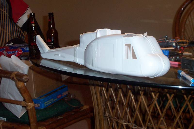

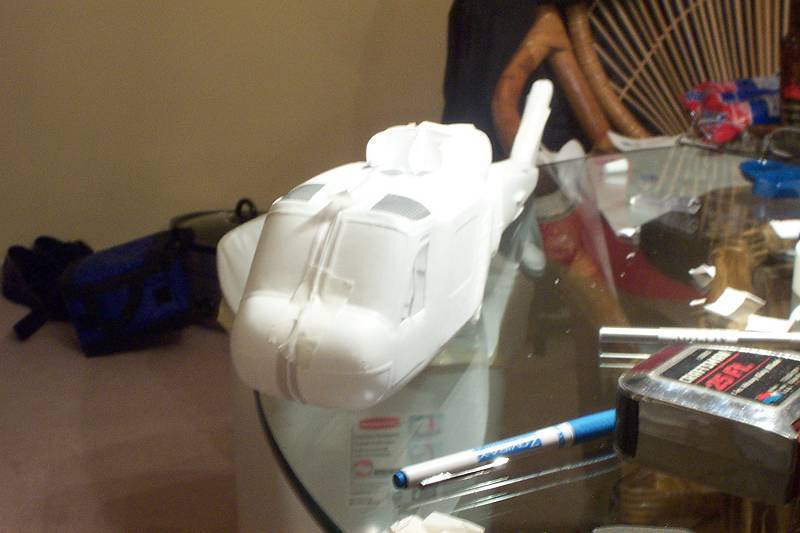

Thanks Cruz! I just got home from my shift at the firehouse and will try it. I should also be recieving my Huey scale body today! I'll let you know if it works

WOW that Huey looks really nice. Are you going to retrofit it to the blade CP or onto another heli?

Thanks for the input. As it turns out, evidently the main rotor blade holders were sticking, because I took everything apart, lubricated with graphite, and reassembled it and now it is very stable again. With that done, I replaced both the main rotor, the swash plate and the rotor blades. She looks as good as new and flies extremely well again. I was beginning to lose hope.
Now that the rotors are new (aerodynamically clean with no dings) and balanced, it is very stable. I don't think I'll be taking it outside because I can learn everything I need for basic flying while in the safe confines of four walls and a roof ;-)

The paddles are not quite perfectly aligned. After a dump a couple of days ago there's a very slight bend to one end of the flybar. As for the paddles themselves, it seems they should be level with the rotor hub, is that right?
I've held off replacing the flybar because I haven't looked into how the paddles should be oriented when reinstalled(level with each other, or pitched slightly to give a bit of lift).

well make sure they're aligned if it's only 1mm off that won't make much of a difference but any more and the shaking will grow quite a bit. also make sure the paddles both have the same amount of pitch prefferably 0-2 degrees.

Good point, I didn't think about the paddles at all... slipped my mind. Yes, they too have to be level. also I had to disassemble mine because I had my first real major crash with it. I took it outside and piled it into the asphalt. (Trying to fly in 15mph wind does not work well with this little thing). The only damage was a cracked canopy and a bent main rotor shaft which I fixed today. Make sure the lenght of both flybars are the same as well. wouldn't want one to be longer than the other.

I am going to retro it to the Blade. I have made all the cuts and am going to paint it on Sunday at the firehouse. Here are a couple pics of it taped together to gets the measurements for the cuts on top for the servos linkages. I put some window screen on the top two windows to allow some air to cool the motors. Hope it works

Thanks for the advice all. I've repaired the flybar and will adjust the paddles for a slight pitch up. Still just as unmanageable, but I'll keep fighting with it maybe something will click and I will get the hang of it someday. That's or I'll finally dump it so bad it's unrecoverable.
