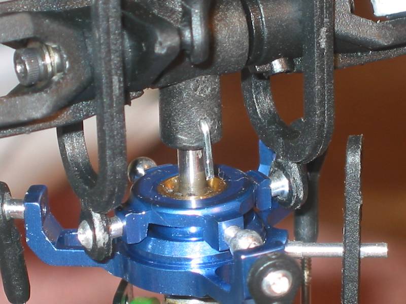

One other trick you can do is put a paper clip in the head instead of the sheer pin. The paperclip sheers much easier, and can prevent head damage, or bent main shafts. I forget who came up with it, but I included the picture they took just for reference. Way to go to whoever came up with it =)
