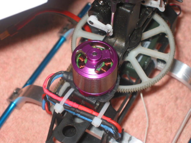

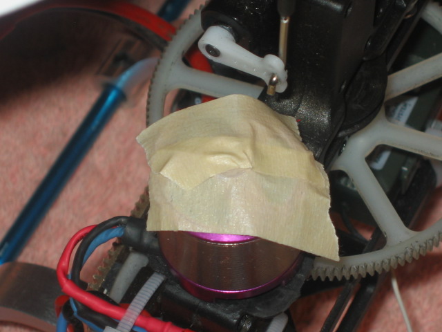

Yeah....would like pics very much.
Been having main drive gear and pinion problems....think I got that whipped. Running 10T and I HATE it...needs to be 11T. Another problem (Arrow can relate to this). The DX6 TX battery leaves a little to be desired (LMAO). After about 3-5 flights...shes down. I found 8 Ni-Cd brand new with a Tamya connector on it but wrong configuration. I just spent the better part of 3 hours building another TX battery for the DX6. Happy to say....."works good, I hope it lasts a long time". I have no idea the mAh of these batteries, but they powered an R/C tank I no longer have, and they NEVER saw a lot of use. HOPEFULLY...they will last longer than the stock TX batteries. I now have both sets on chargers. Each battery has a male futaba plug, the TX has a female Futaba plug for compatability and I can change TX batteries in seconds. I even did it tonight...leave the TX running and forget about it until the alarm goes off (I do that a lot for some reason). NOW...I have a backup TX battery. If I fly all 4 of my packs through the heli.... the TX battery is done for a couple hours. Hopefully...this will solve the TX battery problem to a degree. Having the EP Glider and two heli's on one radio can be taxing on the TX battery.

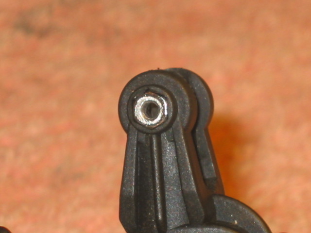

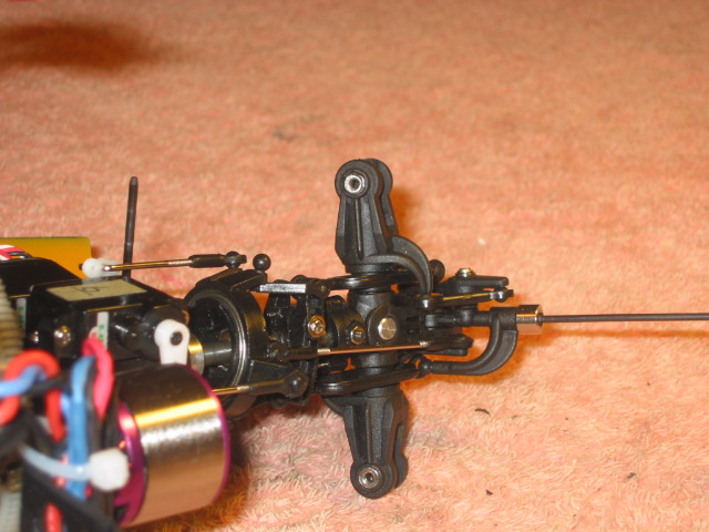

TIP of the DAY:
Haven't done this in along time, you guys are getting to smart for me. That's what this thread is for, to inform everyone of there experiences and pass them on.
Anyway, you know those tiny little nuts that are on the bottom of the blade grips, for installing blades. And what a pain they can be, getting them in there and falling out before you can get the screw in.
Well, my cure for that is to CA them ba$tards in there. Just a drop in the grip and put the nut in. Let it cure overnight.
Pics don't show me putting the CA in the grip, but all you smart guys know what I mean.

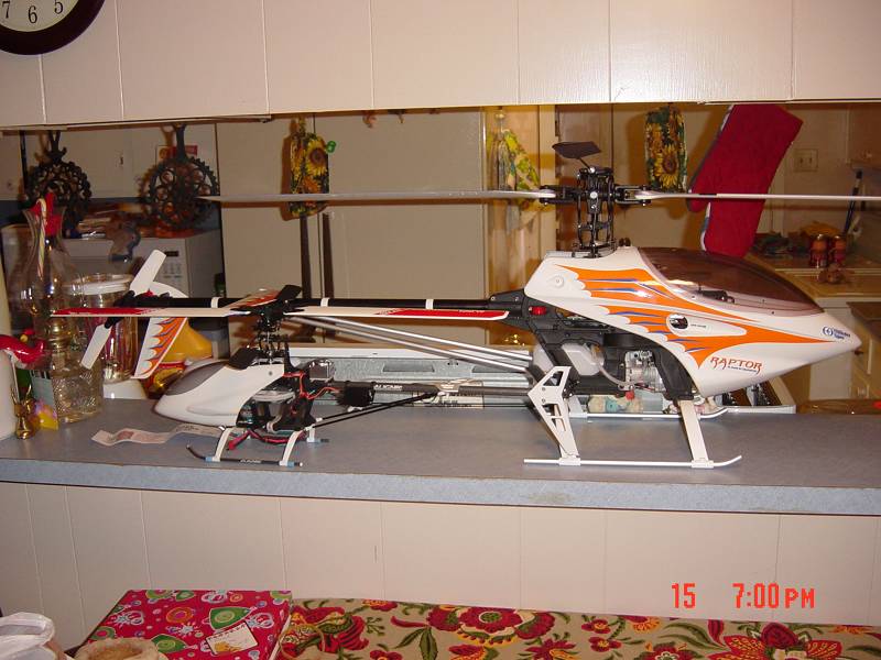

January 15th Exciting day ! my TWO training machines have now been put together
and serious HELI training will begin, given time, weather, Guru availability and all the
other variables the regulate my busy life.
Here is a picture of the Raptor and the TREX that just arrived from Cali, from the tender
mercies of LOOKYJ.
I have hopped the RAPTOR for a couple of minutes. I find that it's Do-Able, albeit QUITE
different from the small electrics. Have no idea yet what the TREX is about, but will begin
to transfer the PROGRAMMING received from Jeremy.
What a DAY !
LOOKYJ look for your EMAIL
RICK
p.s. it's been DEAD CALM all week, temp in the 60s and mid 70s, great weather, but right now
a wet front is going through and we will have RAIN almost through the week-end. Hope to fly
the RAPTOR on the week-end and will take the CAMCORDER to register that.

Rick,
So glad you're having such a wonderful day. Great Pictures of your helis. You lucky dog you, perfect weather for the weekend. Here in Indianapolis, Saturday night it'll be about Zero degrees.
Gotta break out the Long Johns, I have to work this Saturday. [sm=cry_smile.gif][sm=cry_smile.gif]
Take care and have fun,

Cltmte,
I have to HA!! ya back.
Many months ago, I was changing blades on my HBK2, and the tiny little nut fell in the Brushless motor. I couldn't see the nut, I couldn't shake it out. I ended up, tossing it in the garbage and getting another motor. Since, that mishap, I always put a couple hunks of masking tape over the openings in the motor. Oh, BTW, it's a 3800kv brushless with ports on top of the motor. CA'ing those tiny little nuts in place, just makes maintenance and changing blades a dream. [8D]
Hmm, that could have been a TIP of the DAY: [sm=75_75.gif]
See the pictures..
