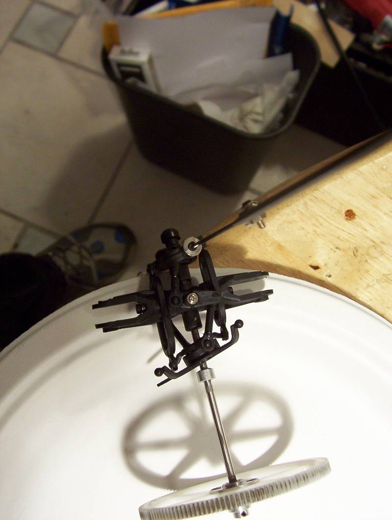

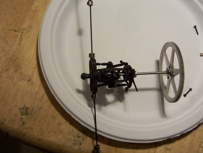

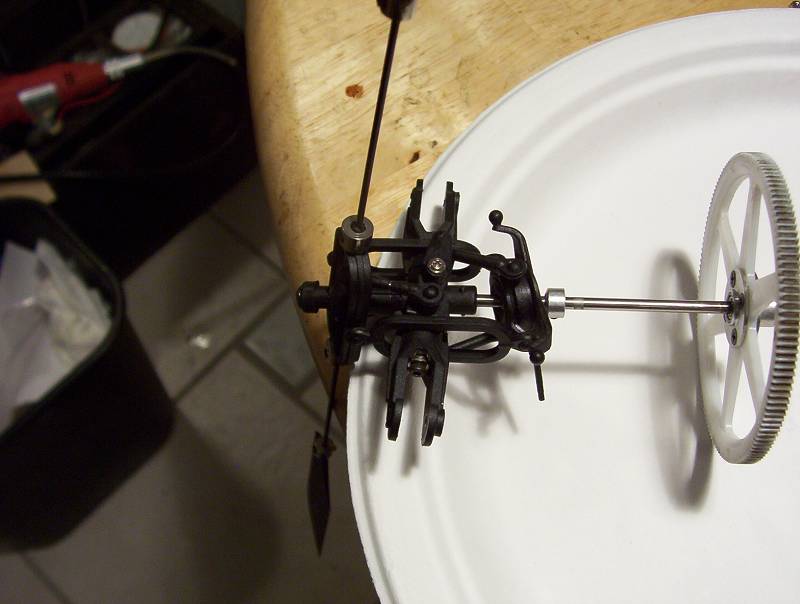

Ok, I think I figured out why I couldn't find a 1/2' ball. It didn't exist[X(]
. Bad pics, but I have rebuilt the rotor head. The parts blow upshows the ball on top of the swash plate. I was crawling around looking for it

I hope you're not going to replace that assembly in the heli without checking the orientation of that locking collar on the main shaft. The slanty side goes toward the top bearing...flat side UP.

Nice catch Ray I looked at it and didn't notice it but you are right flat side up

I had the parts segregated in a chinette plate, a trick I haave use for planes for a while. What fell was a small hex nut. I found that immediately. That stop nut is how and where I found it.I would think I want the flat side on the bearing in the body.
Arrow, do I not have the standard rotor head on here? If not what is it?
I still haven't figured out how to balance this thing. Off to find instructions.

Flat side on the bearing, is WRONG. The beveled or rounded side of the retaining collar, goes against the bearing. That way it reduces friction. See page 16 of the manual. Bottom right picture. You can see clearly that the beveled side is down.
Here's a site: http://h1072147.hobbyshopnow.com/Pro...Pro_Manual.pdf

The reason for the slanty side down is that you only need to retain the driveshaft at the bearing's inner race. The outside diameter of the collar is such that if it were used with the slanty side up, the flat face would interfere with the stationary outer race of the top bearing.

Gentlemen, I will defer to your knowledge until such time as I can take apart and put back together the entire heli blindfolded, in 3 minutes. I was just indicating that it was the way I found it, so that is the way I replaced it. It's a trick from my days as a mechanic. If you I to tear something down that I wasn't familiar with, at every opportunity replace on the assy just as I found it. No worries it went on flat side up. That is one reason I posted the pic.
The heli is rebuilt and if the wind dies out I will use a peice of cardboard as a helipad and attempt to hover when or if the wind dies down. Is the aluminum head gear worth exploring? At $140 I will not be buying any, but just the swashplates are $25.

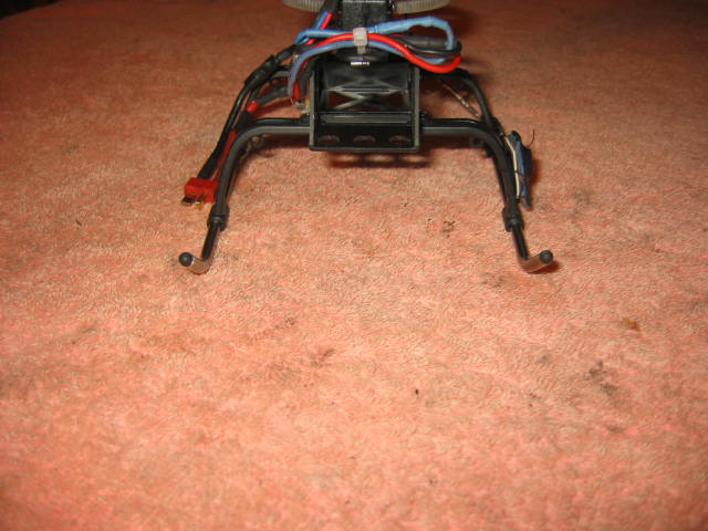

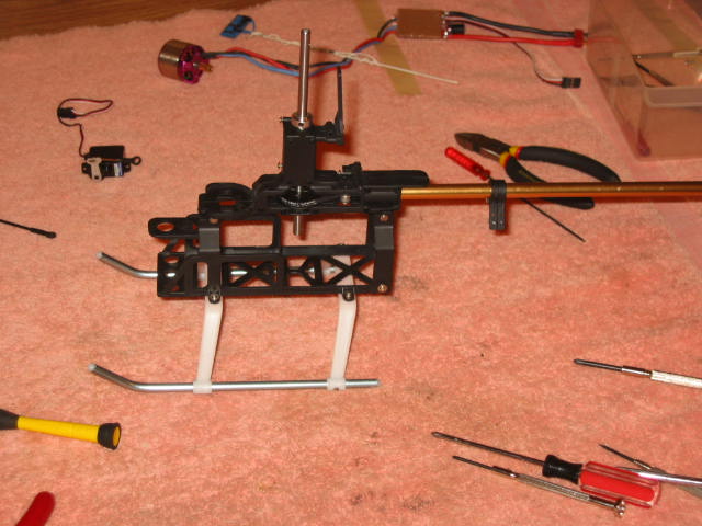

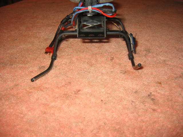

Tip of the Day:
Skids:
Don't use any type of glue or screws / srews(
) to keep the poles in the skids from turning. They have a more potential to bend / break. Just put them in and let it go. On landings, hard or soft, they may twist in the skids, but wont' bend or break. Unless, it's a terrific crash. Yuk-yuk!
See attached pictures.. not great, my camera sucks. But, you'll get the idea.

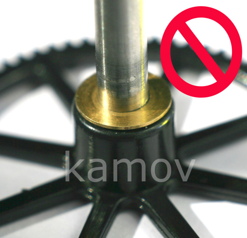

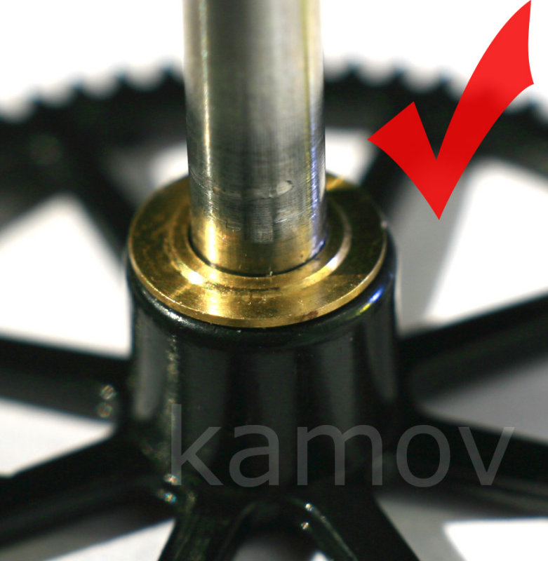

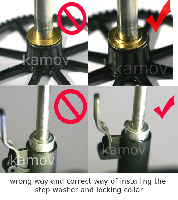

Here are a few pics for your collection. It helps show which way to position the washer and collar...It's for a CX-2, but same principal ...Get that sucker in the air...!!!
[8D]
