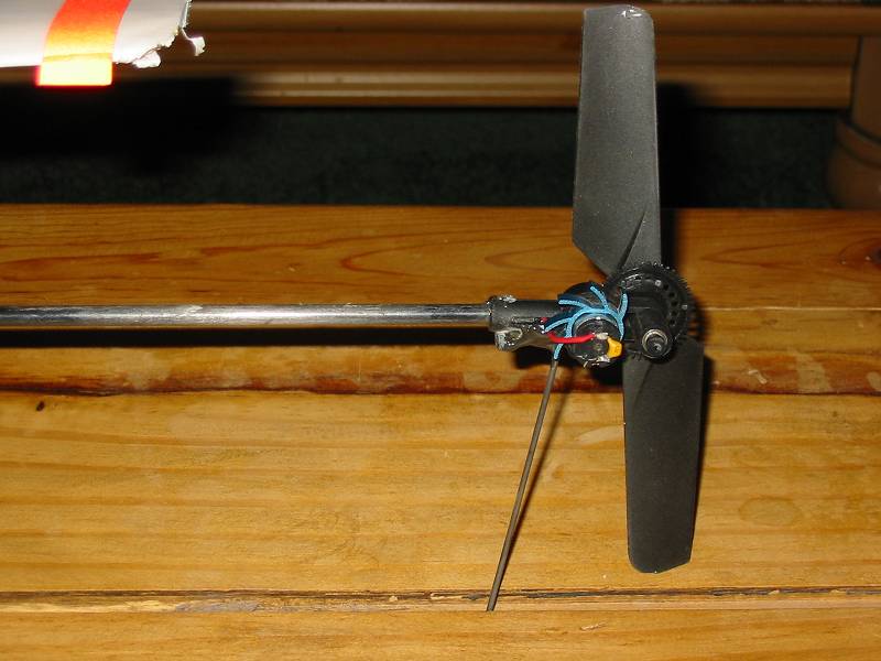

INSTALLING A HEAT SINK ON THE TAIL MOTOR OF THE CP - was bothering me for a while
Just now figured a very simple solution.
( Everything I considered involved disassembling half the heli, cutting straps, soldering, etc)
The space between the motor casing and the black plastic shaft toward the back only interferes with ONE of the blue "fins" of the heat sink. I took the cutting wheel of the Dremel, cut off about half of the fin and then the heat sink SLIDES onto the motor casing from the top. There is a slight hump of a solder joint to ride over but with care and a micro size pair of tweezers it CAN be forced over that. Slather some white sealer on the casing, slip the blue aluminum over that. I had considered disconnecting the wire from the 4+1 etc etc....SIMPLE is MOAH BETTAH
and that's ALL I AM GOING TO SAY 'BOUT THAAAAT ......Forrest G

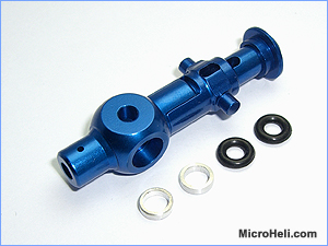

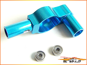

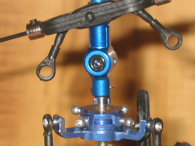

Choppersrule Here:

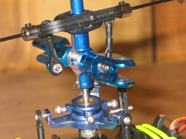

Latest piture of bling stuff. Got the Head Assembly in about a week or so ago.
I installed the CNC grips tonight, standard grips, non Bell-Hiller. Did that, because I like to fly indoors alot and find it easier to control the than the Bell-Hiller. That's what I learned on, no Hiller. (Got the Trex for major outdoor stuff)
Holy SMOOTHNESS Batman!
Between the CNC Head Assembly and the CNC Grips, it's like a totally different heli. Wish, I would have thought of this many months ago. I would have save a ton of $$$$, in busted parts. Difference between a Chevy and a Cadillac.
Enough of my yapping on...
See Picture,
Dave / Choppersrule

Second flight on the CP, with the CNC Head and CNC Grips. I have never ever, in 8 months had a better better hover and short FF. I'll have the wife take a picture tomorrow in the basement of me hovering. I swear by the CNC Head, and the tracking with the CNC Grips is totally right on. Never better. I know, I sound like an advertisement, but this is how it is, absolutely great!!!!
Dave / Choppersrule

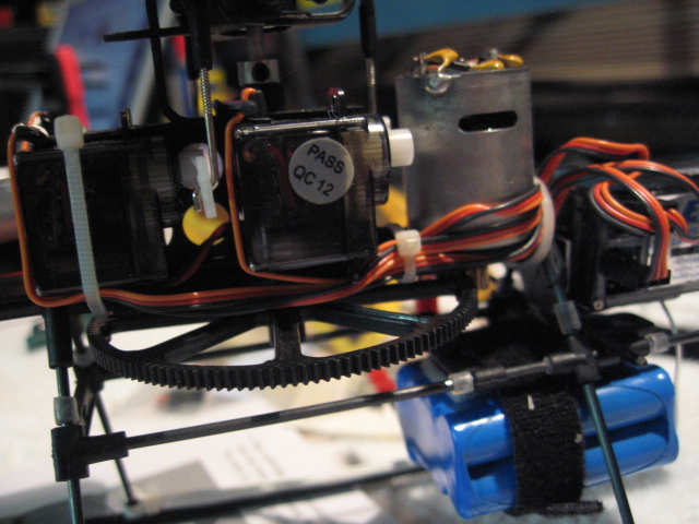

That CNC stuff looks great!

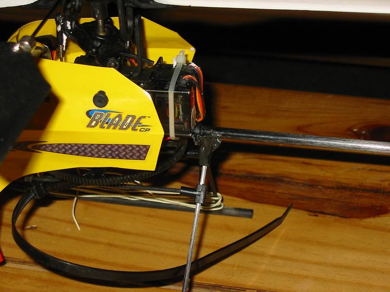

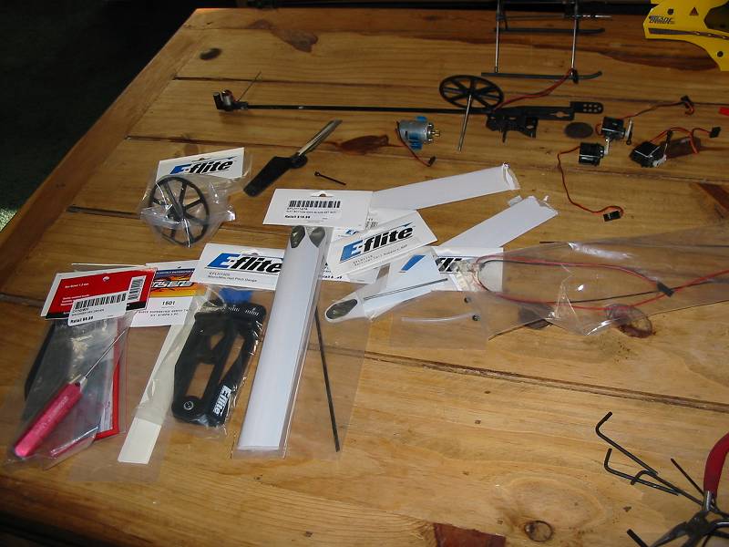

The new airframe was rode hard and put up wet. It couldn't have been flyable in it's last attempts with the previous owner. So far I have replaced the main frame, main shaft and gear, tail boom, tail rotor housing, main blades, fly bar, and tail stand. After I started re-assembling I couldn't decide how to run the servo and motor wires to work and look good. After looking through 42 pages of this thread for pictures, I have decided that you all don't like the right side of the Blade series.
I only found one partial shot of the right side with the canopy off. I did power it up and everything seemed to work fine other than the swash plate needing some large adjustments.
I'm off to search for info about the best way to route the antenna, how tight the blade grips should be and how to do the initial setup on the swash plate.
I only found one partial shot of the right side with the canopy off. I did power it up and everything seemed to work fine other than the swash plate needing some large adjustments. I'm off to search for info about the best way to route the antenna, how tight the blade grips should be and how to do the initial setup on the swash plate.

wick,

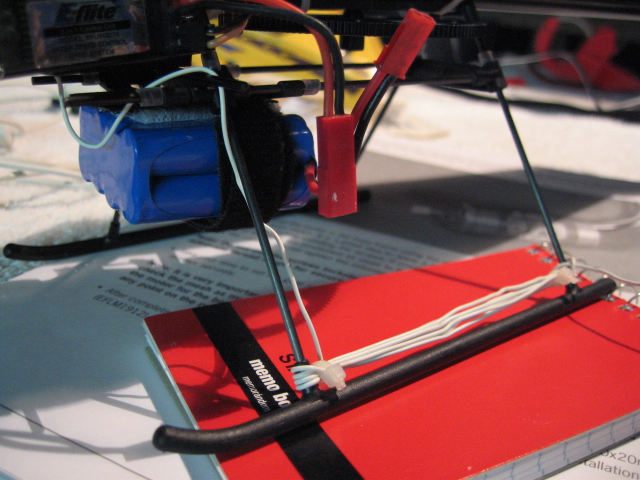

what details are you looking for? here's a couple shots of a stock Blade CP.... hope this helps!
I also noticed in your pic, the tail motor heat sink should be rotated 90 degrees counter clockwise...
edit -
not sure what happened to my last reply, so I'll just add it here.

I'm just looking for ideas for the cleanest way to route the antenna down to the skid. I have the servo wires routed and tied up. Mostly I'm down to reassembling the rotor head and rigging. I've seen so much about how to set it up but there are almost too many opinions. How high should I adjust the swash plate to? With the motors disconnected, throttle and trim at half the swash plate should be level right? I didn't check the orings in the blade grips but as bad as everything else was I'm a little worried about their condition. I guess if I have problems I can take them apart later.
Edit: thanks for the pics - those are perfect. I'll get some "after" pics up of my wiring and the airframe overall tomorrow. She already looks much better than when I got her. Would be easier and probably not much more money to just buy new ones in the box but I have too much fun rebuilding them. Should have enough parts to start on three more next week. Somewhere in this I should probably learn to fly them.

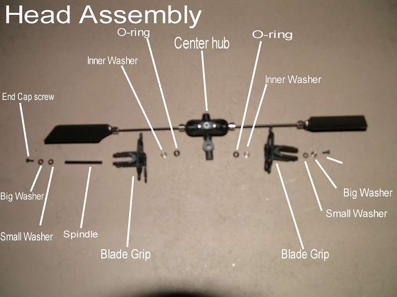

Shoot, got to looking at the rotor head and there was tons of gap between the blade grips and center hub. One oring was out on the spindle and the other one was not visible. I disassembled it and found I was missing washers on the outer ends of the spindle and one of the remaining cap screw washers had been replaced with an off sized split washer. I'm going to have to head back to the LHS (they really should move that store closer to me) and see if they have the washers in stock.
[link]http://h1070313.hobbyshopnow.com/products/description.asp?prod=EFLH1162B[/link]
[link]http://h1070313.hobbyshopnow.com/products/description.asp?prod=EFLH1144[/link]
These are the only replacement parts that I could see that may have the needed washers in them, are these shims to remove the blade grip side to side play on the spindle? Do these parts look like the correct ones?
