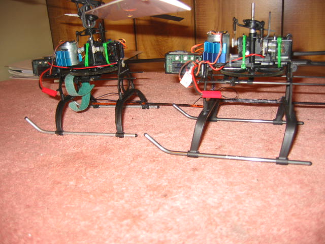

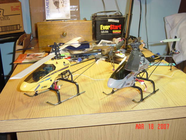

Here is a PIC that I meant to SUMMARIZE how serious I take y'alls ADVISE and GUIDANCE.
I am re-doing the PRO now, like I just did the CP, with SuperSkids and fins, etc. On the table you can see : the 6100 RX for the DX-7 that I picked up today at the LHS. Then there is the SOLDERING PENCIL (thanks Dave ! ) also you can see the MAGNIFYING LAMP, thanks Arrow I just got that today as well...In front: the F/G black blades going on the PRO, right now with the new SuperSkids.......

Like your pictures, you purchased some great things there, especially the SOLDERING PENCIL, I've been after you for that for a month(yuk-yuk). Finally you got the picture....(SOLDERING PENCIL).
HEY, in picture # 2 in the upper left quadrant, I think I see an IRONING BOARD, with Flowers on it, What's with the Flowers?( Jes-kidding)

Great vids Rick - and the cp's look good in the picture. I didn't like the look so much of the super skids a couple of weeks ago but they are really starting to grow on me.
I started over with airframe #1 pretty much from the beginning. Replaced the motor (to trouble shoot my vertical hopping issue), checked the swashplate, balanced the blades, set the zero angle per bladecp.com, and set the blade tracking. I did some test hovering in the living room and it does run a little better. Still getting some vertical hopping. I guess I need to replace servo's individually until it goes away. That or the 4 in 1, not sure which would be most likely yet.
A couple of questions...
After the initial flat setting of the swashplate do you go back later and adjust the servo arms for things like left drift?
What is a good glue for the tail motor housing? I've tried some kind of loc-tite for plastic, it was too soft like rtv and bumping the tail stand make it fail. Tonight I tried a hot glue gun and got the same results. Of course I could epoxy or super glue it but I'm trying to keep these removable so I don't have to buy a whole frame assembly every time there is a boom problem. As I type this I realize that what I really want is a carbon fiber fin - that would take all of the twisting loads off of the rotor housing and I would just have to worry about the boom to frame joint.
For twenty or thirty seconds of hover tonight I actually felt in control. Then some vertical twitching, some yawing and drifting that don't seem to stop despite what I do. I just have a hard time deciding what problems are noob induced (me) and which are mechanical / radio problems.

Is the weight of the super skids a significant factor? That set up has everything I'm looking for - cf fins, tail support bead and looks like a little higher stance to get the tail rotor out of the carpet.

Wick246,
The weight isn't a significant factor, unless your doing some heavy aerobatics or 3D. Hovering and light aerobatics is fine, actually the added weight helps, to some degree, with stablility.
There are two versions out there, V2 and V3, only Gary at 'super-skids.com' has V3. Helidirect carries V2. The V3 is $30, shipping included. V2 is less expensive. There's always a however, the V3 has a biggier opening for larger batteries that, the V2 can't handle, also, the V3 sits the heli about a 1/4 or so higher than the V2.
See Picture: V2 on left, V3 on right.
Just more decisions to make,
Dave / Choppersrule
