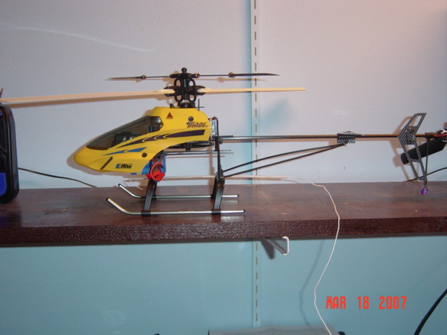

all the research has paid off! "Project Perfect Blade" has ALL planned modifications, (at least for now!)
I've just spent the last couple hours installing the last few components (AR6100 and GWS DD tail).
the install is not complete, I still have to hook up, dress the cables, and program the controller.
I just needed a break, got in a couple flights with my CX2 and grabbed the much needed BEER!
EVERYTHING's better with BEER, especially Helis!
here's some pics

confusion hooking up the AR6100 to the BCPP 3in1...
figures the AR6100 uses labels as THRO, AILE, ELEV and the BCPP uses numbers ch1, ch2.... hummm
from what I can figure out so far, I have it hooked up like this
AR6100 - BCPP 3in1
AILE - ch1
ELEV - ch2
THRO - ch3
RUDD - ch4
AUX1 - ch5
GEAR - ch6
does this seem correct? any thoughts from the experts, test monkies, or expert test monkies?
Edit -
DO-H, not it..... just bind the AR6100 to DX7, then powered up... G90 won't arm, neither will 3in1.... back to the drawing board...

Just a thought, unplug everything(servos, motors and what not) see if the 3n1 will arm. Then add one componet at a time, until it won't arm.
Process of eliminatiion.... Hmmmm, TX settings too. Not familiar at all with the DX7.
anyone out there working on a similar project?
Do you by any chance run a seperate esc for the main motor? If you do, do you have the signal wire from the throttle in on the 3 in 1 and the signal from the esc connected to the throttle out on the receiver?

yes,
I have the 20amp brushless esc from Eflite with the 370 brushless main.
CPPROMAN doesn't say anything about the labels for GEAR and AUX1... I'm also using brushless and G90 HH gyro.... I labeled each ch as I removed from the stock RX. I'm assuming I need to use all 6 channels (which incl. AUX1 and GEAR) as the stock RX was a six channel receiver. Just confused on what goes where... then there's so settings in the DX7.... hummmm I copied the settings and programmed into my DX7... but still
CONFUSED!
[b] It's gonna be SWEET, when I get her in the air!
CONFUSED!

LookyJ...on the DX6, gear is open and aux is pitch (I think). Might help.
