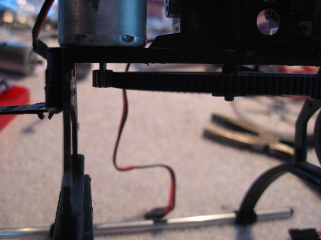

just finished rebuilding the head..
and yes, fixed the main gear issue.... got to love the dremel!

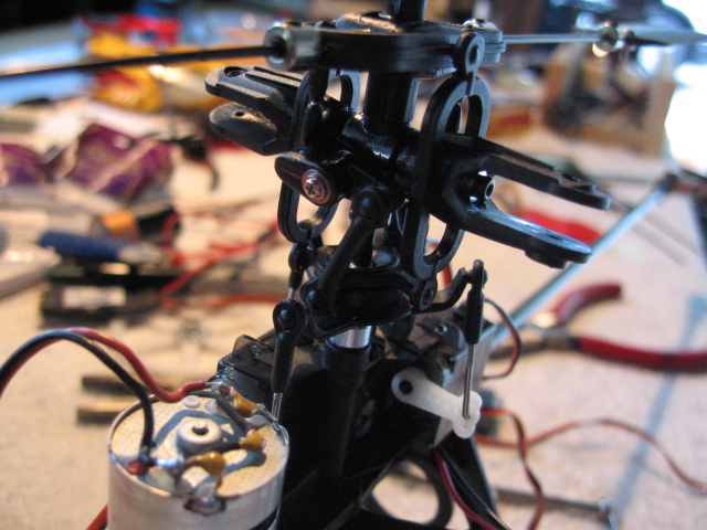

Choppers, I did the servo wire wrap like you showed, it only makes sense, I used to work on 24V control systems and all of our pairs were twisted too.

lookyj, looks really good, got a lot better mesh on that gear now.

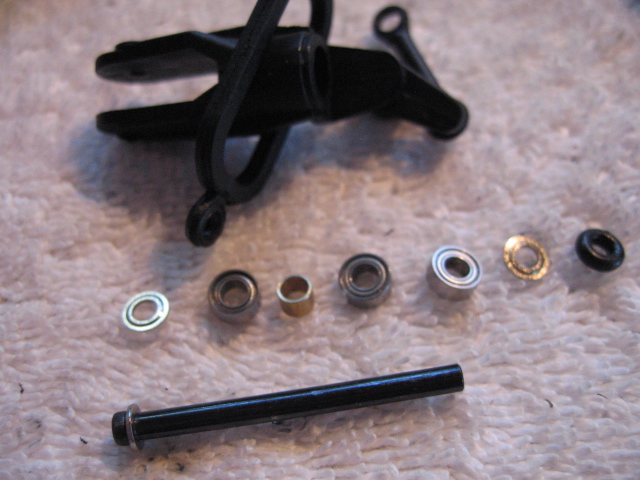

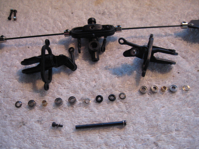

Have any of you guys installed the head dampening shins E-Flite Sells? It supposed to tighten up the cyclic repsonse. I bought them today but am unsure where the shims actually go on the spindle.
#1487
I believe those go in between your O rings and the inner stepped washer, next to the rotor hub.

crash, servo's were plugged in backwards so had to unwrap em and mark each one after I fixed it, then wrap em back up! I am such a dork sometimes. Next issue at hand, Even with the programmable radio I am unable to reverse the collective pitch. So am gonna have to flip blade grips and the flybar inner frame dealie ( I am not sure what its called) and then am ready to go buy a darn scale, I have major wobble going on just starting to spool up. I have my second throttle point set at 21% right now, didn't want to take off to quick until I get a smooth wobble free spool up.

Wnuk I put my shims as Arrow suggested, between the o-rings and the stepped bearing washer. I don't know how much they have helped but I do know that the side slop was causing one blade grip to not rotate as freely as the other because the spindle (feathering shaft) was not centered in the o-rings.

See Lookj's post number 1480, first picture. He has the bearing and shims laid out in order of installation. Remeber the tiny washer with the ridge.... The Ridge always points towards the bearing.

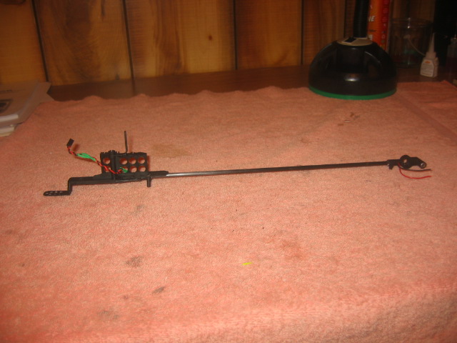

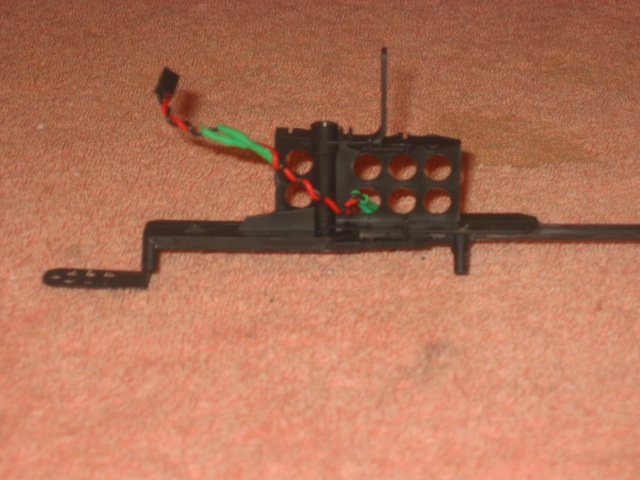

Update on my Rebuild with brushless motor and G90 gyro..
See pictures,,, Over a week and this is all I have done, just been busy..
Got the main frame, tail boom, tail housing put together, Ran the wires for the tail rotor, and made sure I installed the upper and lower bearings in the main frame and the two bearings in the tail.. Not much progress at all.
