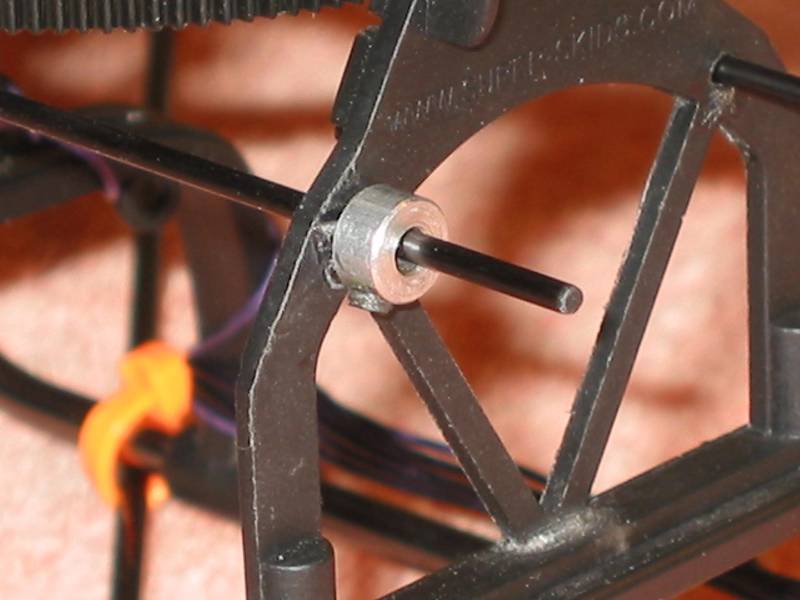

Nice looking heli....You'll be fine with the antenna routing, it's not wrapped around the boom or parallel(spelling) to the boom so interference would be at a very minimum if at all.
Dave / Choppersrule

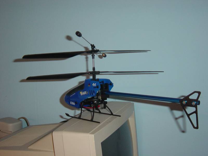

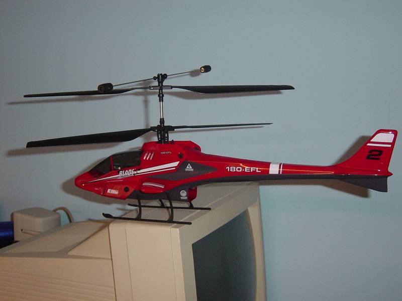

Y'ALL ARE SO DARN SMART - UPGRADING EVERYTHING and discussing abstruse recondite subjects of which I UNDERSTAND NOTHING.
I took the bull by the horns, and I am pleased to present to you :
TAA ..........DAAAAAAAAAAAAAAAAA !
UP=GRADING FOR DUMMIES !!!!!!!!
1 - take a CX-2 STRAIGHT OUT OF THE BOX
2 - render it very NEKKID
3 - have it IMPERSONATE A T-REX !!!!!!!!!!
[ "still" hasn't been flown in its new personality ! - Will it FLY ?
stay tuned
RICK - A DUMMY FOR ALL SEASONS....eat yo' heart out Leonardo da Vinci........[:-]

LISTEN UP N'Y'ALL WILL HEAR : THE UPGRADE WORKED ! ( I had no fear ! )
in actual FACT .... the CX-2 goes quite a bit BETTER with this new personality. The breeze is up from this morning's stillness, maybe 6 or 7 mph
This "new" CX-2 held its own for a bit, where the RED BODY could (or would) NOT
Brought it INSIDE, rolled up the carpet....and proved to myself that it is a lot better
It also has a set of "new" more powerful 2SLiPo which promised to double the Flying time.

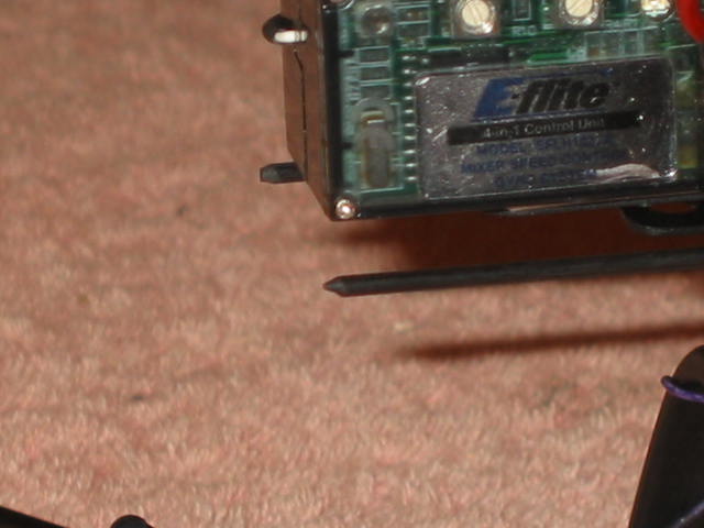

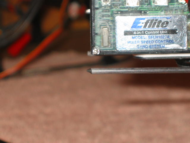

Rick,
Your second picture, with the naked heli.... Guess what... It will fly that way.. UP=GRADING FOR DUMMIES !!!!!!, THAT'S GOOD, Maybe someone can write a book like that.. They have 'em for computers..

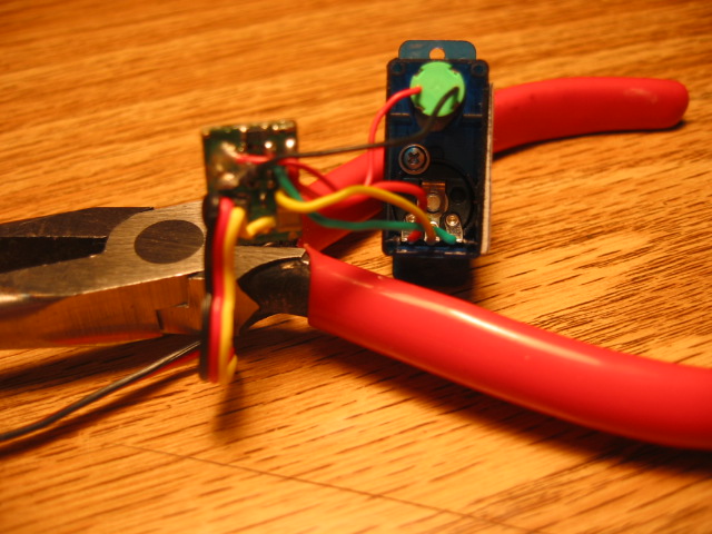

Choppersrule Here:
Topic:
HiTec HS-55 Servo Modification, When Using the Blade CP/ CPPro Stock Transmitter
*This modification is not necessary when using a Programmable Transmitter, servo direction can
be reversed in one of the menus items..
The HS-55 servos turns in the opposite direction than the stock S75's that come with the Blade
CP/CPPro. There is a wiring modification that changes this for the Blade Series.
Warning: If you don’t have good soldering skills or are timid working with 28 or 30 gauge wire
in a cramped area, this may not be for you... There is an alternative method, I’ll mention that at
the end of the wiring modification.
The process is straight forward, and only four wires are involved, two for the servo motor and
two for the circuit board servo travel control.
TEST EACH SERVO, BEFORE AND AFTER MODIFICATION:
PROCESS:
1) Take a piece of masking tape and run it from one side of the servo case, around the front of the
servo(where the servo arm attaches) and to the other side of the servo case. This will hold the
front of the servo case on, after you remove the screws of the case..
2) Remove 4 screws that hold the servo case together.
3) Gently remove the back of the servo case.. This will expose the wiring and the small circuit
board.
SEE PICTURE::
4) At the top of the servo (small green dot, that’s the motor), cut the red and black wires at mid
point. Strip the wires and tin them.( You can use shrink tubing or a tiny piece of electrical tape to
insulate the wires) Reverse them, Black to Red, Red to Black. Solder.
5)At the bottom of the servo, you’ll see three leads, a Red, Yellow and Green wire..
DO NOT CUT THE YELLOW WIRE:::It’s a signal lead and does not require modification:
6) Same as step 4 concerning soldering... Cut the Red and Green wires. . Red to Green, Green to
Red.
7) This is the tedious part, put the back of the servo case back on.. Reinstall the four screws, take
the tape off..
That should be it...
Test each servo to make sure that your work has been done correctly.
ALTERNATIVE METHOD: Servo Reversing Cable
Mrsamm, provided this link to the Servo Reversing Cable.
Link :http://helihobby.com/html/helicopter_servo.html
The only factor is the cost, $9.99 each plus shipping,, a little less then the cost of a servo
The Servo Reverser is a quick and easy way to reverse the motion of the servo and it is ideal for flyers
who do not have a computerized transmitter
My verbiage may be lacking, if there is something you don’t understand, PM me.
Happy Soldering,
Dave / Choppersrule
PROCESS:
board.
SEE PICTURE::
Red.
the tape off..
Happy Soldering,
Dave / Choppersrule

Choppersrule Here:
The first picture I posted for the HS-55 modification was in error... Here's the correct one.
Sorry about that,
Dave / Choppersrule
Sorry about that,
Dave / Choppersrule

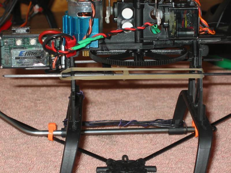

Battery Tray:
Three ways to keep the battery tray rods from slipping..
1) Just a dab of CA to fix them to the skids.
2) A rubber band
3) A wheel collar
I don't have a picture of a CA fix, the rubber band and wheel collar fix is attached..
The collar in the pictures is just for reference, it's a main shaft retaining collar and is to big in Inside Diamater. You can get the right size at the LHS. A shot of black paint would make them invisable. You'd have to use a total of 4 collars, two forward, two aft.
I like to use the rubber band trick, it's fast and easy. Plus, when you have to change a main shaft, tear down is a piece of cake.
Dave / Choppersrule
Battery Tray:
2) A rubber band
3) A wheel collar
Dave / Choppersrule

Battery Tray Rods::
Forgot on the earlier post.. Isn't just a pain to get the battery tray rods through those tiny holes in the skids....
Hmmm, computer brain is on and thinking...... Processing.......Problem resolved.....
See Picture: I just used my dremel tool with a cut off wheel, and used the side of it, and sharpened the end of the rod like the lead in a pencil... How easy is that. Makes for threading the battery tray rods through the skids a snap...
Dave / Choppersrule
Battery Tray Rods::
Dave / Choppersrule
