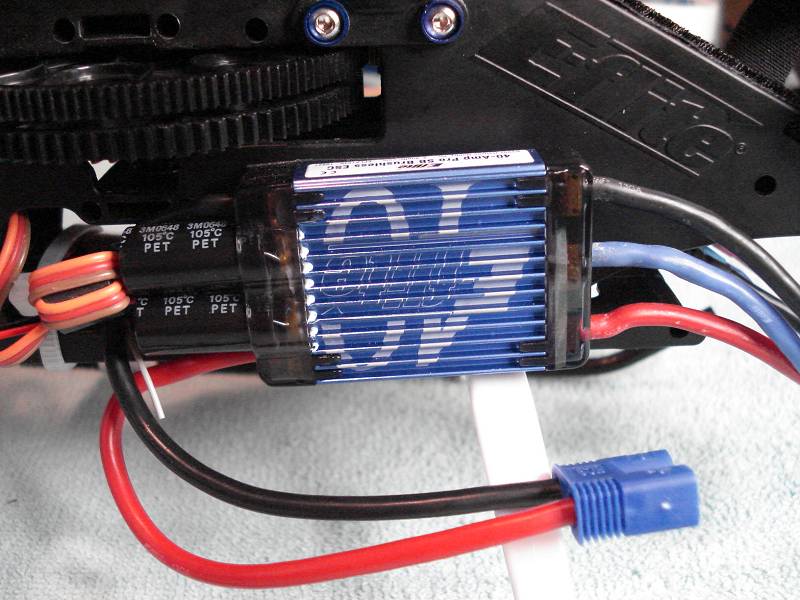

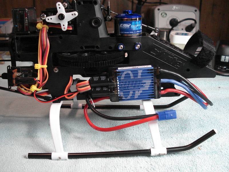

I just upgraded from my stock ESC when it developed an overheating issue.
I went with the Eflite 40 amp ESC...it is nice. I have had no issues with it since I installed it. Easy to install, and setup.
It is way bigger than the stock ESC and will not mount where the stock unit does, I mounted mine on the right side of the frame. It fits nicely there, and stays cool in the airflow.
The nice thing is it's a direct plug in, the connectors are all the same as the stock ESC, no cutting, splicing, etc.
It was not terribly expensive, I paid $75 at my LHS. Now I don't have to worry about ESC problems anymore!

my stock esc is overheating now too well, i think that is my problem? it cuts out after 3or4min. of flight but thanks for the info Glenn i like that the eflight 40a would plug right in
and $75 is not too bad my lhs should have one too do you know what A the stock esc is? 20a? 25a?

Hey auto,
Yep, that sounds just like mine did, it would fly for about 2-3 minutes, then lose power, and the ESC would be extremely HOT.
Yeah, it's a direct plug in, and I'll post a pic of it mounted on the heli for you.
The stock ESC is a 25 amp, which is barely adequate for the job...
I have been very happy with the upgrade. There is a bit to learn about setting it up, we can help you when you get one (I can advise you on this particular one, but maybe not other ESC's, but most are similar).
I had no clue that you could set that many adjustments until I got the new ESC. But, don'w worry, it's not hard to do, just a bit of a learning curve to it...
Glenn

man that esc looks good too! i looked at my lhs web site and they have them in stock
