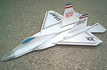

Yeah, the jets are better with little or no wind. Found that out yesterday- it was like
trying to control a kite with little knobber'z. It's now on the chopping block anyway....
Added the decals and a little paint to the F22. Also got it gliding great with 10 grams
of weight. I used 2 grams for each motor, 3 grams for the RX & 3 grams for the battery.
Only problem is where to cut the prop slits? In toward the fuselage or out toward the wing.
I can see another problem for me too. Crunch'n that nose during test flights. I already
did it once test gliding with cotton on the tip. Had to sand off a quarter inch to get a point
again. Foam is not forgiving!

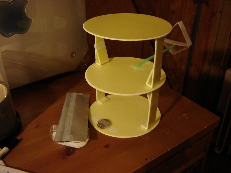

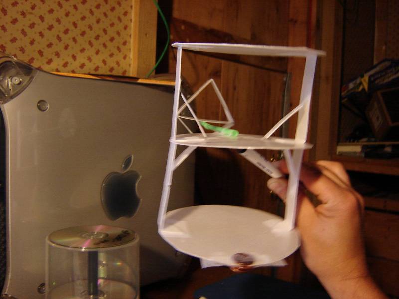

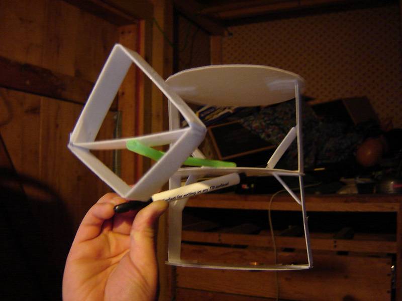

My latest, trying to work with the 3.5mm extruded polystyrene from slingwing but it's thick, heavy and I suspect it will be brittle, also the Gorilla Glue that I have been using for other things, isn't sticking this foam together very well so I have to reinforce with tape. I'll try sanding before gluing.
Pic is of a small test aluminum wing from an aluminum can & a straw inside to fill out the airfoil, and the latest tri-platter wing thing. It glides well but fast (w/3 quarters). Probably too heavy to do what I want which is tight circling climbs and slow straight flight. May have to reduce scale. Needs lots more work.

Posts: 1,135
RE: Air Hogs Aero Ace!
ORIGINAL: FERNDALE AIR FORCE
Would such a structure survive ducted fan motors? Could I perhaps build a wing from aluminum?
with MonoKote to make it stronger. The ducted fans are no doubt heavy. You
should find a way to lighten them up some. Maybe even build lighter housings
for them. Seems like a lot of work- you think the plane is worth it?
I don't know of any forums for the monster. Might be good to find one since it's
discontinued and you may need parts for it in the future.
#2571
Join Date: Apr 2006
Location: Warren, MI
Posts: 1,135
ORIGINAL: jonny didmo
What's the weight of your model?
Try using hot glue or Automotive Goop on the foam. Does the foam have a
backing or plastic covering on it?

I just gutted my stock AA jet. The plastic board mount is smaller than the
AA bipe and the antenna wire is thicker. It's also mounted better. No hassles
cutting that plastic tail boom like on the bipe. The switch is better on the jet too.
The jet makes a better mod than the bipe.
Much easier.
I cut the slots in the F22. They're cut much like the original AA jet.
The outer edges are cut on an angle and then sanded. It's not a squared
slot.
