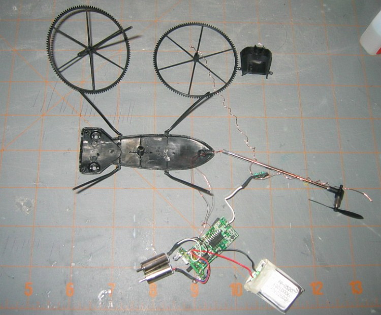

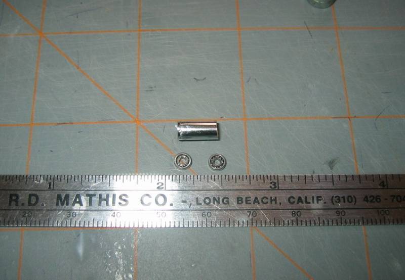

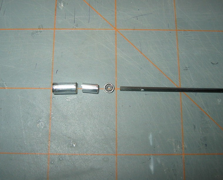

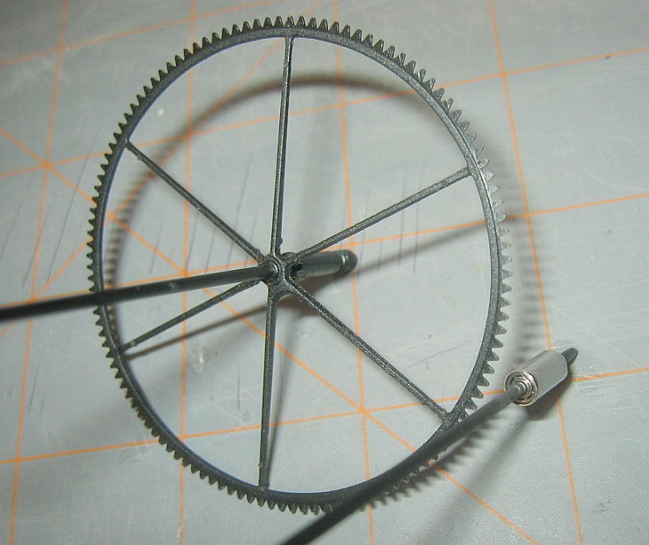

on a side note, my bearings and CF came today. took almost all day to do it, with lots of swearing and a little pain, but i succesfully replaced the stock rotor shaft (had a slight bend in it) with new CF and installed the bearings. the rotors have almost no wobble in them at all, maybe 1 millimeters worth, which is a far cry better than what it was. i still have a little bit of binding to fix, but despite that, my flight times have increased to over ten minutes (only got ten minutes before if i didnt use the tail motor). it was a pain in the butt to do the mod, but it is certainly worth it.
