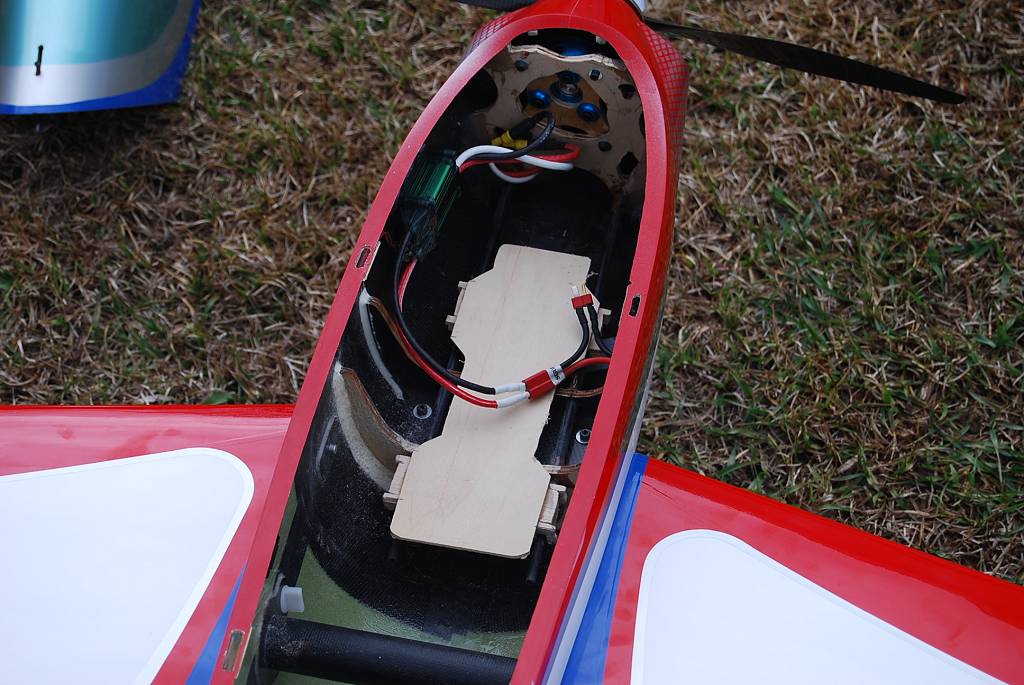

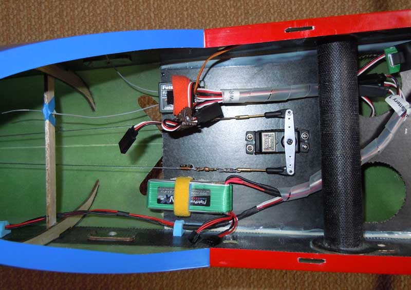

ORIGINAL: rcpattern
Bob,
Dual 350mah packs will last you 10-15 flights with no problems. I know they look small, but they do work....
Arch

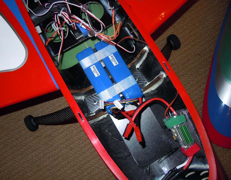

Arch,
They just look so... incredibly tiny! I'll try them later, but for the first few flights I'll go with these.ng
I might have a bit of a problem with the CG. The first photo below shows where I tentatively marked the CG with some striping tape. The second shows how far back the batteries must be placed to achieve that CG (with the canopy on).
Seems pretty far back, doesn't it?? But that's where it balances. Did you ever see batteries that far back?
I looked at some photos of the Wind S Pro and this model appears to be very similar. Do you know where the CG is on that one?

Old 03-05-2011 | 06:24 PM
  #107
Mastertech's Avatar
My Feedback: (31)
Joined: Nov 2004
Posts: 1,411
From: Dalzell, SC
Default RE: Sickle (V-2)
On the CG, leave the wings off and set to the center of the wingtube for the first flights. That is 25% MAC as near as I can figure. I just picked mine up with a 1/4" dowl to check it.
Tim
Old 03-05-2011 | 07:22 PM
  #108
Joined: Jul 2006
Posts: 2,819
From: Ossining, NY
When I do it that way, it must be even farther back to balance!
I'm stumped. I can move the ESC back a little, but I'd have to put the RX batteries under the stab to get it to balance with the battery packs in a more "normal" position.
I must be doing something wrong. All the components are the usual stuff a lot of guys are using, and I can't imagine the tail group on this one is so much lighter than the others.......... I dunno...

Your batteries are only about 2" farther back than mine. That's about .5 oz less in the tail, I used twin servo leads on mine.
Tim
PS.
Did you check the right and down thrust? How about the wing incidence? Add wing adjusters yet? If not you will.

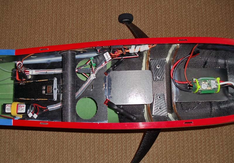

Tim,
Thanks for the input. Do you have a photo of your battery deck?
OK, when I get desperate I go back and search the threads again, and on the Sickle V1 thread on Electric-F3A there was a report by "tewalker" that he was using Zippy's and the end of the battery packs was about 2 inches from the wing tube. So this is not so abnormal as I had thought. Hmmm.
So what I will do is move the receiver behind the wing tube and make another little battery deck farther back, somehow leaving access to the LG area. That would require the least amount of component shifting. I'll leave the battery deck in the front in case I ever get hold of some superlight battery packs.
I have 3 deg of right and 1 deg down thrust, as closely as I could figure using a protractor and some shims. Wing and stab incidence I don't know about yet. I have some Gator wing adjusters which I am hoping I won't need.
For the initial setting on the stabs, I simply centered the metal rods with the set screws in the middle of the oval cut-outs in the stab root ribs.

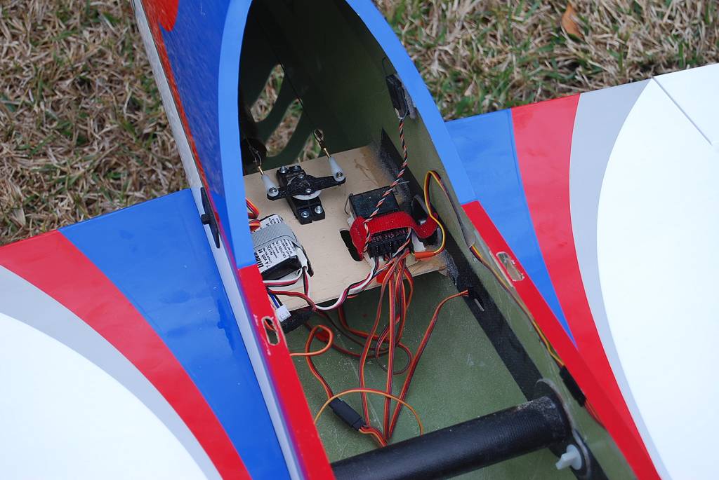

Old 03-06-2011 | 05:01 PM
  #111
Joined: Jul 2006
Posts: 2,819
From: Ossining, NY

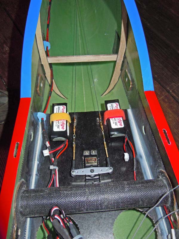

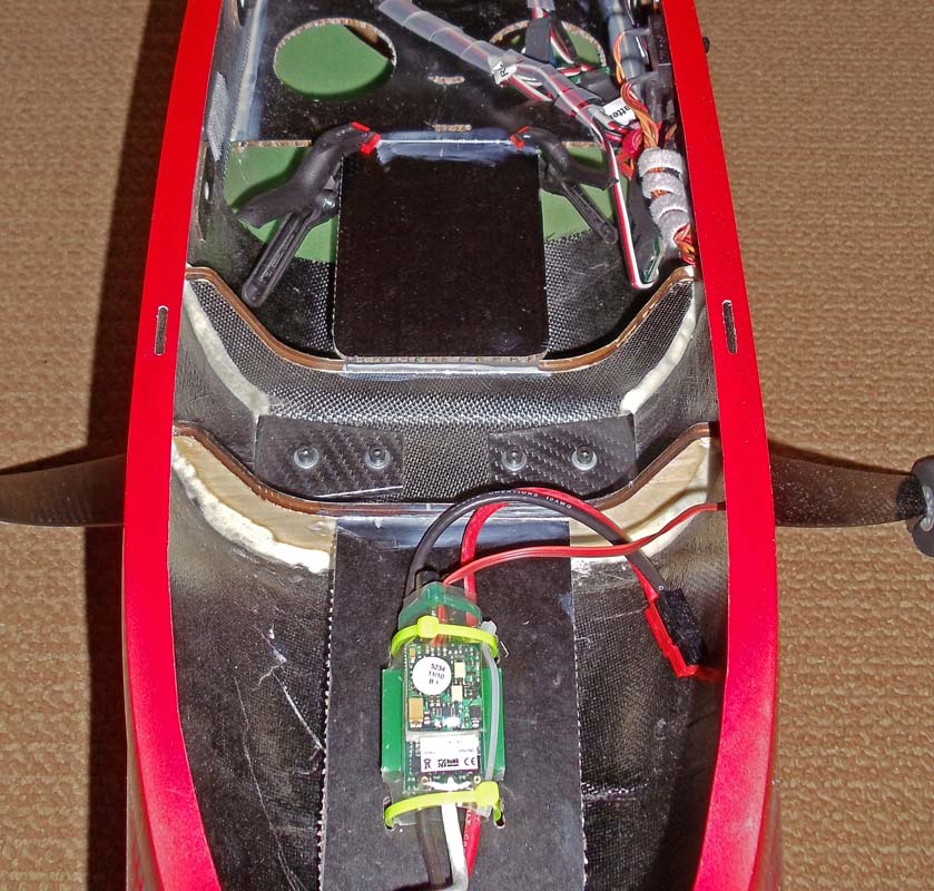

It was quite a hassle but there was no other choice.
Moved the receiver back behind the wing tube, made a new battery deck and spliced it into the mid deck, moved the ESC to the original battery deck, and cut another air inlet in the chin area of the cowl. Now the ESC will be getting a direct shot of fresh air.
Still got the clamps on the new battery deck as the Aeropoxy cures. Also got the servo leads and battery wires squared away.

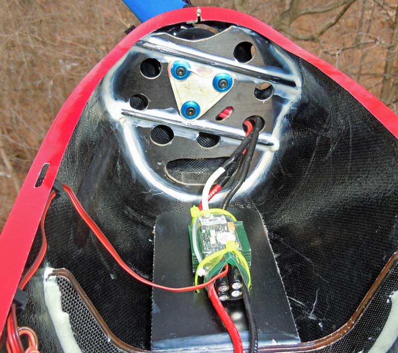

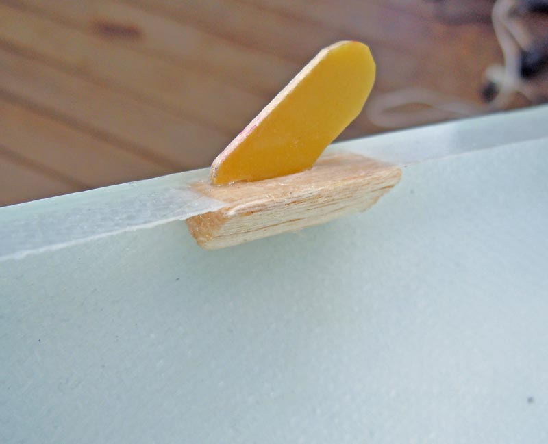

Old 03-10-2011 | 06:31 AM
  #112
Joined: Jul 2006
Posts: 2,819
From: Ossining, NY

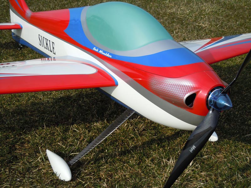

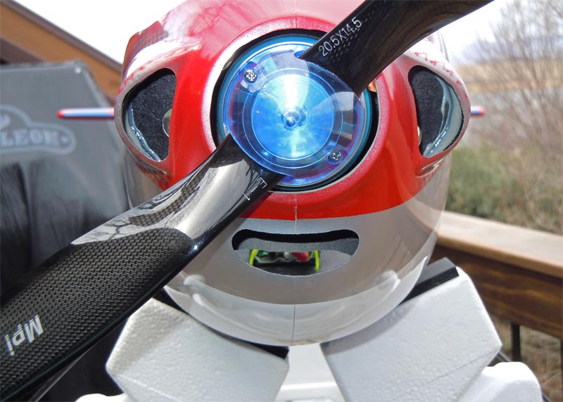

Glad I didn't rush it last weekend because there was some critical stuff remaining to be done before maiden.
Ran up the motor for the first time but nowhere near full blast, perhaps 1800 watts, and the power is amazing! Full bore is going to be about 3.5 HP, and it "inspired" me to add some stiffeners to the firewall.
Also cut another vent hole in the chin, which exposes the ESC to direct airflow.
Don't know how fashionable an undersized spinner is. Definitely lets more cool air into the motor.
Photos of the canopy latch and also the canopy tabs made from the leftover phenolic control horns.
After all final mods (including Falcon prop/lighter spinner, removing unnecessarily long servo extensions on wings), AUW is 4759g with the Zippy battery set, 4816g with the Rhinos.

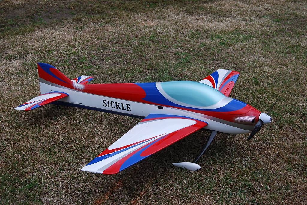

Old 03-12-2011 | 06:50 PM
  #116
Joined: Jul 2006
Posts: 2,819
From: Ossining, NY

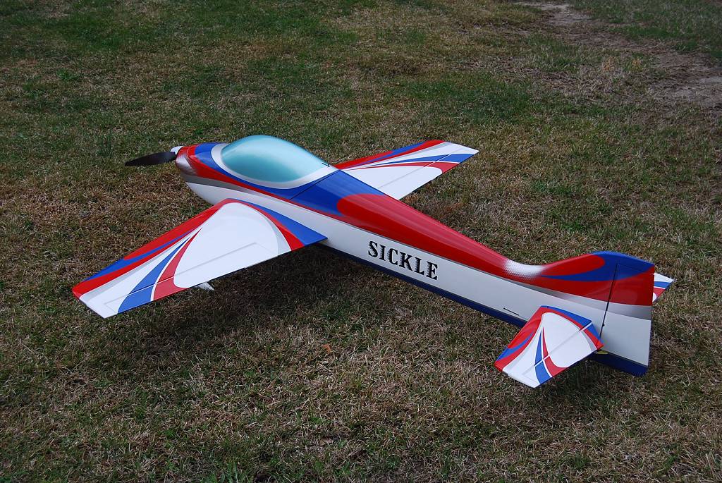

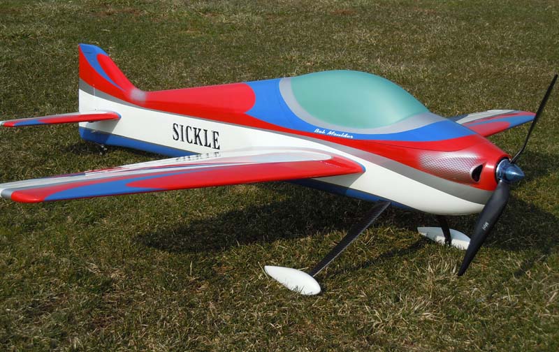

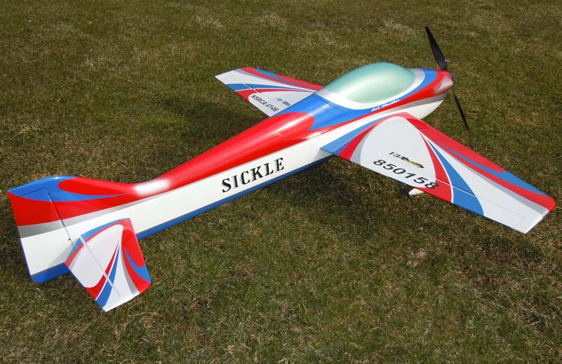

The winds weren't quite so high today as expected and I was able to maiden this afternoon. A bit turbulent and varying speeds.
The Sickle flew great right from the start in a quartering wind that ranged from 10 to 15 mph. Needed 2 clicks of up on the elevator and 1 click of left aileron and it was flying very nicely, without a doubt the most precise flying model I have ever owned, although admittedly this is the first truly modern pattern model I have owned as well.
With the CG located halfway between the middle and the back of the wing tube, it required just a smidge of push inverted and held a 45 degree line upwind with no elevator. Hard to tell much about the downline pull or tuck, or the rudder trim, with the turbulence in the sky, but it seems not to need a lot of correction. Can't wait to fly it on a calm day and find out. As someone noted before, rolls are practically effortless.
I got in 5 short (5 minute) flights to begin conditioning the batteries, but suffice to say that even at this point there is plenty of power on tap. Ambient temp was 55 degF and upon landing the Zippys and Rhinos were barely warm and the ESC and motor were cooled off completely by the time I could get the canopy off to check.
Beautiful flying machine... it's a keeper, for sure!

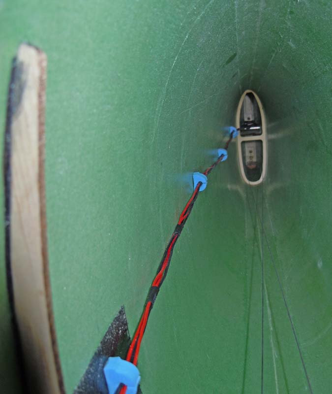

Old 03-22-2011 | 10:07 AM
  #119
Joined: Jul 2007
Posts: 240
Received 6 Likes on 6 Posts
ORIGINAL: cmoulder
The 4-wire, long lead for the stab servos ended up weighing a bit more than the 2 40'' extensions, but the slightly heavier silicone coated stuff will have less resistance and should be better in the long run. Installed a few of those blue foam wire keeper thingies down the inside of the fuse to keep the wires from flopping around.
Hi Bob,
Where did you get those blue foam wire keepers from?
Glen
Old 03-22-2011 | 03:38 PM
  #120
Joined: Jul 2006
Posts: 2,819
From: Ossining, NY
Glen, I'm on the droid now so it's hard to paste a link. However, go to amazon.com and keyword search "servo wire keeper" and you'll find them.
Edit: Ok, Horizon has them [link=http://www.horizonhobby.com/Products/Default.aspx?ProdID=DAJ74RED]here[/link], except they're red now.
They have some adhesive on them, but add a small drop of medium CA and they will stick permanently.

The Tech-Aero dual regs with the 2 FP 350mAh 2S LiPo's worked out very well with surprisingly low current draw. Did 6 flights today and upon recharge put back only 152 mAh.
Plenty of capacity for a day's flying and can really shave significant weight, depending on what you might be using now. The 2 batteries together weigh 56 grams. I didn't weigh the switch/regs before, but I would guess the whole dual-redundant Rx battery set-up weighs less than 4 oz.
