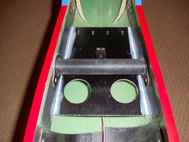

Working on the mid-fuse deck today. I thought I would make it a full 12 inches long (the dimensions of my CF stock) but there's no way it could be finagled into position because of the wing tube. So I kept trimming a bit off my pattern until it fit in without bending. Looks like approximately 9-1/2" with plenty of room behind the wing tube for the rudder servo (but close to the wing tube to achieve CG... hopefully) and room in front for the Rx and battery.

Some progress today on the rudder servo/mid-fuse deck.
I made a template from a nice plastic sheet (cover from a report folder) and transferred it to the CF with a silver marker, which turns out to be excellent for marking dark-colored items. This silver will write on anything!
It turned out to be a perfect fit. I made a little 4-inch stick to use as a guide and CA'd some small triangle stock to get the height of the tray even on each side of the fuse, then a couple of small sections of 5-minute epoxy to set it in place, followed by the Aeropoxy. This is really going to make the middle of the fuse rigid, and there is going to be virtually no flex in the servo. There are some small 1/8" 5-ply strips on the bottom to give the servo screws something to bite into.
I have a pdf file of the deck if anyone wants it.

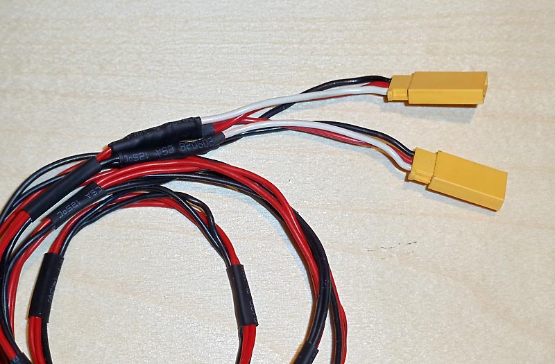

Today I had a short time this morning to do something so I started soldering up the 4 wire servo extension for the stab servos. I don't know precisely how long it will be - since it depends upon the receiver location - so I will not solder on the male ends until a little farther along in the assembly. I have a couple of normal 40-inch extensions and I will compare weights when done.
Also put in the rudder control horns with Aeropoxy. I used medium CA on the others because there was a lot of contact area within the control surface slots, but these rudder horns had to be trimmed off since they butted up against each other. I got as much glue in there as I could and I hope they hold. That's a lot of stress for such a small area.
Some guys (and some of you!) have done some pretty trick designs and installations with the battery tray. However, I think I'll keep it simple with just a well-secured plate of some sort and some Velcro straps.

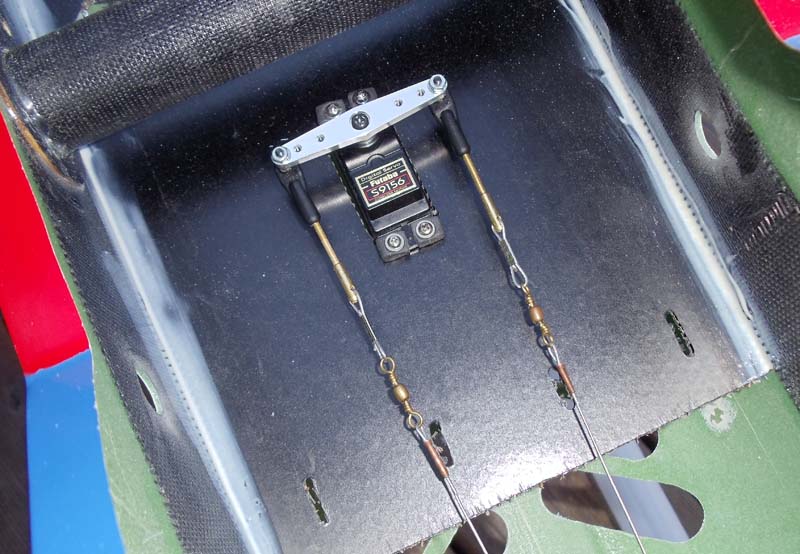

Got some more stuff done the last couple of days, the motor mounted with a ply plate to spread out the bolt hole stresses, and the battery deck.
Also got the rudder servo set up, using the fishing swivels to keep the pull-pull wires from winding up when turning the adjusters.

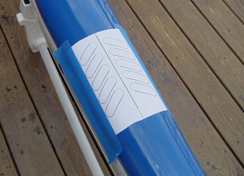

I still didn't start working on the canopy yet, but some good progress was made in other areas.
Made a template for the belly vent, stuck it on with double-sided Scotch tape and went to work with the Dremel.
Got a Futaba aluminum servo arm for the rudder pull-pull because the round wheel was interfering with the linkage hardware. Located and cut the holes for the pull-pull exits in the fuse and got them pretty close. Pull-pull installed.
Holes cut for the aileron and stab servo wires, and the Tech-Aero switch and the charge port for the second RX battery.
PDF for the Sickle vent is attached if someone wants to use it.

I've been steadily keeping up the work and my Sickle might be ready to maiden Saturday, depending upon the weather and any last-minute glitches I might encounter.
For the canopy I decided to simply go with the F3A Unlimited latch and I made some alignment tabs by cutting down the leftover phenolic control horns. The canopy is still not a perfect fit so I plan to put in some CF braces to get it to behave a little better.
The 4-wire, long lead for the stab servos ended up weighing a bit more than the 2 40" extensions, but the slightly heavier silicone coated stuff will have less resistance and should be better in the long run. Installed a few of those blue foam wire keeper thingies down the inside of the fuse to keep the wires from flopping around.
There were no set screws for the stab adjusters in the provided hardware. I made some by cutting the ends off some 4mm bolts and slotting the tops with a Dremel cutting wheel. These worked out fine.
Programming the CC ESC with the Castle Link was a breeze, and setting the fixed endpoints for the motor went very smoothly.
The Tech-Aero dual reg arrived in the mail a couple of days ago. Had to solder on a Futaba-compatible charge lead for the second RX battery and also solder Futaba leads onto the LiPo RX batteries.

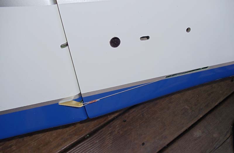

Finishing details
I think I already know the answer, but.... Are you guys sealing the aileron and elevator hinges with clear Ultracote? If so, both sides?
Never used stab adjusters before and I don't have any sophisticated alignment tools, just a couple of Robart incidence gauges. How do I get a good starting point for the stab incidence setting? With the adjusters set so that the aluminum rod is centered in the oval cutouts in the stab root ribs, just eyeballing it, it appears to be tipped down a bit.
