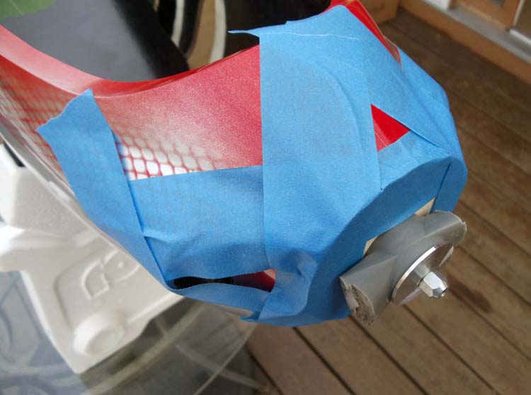

Guess I'll just go with 3 deg right (for 14 pitch prop) and 1 deg down since the thrust line isn't very far above the wing.
Hmm... everybody must be busy in their workshops!
#57
Bob,
How are you going to measure it and keep it set as you glue your firewall? I'm thinking I could build the right thrust and down thrust into a spacer I would use to set my spinner backplate gap.
Glen
Glen

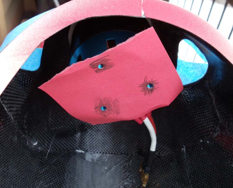

I think that's what I will do as well, make an oversized spinner backplate from ply and then the angled spacer and somehow anchor it to the model's nosering with the firewall attached to the motor. Seems a little gymnastics will be involved, but that appears to be how some others are doing it on various models. I did find and download the firewall pattern posted on the F3A Electric discussion group. Good info also found on the RCU Valiant thread.
This is my first electric 2-meter pattern ship (and composite as well) so I am venturing into new territory here.
The composite firewall and servo tray material arrived yesterday from ACP. I got a couple sheets of both the end-grain balsa CF laminate and the nomex honeycomb laminate. A long-time pattern guy and friend of mine gave me some pointers on these materials last night at our club meeting.
The aeropoxy is arriving in the mail today which means the next couple of weeks should be interesting.
How far along are you on your assembly? Thus far I've gotten the elevator and wing servos installed and linkages done on the elevators. Elevator linkages were a bit tedious, but the the aileron links will be easy by comparison.

The way I did the V1, and will use the same method for the V2, was to have the motor mounting holes drilled in the firewall and the
firewall fitted as close as possible in the fuse.
I made a spinner spacer ring as you describe with the desired backplate spacing and side/down thrust.
Got all this assembled and then hung the fuse by the wing tube holes in the shop oriented as close a possible to
dead straight nose up.
Once this was done and I had the spinner with spacer centered I tack glued the firewall in from the back with Bob Violett
epoxy...can't remember what it's called off the top of my head but it's the stuff you need to use a "gun" and can attach
a long mixing nozzle to the end of.
Once this setup at least 24 hours I carefully removed the motor and then ran a finish bead of the BVM stuff around the front and back side
of the firewall to fuse seam.
Worked really good.
JLK

That's what I got, the BVM Aeropoxy. Must be good because it sure ain't cheap!
Although I have the downloaded firewall template it looks as if there is still a ton of work to do because the V1 and V2 noses don't look the same. Seems there was sort of a flat shelf in the chin area of the cowl on V1 and just an open structure on V2. Also no rudder servo tray on V2 which complicates it for a composite virgin such as I.
Oh well, I am just reading through and looking at photos from all the composite build threads I can find so I don't make any major mistakes.

The firewall was an awful lot of work as you guys know, with lots of figuring and futzing, but putting together all the advice from the various Sickle threads made it possible. What a relief it is well on the way to being done after spending 2 full afternoons getting to this point. Hope it's quicker next time![X(]
The tip someone posted for transferring the motor bolt template to the firewall worked beautifully. I used some double-sided Scotch tape, a couple of tiny pieces on the end of the motor and then put a lot of tape on the firewall side. All bolts went in on the first try with no misalignment.
A question... After the Aeropoxy cures should I remove the motor and put another bead on the other side of the firewall? Seems like a good idea, or is it not necessary?

"After the Aeropoxy cures should I remove the motor and put another bead on the other side of the firewall?"
Bob,
Yes, that's what I did.
I let the Aeropoxy cure for 24 hours then I very, very carefully removed the motor and ran a bead
around the front side of the firewall to fuse joint.
JLK
