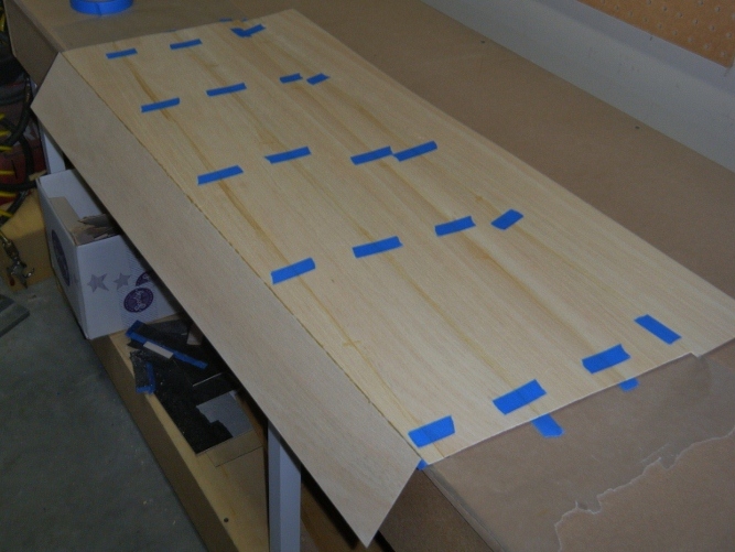

Now I need one large sheet of balsa to sheet the wings with. I use blue painter's tape to hold the sheets together, open them like a hinge, apply glue, and then tape the top. Now, the real secret to wing sheeting is using the correct glue to hold the sheets together. I have tried many different glues which never quite turn out right, so with my last build I went old school and tried Ambroid. It worked great. It sands very well and doesn't get super hard. The only down side is the STRONG fumes. It can be tough to find as well, but I have a supplier out on the West Coast, right Dad?
The second key to wings skins is to sand them to near perfection prior to putting them on the cores. This makes sanding the seams much easier and much more effective.
I tried something new this time and glued my carbon reinforcement to the wing skins prior to gluing them to the core. I like the bond I get using CA with carbon, so I wanted to take advantage of that. I did make precise marks for the location of the cores on the sheeting to ensure the carbon is in the right spot.

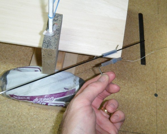

I use Gorilla Glue to sheet the wings and stab. I apply the glue to the sheeting and then use a foam roller to spread the glue out as well as soaking up any extra. I align the sheeting on the cores and the cores lined up with the shucks. Then I use weights to hold the whole thing down until it cures. Once everything is dry, I pull the weights off, but I leave the wings in the shucks. I sand the extra sheeting off using the shucks as a guide. Once all of the edges are trimmed, pull the wings and stabs out of the shucks, and presto, you have flying surfaces.

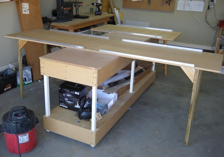

The wings and stab are now sheeted with the leading and trailing edges trimmed and sanded. The next step is to install the wing tube socket in the fuselage. Alignment of every part that goes into a pattern plane is fairly critical, but this is arguably the single most critical joint in the build.
I start by ensuring my line-up table is level and flat. I have adjustable feet on all of the legs to get everything flat. I use a combination of my digital level, straight edge, and thread strung across the top of the surface to ensure accuracy.
I made all of the holes in the fuselage for the wing and stab sockets prior to mounting the fuselage to the table. I made hole on one side slightly oversize to allow adjustment without having to take the fuselage out of the jig every time.
Next, the fuselage is mounted to the table and is adjusted to zero pitch and the fin perpendicular to the building surface. I used the firewall jig station that was used in the construction of the fuselage to anchor the front end of the fuselage. I used two jig stations, turned 90 degrees, as clamps to hold the aft end of the fuselage.
The wing socket along with the lightply doughnuts are installed in the fuselage. The wing tube and the wings are installed. 1/2" balsa spacers are used between the wing roots and the fuselage sides to allow for the socket that extends out of the wing root. The wings are set in jigs to hold everything in place.
Measurements are first taken to set the wings at zero degrees incidence, then set the wingtips equal distance from the surface, and then from each wingtip to the tail and the nose. I use T-pins, set with CA to mark all of my measurement reference points. I have used a steel cable with an adjustable pointer to check the wing to tail measurement in the past, but for this build I upgraded the cable to a carbon rod. I used both, and the results where the same between the two.
Once everything was set I carefully applied Hysol to glue in the sockets and the doughnuts, making certain no glue gets onto the wing tube. Once all the glue is on, I recheck all measurements, and then kick back and wait for the glue to cure.

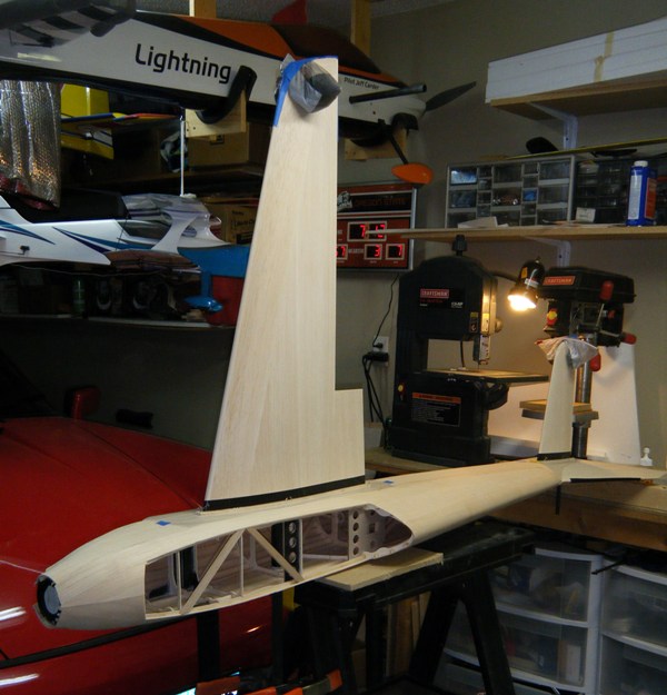

The stab socket is installed using the same method as the wing socket. I left the fuselage and wings in the jig, elminating the need to line everything up again. Here are the pictures with the stab on.

Jeff, how do you gain access to inside the tail where you'd glue the stab tube inside the fuse?

Great question. It took some head scratching to figure out how I wanted to go about it. The sub-fin area on the bottom of the fuselage is covered with a piece of 1/4" balsa that is added after the stab socket is glued in. I slid the socket in with the lightply doughnuts on the socket. I then set everything up in the jig. I only glued the outside were the extra socket sticks about 3/16". Once that was all cured, I turned the fuselage over and glued the inside and the doughnuts through the open area in the bottom of the fuselage.

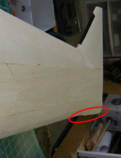

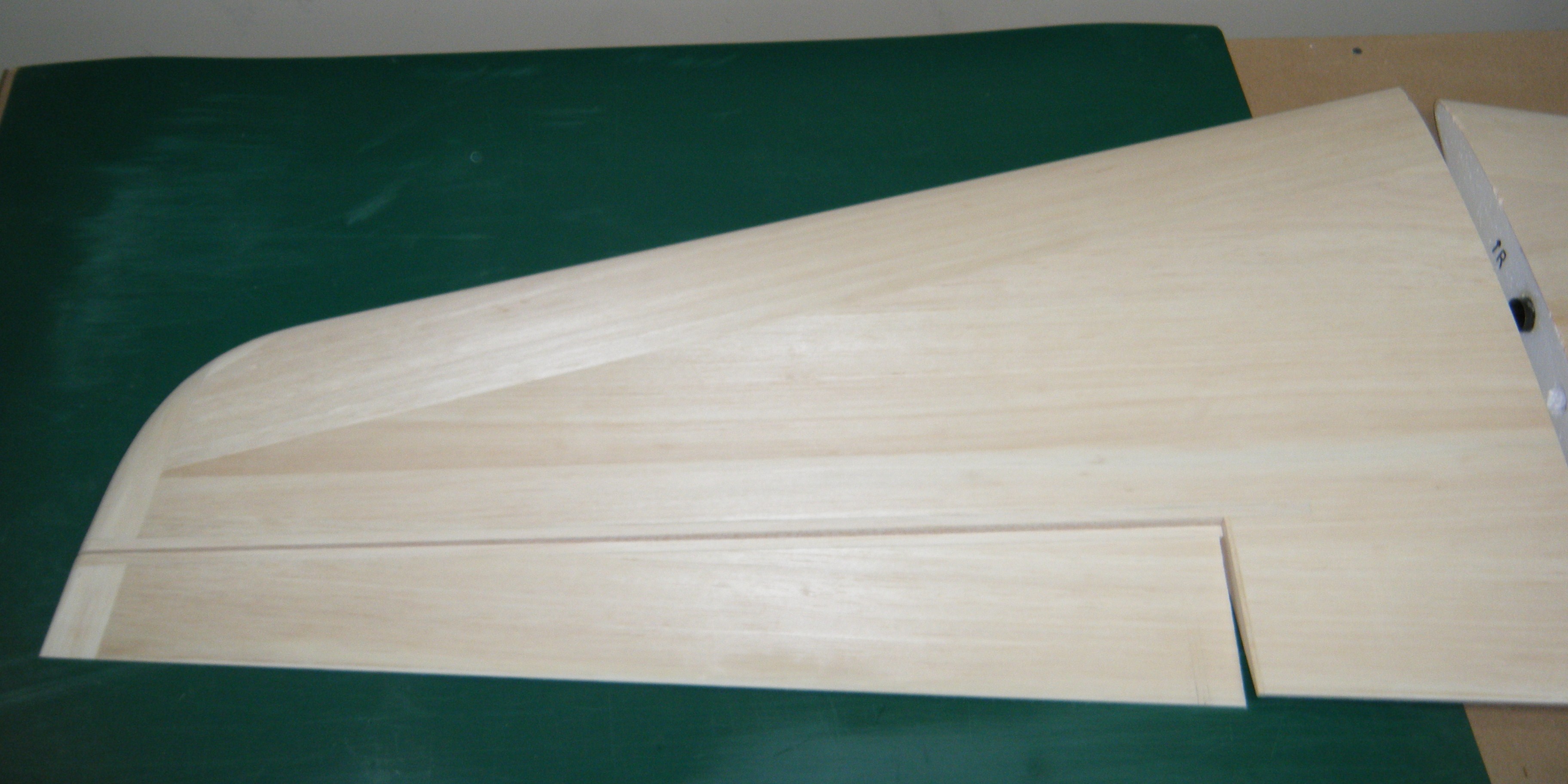

Old 03-06-2011 | 05:39 AM
  #94
Viper Driver's Avatar
Joined: Feb 2003
Posts: 397
Received 5 Likes on 5 Posts
From: Archer City, TX
Default RE: Lightning Build
I have been making quite a bit of progress (yes Arch, I consider this progress). It is really looking like and airplane now!
The leading corners at the tips are cut off and replaced with balsa to account for the curve of the tip. The leading and trailing edges are then glued on. The leading edges are 1/4" balsa and the trailing edges are 3/32" balsa. I use Gorilla Glue, applied with a foam brush to glue them on. I use hard 1/4" by 1/2" balsa sticks stacked on top of the leading and trailing edges to ensure they lay flat against the wing. The stack is then held on with blue tape.
The wing tips are hollowed out and added after the leading and trailing edges.
I then cut the control surfaces free. I stack the wings and stabs back in their respective shucks and use my band saw to roughly cut them out. I use 1/4" balsa for both leading and trailing edges of the control surfaces. I reinforce the wing trailing edge at the junction of the aileron inner tip and the trailing edge of the wing with carbon fiber.
I have also included another picture of the stab socket to help clarify the previous post on how I installed it.

The root ribs are made from 3/16" balsa, reinforced with carbon fiber.
As far as general wing set-up goes, I like to use two nylon 1/4-20 bolts with wing nuts per wing panel to hold the wings on. This may be overkill as far as simply holding the wing panels on, but it has the benefit of making the wings extremely rigid. There is no slop when the wings are bolted on. There are square lightply plates for the bolts to secure to. I use one Gator wing adjustor per panel. I am reusing old adjustors from some of my old dearly departed aircraft, so I had to make new sockets. I searched high and low for the correct dimensions with no luck. I ended up using the correct OD phenolic tubing that I drilled out to the correct ID. End grain balsa blocks are glued to the rib to anchor the sockets.
The stab ribs use similar materials as the wings. Gator stab adjustors are courtesy of my buddy Tim. To mount the stab, I use 4x40 screws going into the ends of the stab tube.
