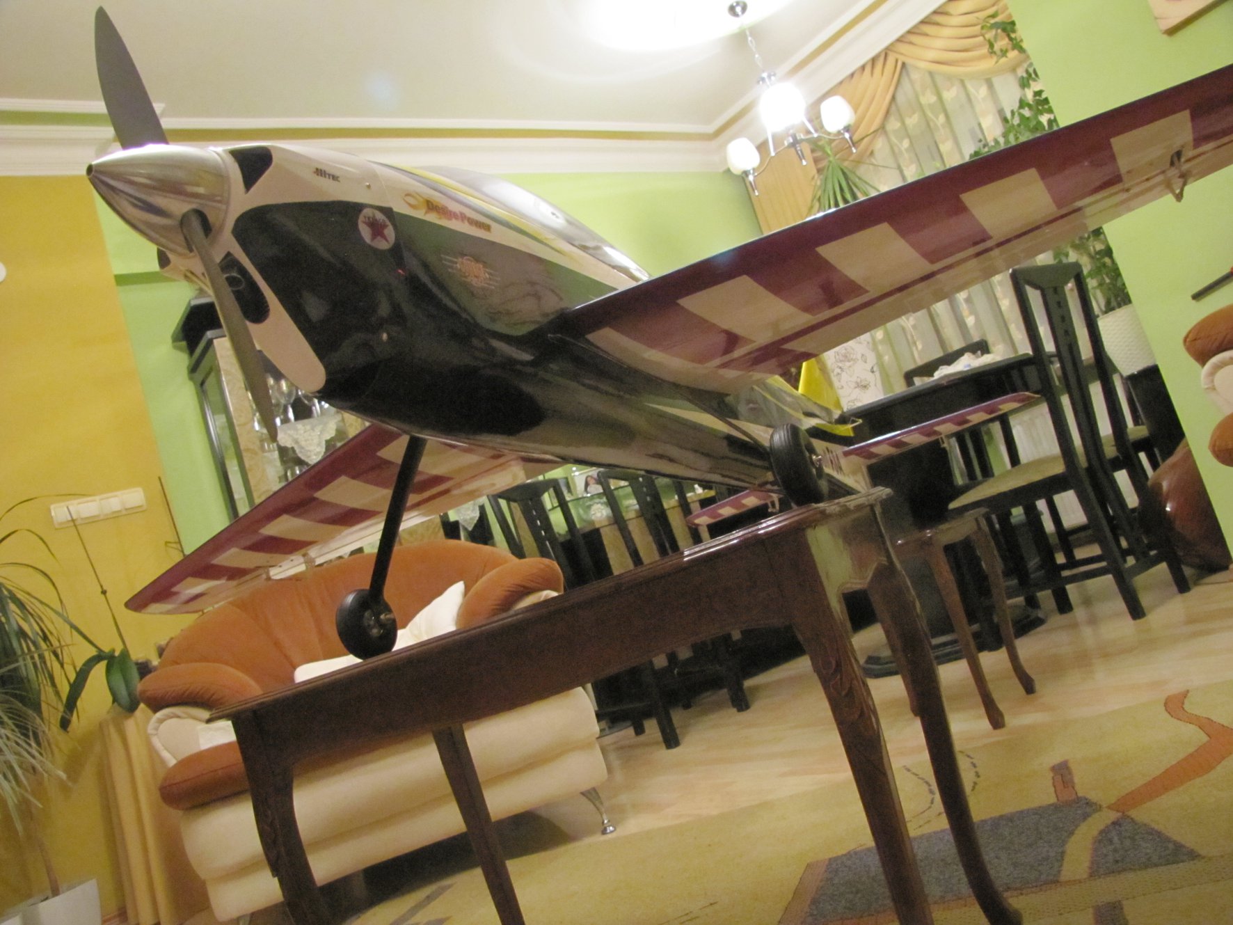

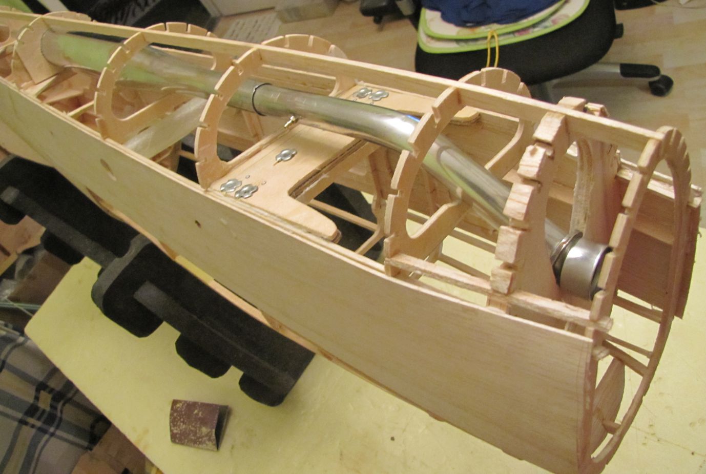

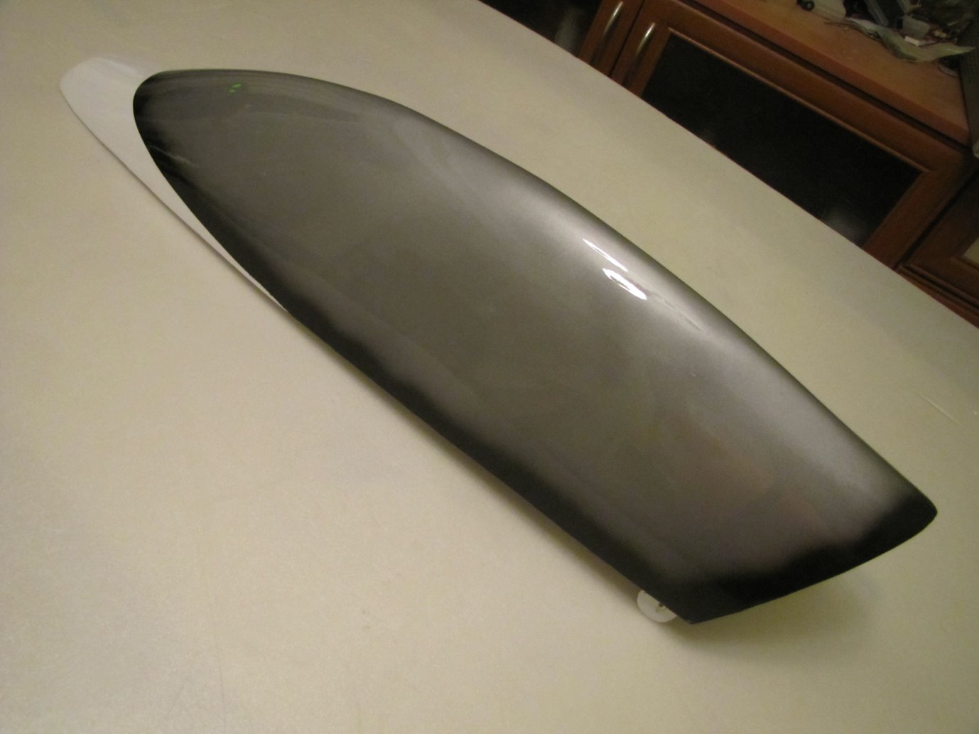

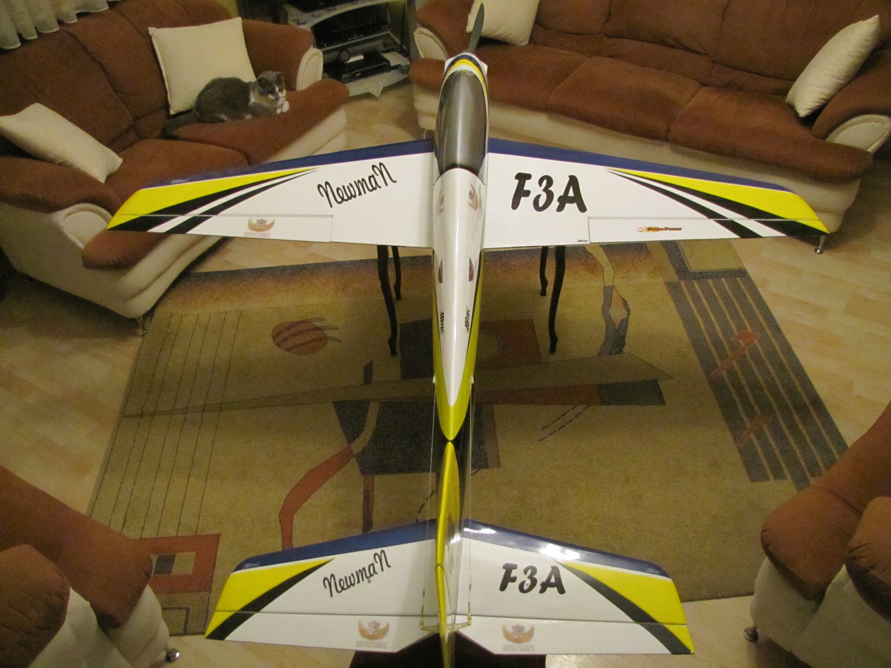

Jeff, many many thanks for plans. So I also now have a F3A!!!!
I have a question to anyone, where is CG point for this F3A?
Thank you.
My works for F3A and final.

Old 08-23-2013 | 08:32 AM
  #480
Joined: Feb 2012
Posts: 47
From: , CA
I believe it's on the plans.

Old 08-25-2013 | 07:04 AM
  #484
Viper Driver's Avatar
Joined: Feb 2003
Posts: 397
Received 5 Likes on 5 Posts
From: Archer City, TX
Mnevzat,
Very nice work fitting the engine and pipe in the airplane and great job overall. Let us know how it flies.
Jeff

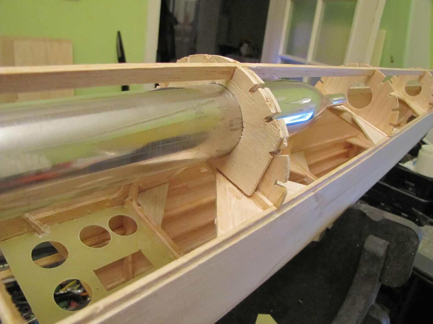

Old 08-25-2013 | 01:42 PM
  #486
Jason Arnold's Avatar
Joined: Aug 2005
Posts: 1,341
From: Sydney, AUSTRALIA

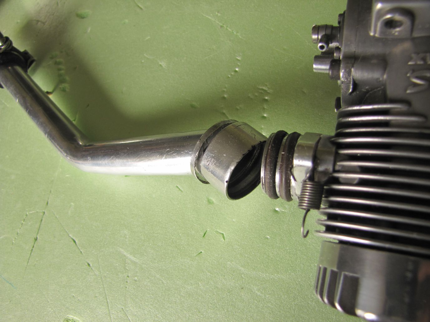

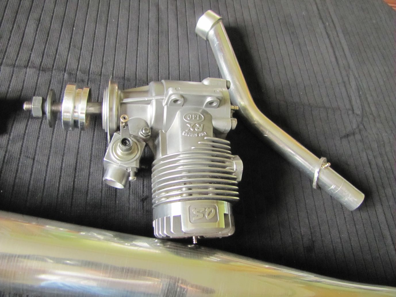

That 140Rx hard mounted, is going to vibrate the hell out of the airframe. You should consider some sort of soft mounting for the engine and pipe.... A Hyde type soft mount and nose ring would be the easiest install based on your pictures. Budd Engineering also have a suitable solution.

Old 08-25-2013 | 03:01 PM
  #487
mnevzat's Avatar
Joined: Oct 2007
Posts: 13
From: Istanbul TURKEY
Jason,
Many thanks for your interest and inquiries.

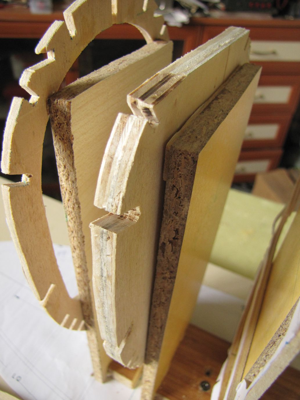

I have built firewall 3*4mm plywood laminate.
The pipe coupling to engine two O-ring and with bed. And draws two spring. No any hard connection.
Do you think, can I still change?

Old 08-25-2013 | 08:14 PM
  #488
Dansy's Avatar
My Feedback: (53)
Posts: 3,001
Received 165 Likes on 147 Posts
From: Prescott, Ont.
Having run the OS 140RX for a number of years (and the YS's).....back in the 2000"ish.....I would definitely soft mount the pipe and the engine....otherwise I don't think the electronics would be happy for very long.
Old 08-25-2013 | 11:00 PM
  #489
mnevzat's Avatar
Joined: Oct 2007
Posts: 13
Messrs, thank you for your valuable comments and suggestions. I'm going to fix soft mount after maiden.
