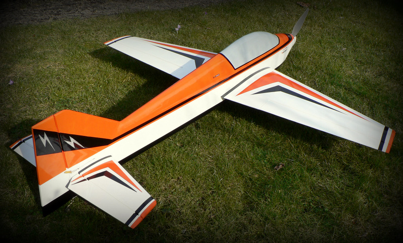

Default RE: Lightning Build
Greetings from Germany
Thank you Jeff for the plans, my plane is ready for flying (when the snow is gone!)
http://www.rc-network.de/forum/showthread.php/301355-Selbstbau-des-F3A-Modells-Lightning-%28Holzklasse-!-%29/page16
Hans

Hans,
Thank you for posting pictures, it turned out great! I hope you get to fly it soon.
Looks great Hans! Getting ready to start mine soon. Already have the foam core for the wings. I was going to change the colors because they have already been done but I really like that color scheme!
A beaver would look good on the tail though
Robert

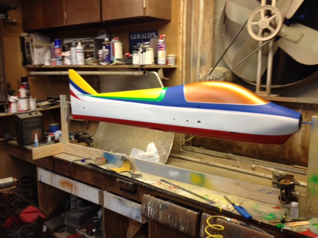

Hey Jeff thank you
Gerald,
That looks awesome. We'll figure out the graphics for it this weekend and get it ready to go. Jeff, do you know what font you have been using on yours?
Arch
Old 04-16-2013 | 06:45 AM
  #449
Viper Driver's Avatar
Joined: Feb 2003
Posts: 397
Received 5 Likes on 5 Posts
From: Archer City, TX
Gerald,
That looks fantastic, I can't wait to see the entire thing.
Arch,
The font I use is called Bellboy.
Good luck with the rest of the project!
