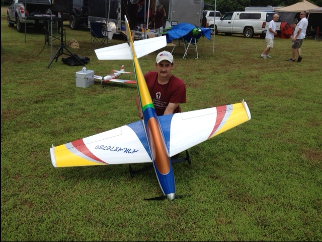

Old 06-30-2013 | 05:43 PM
  #461
Joined: Jul 2008
Posts: 14
From: woodbridge, VA
Default RE: Lightning Build
maiden flight - thanks Jeff flies great

Old 07-02-2013 | 04:21 PM
  #463
Viper Driver's Avatar
Joined: Feb 2003
Posts: 397
Received 5 Likes on 5 Posts
From: Archer City, TX
The new Lightning looks great! I hope it flys well for you for a long time.
