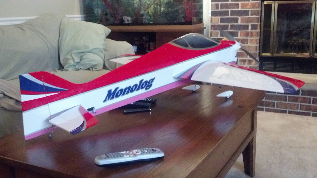

Just finished a ML 400
<a href="http://www.f3aunlimited.com/webstore/index.php?main_page=product_info&amp;cPath=8_70&am p;products_id=595">http://www.f3aunlimited.com/webstore...roducts_id=595
</a>I'm really happy with the results can't wait to fly it.
I'm pretty confident that I have a rockin setup to get er to fly with the authority that's usually missing in these smaller planes.
Notor is a G Force 32 with a Hobbywing Opti 60A esc. Looks like it has a ton of power.
The WS is 47" and length 49".
Now I have to wait for a good day to test.
We've been looking for a small plane that actually simulate a larger model. So far all have been a disappointment.
Fingers crossed. Mike

<span style="font-size: medium">Looks REALLY nice, Mike
</span> -Looks like the canopy is further forward, than on previous versions of the Monolog 400
The GForce G32 (4250-800KV) is 214g, D42 L50 -it will have a 3520 stator
Other same-size 42mm ext diam motors to consider are:
Turnigy SK3 4240-530kv, 14T
Turnigy SK3 4240-620kv, 12T
Turnigy SK3 4240-740kv, 10T -these are all 195g</p>
Also more expensive ones, which are the exact same motor as Turnigy SK3:
Hacker A40-14 S V2, Kv 530, 14T
Hacker A40-12 S V2, Kv 610, 12T
Hacker A40-10 S V2, Kv 750, 10T -these are all 208g</p>
and also the:
O.S. OMA-5010 Kv 810,
this is 234g, has a 4010 stator, and is a 50mm ext diam motor
see: http://www.rcuniverse.com/forum/fb.asp?m=11428699</p>

Thanks Dr Motor for all the suggestions.
It looks better than the earlier versions.BJ Craftmadewith it with 2 options. One is for3D and one for pattern. We only stocked the patternversion.
At $150 it's a real value.
This plane is the first and I have had many of smaller practice planes to give me the feeling I desire.
It flys like a big plane. The motor I put into is is hot!!! Power is amazing on a 4S 3300 30Cpack.
The only thing I didn't like is the canopy attachment spring. I'll put a better latch on it soon.
For now I'm really pleased. Mike Mueller

..and I imagine this bird will make it out to some contests for public viewing?

Yes Joe as long as I stop killing it like I did the other night. Our field is a mess from the winter and the rains and it has not been kind on landings. Oppss!!!!

Mike,
Will this accommodate a 4S TP 3900 ? I have a good supply of batteries, ESC and motors that I use in U/C Electric Stunt that make this an interesting /inexpensive practice aircraft.
Do you feel a Horizon E-32 would suffice in the power department ?

Yes that E-flite 32 would work just fine. The one thing that needs to be said is that these planes fly best when kept light. I wouldn't go any larger on the battery on this size of plane, of course that also depends on the pattern you're flying. As a point of reference I'm flying a 6 lb. plane with about 1200 watts power and I can fly say the AMA Sportsman in under 8 minutes and my 6S 3.3 mAh 40C pak reads approximately 3.8 volts per cell after flight. What has work best for me has be to keep voltage 3.8 volts on the cells after sequence completion.
