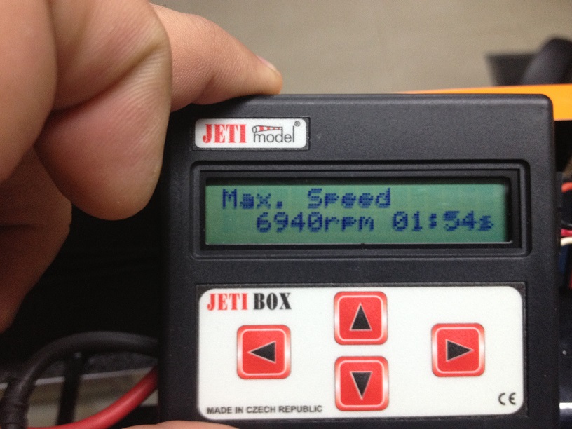

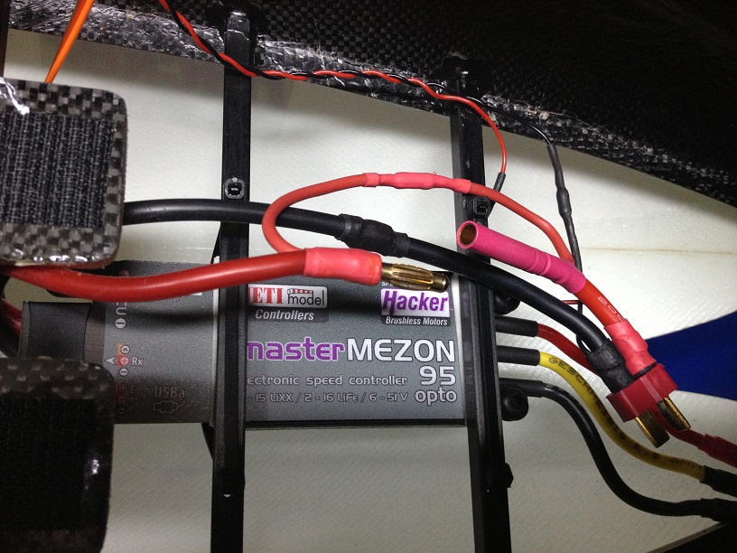

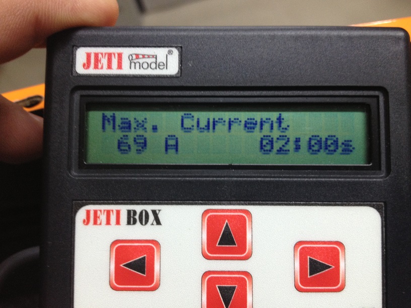

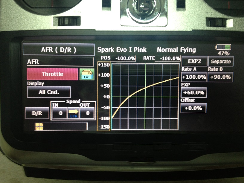

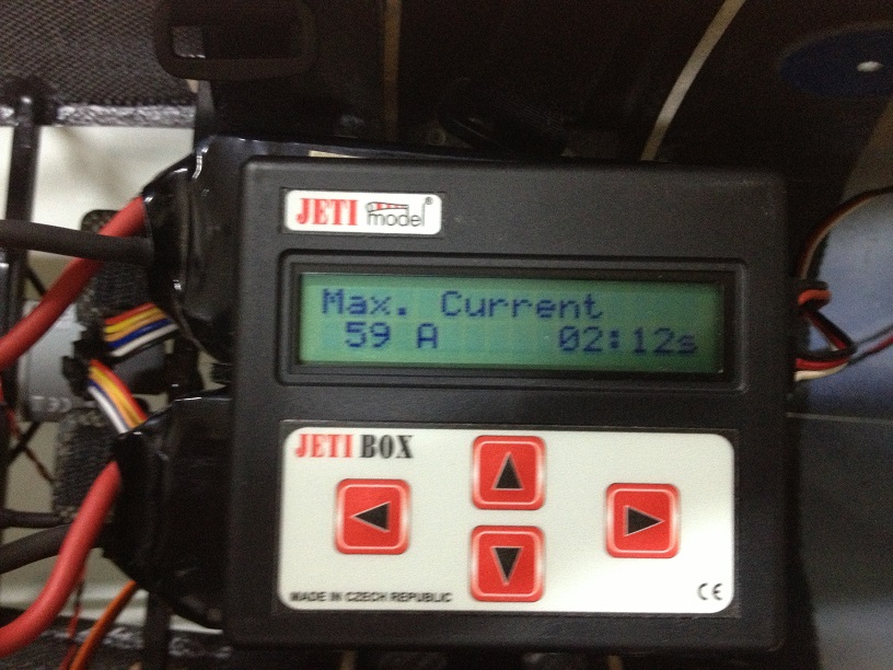

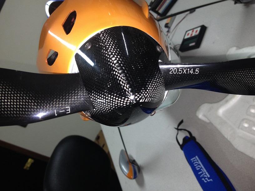

Rune, Brian and Bo:

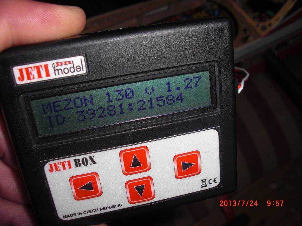

Thank you for your replies. Did a check on the ESC connectors did not find any problems. I tested changing ESC from one airplane to the other and the result was the same. Tested Both ESC with a brand new TP 5400 G8 with 6 break-in flight and manage to get 69A and 59A but RPM the same around 6900rpm on both ESCs.
Bo both of my Master Mezon 95 are with the 1.27 firmware. I used both on my Spark Evo I airplanes with the same prop Falcon V2 20.5x14.5 with the same End Points 100% 100% and same Th curve 100% low side and 90% high side.
That is what´s driving me crazy same exact setup on both but one has more Amps and consume more mAh per flight. []
Here are some pics of the meseurments I did with my Jeti box.
Ney
