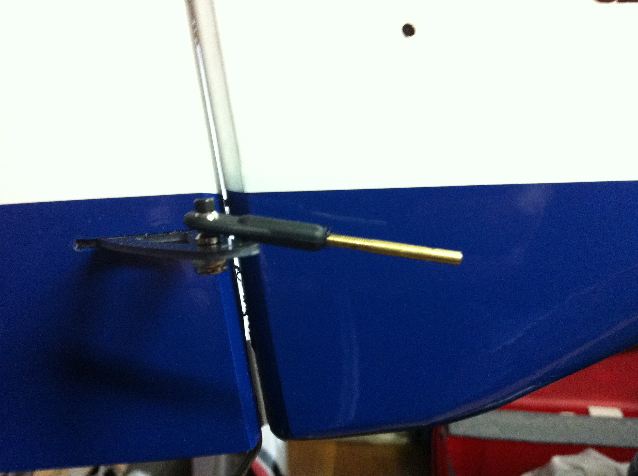

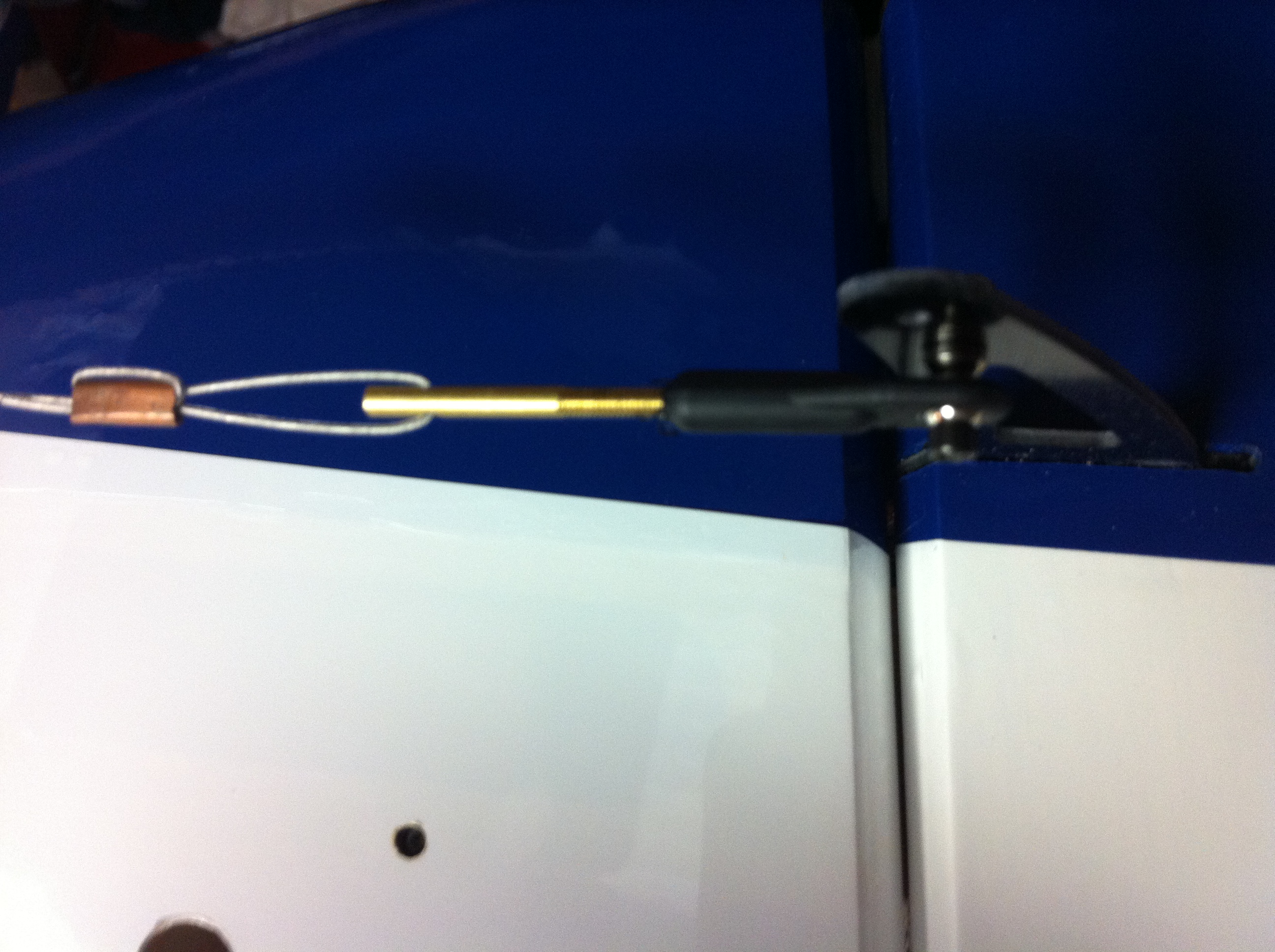

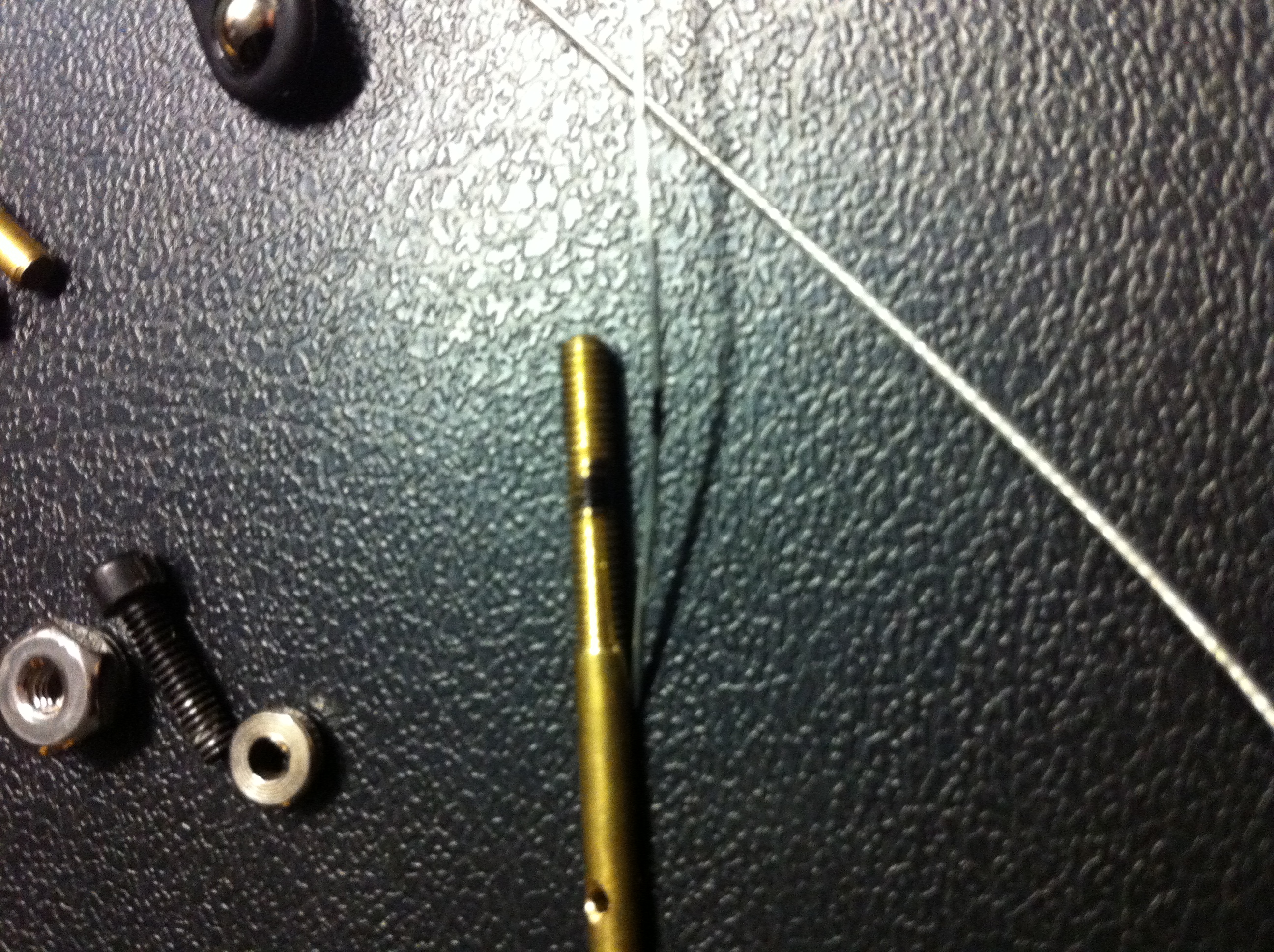

Sorry I've been gone from this project for so long.

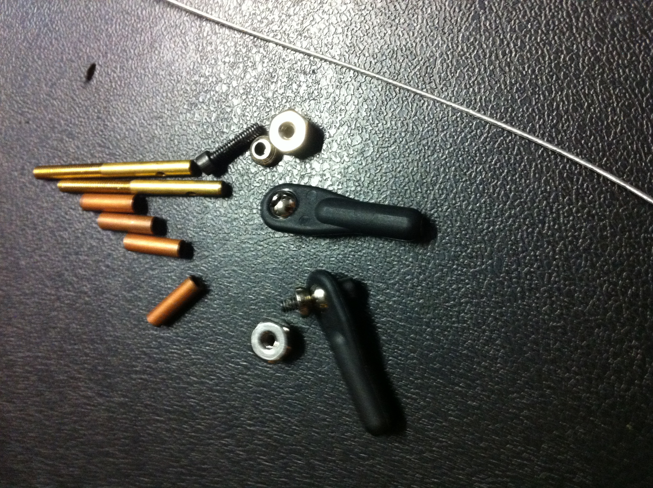

Here's is my process for hooking up the pull-pull.
Gather the parts.
Determine how deep the swivel link is and then mark the threaded couplers for 1/2 of the depth.
Install on to the swivel link and install swivel link on to the rudder horn (same on the servo arm if you choose to use them there).

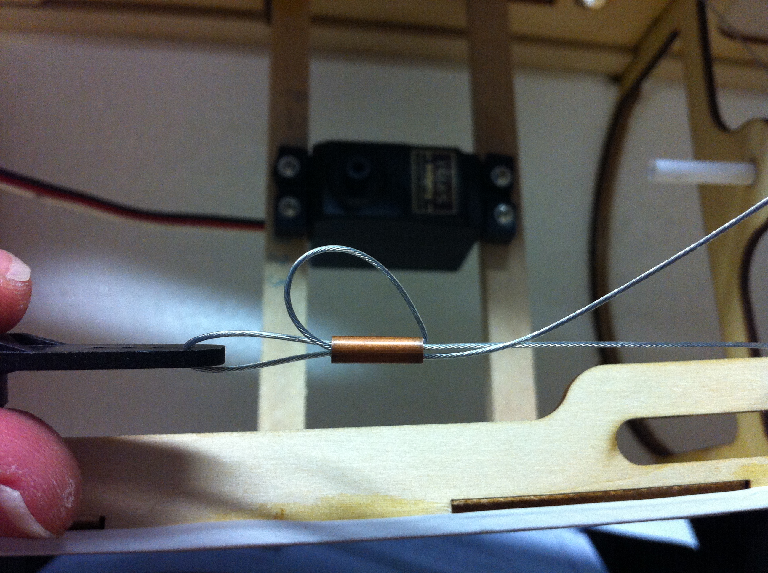

Run a cable up from the back of the fuse, making sure not to wrap it around formers, until you have it up front. I loop it through my servo arm as there is usually enough adjustment with just the rear couplers. Install the brass crimp on the cable. Once I have the correct length needed I pull the cable up through the servo arm hole (outer hole on the Du-Bro arm in this case) and fold it back through the brass crimp.
Then I bend the cable so the crimp can't slide back (about 1/2" to 1" behind the arm).
I loop the wire through the front of the crimp again and this essentially locks it in place.
Pull the cable tight.
Once you are happy with it all, squeeze the crimp with pliers until the crimp is flat.
Repeat for the other cable.
Once you have the servo side completed, repeat for the rudder horn side. Just remember to double check to make sure you have it set at the right length, power it up (or leave it powered on), before crimping the rudder crimps.
With the horn modification (relocating the rudder horn holes) I do NOT get full rudder throw, even with the servo end-points bumped up to 140%. ONLY do this if you don't use a lot of rudder. After I fly it I will report back if I have to change to a larger servo arm to get the last bit or rudder travel.

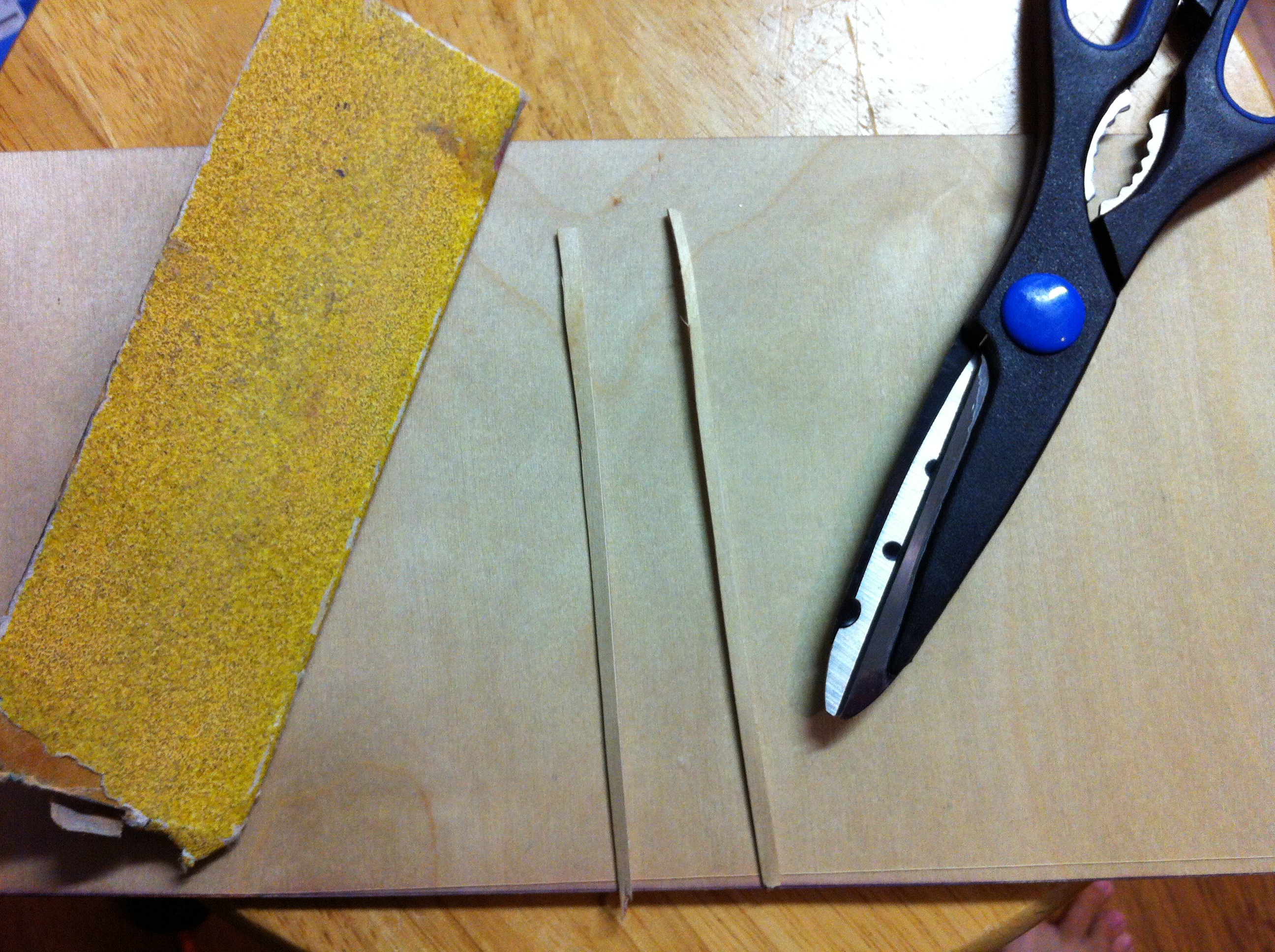

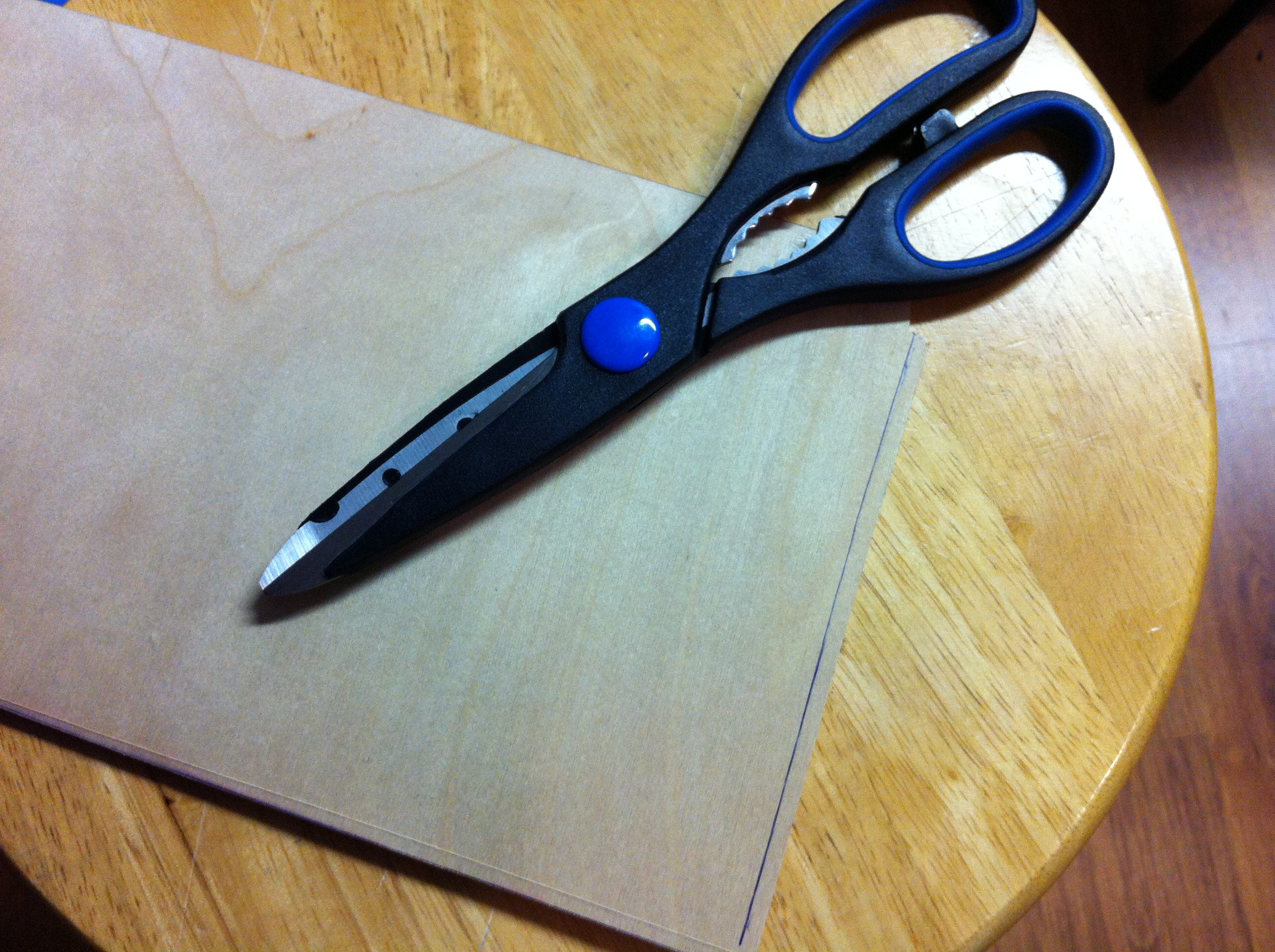

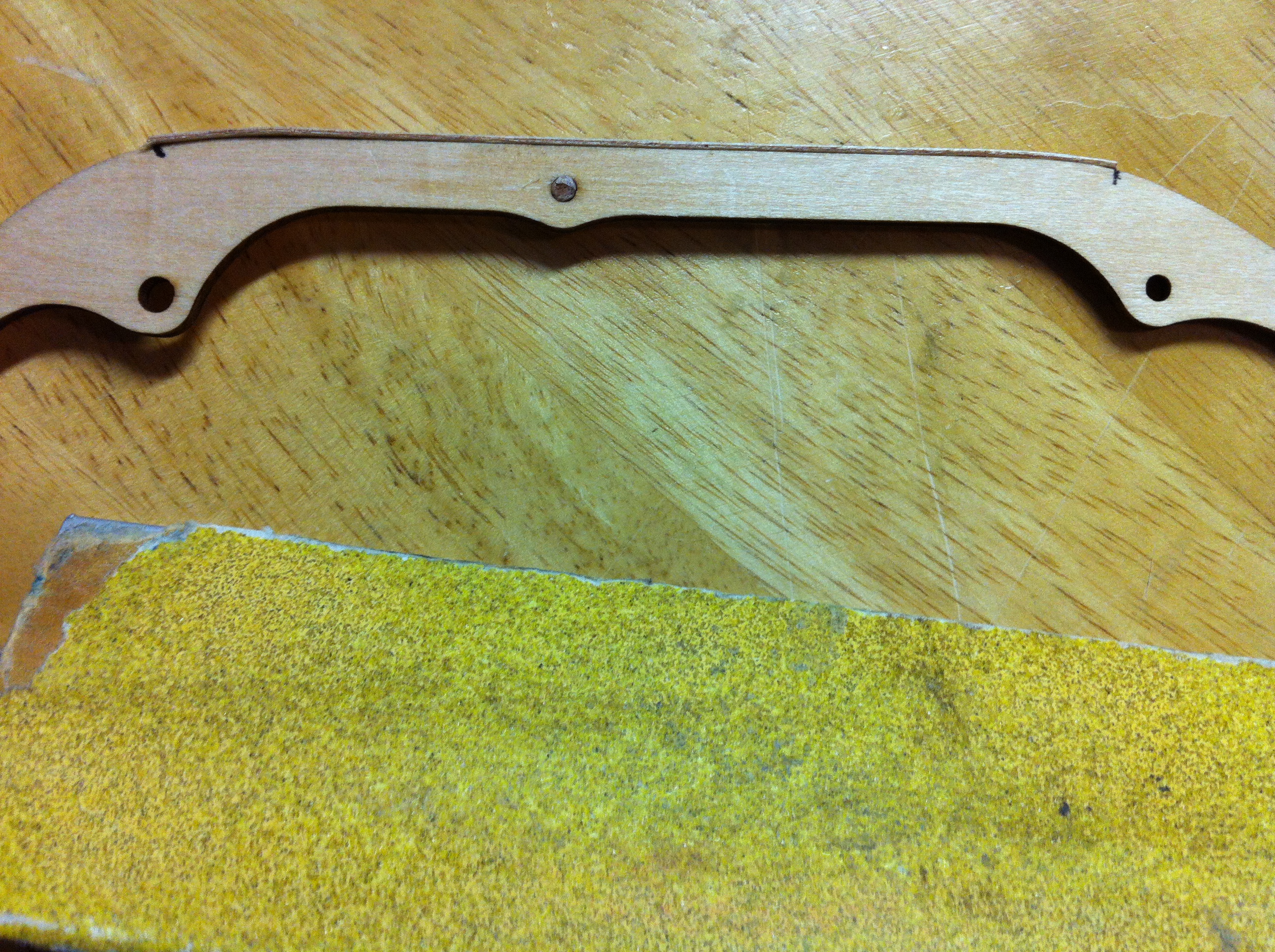

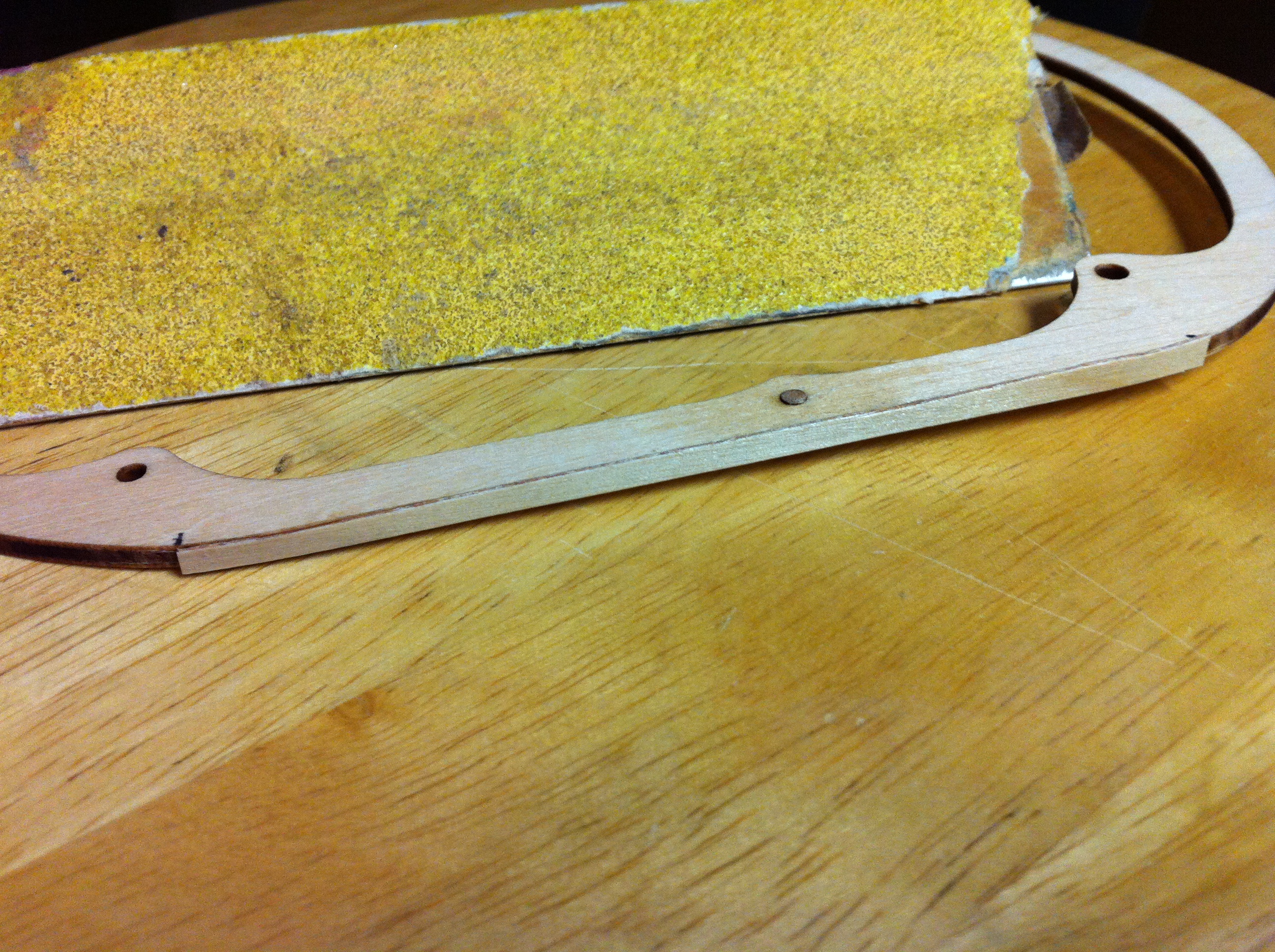

My cowl ring was 1/32" short on the sides. Here's what i did to fix this.
I marked where the ring was short so I knew where to add wood to.
I marked some 1/32" plywood for what I needed.
Then I cut the strips (any way you want to cut it, scissors was my way).
Using some Medium Zap, I glued them on between the marks.
Then i finished it with a final sanding to fit the fuse.

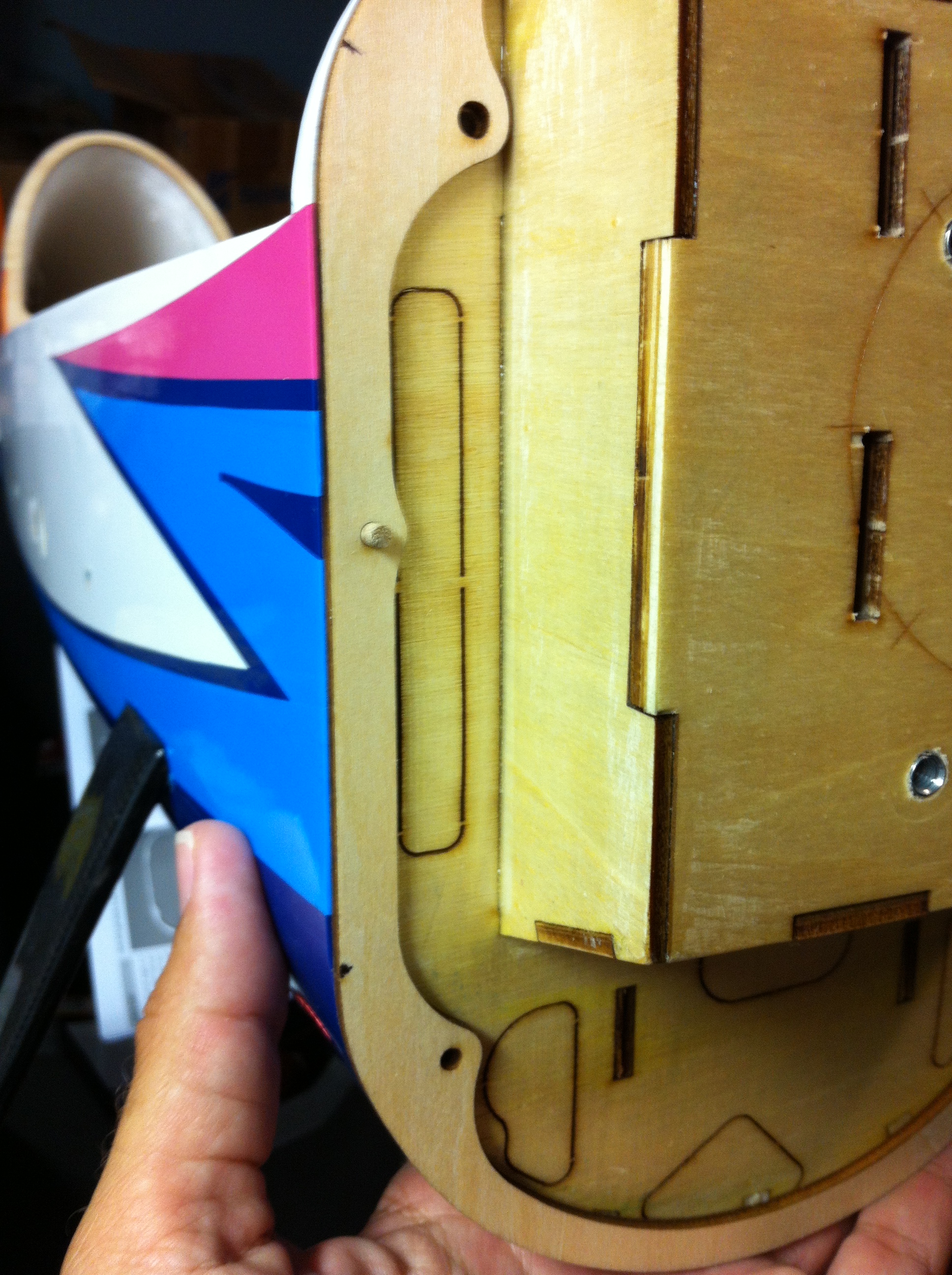

Next is motor mounting. I am spacing it out a bit so the cowling fits 'better'. I'll explain once it's done.

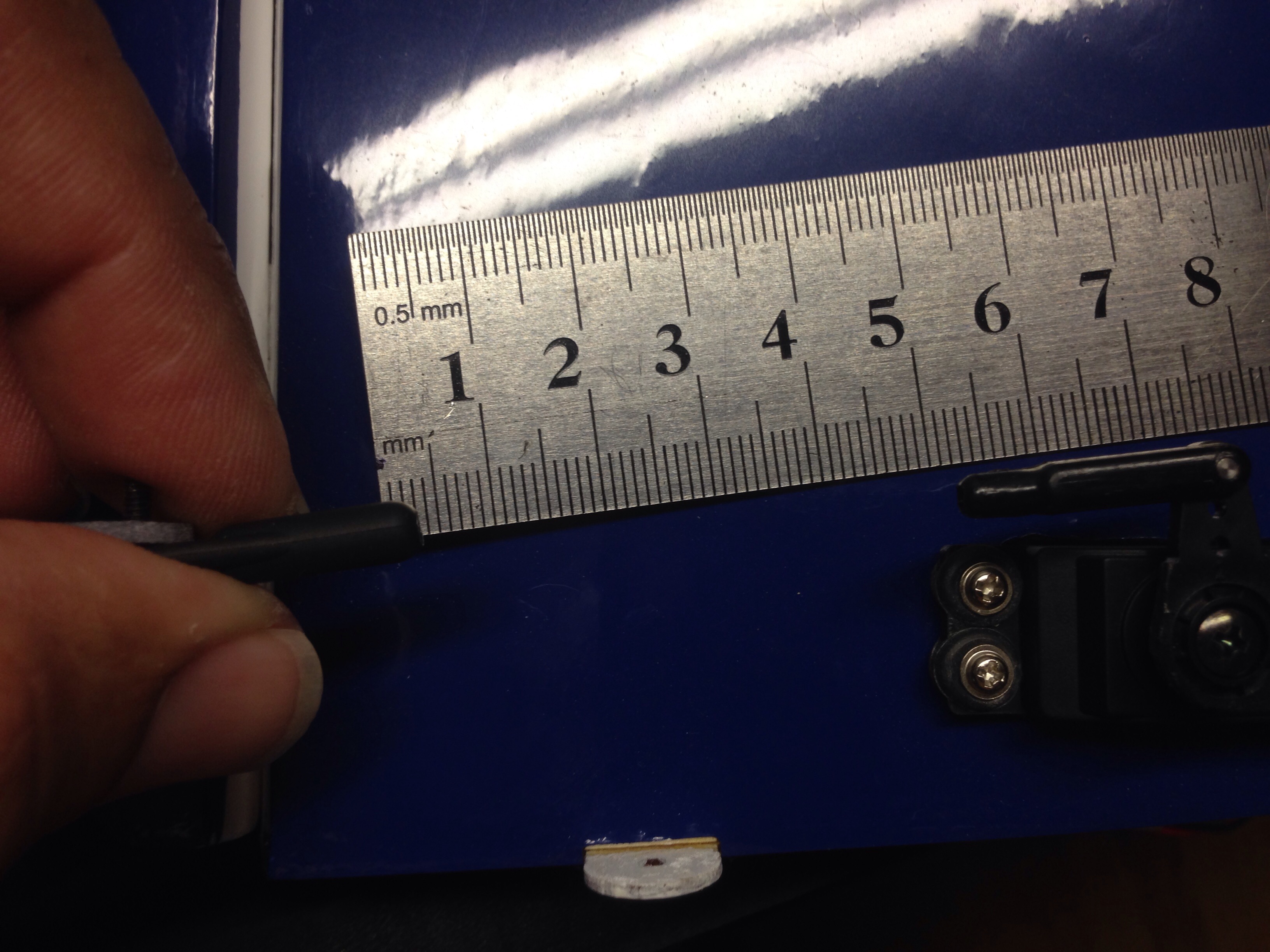

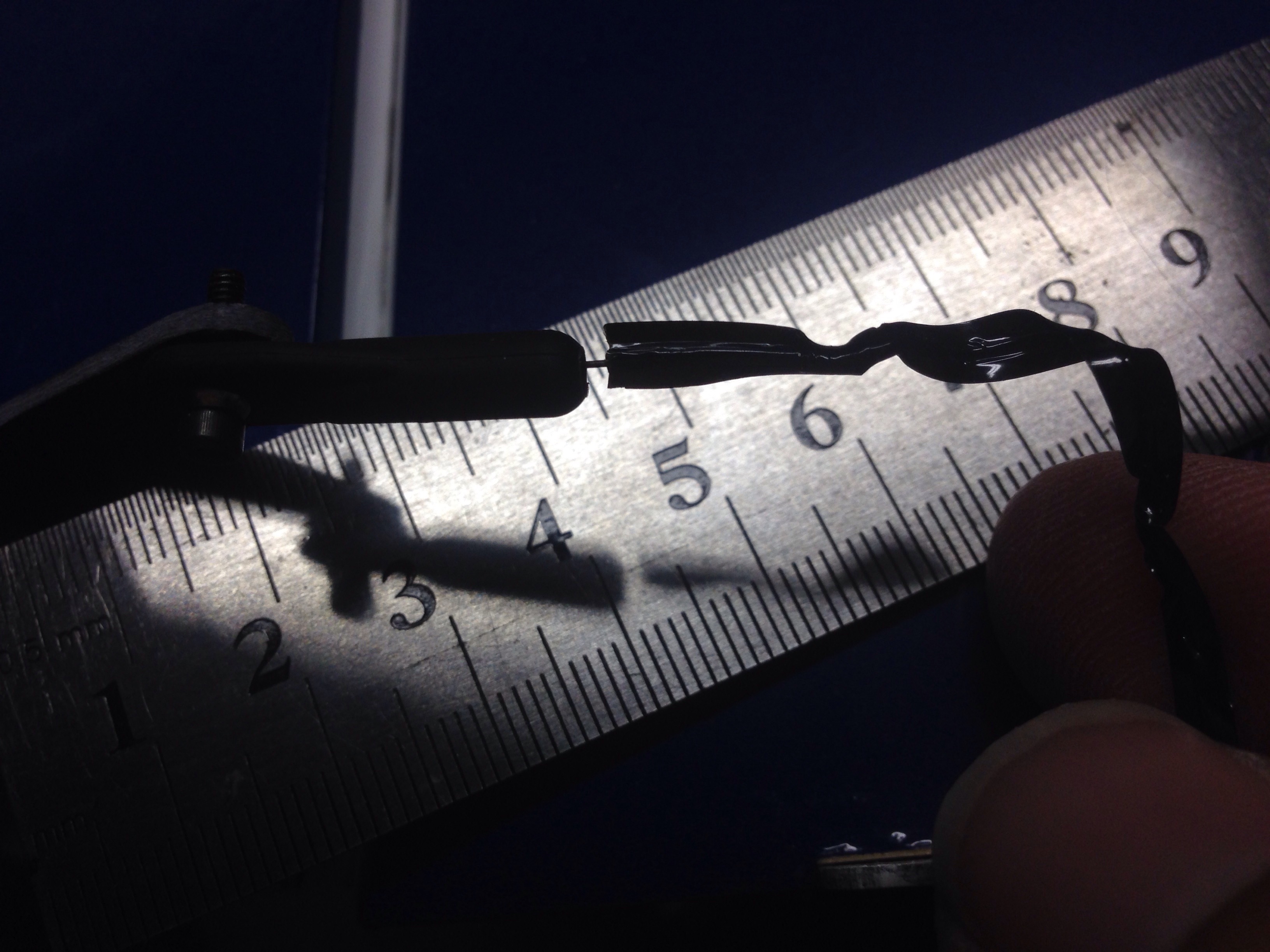

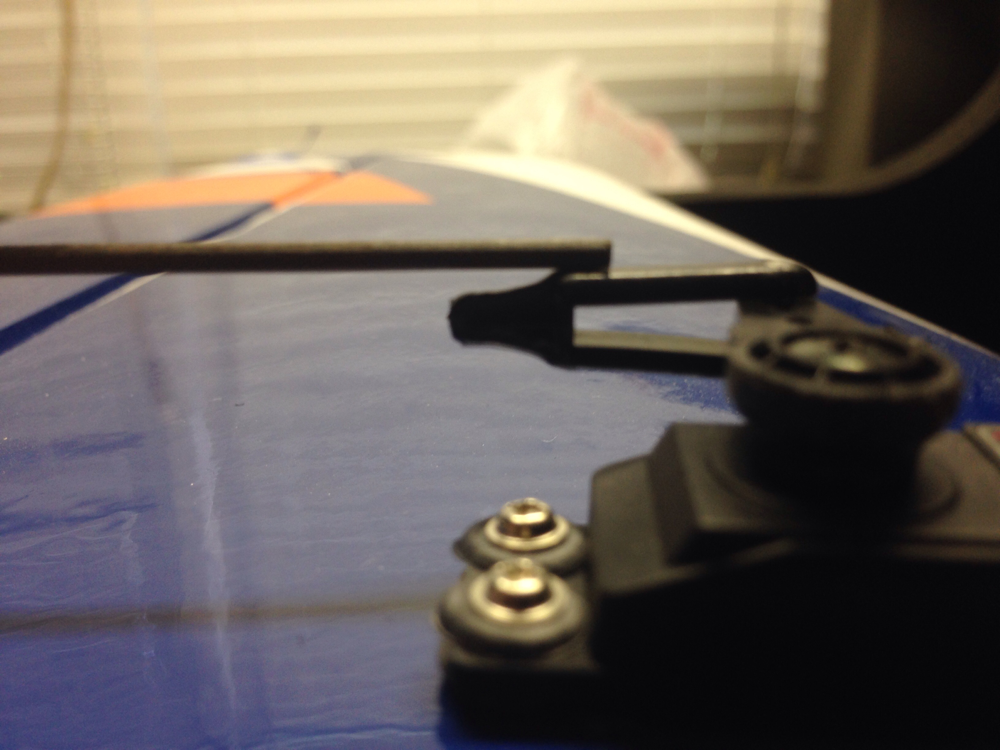

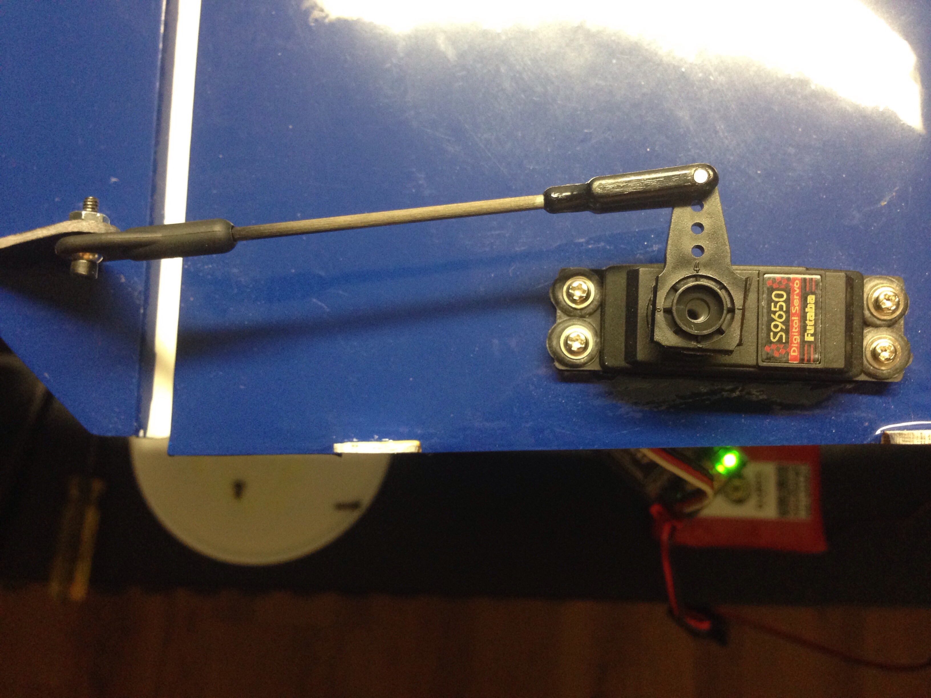

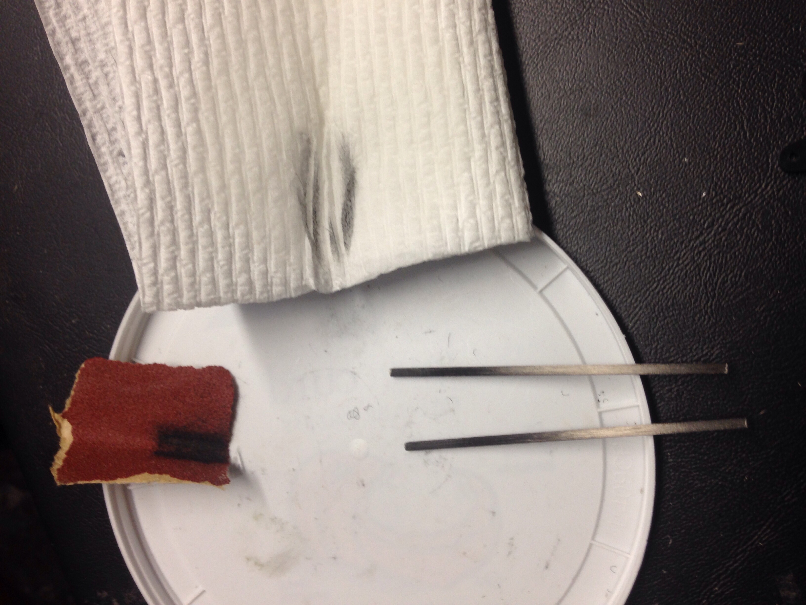

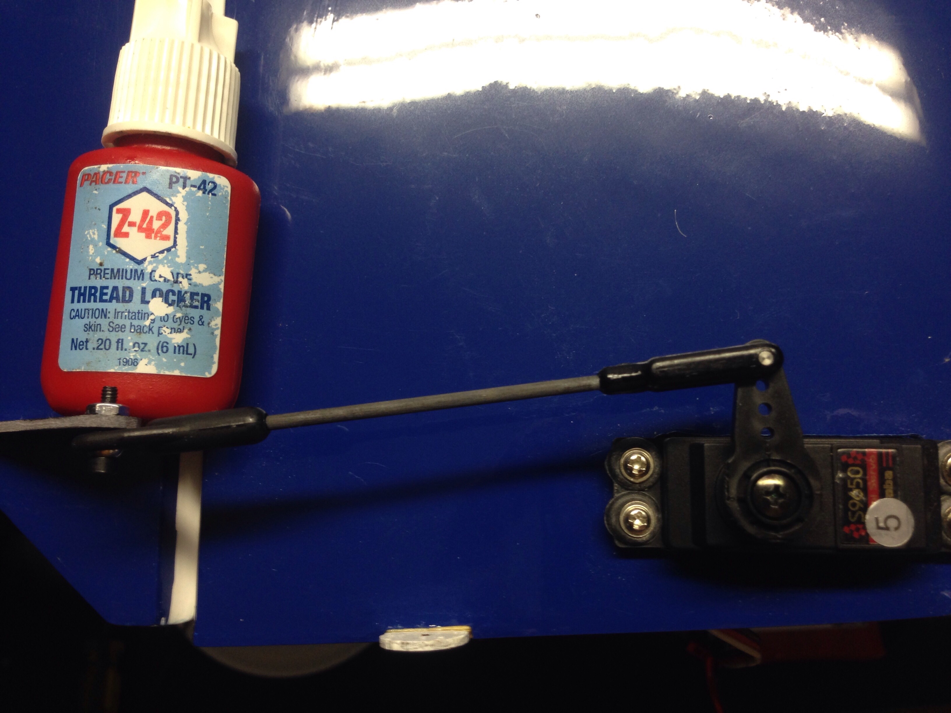

Elevator pushrods
I checked and its 12/13mm to the end of the inside of the swivel link.
With the link and clevis in place I measure for the correct length. I make sure there is a few mm of rod that goes past the end of the clevis opening (see pic a few down).
After measured to the proper length, roll-cut with a new razor blade.
Sanded (while spinning) and cleaned with alcohol on a paper towel.
Marked 12mm with silver Sharpie. Swivel links and clevis' were predrilled earlier.
This is a tricky part. Since the carbon rod doesn't just slide into the redrilled hole, you have to 'tap' it in. I use a small hammer or pliers/side cutters, but make sure you don't just smash it in to the link. You could splinter the carbon rod and ruin the link and have to drill out the carbon and start over. Tap in, while pushing down against the bench/link until it reaches your mark.
Just a double check after screwed back on to the horn (with nut if loose).
Silver Sharpie to mark how far to go.
DO NOT RUSH THIS PART!!! I pushed on the clevis a little at a time (make sure it's the correct orientation to snap on to the servo arm and horn) and check length (with nut on horn side) and powered up. Adjust until happy with placement.
* also notice, I changed from the 6-star (3-hole) to 4-star (4-hole) servo arms for more throw, personal taste on high rate.
Once I was happy with everything I used SMALL drops of thin (2 usually) and let it 'soak in' to the link so it went into the link (vertical). MAKE SURE NO CA GETS INTO LINK BALL OR CLEVIS PIN!!! Repeat 2 more times. Do the same on the clevis side. Don't use accelerator either.
Once the glue is dry (takes longer than you think) you can mount up your pushrod and blue thread lock the swivel link nut.
All done
