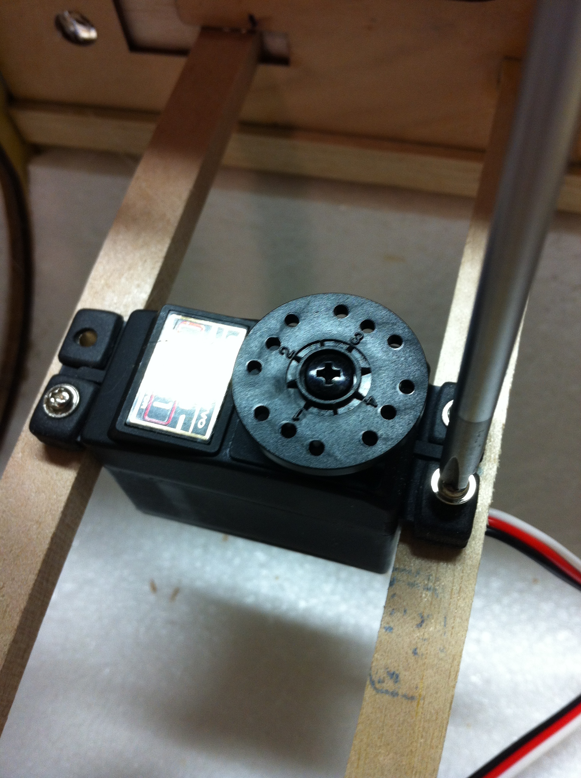

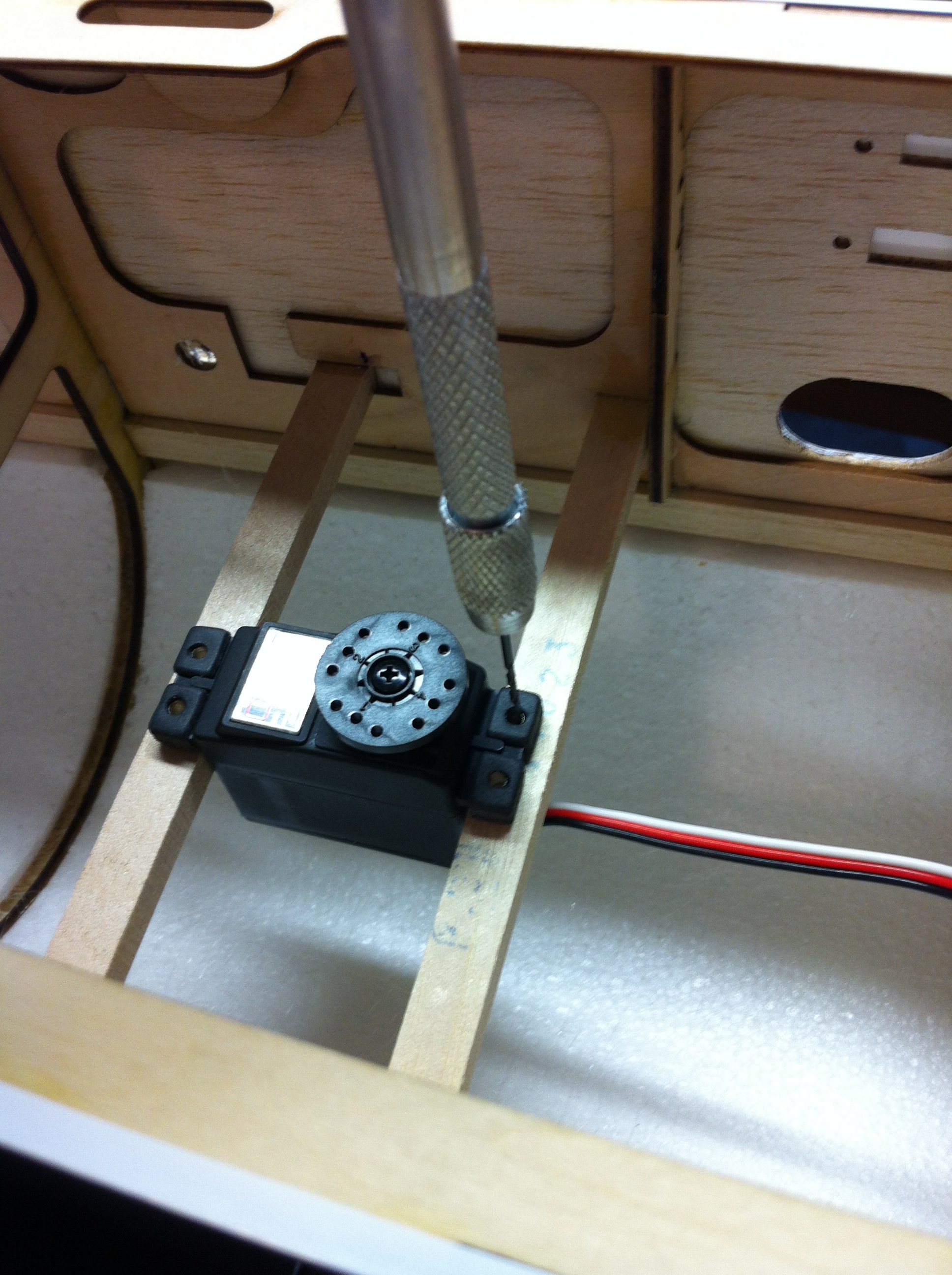

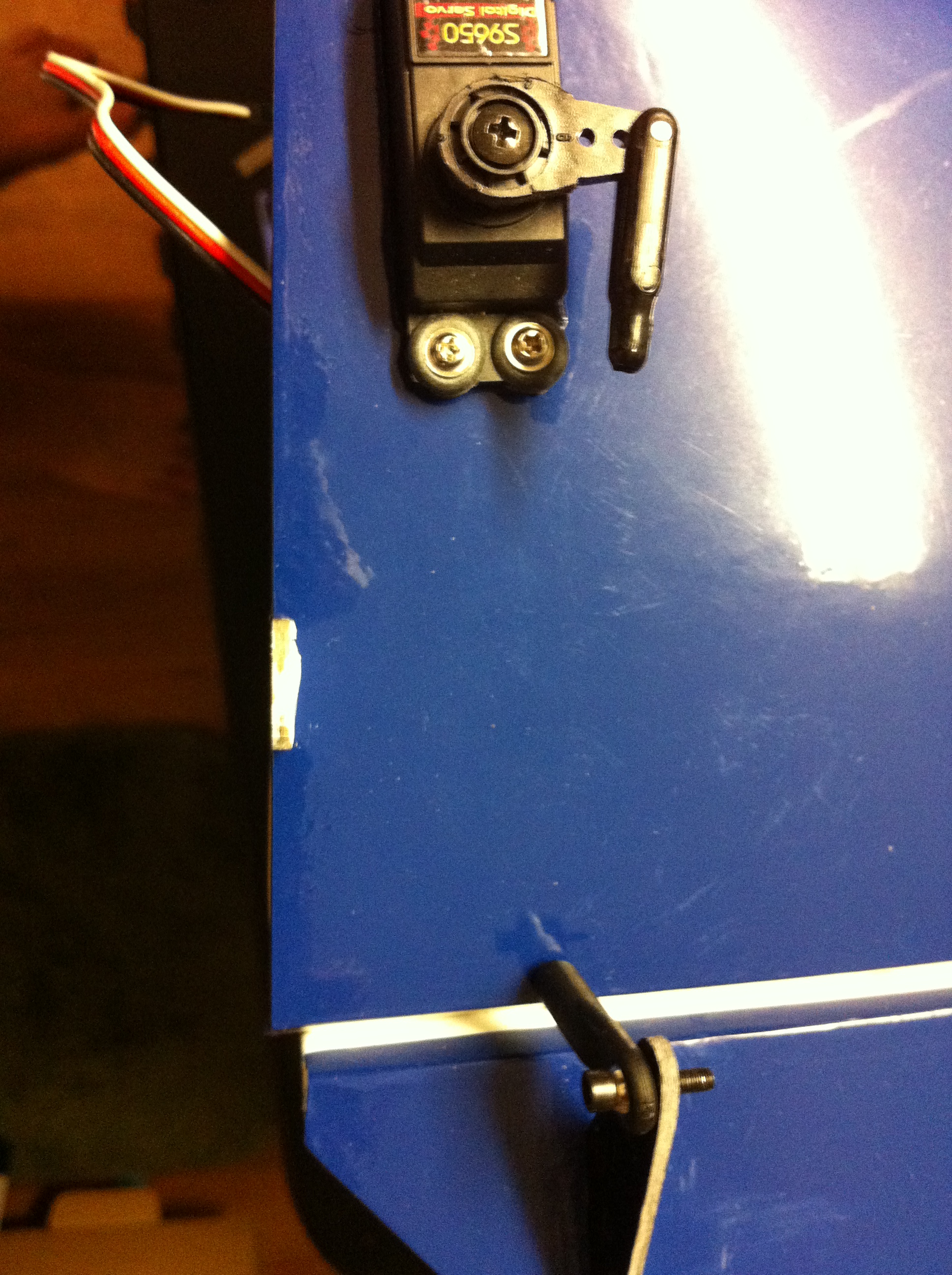

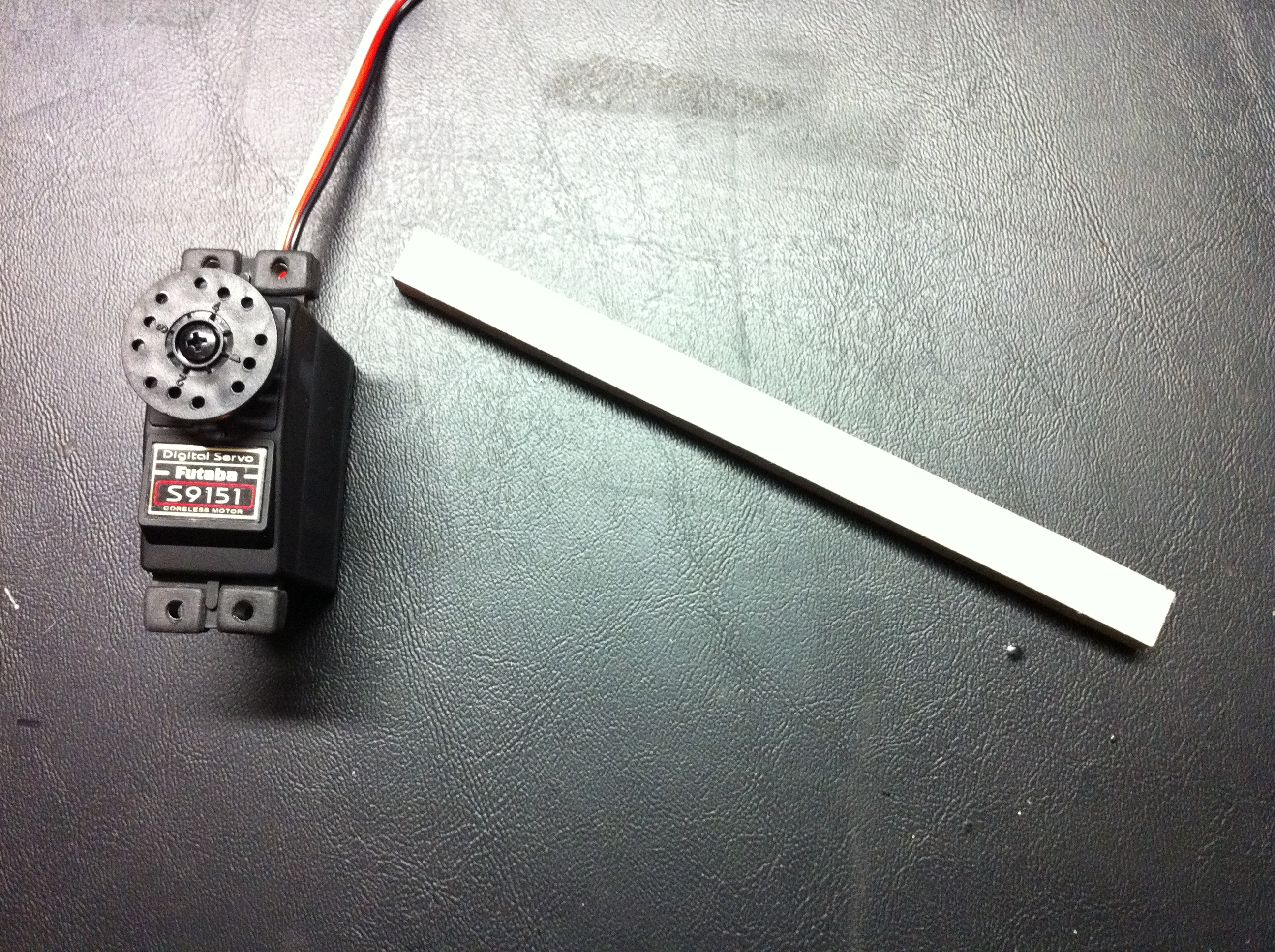

Rudder servo mounting
Measure the servo to know where to position the rail.
After measuring the servo, I marked the rail guides so I knew where to mount the rail.
A generous squeeze of the Medium CA and let it dry.
I marked the rails with the pen drill using a #55/.052 drill bit, but used a cordless drill to get through the hard wood rails.
Once drilled, screw down the servo. Remember to put the brass eyelets in from the bottom of the servo grommets.

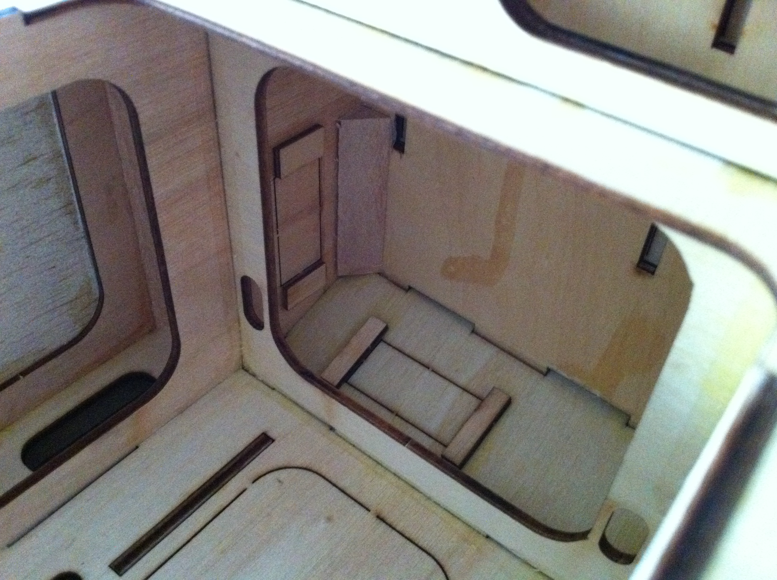

I was noticing all the cut-outs in the fuselage this morning for different switches and external safety plugs.
As well as the 2 spots for throttle servos for the glow set-ups. They'll make good lightning holes.
And removing the tabs for the elevator servos. Make sure not to cut the servo wires (I didn't do it... this time).

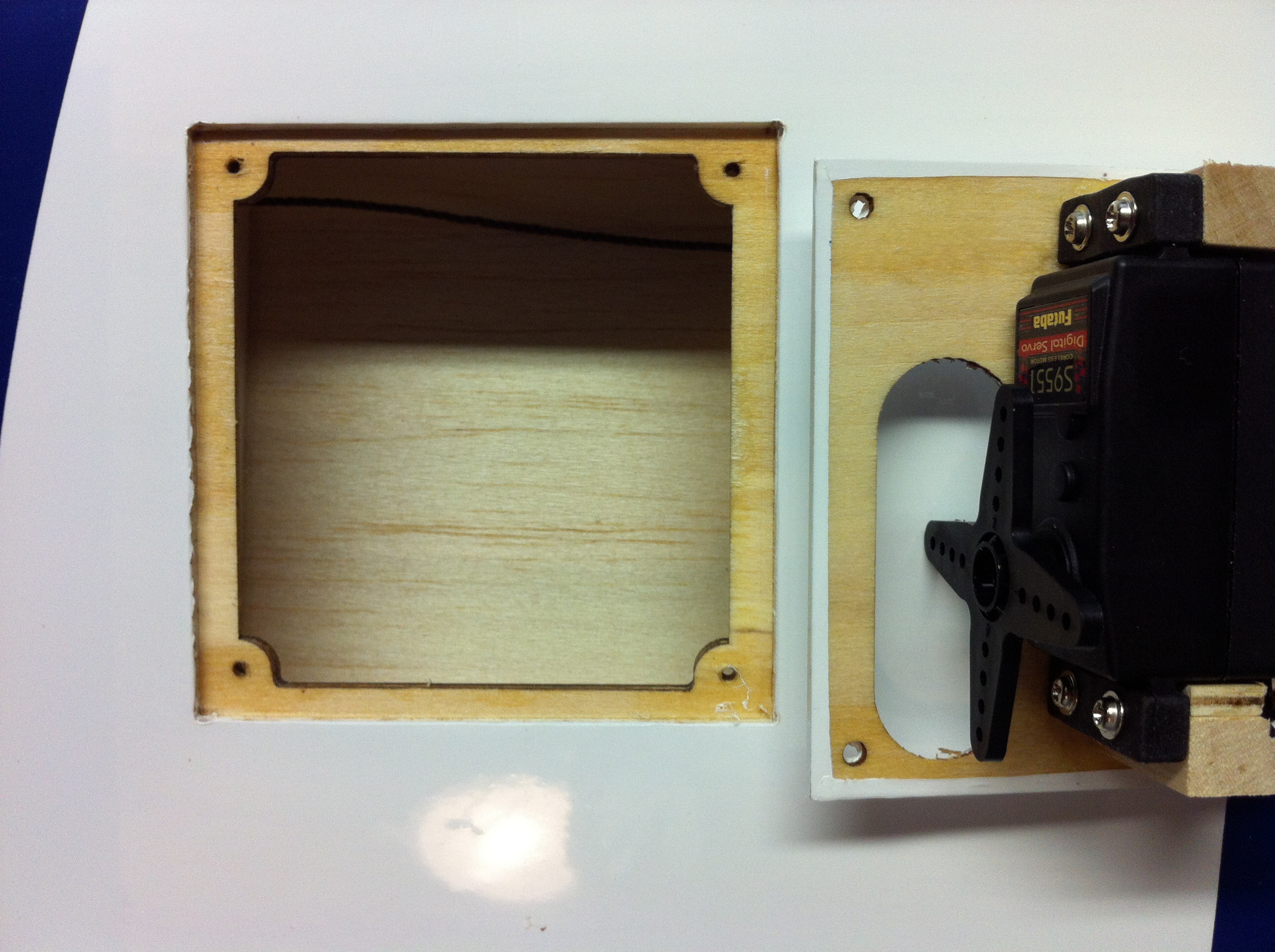

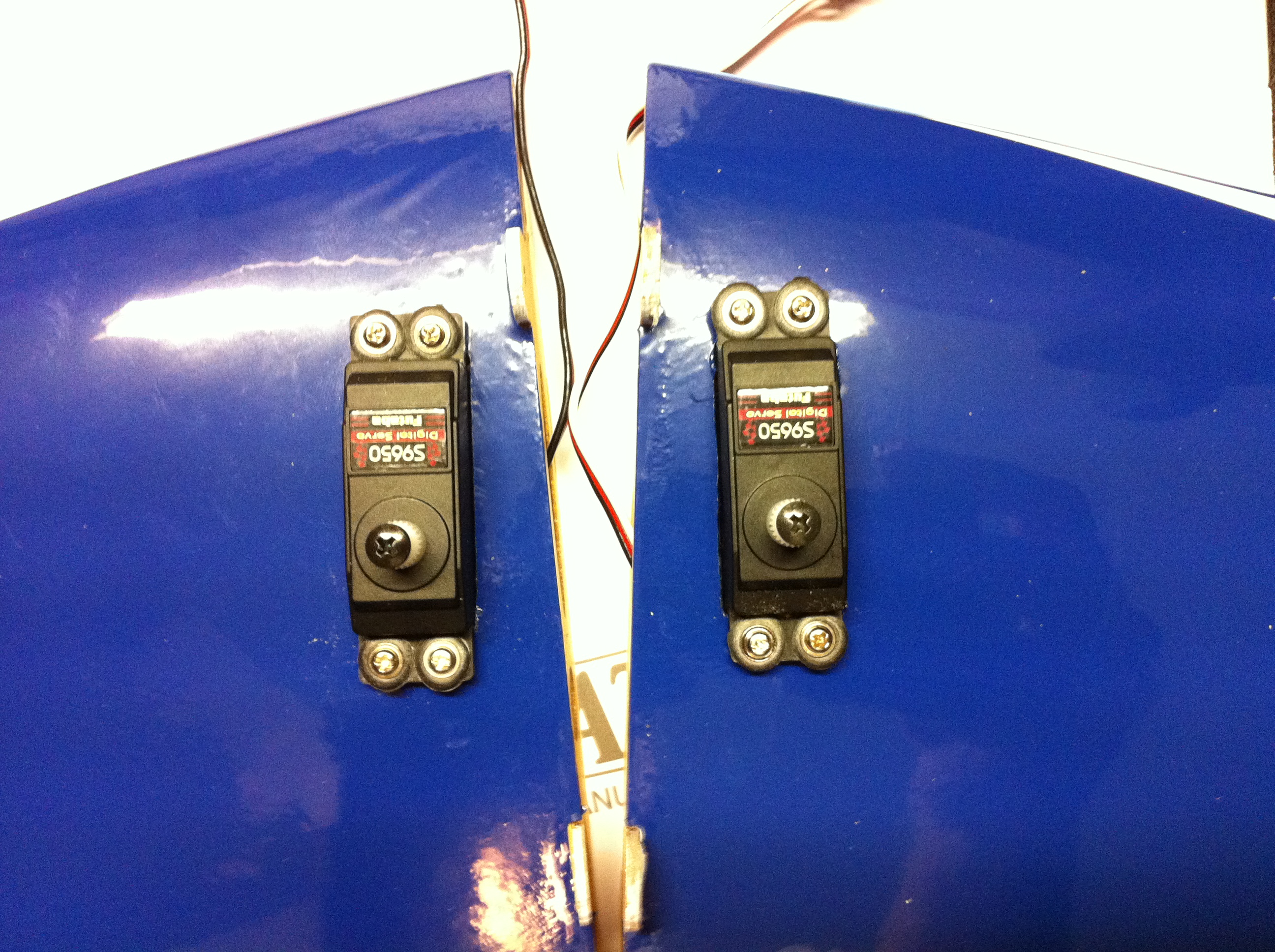

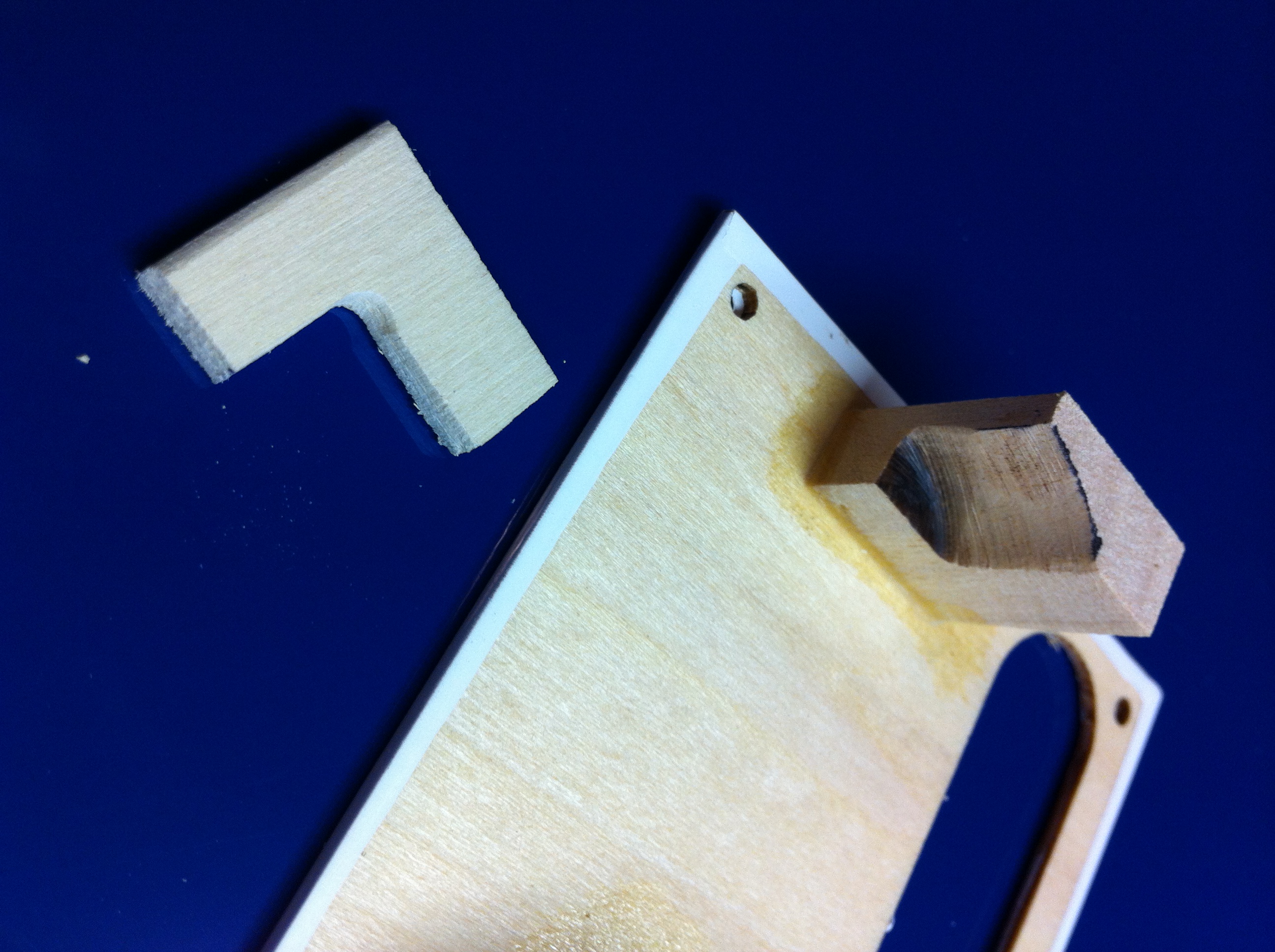

Aileron servos. This took a little bit more work, but nothing major.
First thing I did was reverse the covers. This allows for a shorter pushrod.
Then, seeing as there was a wider gap than I am comfortable with for the servo blocks...
I took some scrap 1/8 Lite-Ply and made a filler plate for a block on each cover.
The 9551 servo is a low-profile servo, so the wire was inline with the block. I marked the block to remove some of it.
Using a large sanding drum, I removed the material.
I matched the cutout to the lite-ply and cut it to shape.
Once sanded to fit, I used Medium Zap and a clamp until it dried.
Side note: I have seen this a few times on some planes, even pattern planes. The brass grommets go in from the bottom of the servo so it acts as a stop for the servo screw. If installed from the top it will just dig into the wood until the screw is 'crushed' down to the servo tab.

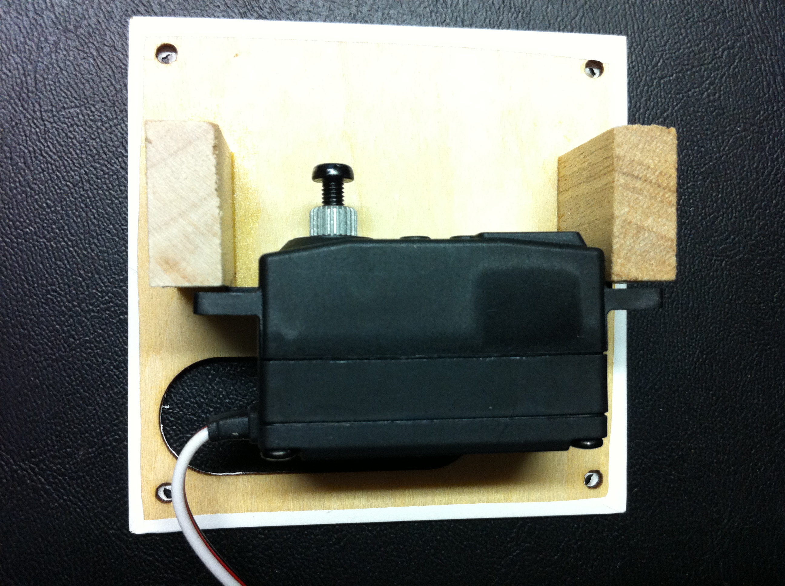

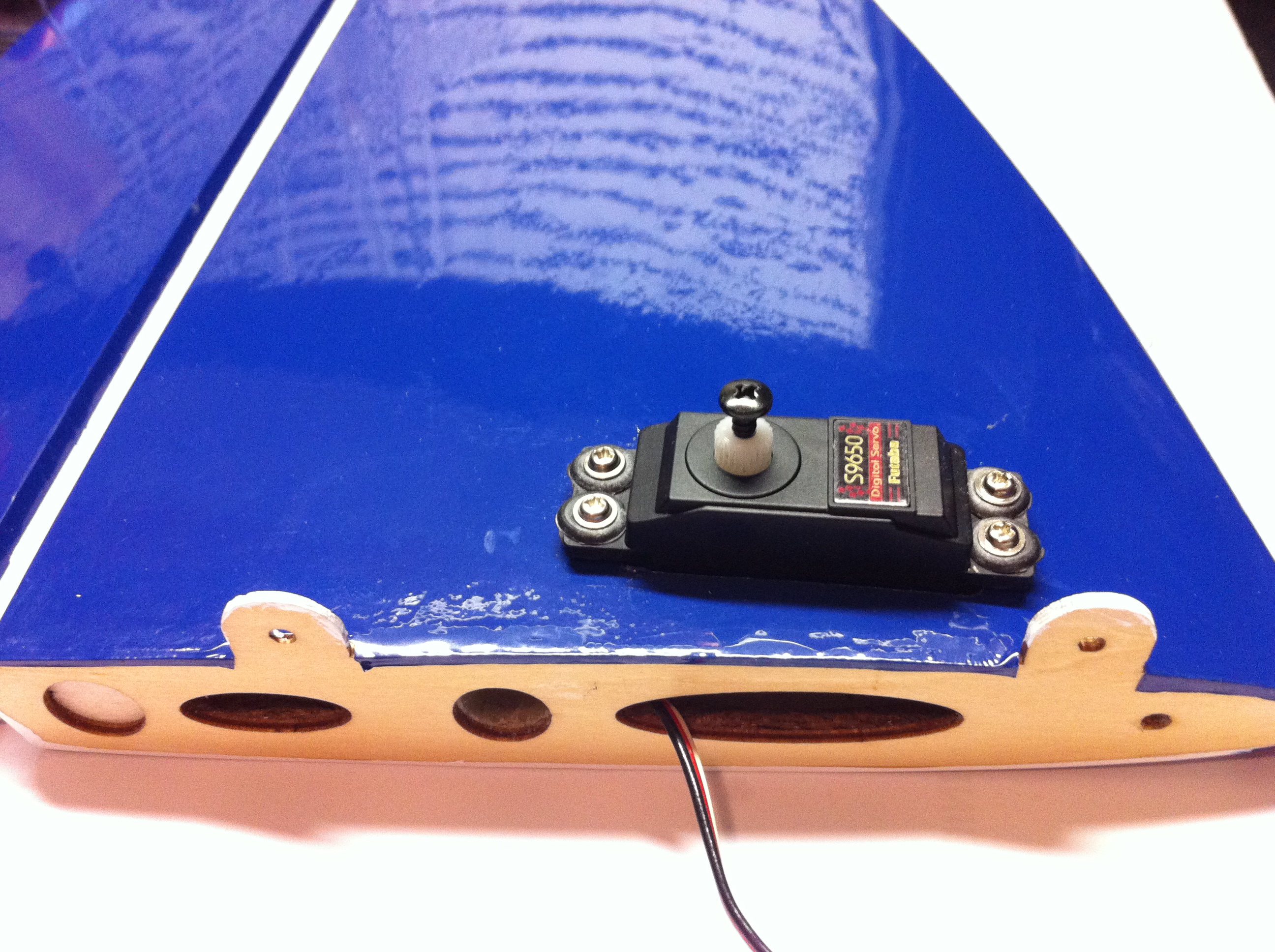

Next I marked the holes for the servo screws. Again using the #55/.052 drill bit.
And there's always one that's off. Thankfully I didn't drill it when I saw it that far off.
I drilled the ones with the plates at an angle so the screw would go more into the block of wood rather than at the joint of the 2 pieces.
Screwed in.
I used the supplies button head screws and 'pretapped' the hatch plate holes. MAKE SURE to use a machined end (not ball end) .050 wrench. I also put the screw on the wrench before screwing them in (they actually pop on the wrench).
Once all the holes have threads, I use Thin Zap to harden the threads and harden the holes in the cover plates.
Aileron servo leads are next.
I'm not a fan of heatshrinking my leads, so I use masking tape instead. I wrap it around at an angle so the plug can't just come out.

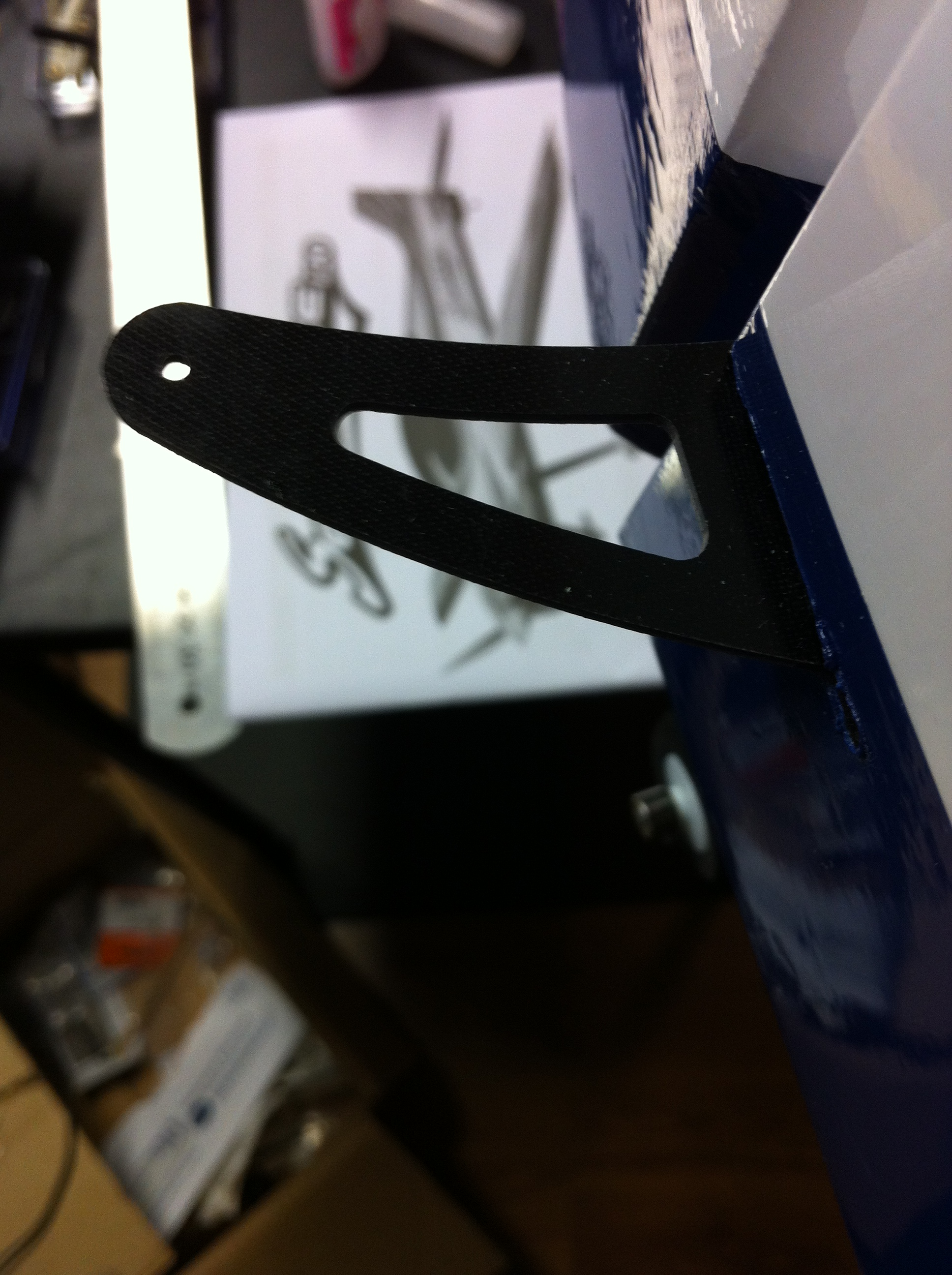

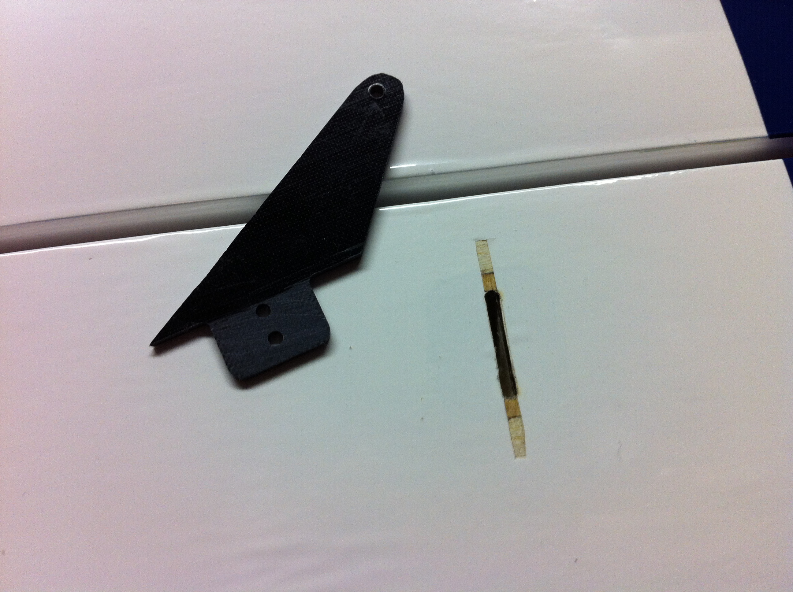

Control horns are pretty straight forward. Same as the instruction manual.
Since I was using the inner most holes I removed the outer holes. I think this actually saved a gram as well.
I used the horns as the templet and cut (new blade) the covering and removed it so the horn can be glued to the wood.
Scuffed all the horns where they would be inserted into the surfaces.
Same thing on the stabs.
Once the horns and surfaces were ready and everything was test fit, I used Medium Zap and covered the tabs and slid them in. Make sure to carefully clean up and CA that comes up from the horns.

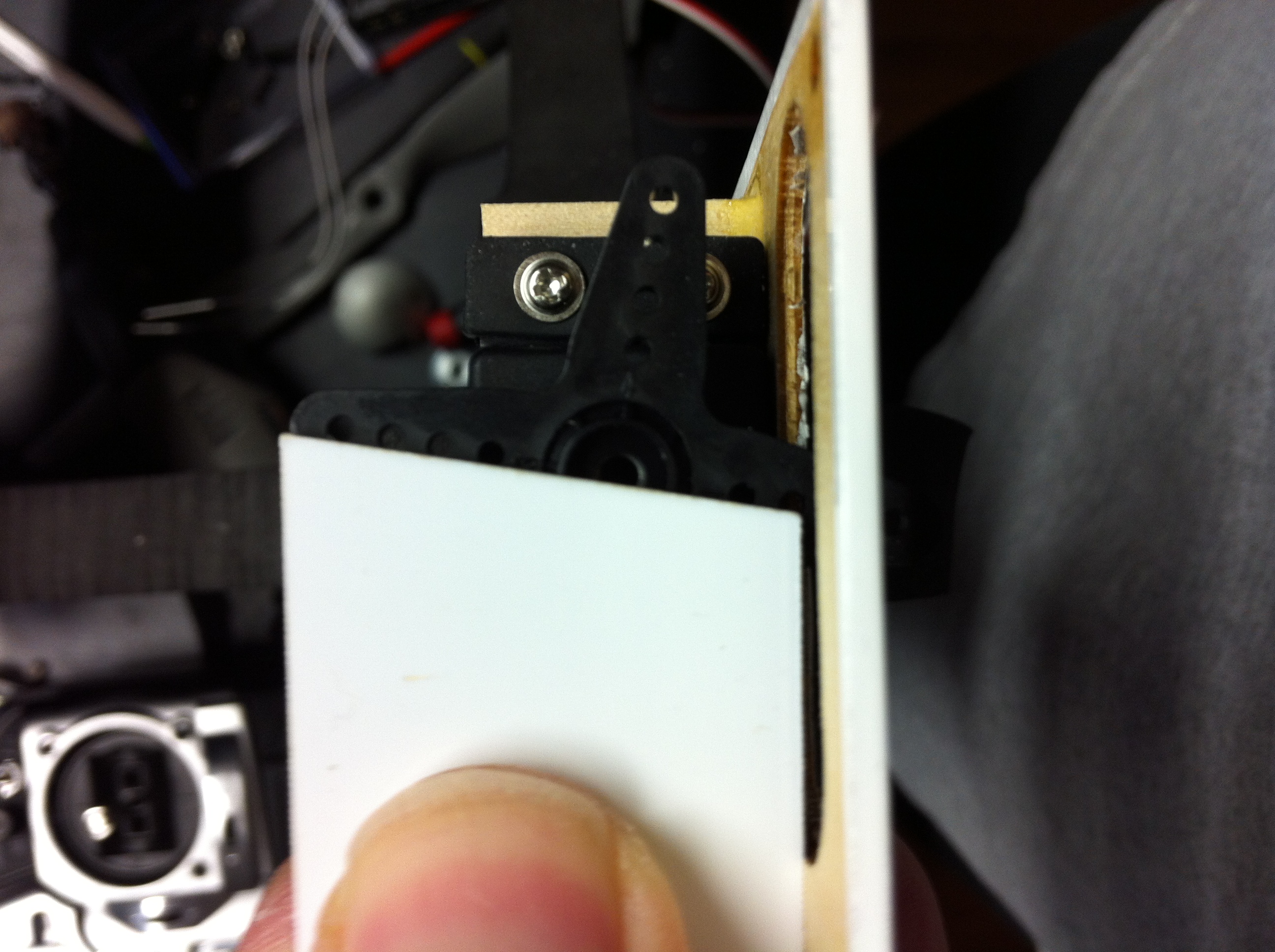

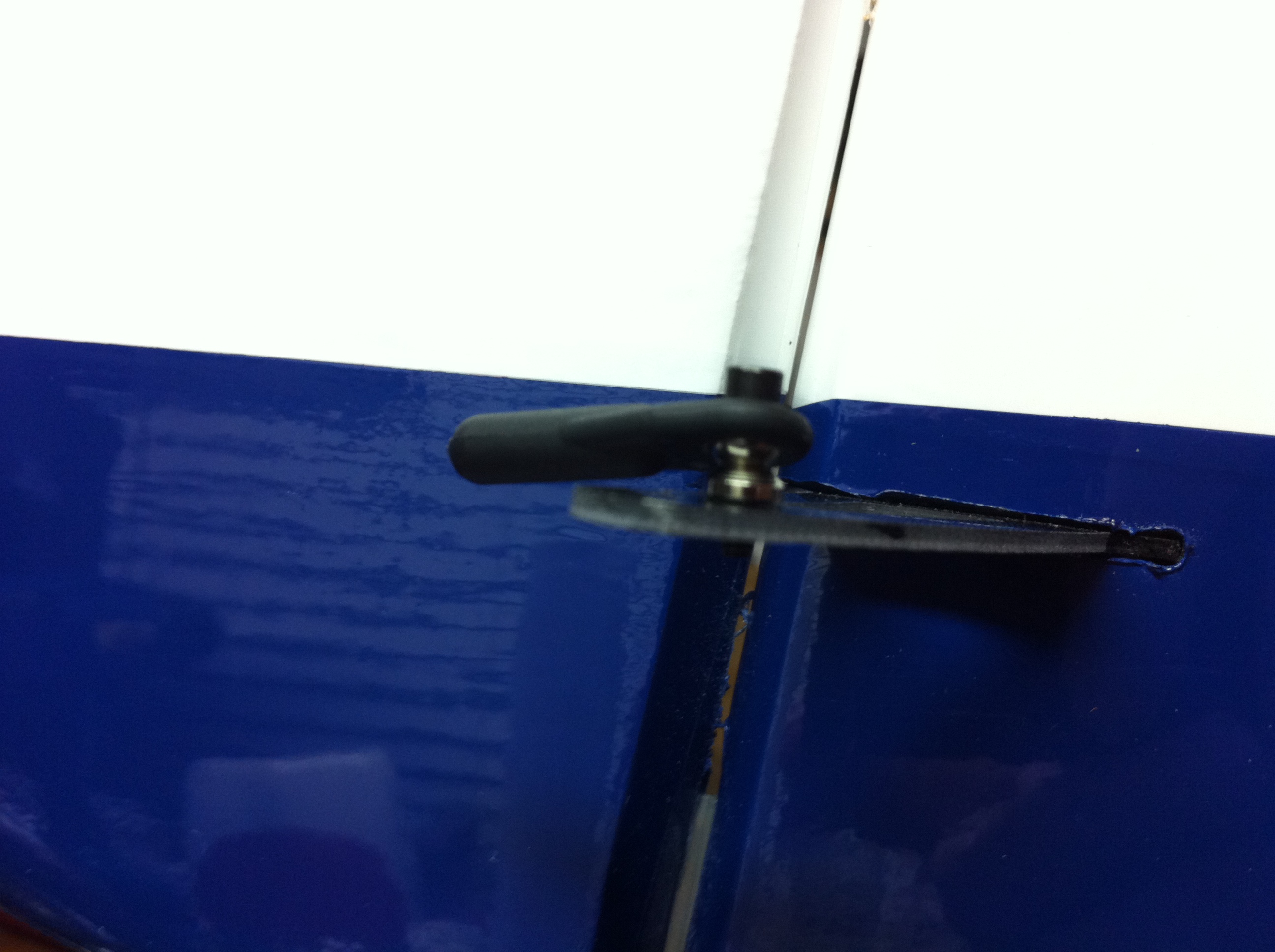

Now I aligned the servo arms (radio on). Using the plastic jig I lined up the aileron servo arms.
Then trimmed off the extra arms.
This is how I align my stab servo arms. Slide the stabs on the tube and push them together. With the radio on, rotate the arms until they line up with the ruler from one side to the other. Now you know the servo arms are starting straight to each other. You do not need any sub-trim to do this.
Once you have them aligned, remove the extra arms.
Just for fun I put the links on. Pushrods will be made later.
Yes the elevator pushrods will be at an angle when at neutral. Once the servo moves, the pushrod will become straighter, providing more leverage over a pushrod that starts straight then goes out as the servo rotates. At least that's how it works when I think of it.

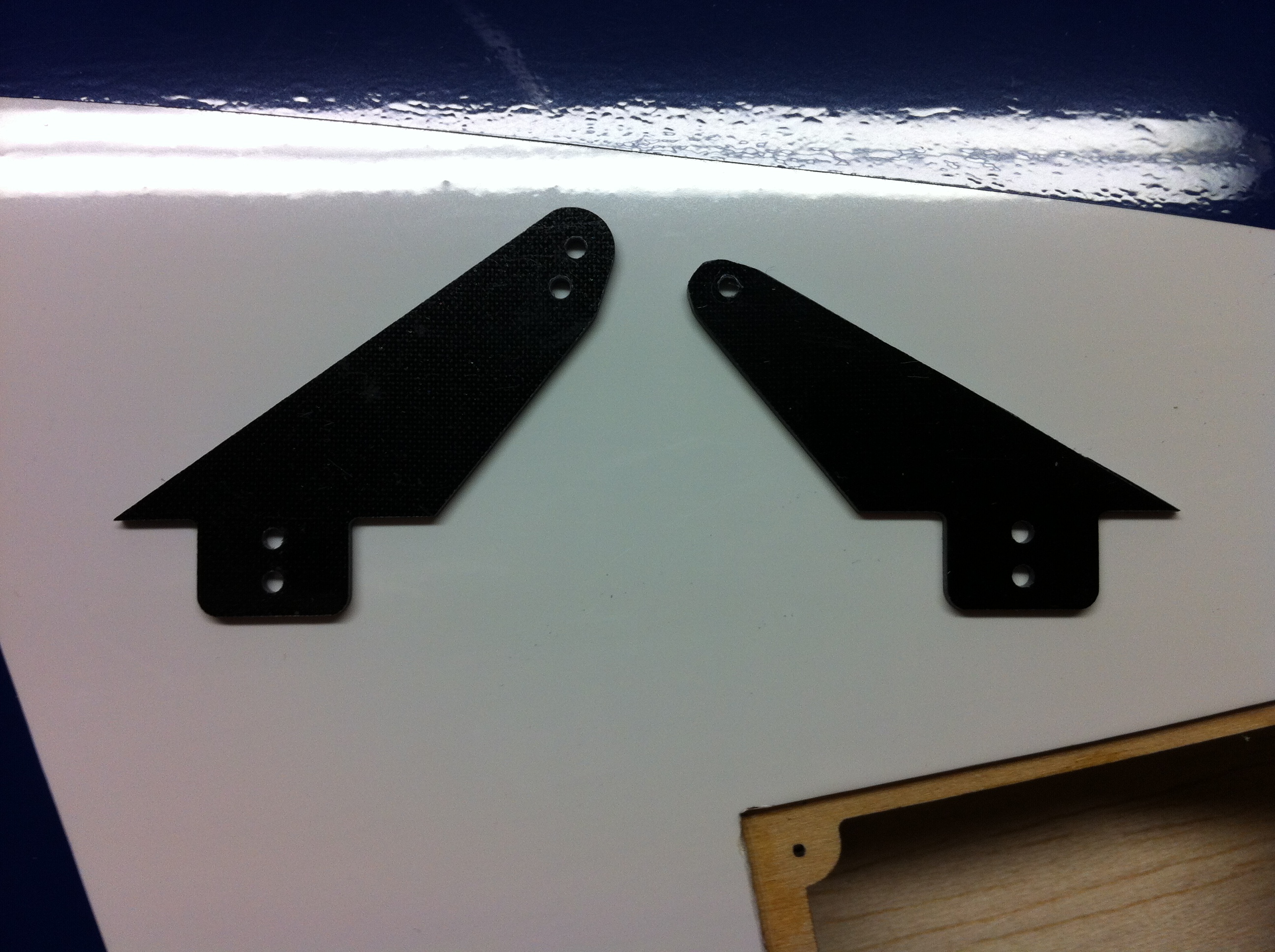

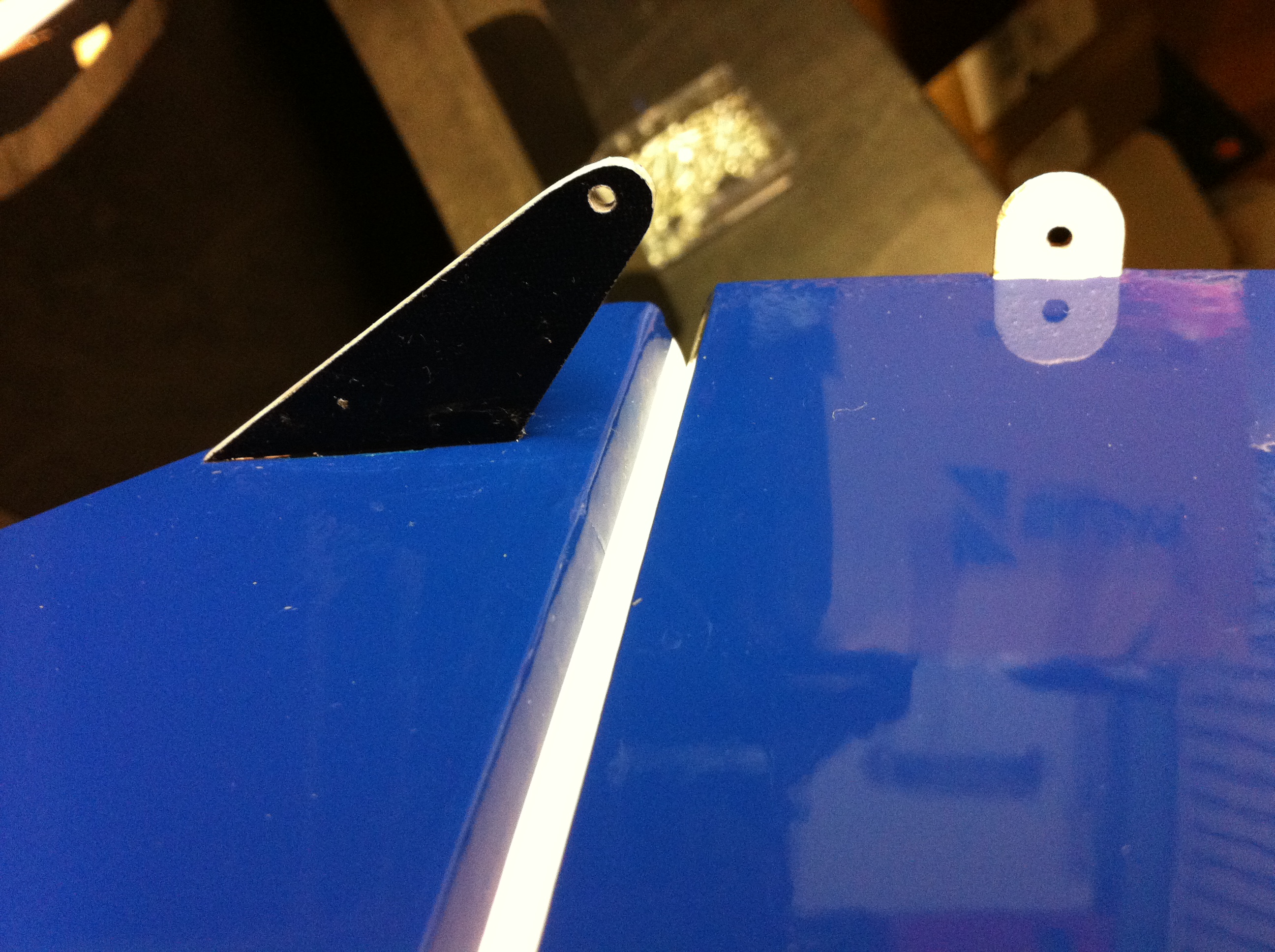

*** THIS IS SOMETHING I DO NOT RECOMMEND DOING AS IT WILL VOID ANY WARRANTY!!!!!
The first thing that jumped out at me when I looked at the fuselage was the broken top cap to the rudder. The second was OMG that rudder horn is huge. Since it was already glued in, I didn't feel like removing it. So thankfully they left enough of the horn not lightened that I could move the hole in a bit. Only bad part is that this would now put my pivot point behind the hingeline. For me, it's not a big deal. As long as my cables are tight at neutral, I'm happy.
First I centered my servo arm. I am not using the recommended metal arm as it weighs 9g. The Du-Bro HD nylon arm I normally use is only 2g.
I marked the current hole and figured out the proper spacing to allow enough material around the new hole.
Once marked, I drilled the new hole using a .82 drill bit.
Then I flipped the tape to the other horn, lining up the stock hole and the LE of the horn to the tap template.
Drilled the second hole and now I have the inner holes. I am not going to remove the extra horn material until after I fly it and see how it works. If it doesn't work, I will use the stock set-up, including the servo arm. (I'll straighten the tailwheel wire out later)
These swivel links will require the standoff's in order to clear the horn.
Using the same .82 drill bit, I drilled out the aileron and elevator horns. (actually did this the step before this)

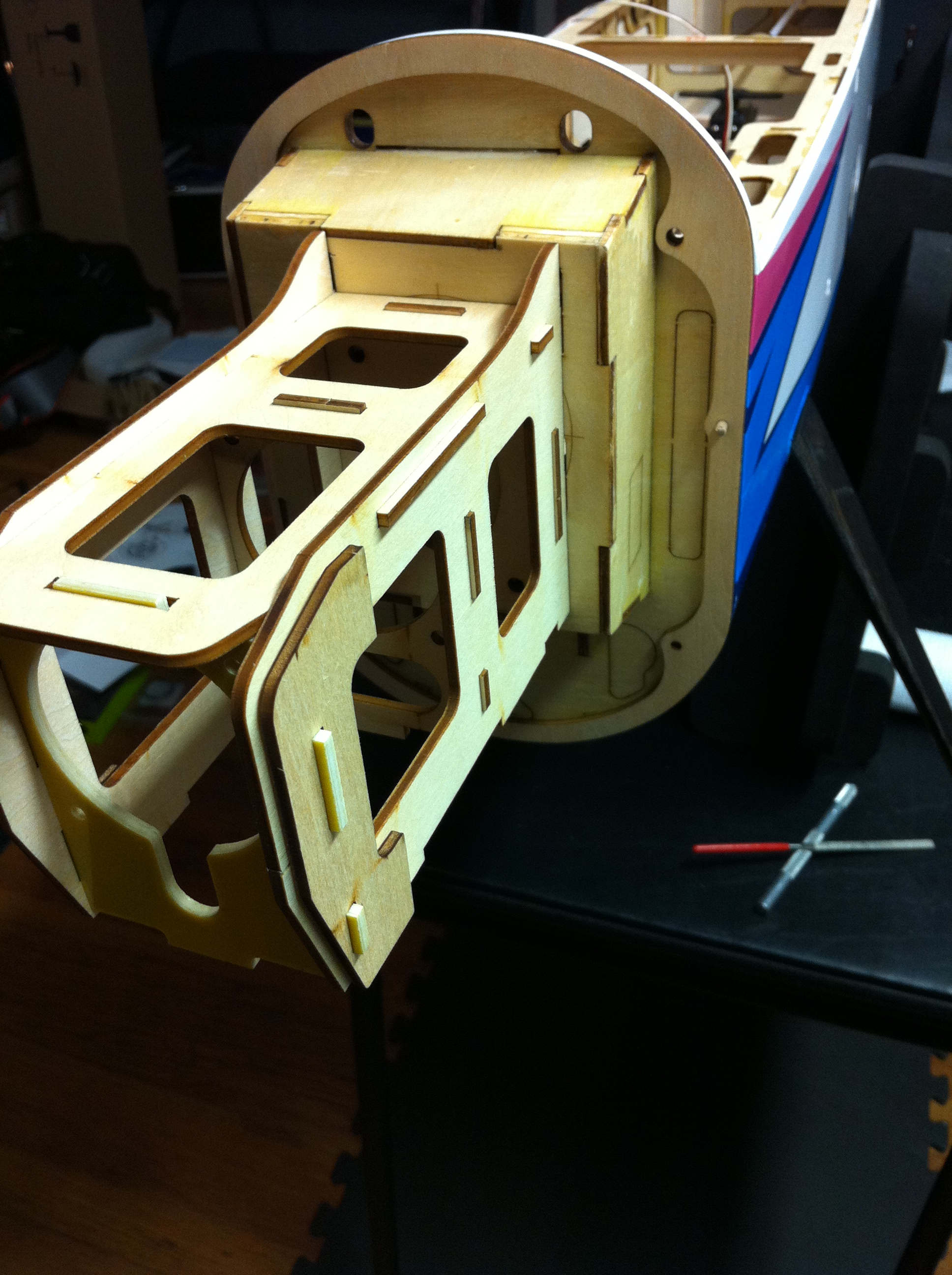

Since the weather this weekend isn't supposed to be good, I'll hopefully finish this up and be ready to test fly next week (before FL Jets).
I'll be removing all the lightning/air holes this way. Probably going to add/enlarge others as well.
Not glued, just snapped together. Have to drill the firewall and front mount first.

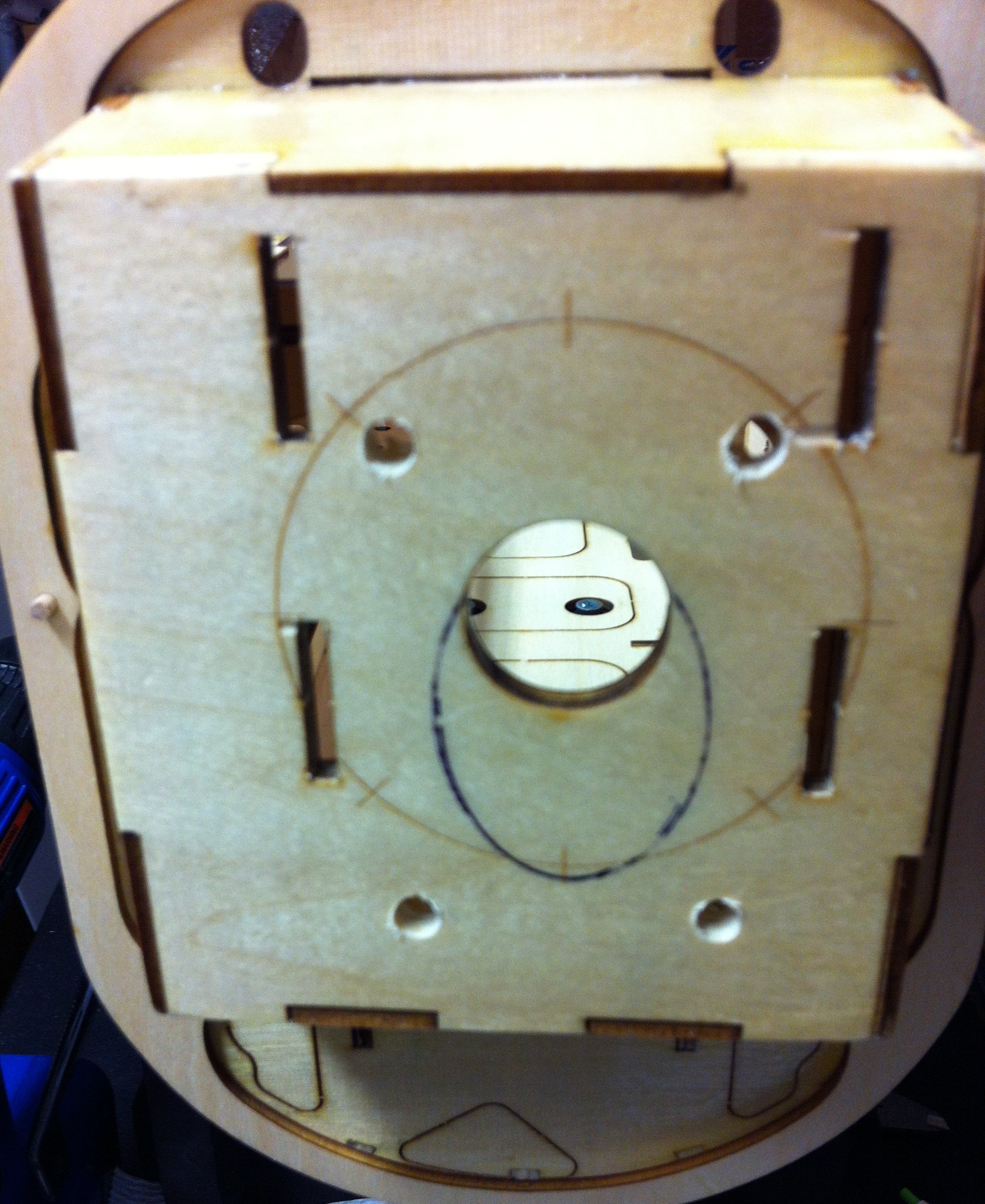

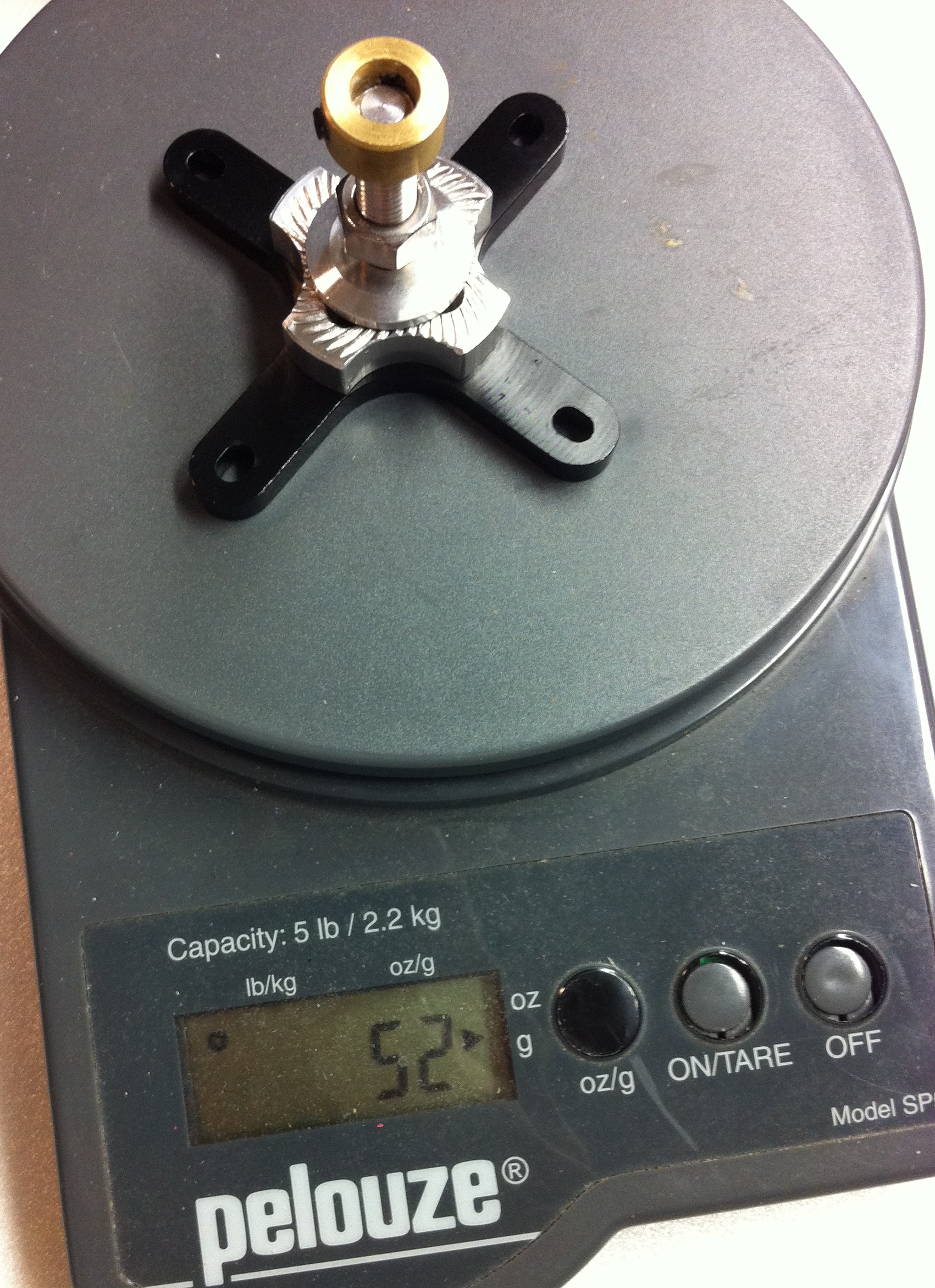

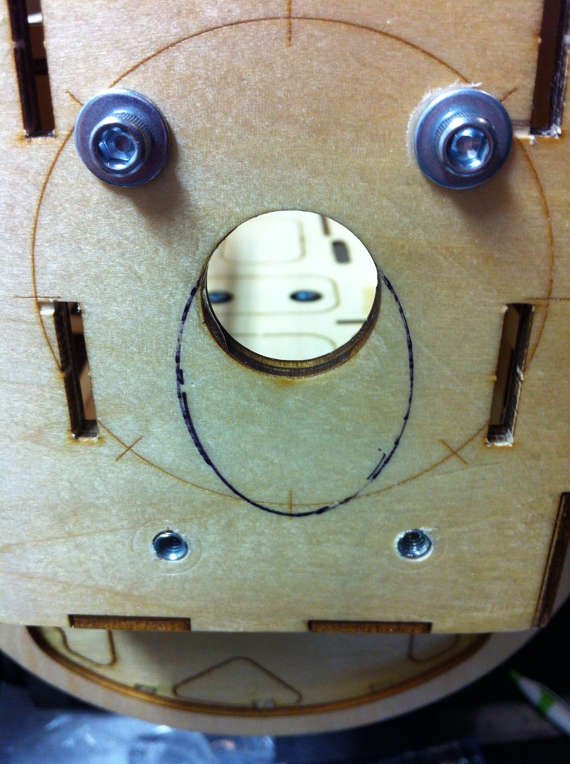

Motor install using the front mount method. This requires the wood motor mount box, which has to be purchased separately. I can see both sides to having to buy this and it being included in the kit. But working at Shulman Aviation, I see first hand that not everyone uses the 'factory set-up' so not including it makes sense to me.
First thing I did was remove the safety collar. A 2mm machine wrench is perfect for this so you don't round out the set screw head. I also found my collar to be stuck and needed a pair of pliers to rotate it free (some thread lock was between the shaft and collar).
Here are the parts, minus the screws, that I would have had to use for a rear mounting set-up.
Here's the part used for this front mounting method. Almost an ounce lighter. I weighed the wood kit and I think it was 126g, but I don't have a metal mount to compare to, but I'm guessing the wood box is lighter. I haven't weighed the re-cut box with carbon parts, but it is lighter.
I used a center punch to mark my centers to drill the 4 mounting holes.
Since I'm looking to save weight everywhere, and work when I can, I noticed that the stock 8/32 blind-nuts were pretty big. I think I would have had to trim some of the flanges so they wouldn't interfere with the mount sliding in the firewall, so I opted for the smaller, lighter Du-Bro 8/32 blind-nuts. This saved 4g if I remember correctly.
Using a .221 drill bit, I drilled the 4 holes. If you're using the stock blind-nuts, use a .202 drill bit.
Then with the supplied 8/32 screws and flat washers, I pulled the blind-nuts into the firewall.
Double checked it with the plywood rear mounts to make sure everything lined up well, and it did.

Make sure that you have the double for the front (without tabs) glued to the front Fiberglass piece, then install it.
Glue in the top 1" Tristock before putting on the other side of the box. Then glue on the other side of the box.
I didn't get to the bottom last night, but I did put the motor on just for fun to see it with the cowling on.
Should have the motor and cowl done tonight, then pushrods and wheels/pants.
I glued the 3 rear mounting plates together and bolted them to the firewall as a clamp. If I had to do over, I would have just put the 4- 8/32 screws in to align it and used clamps.
Then I glued the rear mount to the top and one side (right in this case).
Then I glued in a side piece of 2" tristock. Dry fit this first and make sure the rear bolts/washers will clear the corners.
Then I glued in the middle former.

Using the plastic jig, factory supplied , in the manual it states-use the plastic servo arm gauge to find the servo arms that will align with the gauge as shown. (This will allow the servo arm to be perpendicular to the pushrods.)
To me it looks like they are having you use Aileron differential, and just not telling you.

In reference to the weights of the optional wood motor mount and collet prop adapter vs. the aluminum motor mount, X-mount for the motor, collar and bolt-on adapter; I just weighed a Great Planes Brushless Mount for Large Motors (GPMG1260) I snagged out of our back storage room and it weighs 126g [4.4 oz.]. If, as Jason says the wood mount weighs 96g, that's a difference of 30g [about an ounce].
FYI...
Tim
P.S. I plan to use a Castle Creations Edge Lite 100 ESC on my Sequence 1.20. I can't see anything wrong with using that, can any of you guys? Not sure if I'll use a separate 2S LiFe receiver pack (unregulated), or just to with the BEC in the ESC for Rx power. Will some of you pattern experts offer your opinions/suggestions on these two options. Obviously, foregoing an Rx pack will reduce weight, but if the ESC smokes that's bad! But what are the chances of smoking that ESC in my setup (stock Rimfire 1.20 on 6S).

Glad to hear that the linkages worked out for you. I don't know how the CA will hold up under fuel, so you might want to use JB Weld instead (assuming your Classic is glow powered).
Ramp,
It could also be what they found during testing was that this setting made the plane roll straight. I will do a test with some wire and see if the stock set-up gives any differential. I usually fly with 1-2mm more up than down anyway, so if it turns out close to that I'll leave it and adjust in the radio if needed.
Tim,
I weighed the stock mount when I got home Sunday and found it at 126g also. I will reweigh the new mount before bolting it in. As for using the ESC BEC, I think on a plane of this size, you should run a separate battery and switch. This is a lot of plane to hope that the BEC holds up. I know it's extra weight, but it's also (for me at least) a piece of mind to have a separate Rx battery, and a small (730ish mah) lipo and regulator (or LiFe without a regulator) doesn't weigh too much.
It's not looking good to have it flying before FL Jets, so It'll probably be next week before it's flown. I did notice that my cowling frame (for the 'hidden' screws) is about a 64th more narrow than my fuselage, so I will have to build it out a bit to clear the fuse. Not a biggie, just unforeseen. I debated about just screwing the cowl to the fuse the easy way... but it's a pattern plane, so I'll do it 'right'

Thanks for the weight info Tim. I think I prefer the front mounting with the wood motor box so I'll be setting mine up that way.
Mark
Mark
