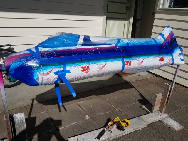

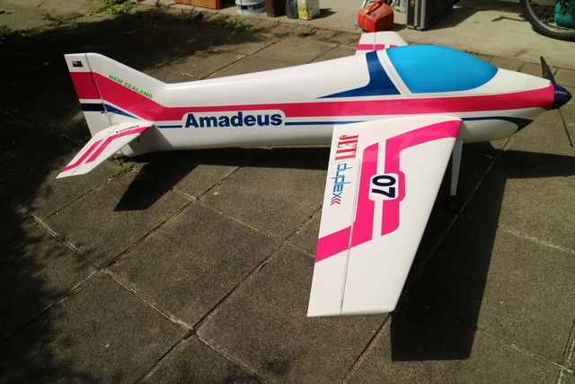

Going though the process of getting the paint on. Got a reasonable paint match for the vinyl I am using. Having the vinyl cutter is great as I can cut masks for paint or vinyl to stick on.

I got a 3M masking tool. If you've ever done much masking you will love this tool. This pretty much completes the paint although I might put on a black anti glare panel. I will put on clear.

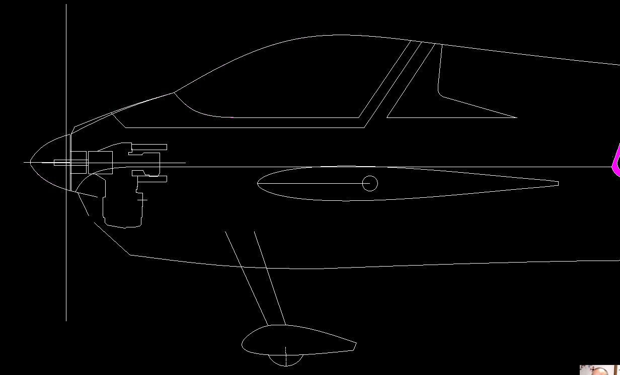

Interesting. The DLE 35 RA fits quite well into the electric version. The weight is 1.26kg and the YS 200 is 1.065KG. I would expect the YS to be a bit more powerful as it will be on 30% nitro. I can design and build pipes, and the DLE on a pipe might respond to a higher exhaust timing as the stock timing is probably fairly low. I wonder how a bit of nitro in the petrol would go?

Hi Flywilly. Interesting about the glow plug, I had forgotten about that. Seems to be very little about the DLE35RA on a pipe when it seems such an obvious thing to do. I managed to deduce the exhaust timing from the available info, stroke 30mm and rear view drawing. As i expected it was a conservative 148 degree duration, about right for a muffler. For a pipe 164 degrees would be better. This means grinding 2mm off the top of the exhaust port. For tuned pipe design Jennings two stroke tuners manual is the holy grail.
https://www.google.co.nz/url?sa=t&rc...gg3gqCxILowdeH
I design pipes for broad range though so the front cone is set for a lower rpm than the rear one. I make my pipes from .6mm ali sheet brazed together with a propane torch. However commercial ones will work fine. Header size looks like it should be 7/8".

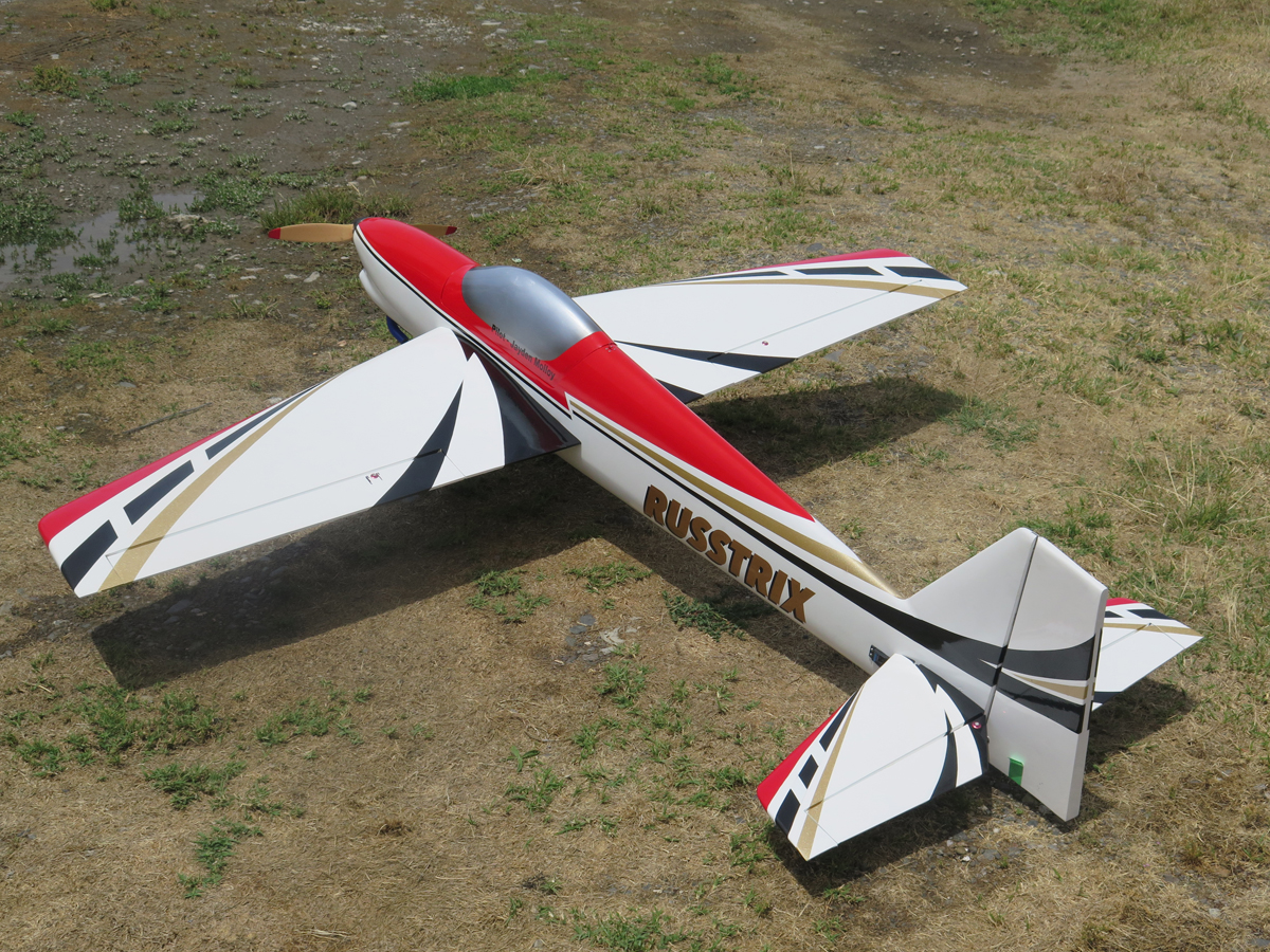

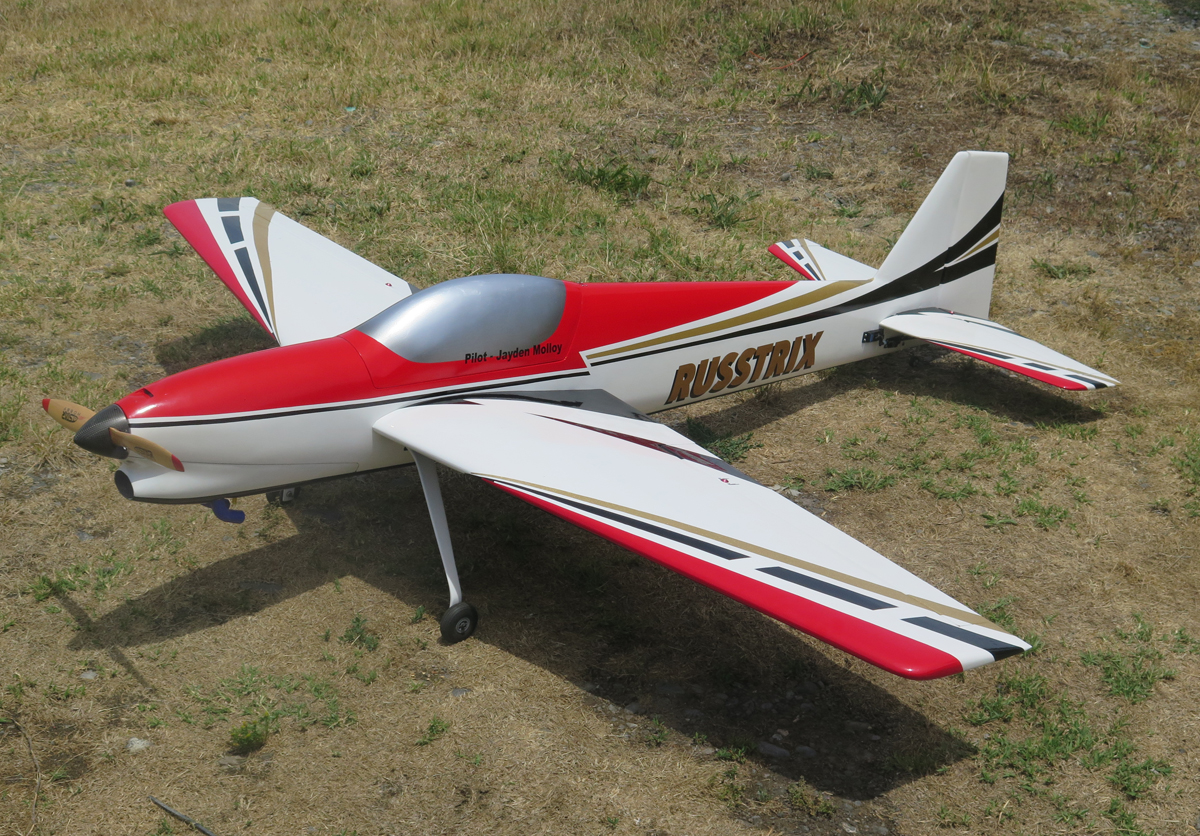

HI Rod, Hope I'm not butting in on your thread, though guess it's all related. Mike S tried an OS #5 glow plug in his Webra35 petrol 2-stroke. Ran very well with the plug powered up, but dropped revs significantly when we took the power off and then had a slow throttle response. It was a little better on higher octane and maybe Av-gas might improve, but the electronic ignition still seems best.
The good news is we finished and ran up the DLE 35RA in the new Matrix conversion at the "Shed" today. Weight ready to fly with a 2100 LIfe battery was a stunning 4.560 grams. I think it's the first plane ever that I've helped build that's come out a pound under the target weight !! It was one of Ewan's latest molded fuselages with kevlar in the laminate. I doubt that we will need a pipe, though some experimenting with larger lower pitch props might be on the menu.
I think your colour scheme looks great, trust we'll see it at Galloway Farm or the Nats. Regards, Barrie.

Those drawings are interesting Rod and an encouraging result from Barrie too. I guess the only other thing to keep in mind 2 stoke pipes are heavy and the YS exhaust is small and very light.

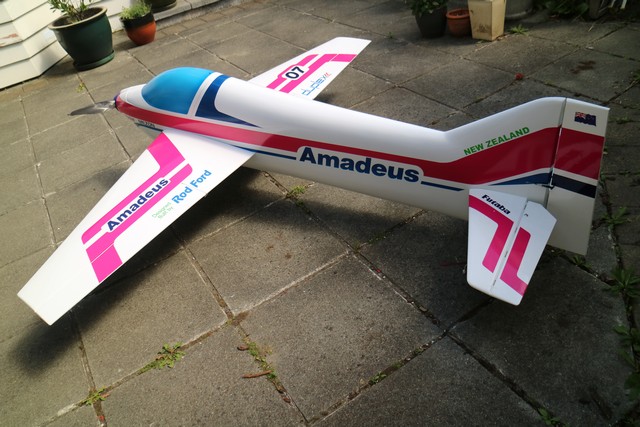

It was back to work this week. For me that means getting back into the workshop Covering on and surfaces hinged. Graphics are done on the vinyl cutter. More Logos to come. Underside is simplified upper scheme.

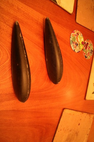

3D printed spat didn't work out as the support material wouldn't come out. Dusted off the Miro spat mold and made one with 50gm glass and 80 gm carbon.

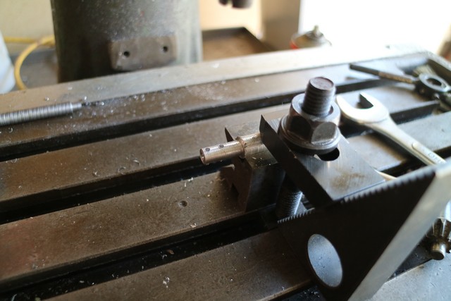

Made some custom 3mm titanium turnbuckles. I needed left hand and right hand taps and dies for this. I had been planning to do this for quite a while so it was good to get a result. The ailerons will be treated the same way. I need to get some aluminium servo horns.

Spat out of the mold at 16gm.

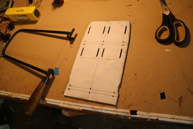

Cut ESC cooling holes. Glued a pattern on with glue stick then cut and filed. The heat sink is directly behind the holes. Talking about cooling I still need to make an air exit system somewhere around the middle of the model. I have a hole at the back but feel I need more.

Got the second spat done. Would still like to make a more compact version. Will probably glue them on with silicone. Got the aileron servos in.

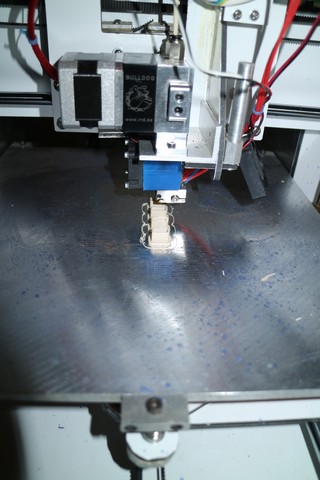

Printing pockets for the servo lead sockets. These glue into the side of the fuselage for the wing and stab servos to plug into.
