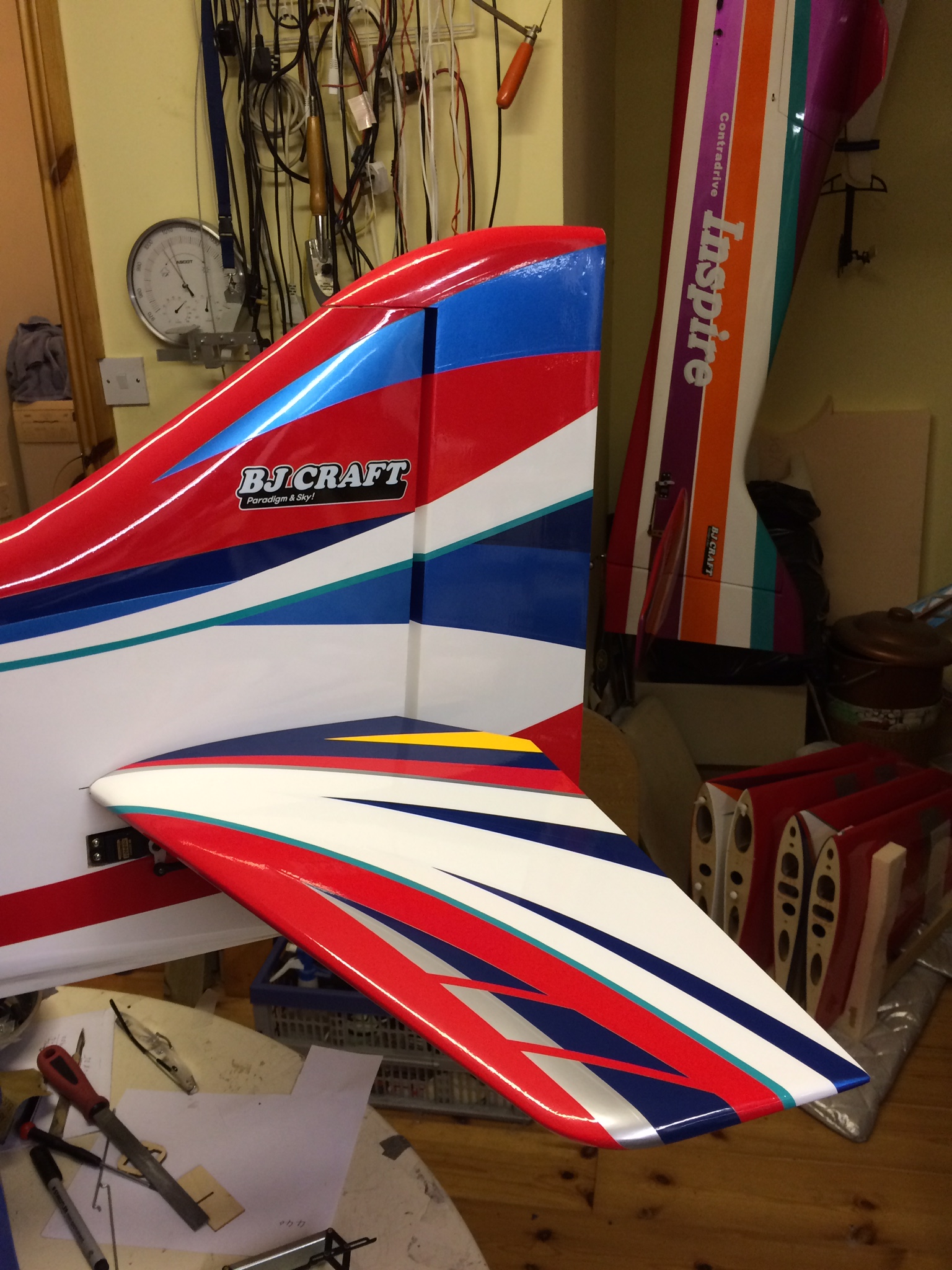

As as you can see motor mount complete, tail and rudder installed and working and the undercarriage with spats installed. I use the PT models undercarriage as it is raked approx 2ins further forward than the BJ ones. On a rough field it will help the plane not nose forward on landings.

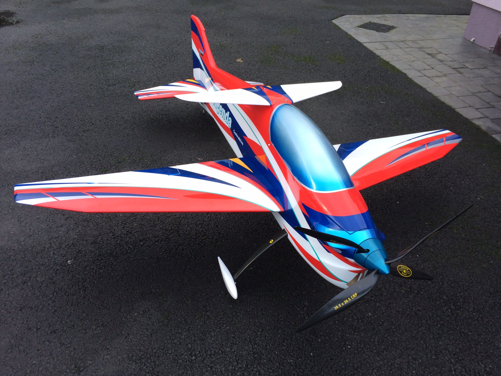

Model fully finished. All up weight with my heaviest battery (1180g) is 4800g. I must now wait for the weather and the flying site surface to improve to maiden it. It could be a while.

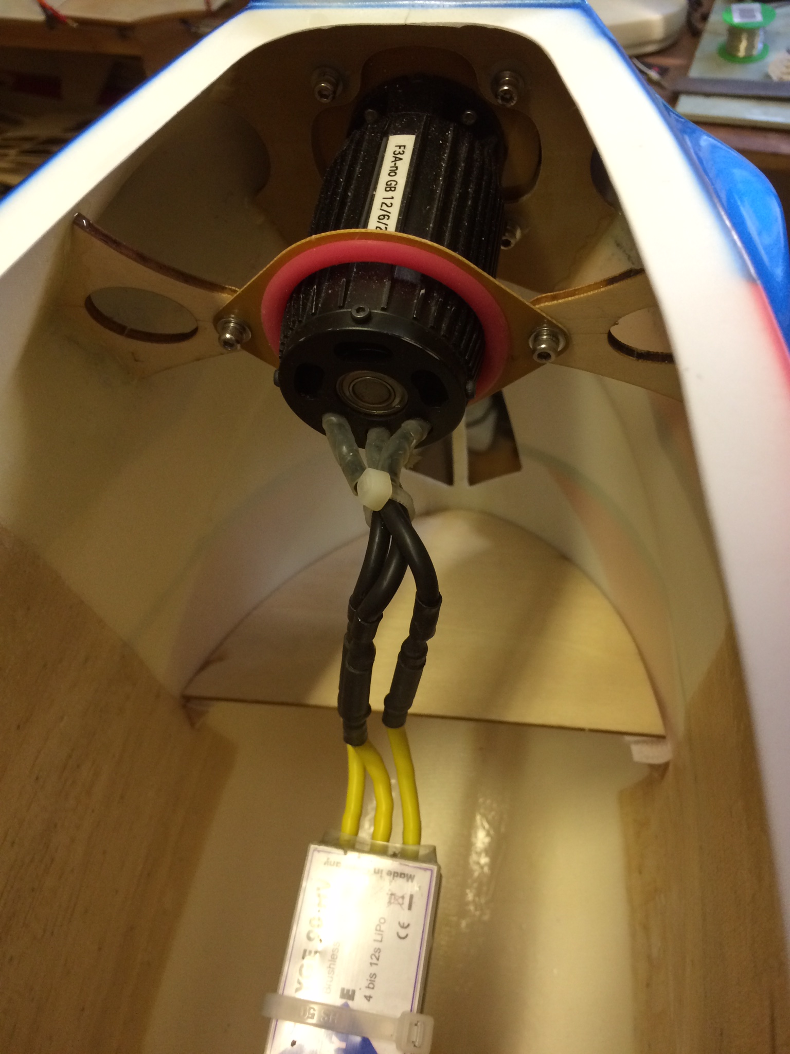

Second photo is the motor install.My firewall etc has been supplied especially from BJ and is the same as the one he did for the Inspire.

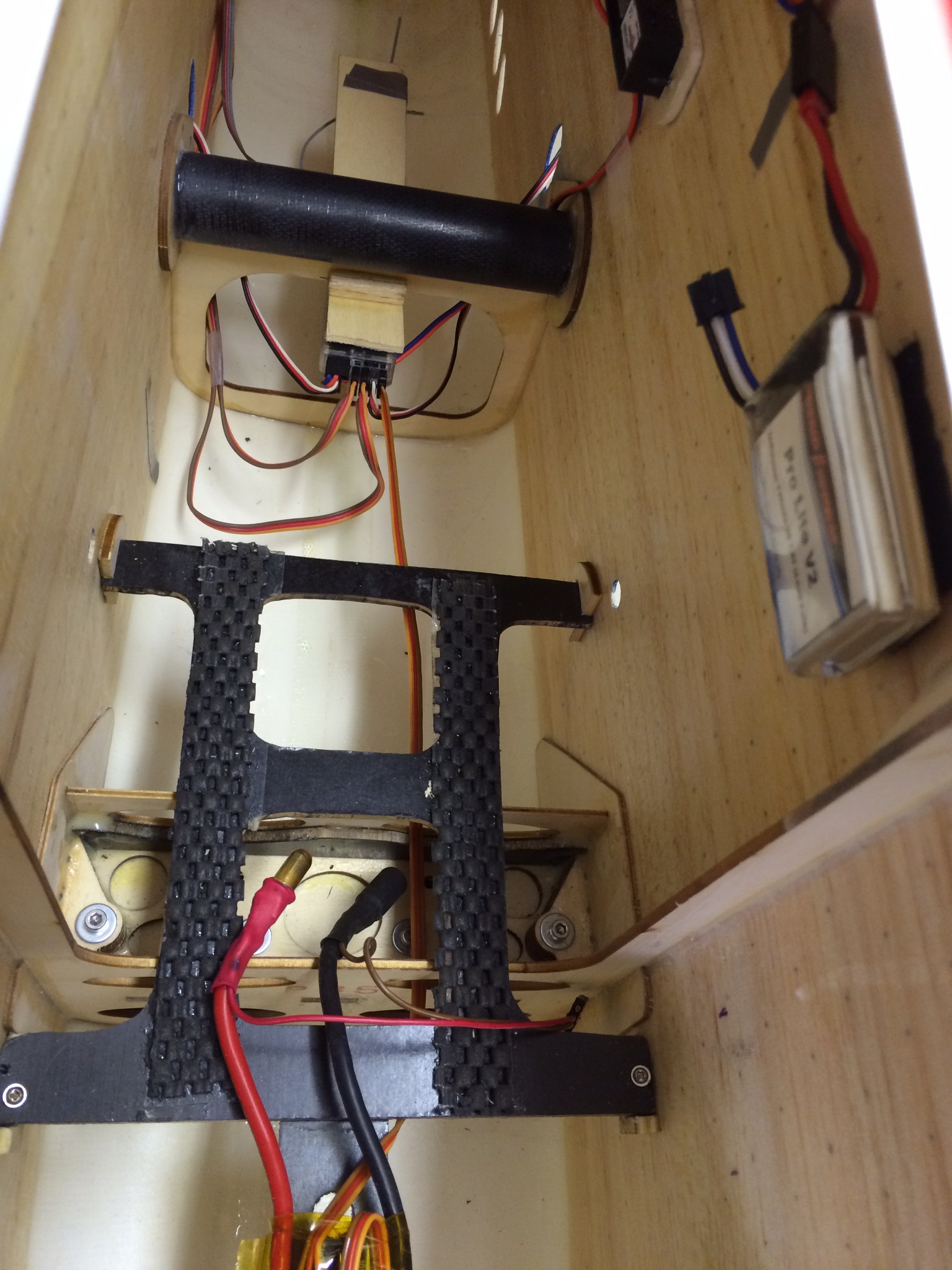

Third photo is the final positions for the receiver , main battery tray and the Rx battery. I use carbon sheeted end grain balsa for the battery tray as it is light but strong, and the speed controller is attached to the front of it. I also make it removable by just opening 2 servo screws.

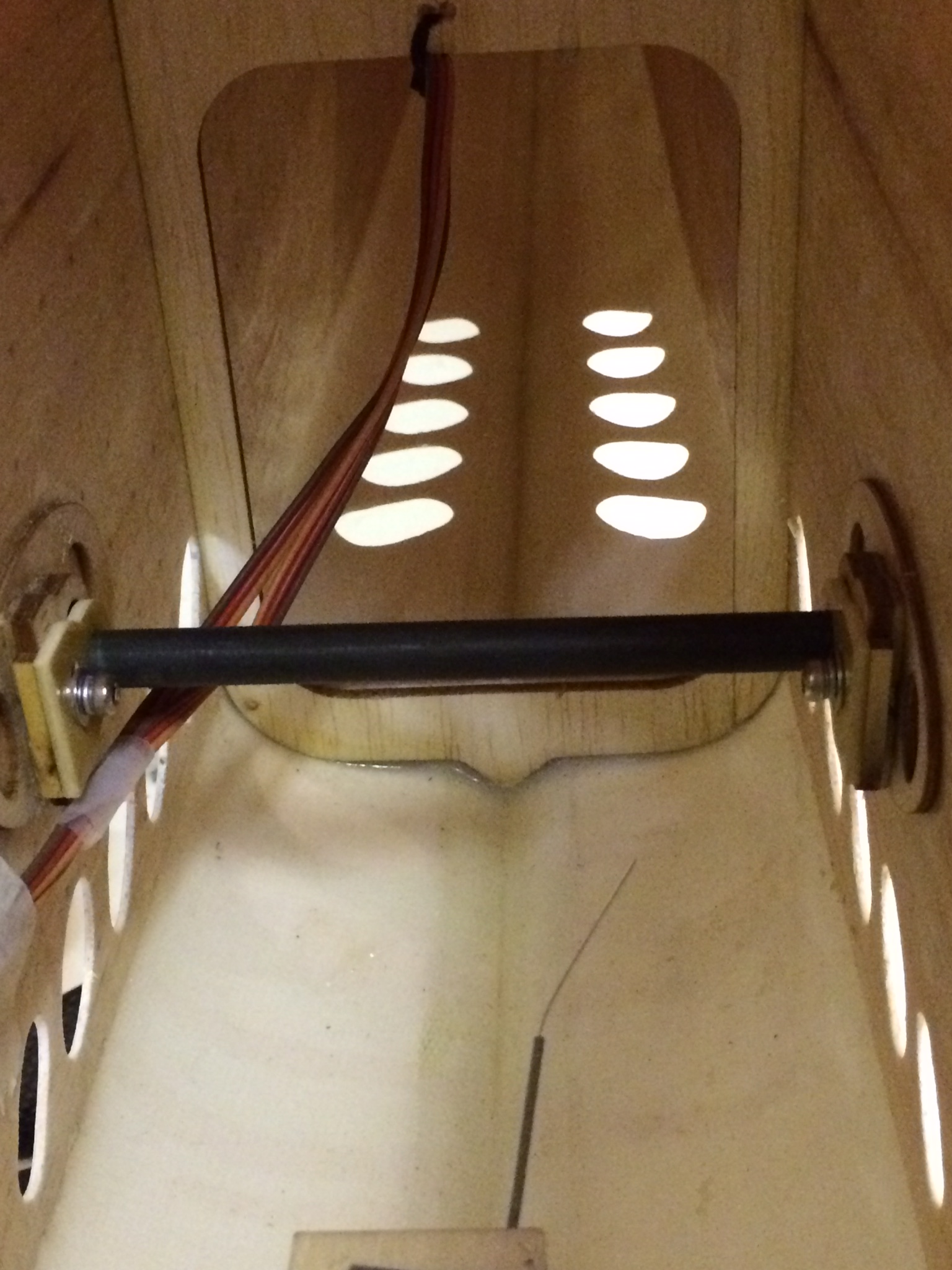

Any pics of your wing adjusters in the rear or did you go without?

I have installed the adjusters but I have left the front holes as they were. I will fly a few flights and then decide whether to make the front adjustable. I may adjust CG first.

Basically the way BJ recommends I think. Because it's so deep in the fus I will drill a small hole on each side to access the screw on the other side with a long driver.

How are you securing the carbon rod so that is does not slide out of the fuse?

I just put a small dot of epoxy on the join where the carbon rod meets the adjusters and then rotate the rod a couple of times slowly. When it dries it will be stuck.
