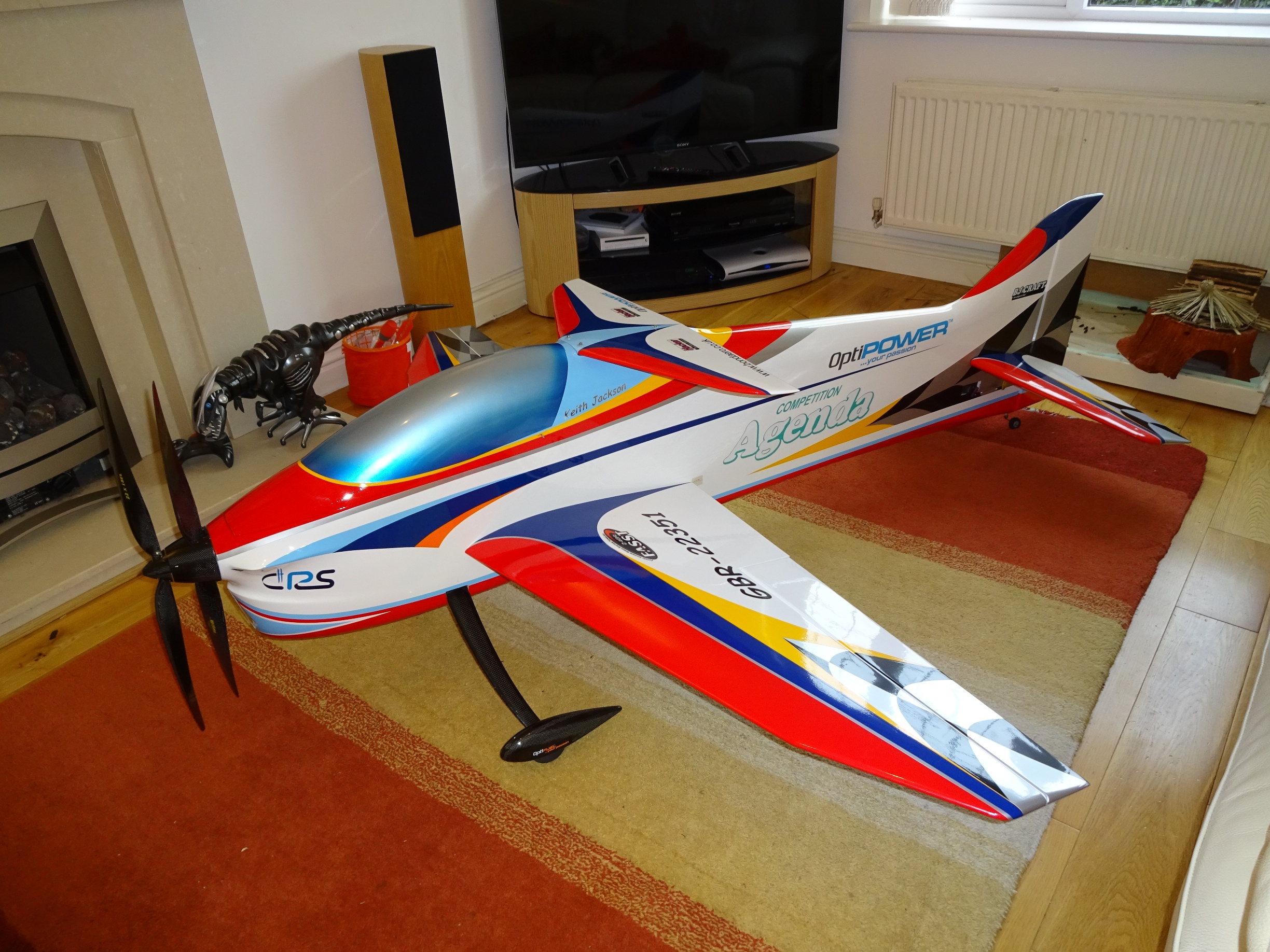

Having just completed an Agenda with the RS Contra drive system, I can happily recommend this model. It built up very easily and there was a surprising amount of relevant hardward included in the kit. The wings and control surfaces were all perfectly straight and the model built very light indeed at 3510g rtf, even after some extra rienforcement around the UC area to accomodate our rought flying fields. I am definitely looking forward to this model in the coming season

Hi Keith ,that looks really nice. Did you do the color scheme or did BJ do it for you ? Can't wait to hear the flying reports.

Hi Paul,
Its the Akiba color scheme? You can specify it when ordering and cost a little more but worth it in my opinion. If its anything like the Inspire I flew last year it should be great

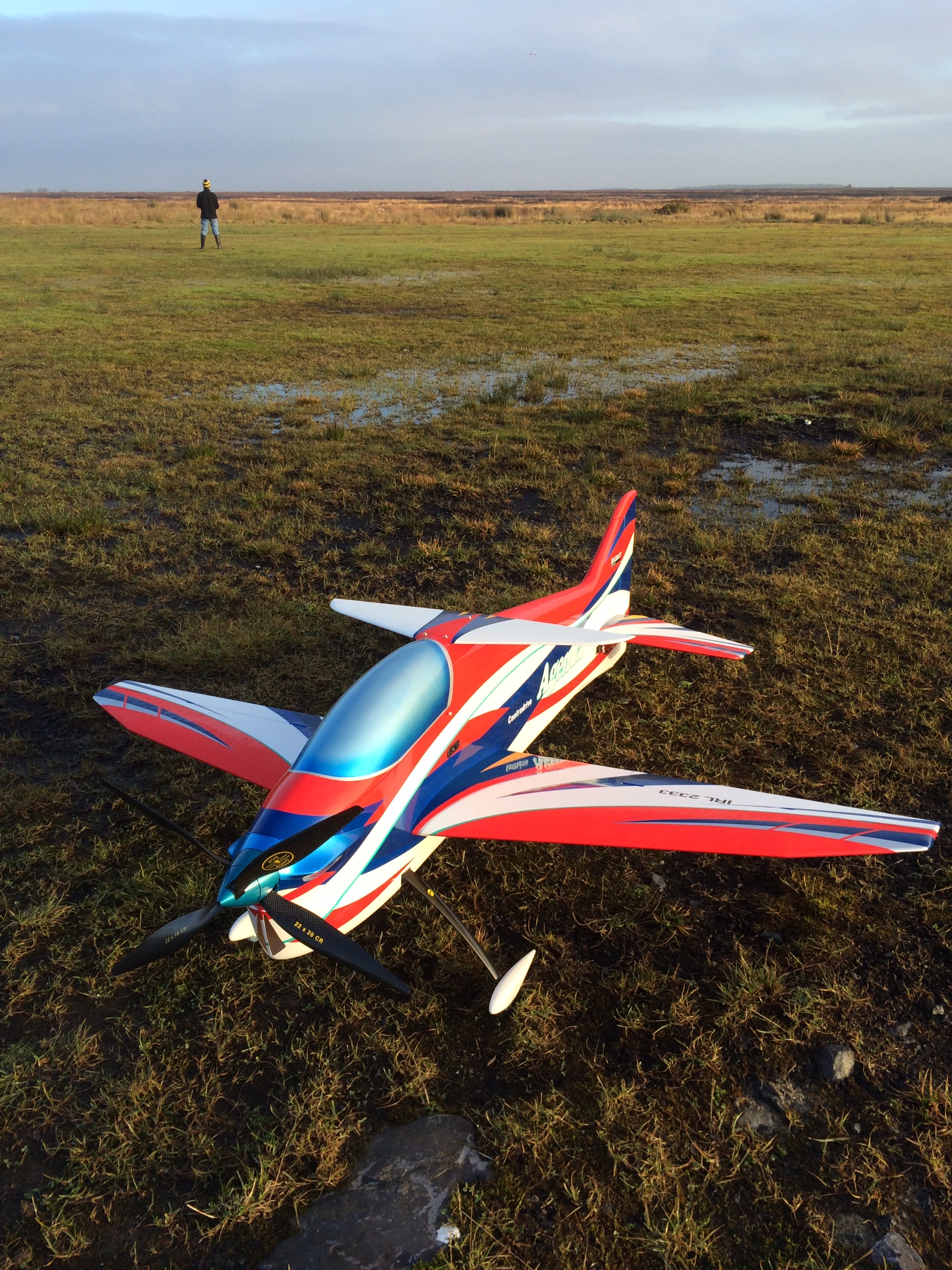

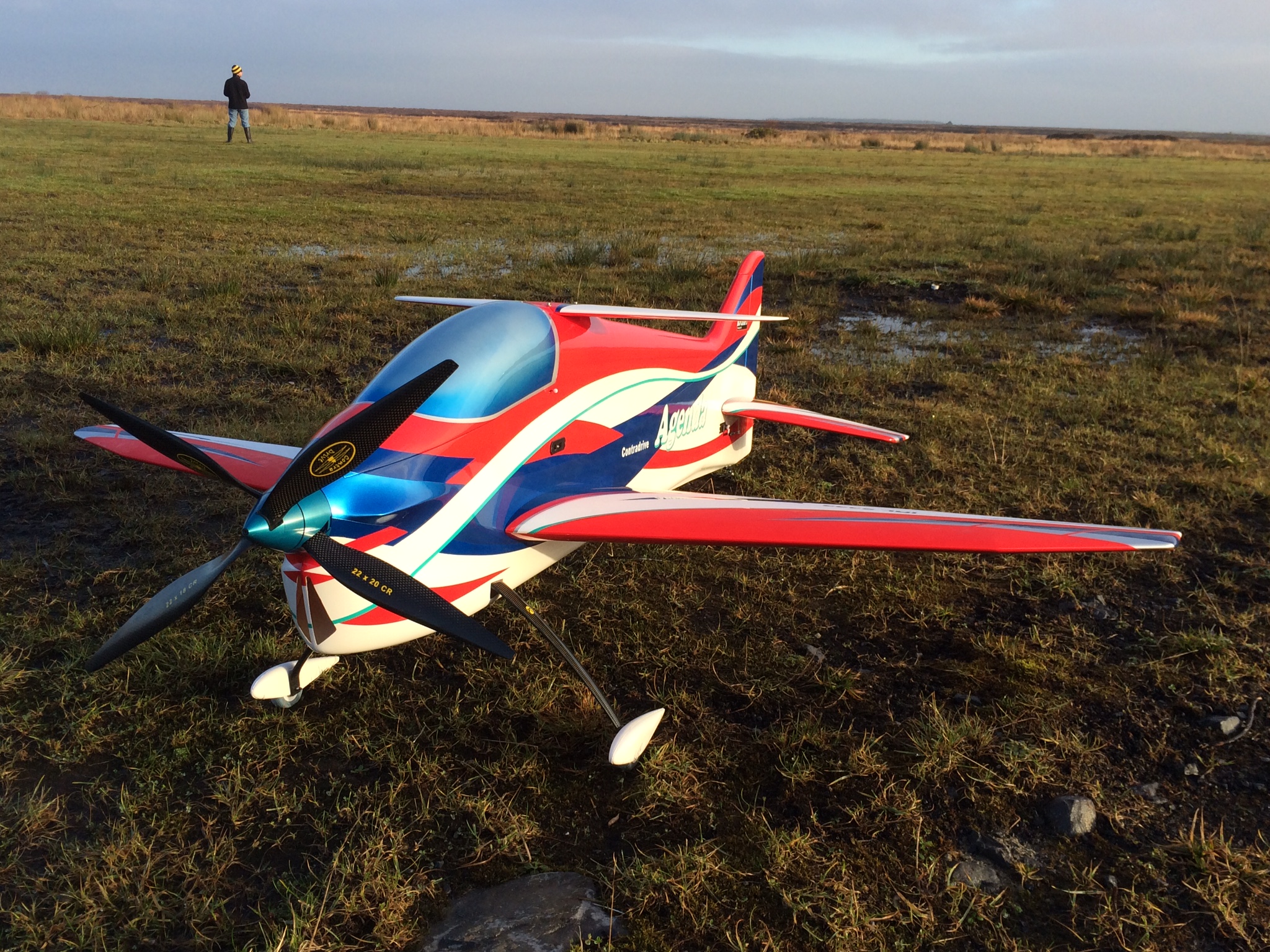

I took a ok a couple of photos before the maiden flight. You can see the water on the surface behind the plane. There was just a narrow strip of the runway that didn't have standing water. It was still all pretty soggy.
Anyway I had 2 flights this morning. The first flight I had to give 4 clicks of down elevator, 4/5 clicks of left aileron and 2 of left rudder to fly straight and level. Vertical up and down were quite straight and knife edge a small push on right and a small pull on left. I started with a copy of my Inspire program so the controls felt quite soft. Landed nice and slow without any hassle.
For the second flight I left the trims and just flew some schedule. Rolls ,knife edges ok.i need a little more rudder for stalls. Snap was ok and spins may need a bit of work compared to the inspire.
As as the plane is light I had to hold back the power a bit or manoeuvres got very big. I am happy to start with..

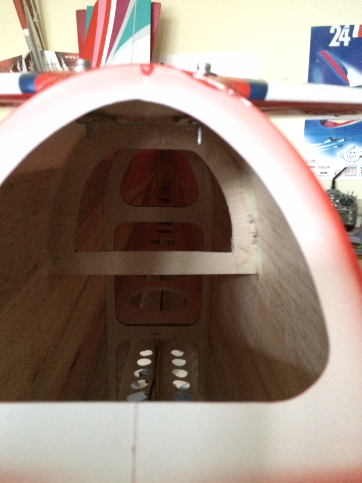

I have approx 27 flights up now with about 5 in a crosswind and I am very happy with the set up. As you can see in the photo I felt the canaliser had too much movement so a I put a brace under it to stiffen the fus at that point. This is the first model in 20 years that I havent damaged the undercarriage mount in the first few sessions as it is so easy to land even onto a small soft surface.
