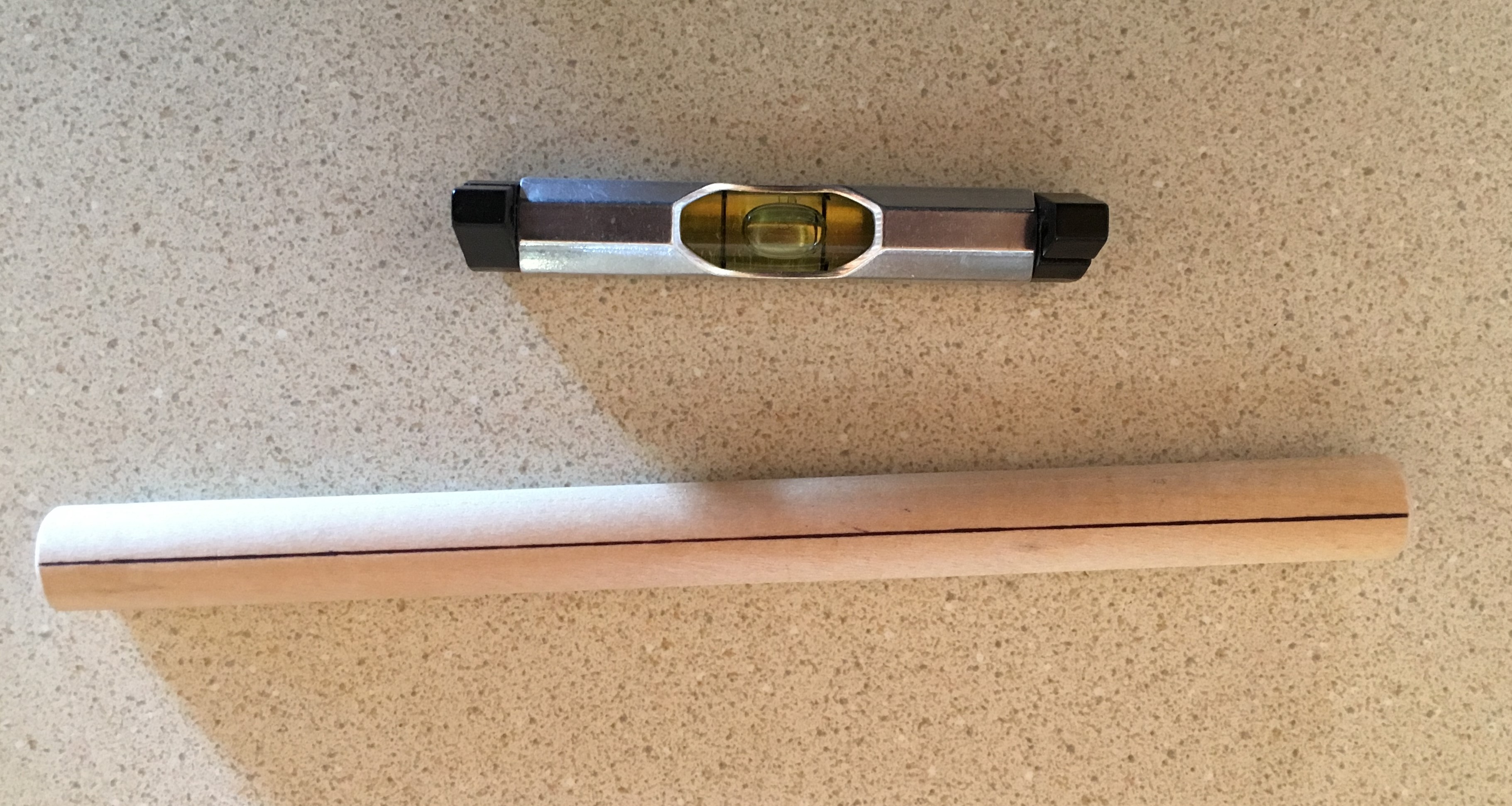

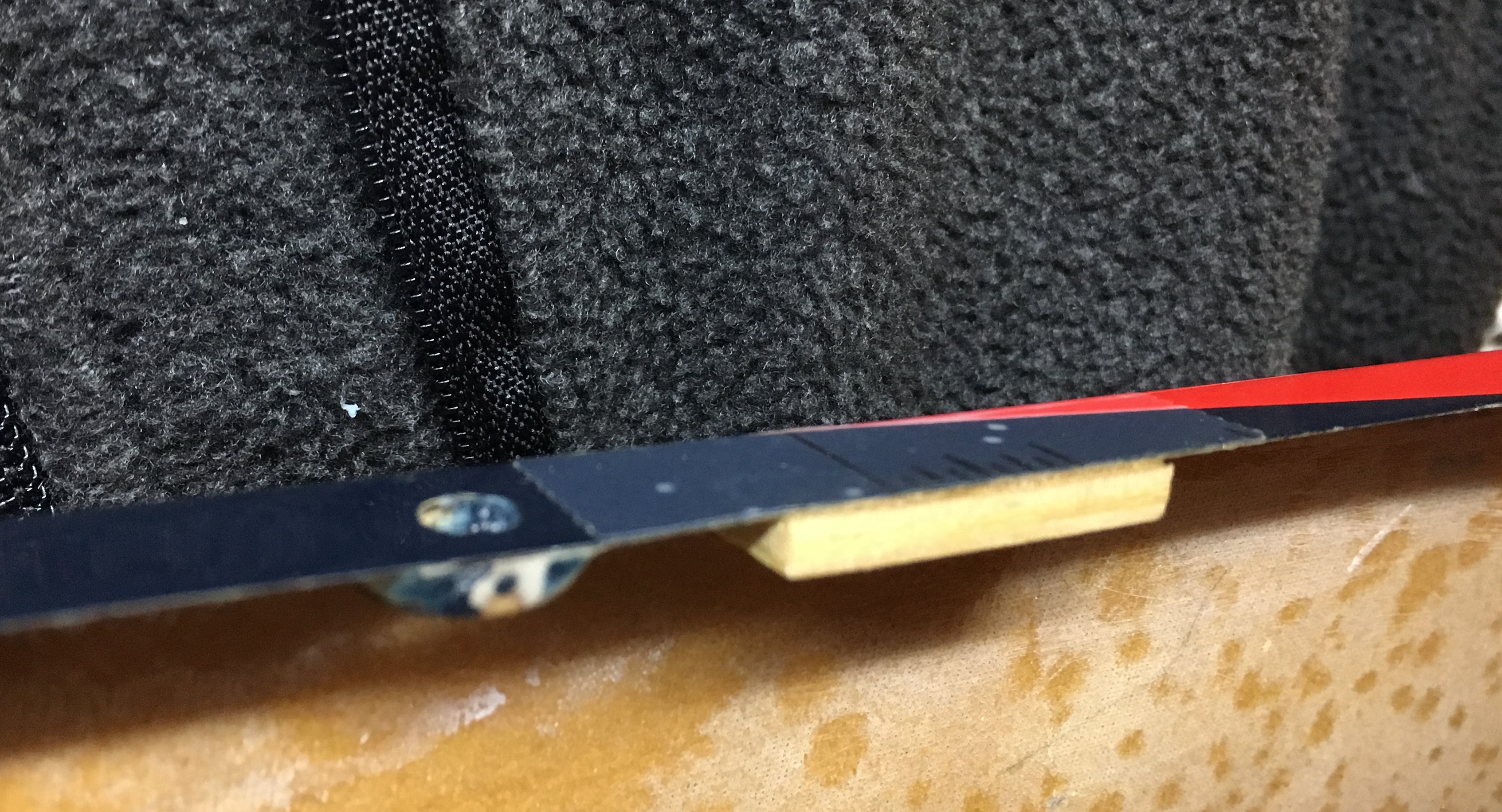

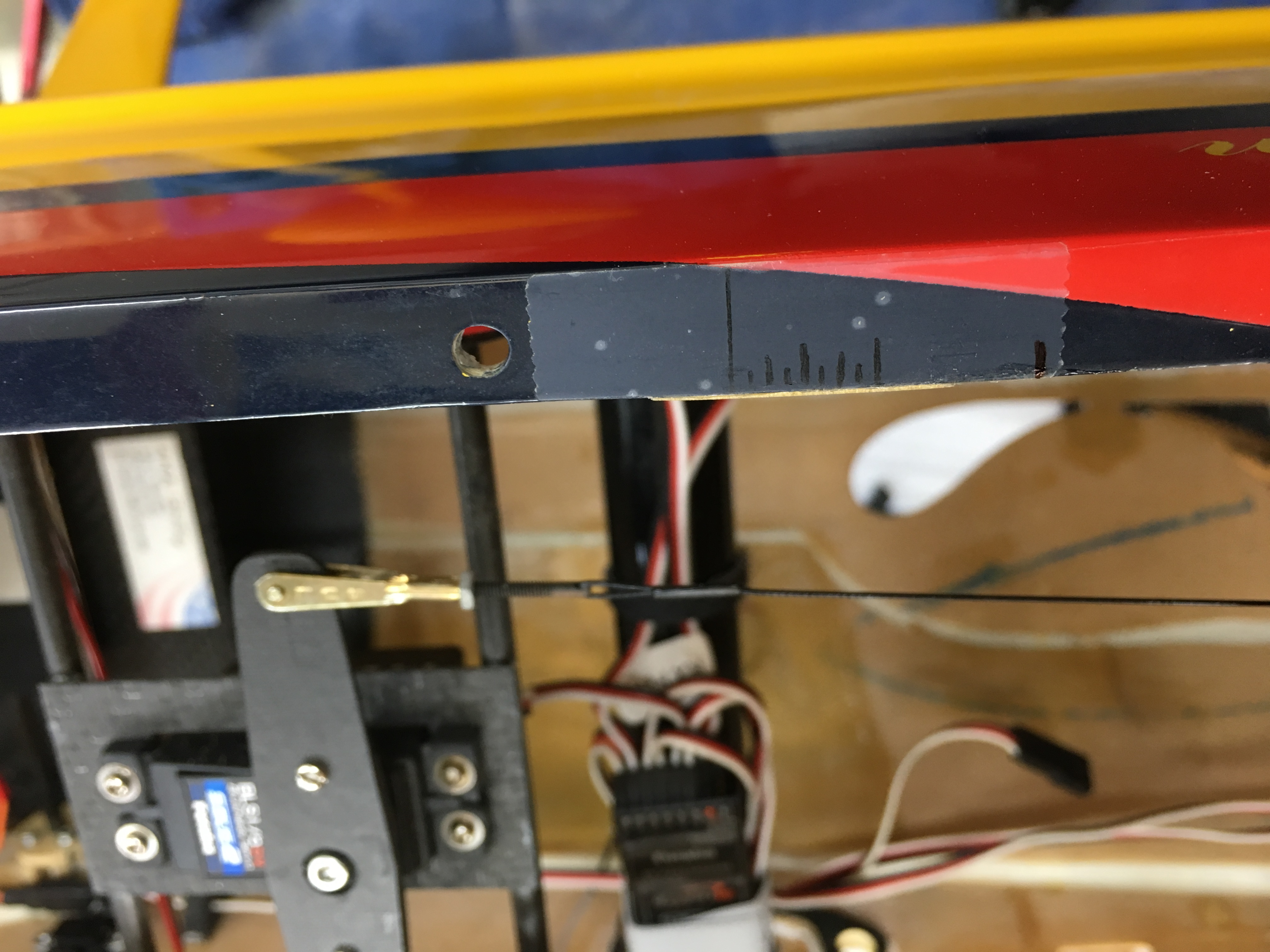

I’ve found even a 1/16” change in CG location affects my elevator trim which means checking CG often, especially when trimming, changing setups, or using different battery weights. At least until battery locations are settled. Over time, fuse opening flange may crack from having 11lbs concentrated on same point repeatedly. A little piece of 1/8” lite ply reinforcement prevents cracking.
Also, translating a mark onto flange indicating backside of wing tube is very helpful. A square resting against backside of tube, mark made on backside of blade and then translated forward by width of the blade gives you location of backside of tube. Having this on each side with 1/16” graduations makes for accurate and repeatable CG measurements using a dowel (marked with line) and a string level sitting on top of flange to indicate level. Result: reduced variability from flight to flight.

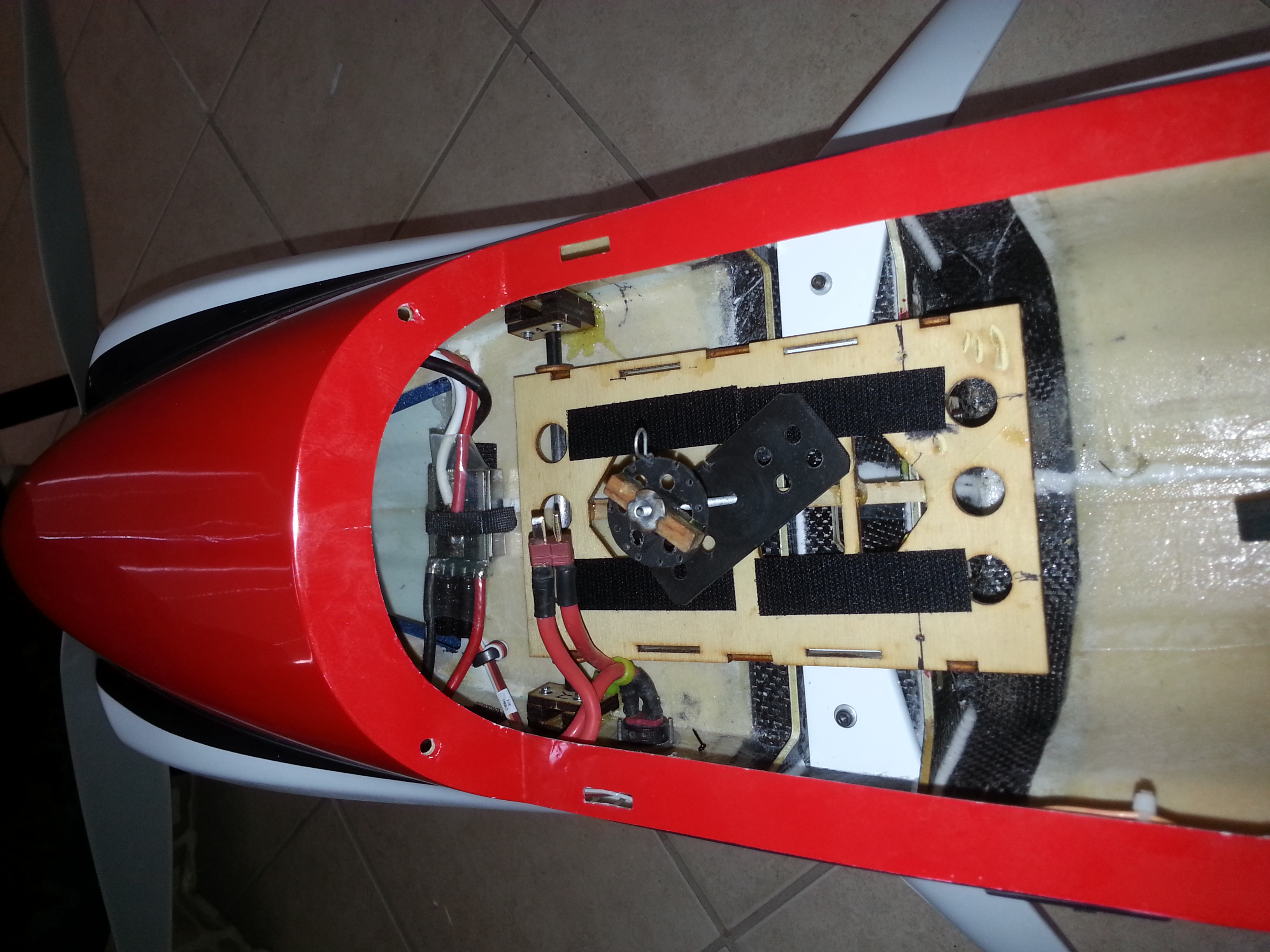

I agree Jeff. Right now I making sure it is close. Bryan has agreed to do the maiden and I am sure he will re-measure everything when I get it to his field. Nothing like having the master designer checking your setup and doing the initial flight.
Here is a picture of the battery tray completely installed. It is removable, although it will take some work to get it out and back in again.
And last, but not least, here are the final weights:
Wings weighed up at 448 and 435 grams each. Some sticky weights were added to the lighter wing to make sure they both weighed the same for a total of 896 grams.
The fuselage, including the carbon fiber wing spar weighed in at 2689 grams. My heaviest battery packs weigh 1124 grams. Add them all up and - drum roll please - the final ready-to-fly weight is 4709 grams. Should this plane last the season, then I am going to the Nats next year for sure.

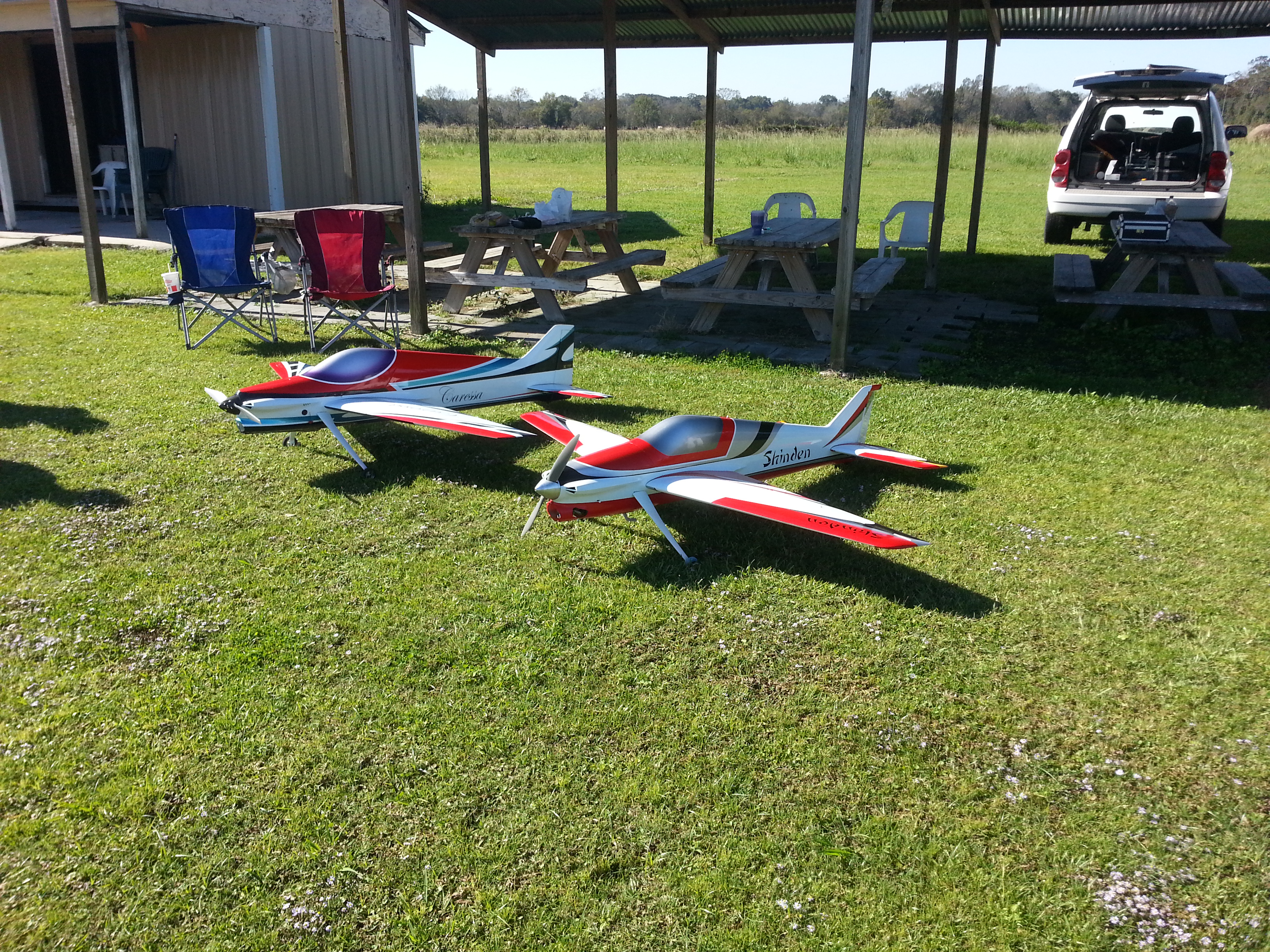

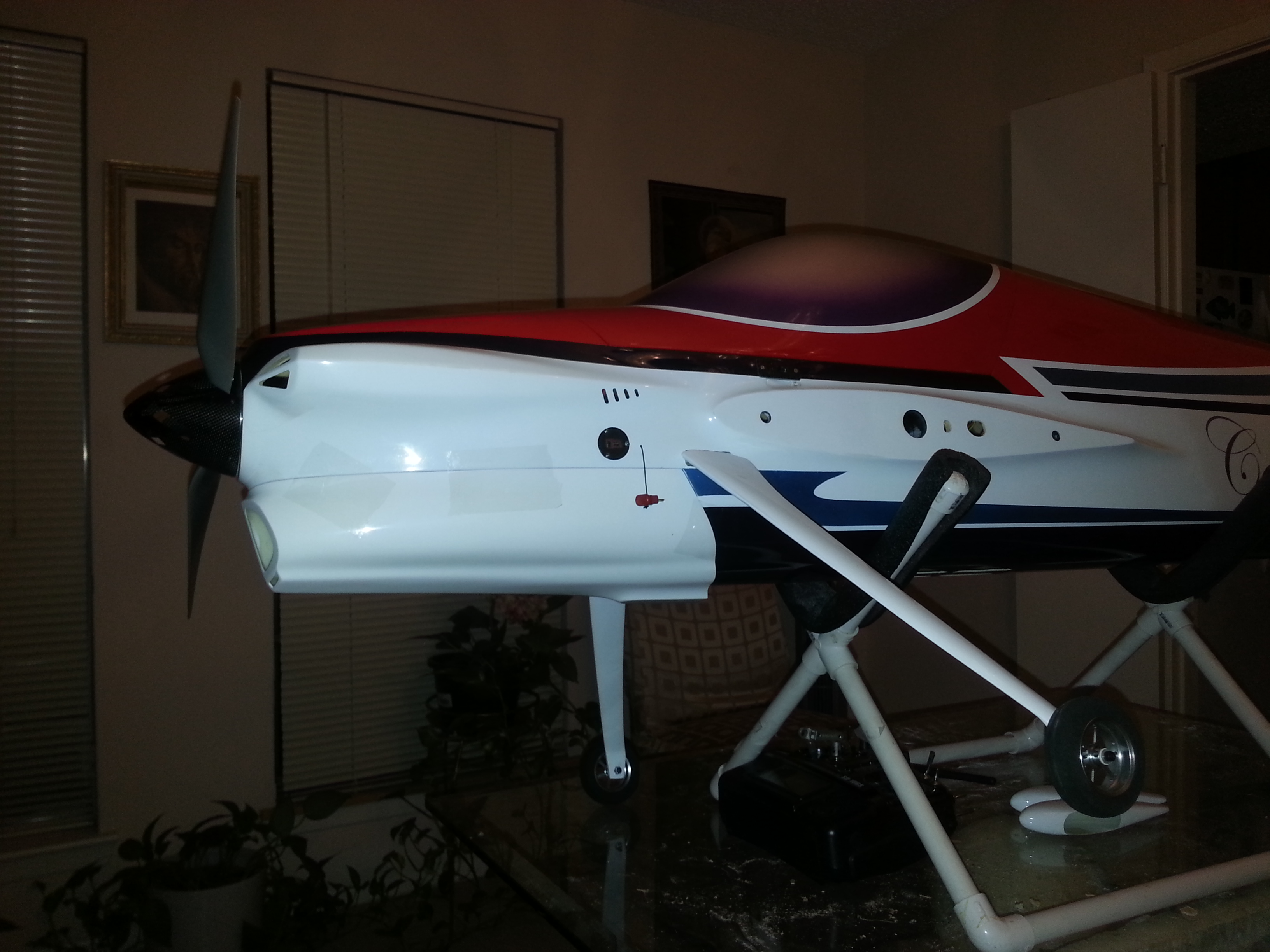

Weel, here we are at the flying field in Ramah, Louisiana, just west of Baton Rouge. Several of my Louisiana buddies were there to watch Bryan maiden this beautiful airplane. Before Bryan showed up we took several pictures. The other airplane is an 11 year old design by Bryan Hebert called a Shinden. I included it here because this plane is the basis of the Caressa design. The person holding the Shinden is Monte Richard, the NSRCA District 6 VP and long time flyer of the Shinden.
Bryan gave the Caressa a check out and decided it was OK to fly. I walked the plane out to the runway and Bryan had the transmitter waiting for me to arm the craft. When Bryan advanced the throttle the plane smoothly broke ground and climbed straight out. After a couple of passes Bryan gave it several clicks of down elevator and that was it. He flew several maneuvers including stall turns, loops, vertical down lines, and a little bit of knife edge. After the transmitter timer went off Bryan landed and requested several changes. First we moved the batteries forward about 1/4-inch forward, changed the expo on the controls to suit Bryan, increased rudder throw, increased the top end throttle curve. The primary change was Bryan realized the elevators were not totally synchronized even though I thought they were properly set.
Put in fresh batteries and off we were again. Bryan flew a bunch more maneuvers taking out the down trim he put in on the first flight. He showed me the vertical up line with hands off, vertical down line with hands off, which resulted in a very slight attitude change due to the incidence, and several other maneuvers. Unfortunately the chin cowl came off in flight during a turn at the far south end of the field. Bryan landed the plane OK while I kept an eye on the cowl. A search party went out, but the cowl could not be found. One of my friend said he had a cowl for the Shinden that was still in the box and Bryan said it would fit, but the paint scheme will be off. Mike Pascal said I could use the cowl until the replacement with the Caressa paint arrived. A look at the attachment point on the fuselage showed that the screw that holds the cowl onto the fuselage loosened and backed out. That will not happen again as I plan on using a locknut as well as the t-nut to keep the screw in place.
Anyway, all that is left is for me to readjust the expo settings and trim to suit my flying style. As soon as I get the cowl, I will update this flight report.
