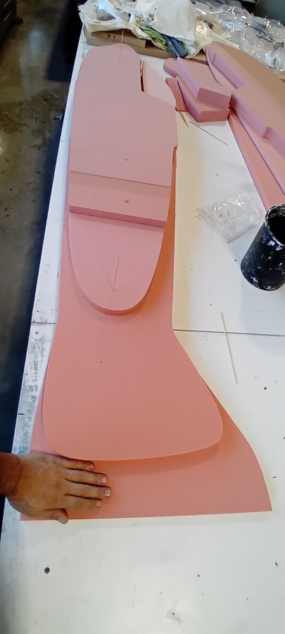

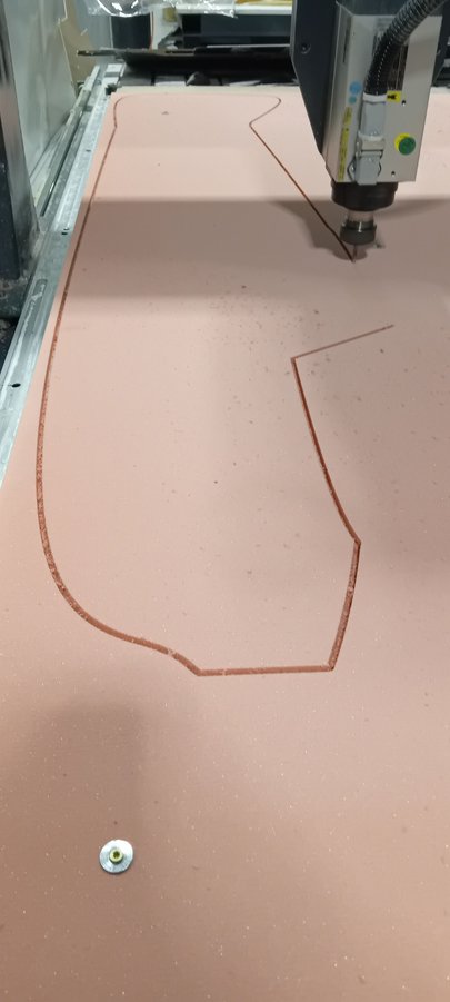

The boards have been prepared and cut with the CNC 3 axis
The following 2 users liked this post by Elias Sopeoglou:
Ricardo M. (11-12-2024), wattsup (11-07-2024)
Old 11-07-2024 | 04:17 PM
FBW
Joined: May 2020
Posts: 150
Received 7 Likes on 6 Posts
Looks vey proffesional........

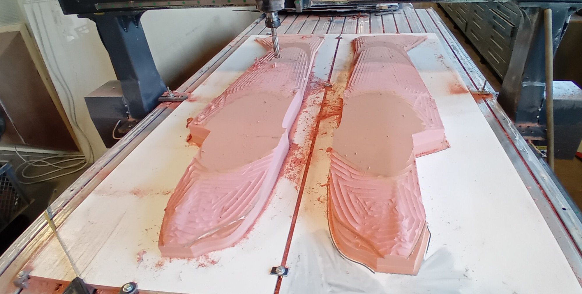

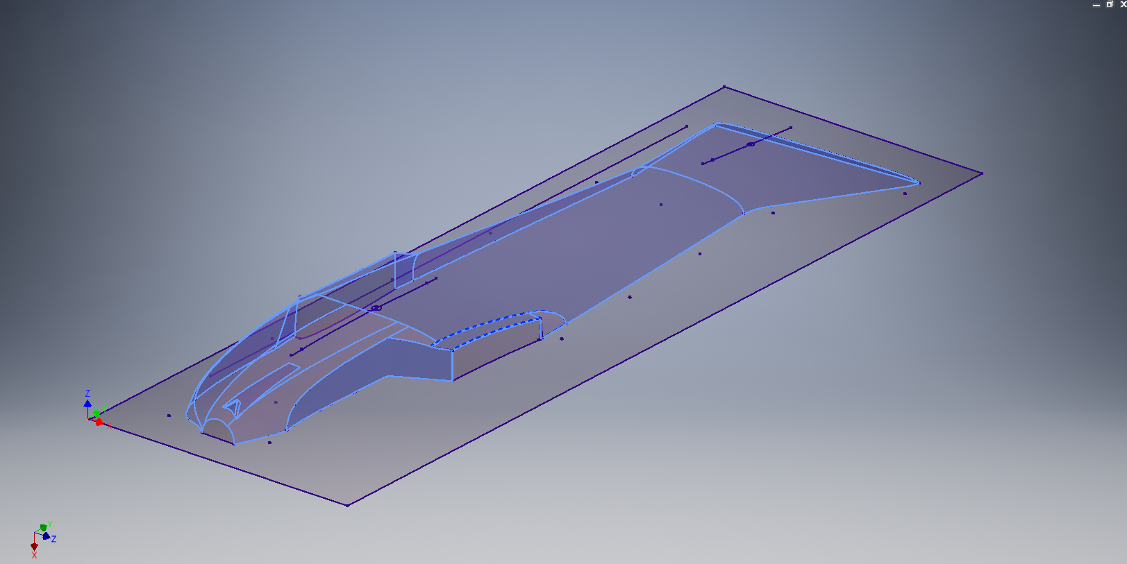

Old 12-12-2024 | 10:13 AM
Joined: Apr 2006
Posts: 169
Received 7 Likes on 5 Posts
From: thessaloniki, , GREECE
Mould cad
Rough
Prefinal
Some progress at last ,Mould cad was prepared .Later rough cuts and prefinish cuts of the fuse have been done
