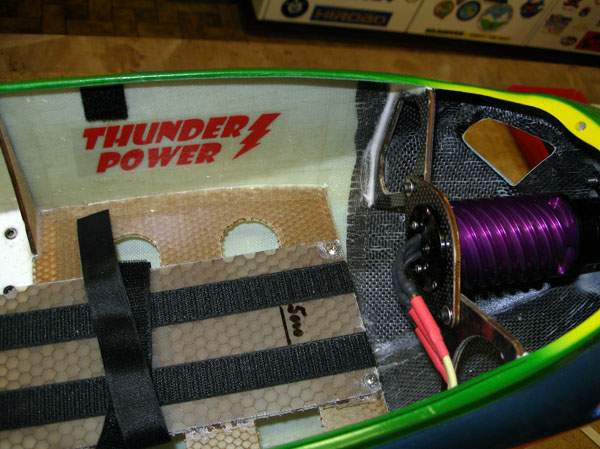

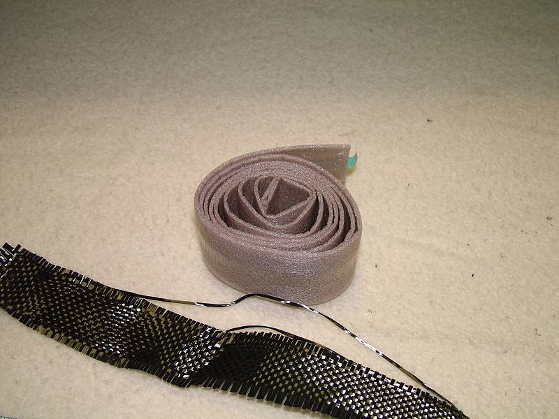

I have another Potentially embarrasing/Stupid question. My Beryll kit came with a section of Carbon cloth & foam tape with sticky adhesive on one side. What are these for? What did you guys do with them?
#84
Joined: Sep 2006
Posts: 53
From: Barcelona, SPAIN
Hi Dentdoc,
The foam tape sticky adhsive it's for to cushion the contact of the wings and the stabs to fuselage . The section of carbon must serve to reinforce posterior sugecion of the engine.
Regards,
Juan.
Regards,
Juan.
#85
Joined: Aug 2004
Posts: 120
From: Anywhere,
FL
Thanks Juan,
I thought so. I noticed the New 07 Beryll has a lot more carbon in the nose than what is supplied with the 06. I am hoping that IF there are any 06 owners out there that installed this tape, they would share the way they did it. Pictures would be great!
Another advantage I see that in doing this they are able to move the canopy hold down to the rear of the canopy. Another cool upgrade for 07 looks like 2 sets of wing hold down points. Looks like a great fix for the flex I'm noticing in the mid section of the fuse & nose.
They also indicated that the Negative stab dihedral is 6 degrees. For those that might want to try.

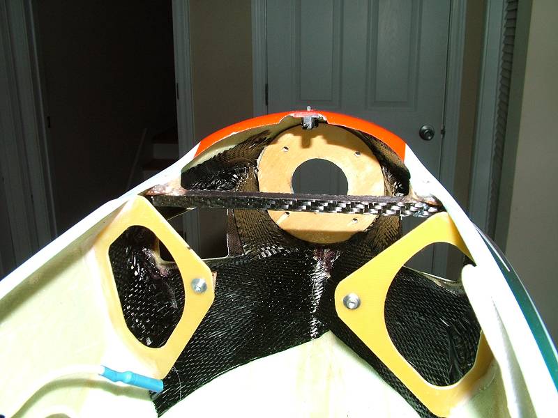

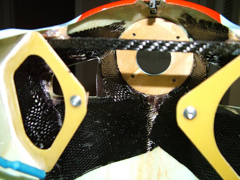

Thought I would post some pictures of what I did. I have bridged the canopy hold down area of the fuse so I can use a hatch latch. I want to be able to access batteries quickly in case needed. I have got the spinner gap even closer since picture taken. gap is less than 2mm.
Flying on recommended CG. .3 degree positive on wing. 0 stab. 1% pitch mix to right 2% to left. Goes up & down strait! All flying surfaces index perfectly. Very nice rudder action. Constructive comments welcome.

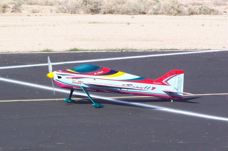

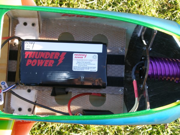

Dentdoc...I have not sent or made available any photos of my model other than the single "grab and grin" which is posted on my RCU profile due to the model being featured in an upcoming issue of FLY RC Magazine and know that they prefer to share the photos via the magazine first.
Having said that, I have the version with the "riveted" wings and my kit included an amount of carbon cloth which I "centered" on the stock epoxy glass motor mount formers and bonded with ZAP slow epoxy and the formers with the Loctite adhesive. I used a Budd mount and the supplied kit supplied rear mount enlarged to accept medium fuel tubing. I special ordered the 6-32 counter allen head screws from Fastenal (24 hours).
My friend Mike Moritko was nice enough to modify a Great Planes spinner by removing spokes and removing the tip for easy mounting (about 5/8"). It is light and simple but will probably not meet AMA saftey codes due to the shape... Beryll owners know that the thrust washer gap is very small (less than 3/16") so I doubt that any significant cooling is being provided. Having said that on a 70 degree Phoenix day the motor and batteries were 118 degrees F (replacing 3400 mah) after a P-07 sequence minimal additional flying.
I am using the TP 5300mah Pro-lite packs (C50 14XL comp and speed controller) mounted about 1/4" in front of the rear landing gear support. I mounted the RX and TP 910 2S either behind or under the stock rudder servo tray. I added a 3/16" x 1/8" lite ply support perpendicular and on edge to the rudder tray to reduce flexing as well...Brett Wickizer and I measured both of our CG's and are virtually identical although his batteries are 1 1/2 inches behind my set-up (Brett has original version). All Futaba electronics per the Matt's.
I have flown about 18 flights, (6) of which were at a contest, getting the cob webs off after not flying since the middle of September. The mixing is similar to Dentdoc's except I have yet to remove the last 1/32 of "up" trim and have 2%/0% of pitch mix. I expect the mix to increase when the elevator is feathered and expect an additional 1/2 turn of positive in the wing adjusters to execute.
16/18 flights were witht the APC 20 x 15 and the last (2) were with a new APC prop Chip Hyde gave me which is 20.5 x 14. I used it for round six of the contest and one additional P-07 before I went home...it seemed to require 2-4 clicks "less" throttle on stick (12Z) for cruise and P-07 sequence...I purchased a few more today by calling APC directly, sharing Chip's name and asking for "Annie". Chip suggested that it is both more powereful and requires less power to operate...(it is magic).
You can order the new "anhedral" stabs from Oxai-USA which may reduce the pitch mix to zero...$250 expect in 30 - 60 days. Yes, I ordered them. The new version uses the stabs in the current stab location...aero-dynamic wonderkind will explain why one generally changes the location to compensate for the anhedral...
