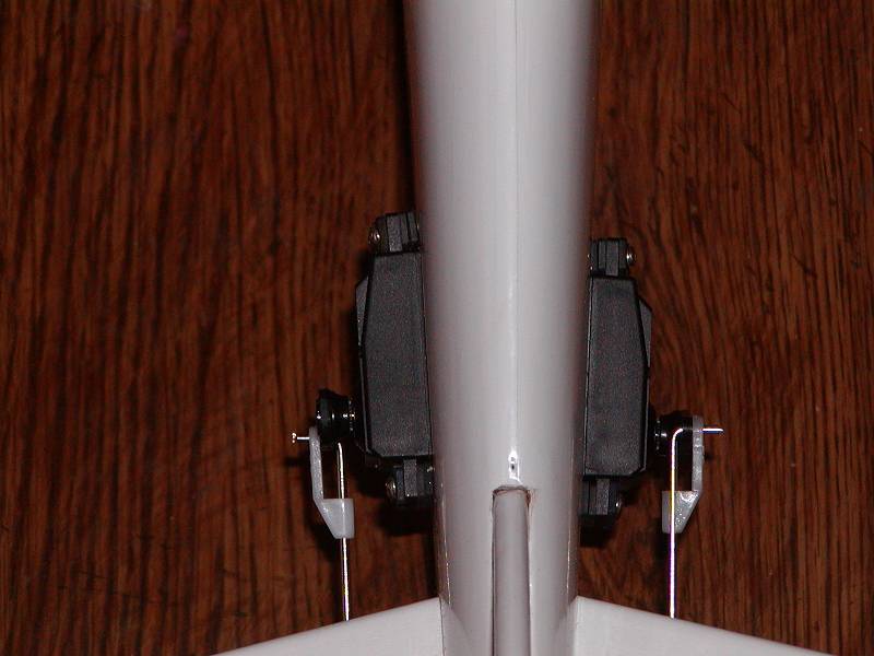

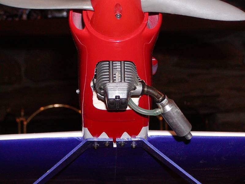

First post on RCU....
I have just installed an O.S. 48 4 stroke on my Diamant'e 25e now named 25e2"squared". It looks like it was meant for it. I installed an 8oz tank and updated with all futaba gear. The elevator halves were not straight from the factory so I seperated them and installed another servo in the tail. This allows me to set elevon mix. should roll like a drill bit. Not sure on the final weight yet. I expect it will be heavier though. I had to enlarge the servo openings to allow standard size servos. Already beefed up the gear due to a mishap on landing as an electric. here are a few photos...
airplanes are supposed to spit oil and make noise.....
