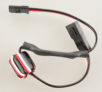

http://www2.towerhobbies.com/cgi-bin/WTI0001P?&I=LXLPP4
Installed on the esc/throttle line..

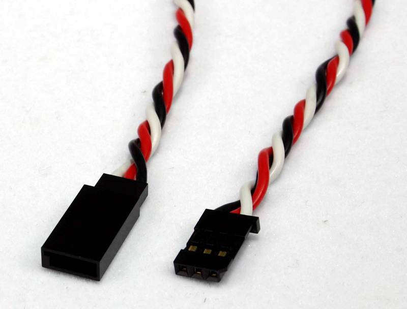

also twist the wires from motor to speed controller this will also help cut down on the EMI... I also run micro choke (single donut) about the size of a pencil eraser on the signal line from speed controller to rx. granted I'm flying a WCII 1024 and have never had radio problem.

The tisted throttle cable from the receiver is a good idea, and so is the choke, but there is one thing that is more important than either one of them.

Hello Dean Pappas, thank´s for help me, finally interferences is over, I change my ruder´s pull pull, put a choke receciver to esc, and my airplene is perfect 3 flight.
Thank´s every body for help me . Andres.
