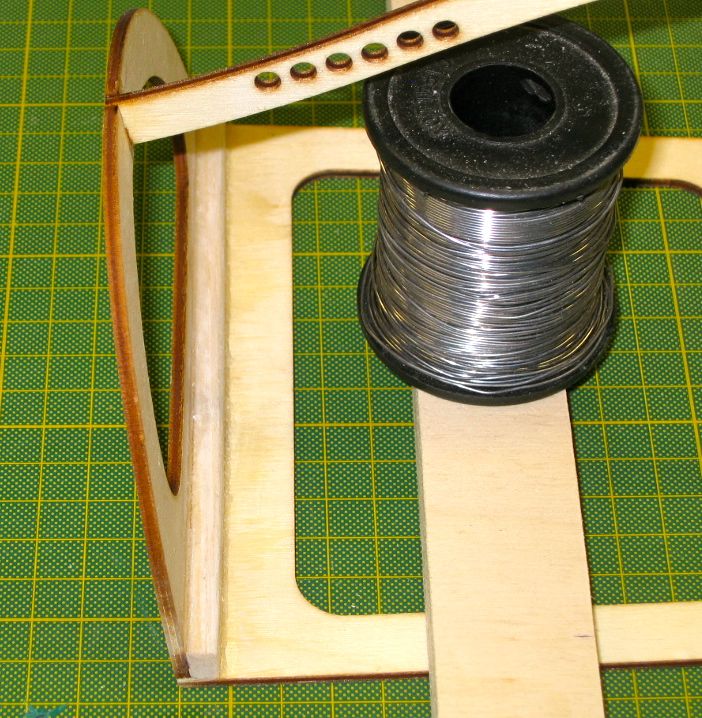

Here's the slot for the false rib on the wing.
It also shows my template which, as you can see, has gone though a number of revisions. Should look tidier once I've cut the holes in it.
I've also cut the hole for the wing tube on one wing panel. Looks good so far but I'll only know when I can line up the two panels. I used the same method as the stabs except with a longer/wider piece of wood and a 3/4" copper water pipe as a cutting tool. The outside diameter just happens to be a nice snug fit for the 7/8" tube.
I am working on the basis that the foam is just acting as a spacer and doesn't provide any real structural strength. Hence it is more important to make sure that the false rib and spars are glued to the sheeting than to the foam adjacent to them. Once sheeted and glassed the foam is more or less superfluous. Anybody that wishes to contradict me (or confirm) is free to do so before I get too much further.

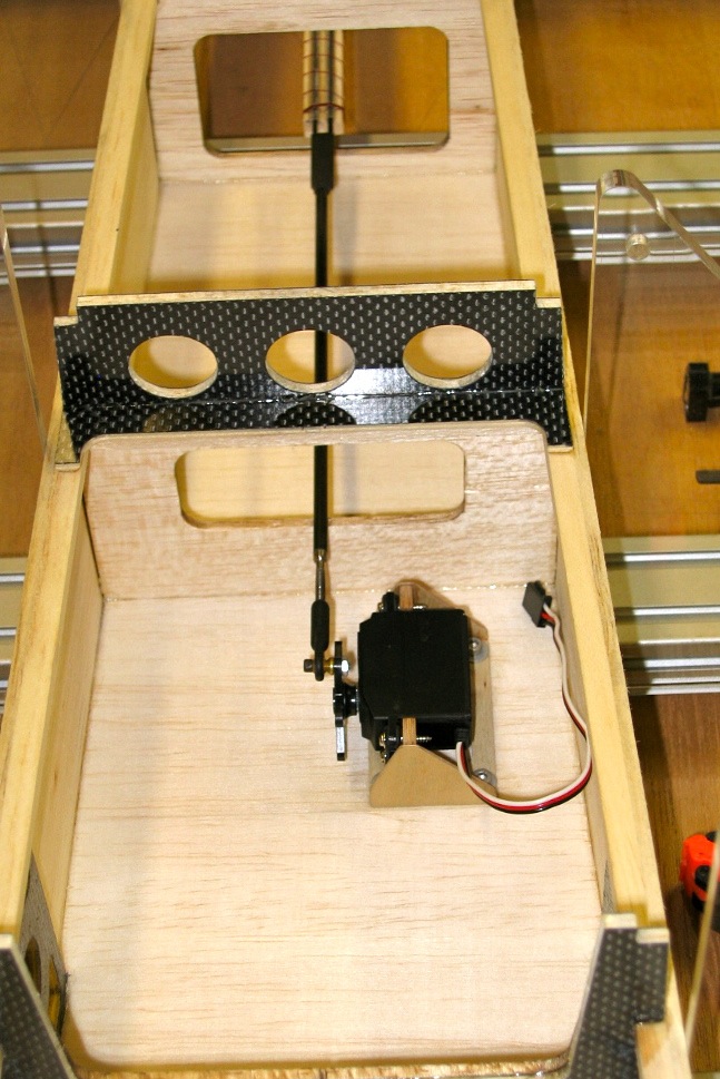

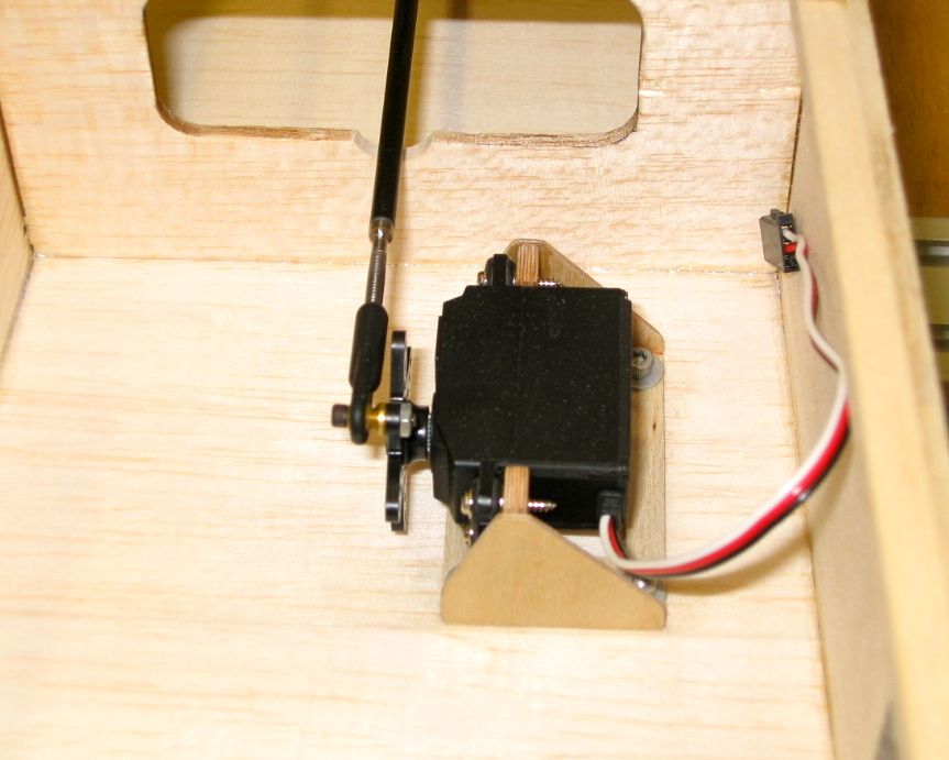

Well, I've started working on my Black Magic VF3E again.
Have located the elevator servo which took plenty of procrastination... Hopefully my pictures will help others?
DEPS is almost fully installed. Just need to add support bracing.
Only using a single S9650 on the elevators.
Cheers,
Jason.

I'd be apprehensive using a single S9650 to drive the elevators. The torque rating might be OK but the gears are a different matter, they are quite a bit smaller with finer teeth. It would be a shame to have the gears strip on you and all that work re-kit itself. Most guys I know using them are using one per elevator half.

I agree with Pete on the Elevator servo situation. On my BMVF3 I run a Airtronics Servo 94775, this servo has 151oz of torque at .13 sec. This is plenty fast enough for me and more than enough torque.

G'day Pete & Chris,
The 9650 will be fine for the elevator. Will be using them on each aileron too but have an S9151 for the rudder.
I understand your reservations with this servo but you need to take the glow hat off. On a glow set-up you're 100% right, the 9650 would be insufficient.
A friend has been using the 9650 on elevator and ailerons for quite some time without drama. This is on a Cyclone E and he flys the model hard in F3A. He's the current Australian Master.... He has recently switched to the BLS153 brushless servos which are the same size. Apparently they have a tighter gear train than the 9650 too and 7Kg of torque!

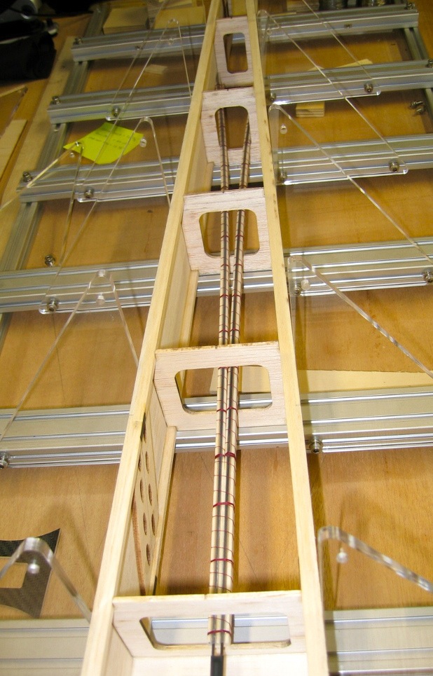

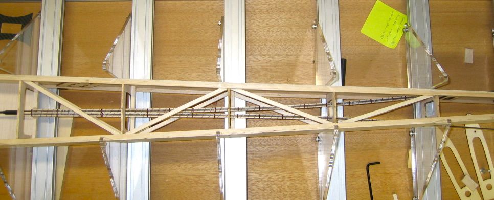

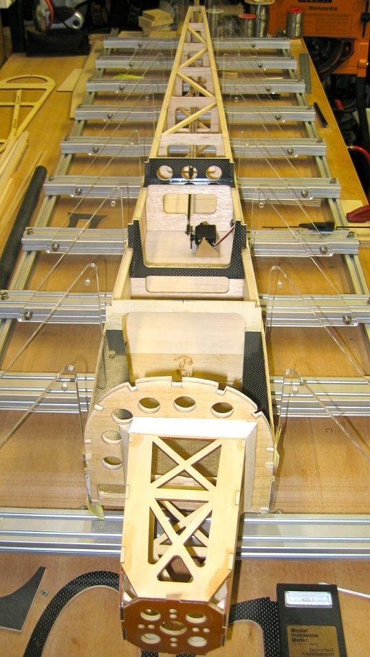

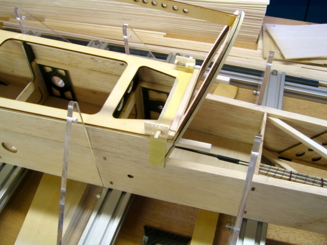

Ok Guy's,
Some more progress.
DEPS is now fully installed. Have fitted support bracing and CA'ed it all into place. Now here's the tip! The instructions specifically state to fit the DEPS before doing any cross bracing of the fuse.. This makes fitting the lower cross bracing real hard so I suggest fitting the lower cross bracing first, then the DEPS and finally, the upper cross bracing. I also made a small cutout in the former near the servo so the pushrod clears the former when actuated.
Have started on the upper stringers too. Looks like I'll have to make the cutout for the stringers in TDF too. This should be done when the part is routed IMHO.
Cheers,
Jason.
Some more progress.
Cheers,
Jason.

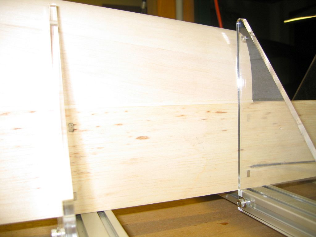

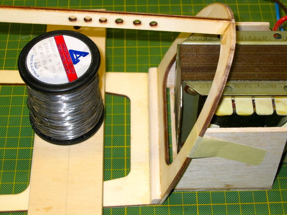

Hi Grant,
I seriously doubt my one will be in the air by Christmas...
I'm considering not honeycombing my wings stab and fin etc. Will see how the fuse weight comes out and make a decision then.
Attached are some more pics. Have built up the canopy frame. I made a small jig to set the rear part of the frame at 20 degrees as per the plan. Also added some balsa front and back to stiffen the frame up. Next will be to cut the turtle deck former to fit behind the canopy frame, fit carbon shell to canopy frame and trim then glue the former in front of the canopy. Doing things a little different from the instructions here as I believe it will result in a better canopy fit.
Cheers,
Jason.

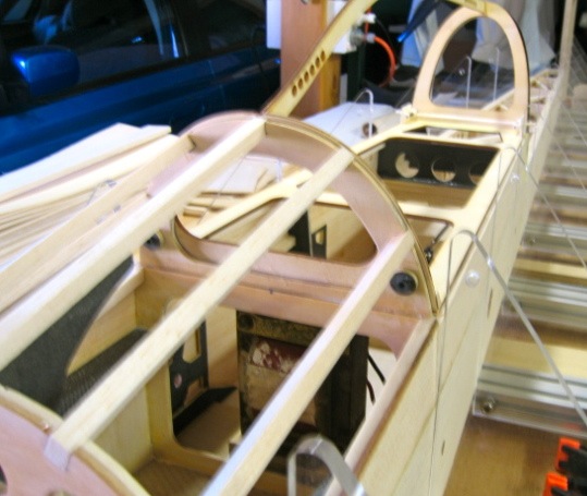

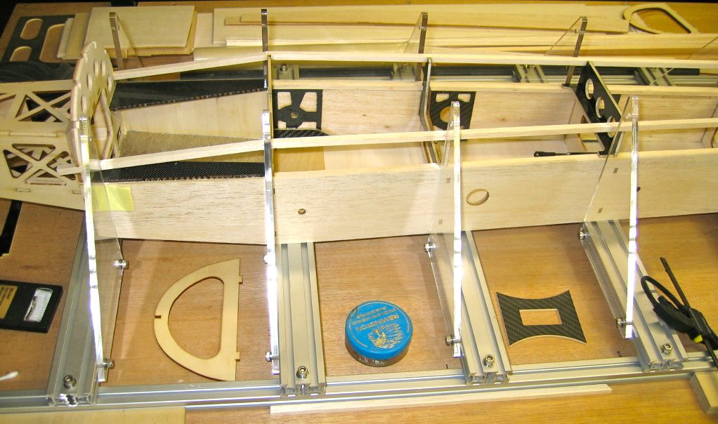

Hi Guys,
I have been a little slack of late but have done a little more to my Black Magic this weekend.
Have fitted the front stringers and fitted the canopy mounting pins and clips. I haven't glued the Turtle deck front ply yet but have pre drilled it for the canopy clips. Will fit the carbon canopy to the frame before gluing the Turtle deck front ply just in case things need adjustment. The canopy frame is flimsy by itself but will be rock solid once the canopy is glued to it.
The Turtle deck balsa has been sanded and cut to size. It curls up nicely once the dope has dried. Weighs in at 27 grams with dope. Dry fitted to core just to make sure all is good. Need to procure some more bagging material before gluing the balsa to foam.

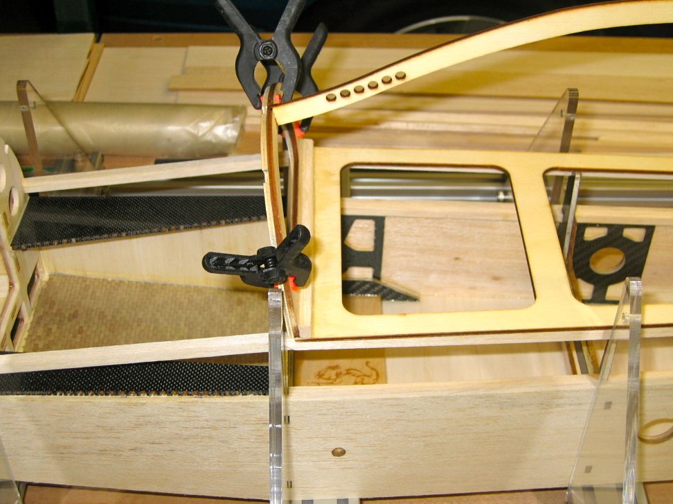

Time for a progress update....
The canopy is now fully fitted with two carbon tube dowels at the front. Once the turtle deck is cut to final shape the rear former will be glued into place. All is fitting real nice so far.
The sheeting has been glued to the front canopy area. This was done in strips as suggested by the instructions. Was a little time consuming bit the end result is pretty good.
The turtle deck skin has now been glued to the core with epoxy. I was going to use polyurethane glue but used epoxy instead as epoxy is tried and tested... Also had it on hand. You can see in the photo how much resin I wasted.. Only used 4 grams of epoxy.
The skin weighs 26 grams un-trimmed. The core weighed in at 100 grams but its yet to have the final hot wire cut. After vacuum bagging the whole assembly weighed 130 grams un-trimmed. That means I used 4 grams of resin to glue the skin. I'm happy with that. After trimming the assembly weighs 129 grams.
Next step is to make another two templates for the final hot wire cut. Plan to leave 1/4" of foam in the turtle deck.
