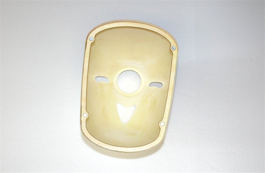

The Great Planes [link=http://www3.towerhobbies.com/cgi-bin/wti0001p?&I=LXWWM1&P=ML]Sequence F3A[/link] is an Almost-Ready-to-Fly 50" class E-Performance XLC Series Airplane. It features a balsa and plywood frame with a pre-built plywood motor box. The two-piece wings are connected with a carbon joiner. The ailerons are factory-hinged and the rudder uses a pull-pull system for control authority. The Sequence comes complete with wheels, canopy, wheel pants, pre-built motor box, decals and a 24-page instruction manual loaded with photos and detailed steps for a quick assembly.
Features:[ul][*] Balsa and plywood construction with prebuilt plywood motor box[*] Two piece wing with carbon wing joiner[*] Pull-pull rudder control system[*] Dual servo aileron control, factory hinged[*] Painted fiberglass cowl and wheel pants[*] Canopy magnetically attaches to fuselage[*] Covered in six colors of Top Flite MonoKote[*] Two piece painted fiberglass main landing gear with tailwheel wire[*] Foam wheels, main 2.25" (56mm), tailwheel .75" (19mm) diameter[*] Spinner: 2" (51mm) diameter, white in color (included)[*] Ready to fly in 4-6 hours
[/ul]Specifications:[ul][*] Wingspan: 50" (1270mm)[*] Wing Area: 505 sq in (32.6 sq dm)[*] Wing Loading: 16-17 oz/sq ft (49-52 g/sq dm)[*] Length: 51.5" (1310mm)[*] Weight: 3.5 - 3.75 lb (1590 - 1700 g)[*] Center of Gravity (CG): 4-7/8" (124mm) back from the leading edge of the wing measured at the fuselage
[/ul]
ID:	1271315   Click image for larger version
ID:	1271316   Click image for larger version

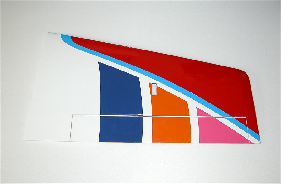

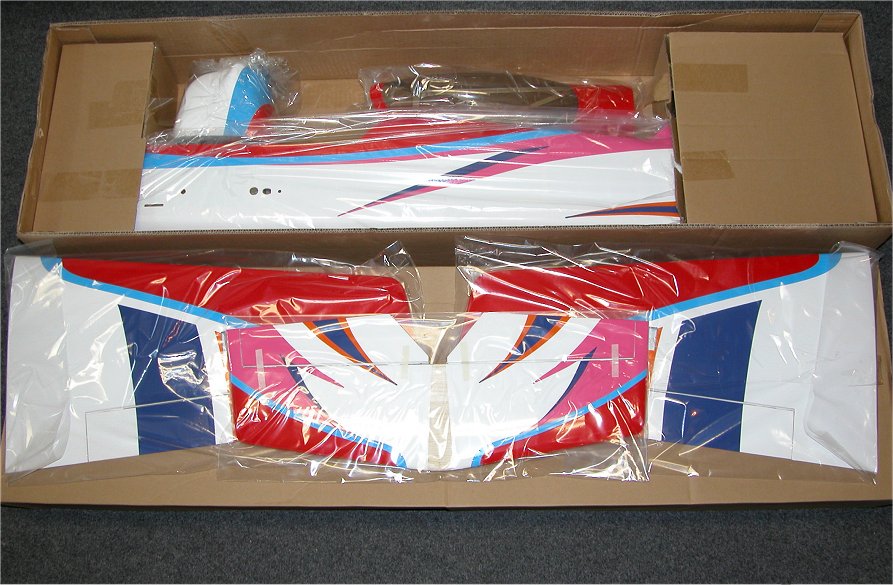

The parts come well protected in a custom box. Each section is individually wrapped in plastic but I removed some of the bags to get better photos. The covering looked perfect and both the cowl and canopy have pre-installed magnets for easy mounting.

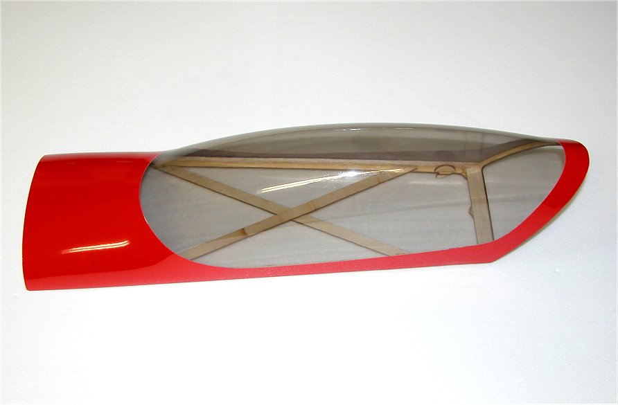

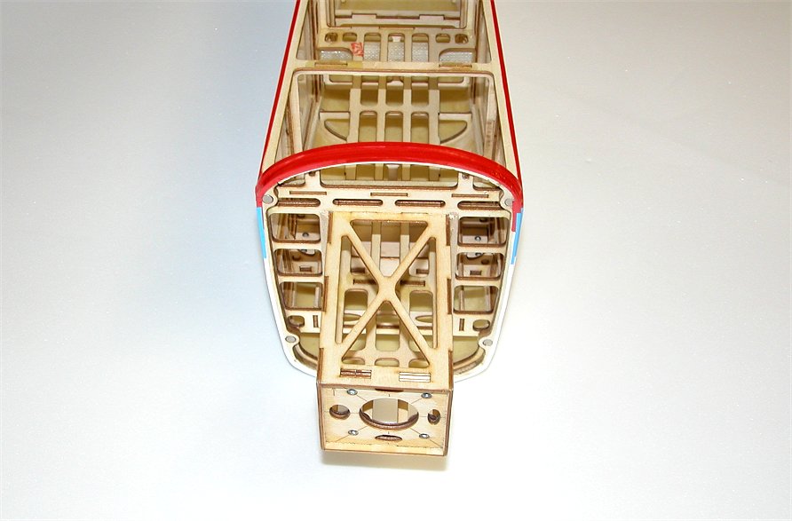

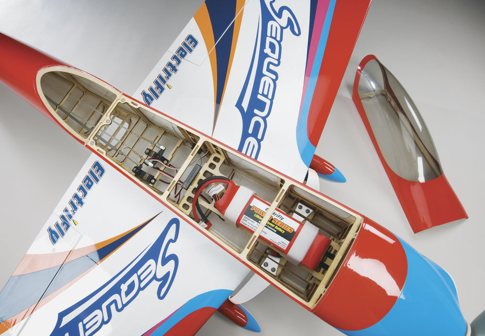

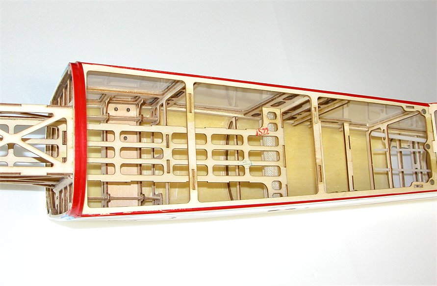

A closer look at the fuselage reveals the quality construction techniques that keep the Sequence light yet strong.

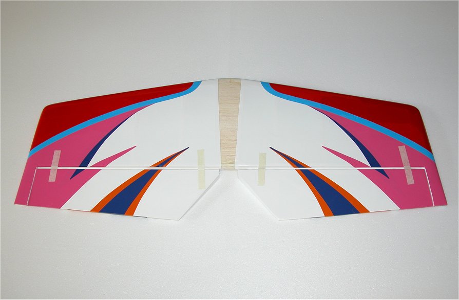

The horizontal stabilizer is glued in place with 30-minute epoxy after first installing the wings to check the alignment. The manual has good photos that detail the key alignment measurements needed. An elevator joiner wire is also installed with the stabilizer. The stabilizer covering comes pre-cut on the areas to be glued so there is no chance of weakening the surface with a razor knife.
After the glue dries on the stab, the elevators are glued to the joiner wire with epoxy and the three hinges on each elevator are secured with thin CA. I installed the elevators when gluing on the stab, as suggested in the manual, to help create a perfect alignment between the stab tips and elevators on each side.
