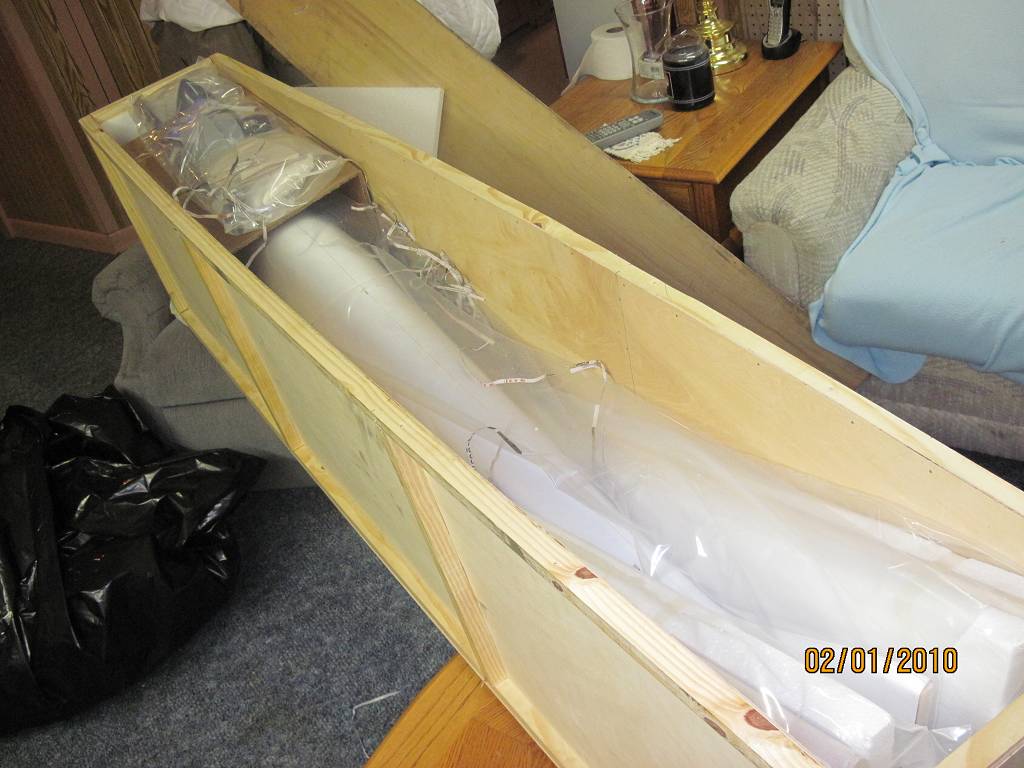

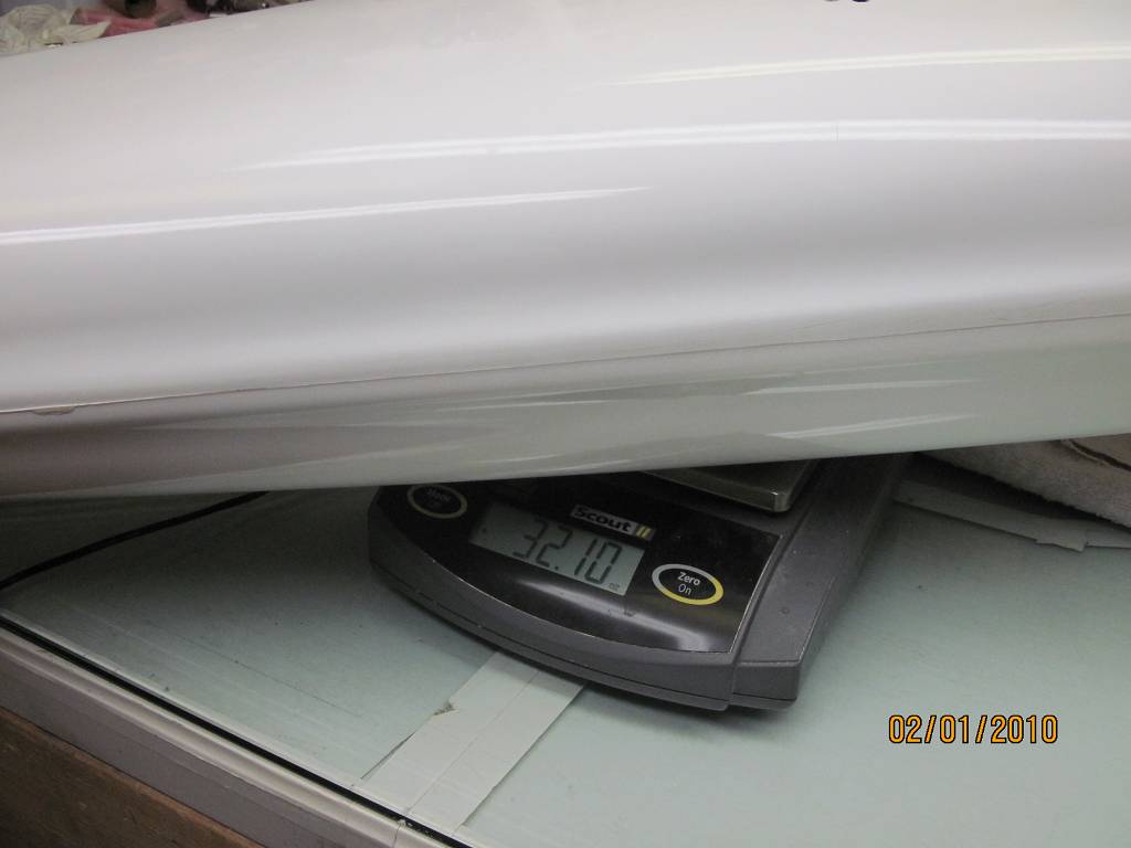

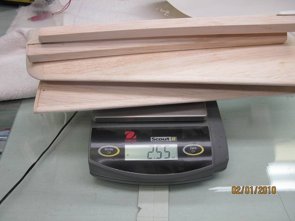

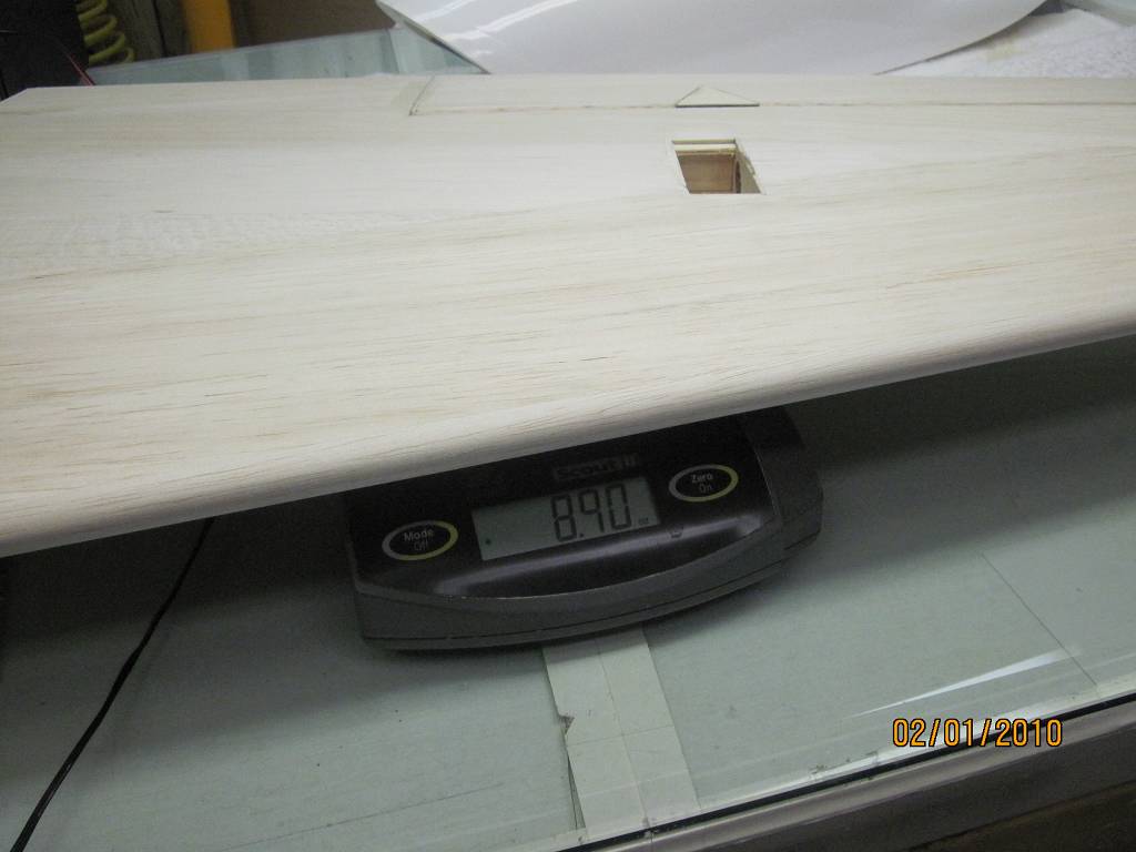

OK weights. I weighed everything I got and it's at 69.8 oz all up. I still have to paint and cover so a lot of opportunity to screw something up. When I look at my old data on my Sickle I get a huge smile. I made weight with that plane so this thing should be light as I want it to be. I would love to have it come out to 10lbs 15 ounces with the heaviest pack I have which is the Rhino 4900's at 46 ounces.
Here's a list
R wing 8.9 oz
L wing 8.65oz
Stab 4.65oz
UC 5.5oz
Tubes 2.65oz
Adjuster .6 all the wood parts 3 oz
Fuse with canopy and chin cowl 32.5 oz
control horns 1.4oz
rudder 1.15
wheel pants both .8oz
So as you can see light as all get out
The wings are not honeycombed but very light and nicely made.
The plane is very complete and mostly built.
