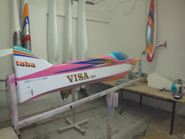

I cant believe someone would actually pass up on one of those airplanes, especially when it looks like that!!![X(] (my favorite color combo yet) It looks great Chip!! Im sure you will have no problem selling it.
