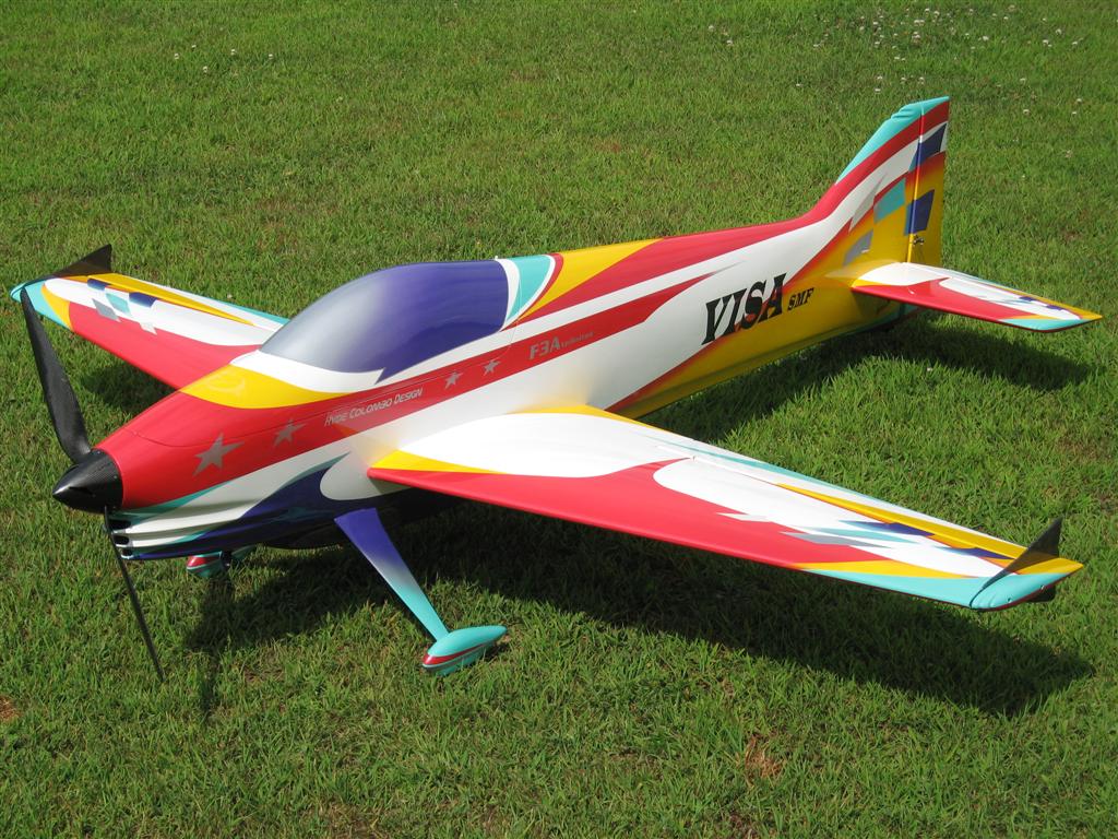

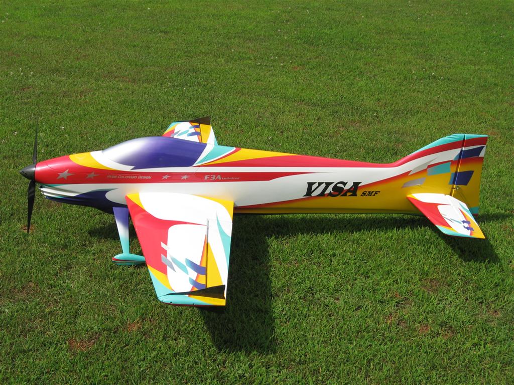

First flights today. Very, very nice flying plane for sure. I think I will have enough time to get it tweaked to my liking before Muncie.
I custom made the wing side force generators by tracing the kit ones onto 1/16balsa laminated between layers of cf cloth. Very stiff but about 1/4oz heavier each than the stock ones.
Weight 10lb 13oz
Plettenberg 30-10 EVO
Rasa 20.5-14 CF prop / Marquet outrunner CF spinner
YGE 90HV controller
Power Unlimited 20C-4900 packs
Spektrum AR9000 RX
JR 3421sa(2) elevators
JR 9411sa (2) ailerons
JR 8611 rudder
Jaccio Perfect Switch @ 6.0V
Power Unlimited 2S-800 mah RX battery

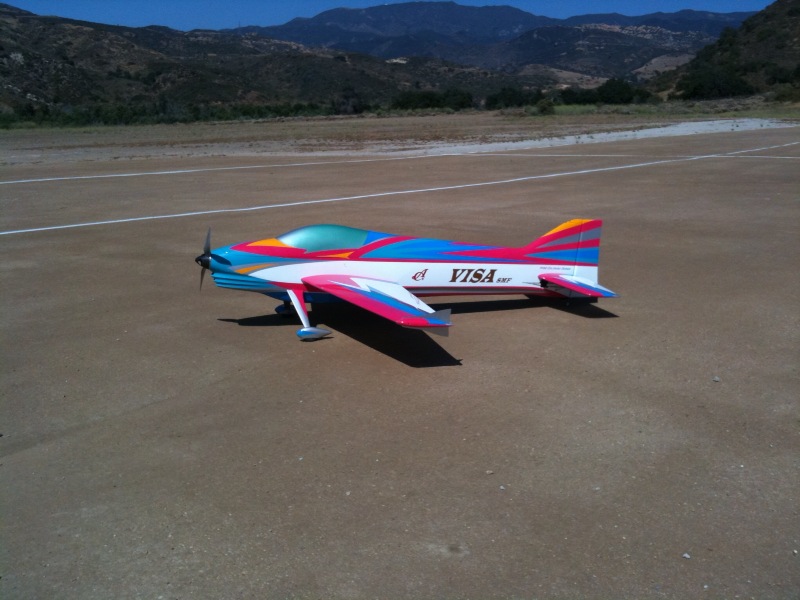

I thought I'd give an update on my progress. I finally had a great trimming session with mine and it is pretty dialed in now. There was no one at the field, I had the place to myself so I could take off, check uplines and downlines, land, adjust, try it again... It is really flying well now.
Yesterday I was getting frustrated because I was starting to chase my tail. Chip called me this morning and we went through my setup. I decided to push the reset button and rechecked/adjusted my incidence and I shut off all my mixes. I went out and flew it and it was tracking really straight up line. I cranked in just a hair more up incidence on the stabs and it was locked in. I turned on about 1% down elevator to low throttle mix and that took care of the downlines. It was a little windy this afternoon so I can't really tell how my knife edge mixing was doing, but I have zero mixing at this time.
Mine was initially nose heavy so I shoved the batts back and I turned them around so the wires are at the rear. Now my 4350s are about .5" beyond the end of the tray and the 5000's are about 1.75 beyond. My ESC is back by the batts now.
So, now I will continue practicing and getting tuned into it. But I am pretty happy with it just the way it is. I can't wait to get a calm air session so I can double check the knife edge mixing. I can't believe it takes zero mix, where it is set right now.
Here's yet another Visa pic for you. Beautiful flying day at my field.
