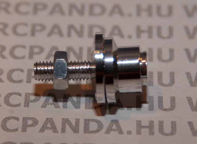

I had problems tightening the shaft on with Scorpion 4020 and Sebart Wind S 50. It is a different kind of shaft mounted on the motor shaft instead on the bell, like this:
I was unable to tighten the spinner and prop enough so that they don't move when I try to rotate them them one against eachother by hand. It's a Turingy light wood electric prop and it's surface is lacquered and very smooth. I tried sanding the center, putting sand paper bits in different ways, but it didn't help. It would always slip eiher between prop and the spinner or spinner and shaft back-plate.
After lots of trying I managed to strip of the threads from the shaft and the nut would slip when trying to tighten it.
I took the shaft and the nut to a guy with a lathe who managed to re-work the threads on the shaft and make a new, brass nut to fit to the new threads, and voila I was able to tighten it sufficiently using a fraction of the force which I was using before.
He said (and I'm no mechanical engineer so can't confirm that) that the problem was that the nut was made so that it was holding on just 3 threads on the shaft and further more, it seems that the threads on the shaft were not made per nut specs (or vice versa).
Basically, it seems that no matter how much force I used, I could never tighten it properly.
Another solution I found was to get Hyperion shafts (like the one in the pic) of the same design, which seem to tighten without a problem. They've got them in two shaft lengths which might be helpful.
Hope this helps...

I got the Hacker A50 back mount prop adapter today (3 packages so I have 2 spare). I had to use wet sandpaper (two pieces glued together for one friction plate). I use one such friction plate between prop adapter and spinner backplate and one between spinner backplate front and prop. I could not tighten the prop nut until both wet sandpaper plates was there.
Some picture of the wet sandpaper "trick" below.
So I was also able to maiden my S 50E today - 10 flights. It was little windy today but later in the afternoon the wind calmed down a little and I decided it was time to try this bird in the sky. I trimmed some up elevator before take off to be little on the safe side but I had to trim it back as expected once in the air. It flies fine but I have to adjust the throws some before I have everything to my taste. Easy to land. Take off and airborne after maybe 10 meter. I used the APC 17x10E prop and I think it worked fine. After first flight I downloaded the logged data in Castle link software and displayed it in Castle Data Log andno alarming values. At home after the 10 flights I examined the Logs more, at 100% output/full throttle in the air I got these max values with DesirePower V8 6S 35C LiPo with the Hacker A50-16S V2 motor and Phoenix ICE 100 ESC:
