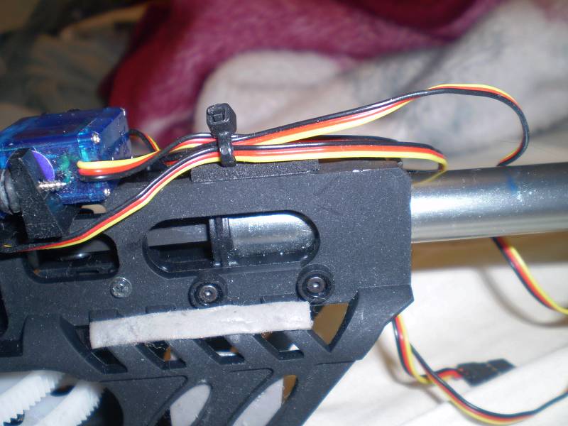

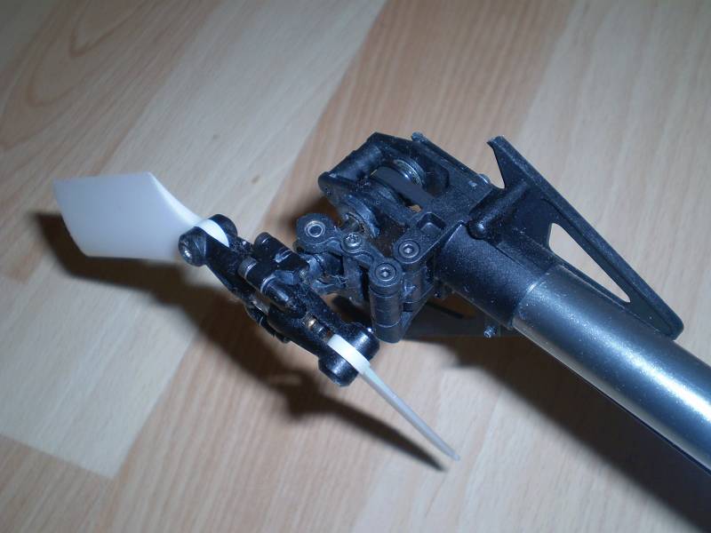

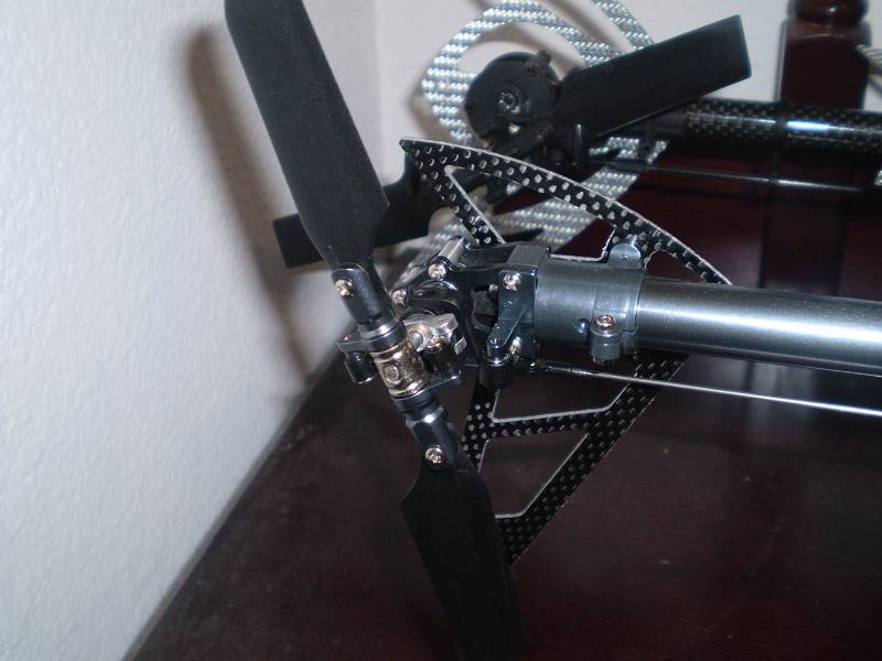

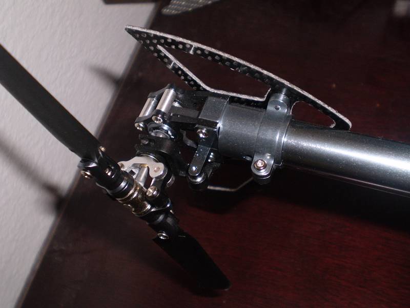

Old 01-20-2009 | 03:48 PM
  #554
Joined: Feb 2008
Posts: 2,543
From: orlando, FL
Default RE: Mini Titan thread
check out the pics. the tail is like the trex450 style. and also how it connects to the frame. the thunder tiger version the boom mounts on a bracket and the bracket slides into the frame. the exi pro is just like the trex450 style in which you slide the boom into the boom mount and secure it with screws. maintaince is the same.

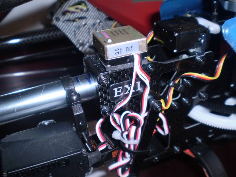

Old 02-08-2009 | 04:41 PM
  #568
bckyrdbshr's Avatar
My Feedback: (35)
Joined: Nov 2010
Posts: 1,055
From: Tuckerman, AR
Thought I'd post where I'm at in my build. I still like getting the ESC & servos. I got my blades balanced perfect but have a slight problem. It seems that one of the root ends are bigger than the other and when you put the blades on one is very tight to the point to where when you tighten the bolt you can see the blade grip bend. What would be a good set of blades to go with?? I'm also (I think) having a problem with the tail blades also. I'm not sure if they shoud be this way or not but when you look at the blades from behind they both curve towards the boom like they are warped?? anyone have this problem? You cant tell from the pics but I've replaced all the phillips head screws with hex head ones from hexcrews.com and I can tell you its worth the time cost $14.00 and that includes the shipping charge, decals, and extra screws. I think they fit and look much better the stock ones.

Old 02-08-2009 | 07:46 PM
  #570
bckyrdbshr's Avatar
My Feedback: (35)
Joined: Nov 2010
Posts: 1,055
From: Tuckerman, AR
ORIGINAL: johrich
3d wanna be,
In your picture, that looks like a Helimax HM4000 gyro, is it?
johrich
Yes that be the one... Hope it works half way right. I decided to give it a try as I read where a couple guys liked it. I also cut out the other adjustment pot they have covered up. From what I hear that pot makes it much easyer to set up the gyro as you can take the gyro out of the picture and adjust your rudder trim to get the servo centered and add the gyro back in and use the hidden pot on the gyro to recenter the servo where it should be after the gyro is added back in.
