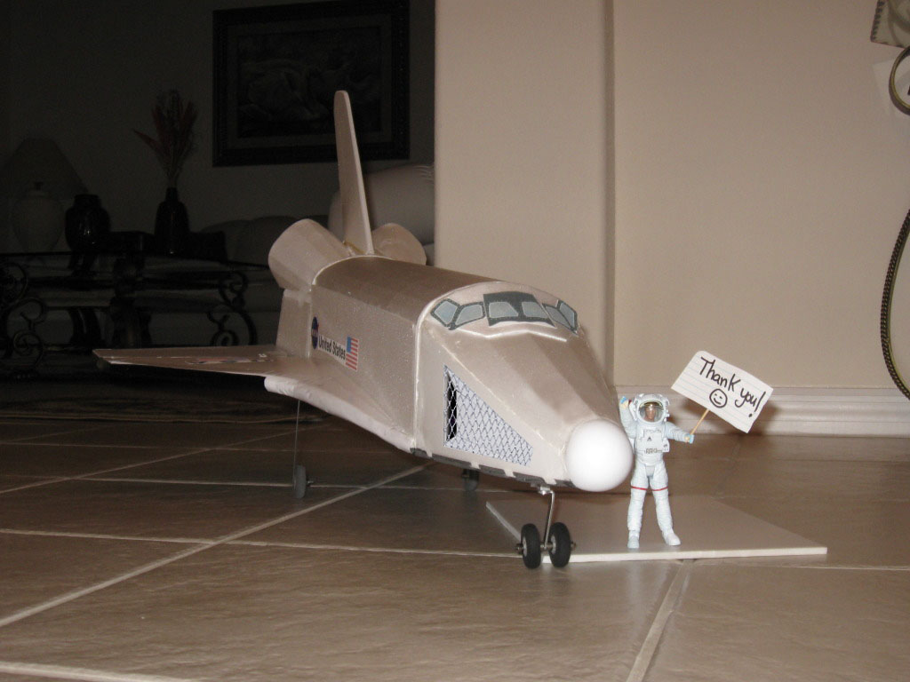

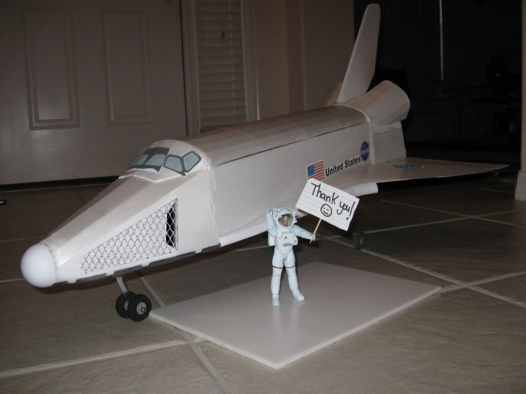

Anyway, I took off those Deflectors very carefully and now the Space Shuttle nose area looks as if no one ever installed any Ulgy Duck bill on top of it!

Wednesday night (09-29-2010), I completed the "DUCT" installation into the Space Shuttle's Payload Bay area primarily because I certainly received my new EM-Sport 2200mAH Li-POLY batteries from Esprit Model. They are have the best customer service and Shipping Department!
Here are a few pictures of the completed internals of the Space Shuttle! Notice the Dimension Engineering BEC on the Right Side of the FUSE.
Total weigh-in was 2lbs. and 1/4 oz.
Two pictures showing a comparison between the two different Batteries form factor (4-Cell and the (2) 2-Cell):
4-Cell, 2200mAH, Li-POLY
The Pair of 2-Cell, 2200mAH, EM-Sport, 25C, Li-POLYs:
