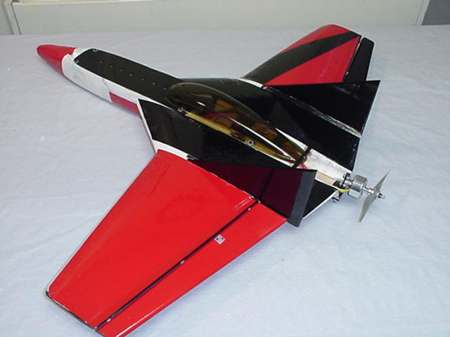

ORIGINAL: greggK
HOW ARE YOU GUYS BEEFING UP THE FINS WITH C/F? PIX
Hinges are made by Robart, and popularized by Chippedprop
Motor; MEGA 16-25-1.5 (3000kv)
ESC; ICE 100
Battery; 4s5000(45/90)
Receiver; AR7000
Servos; HiTec HS5065mg
Prop; Graupner 5.5x5.5
Pitch speed from static test; well over 175 mph
Maiden; DUE
I am thinking of painting it FJ Ultra grey, this way I can trick everyone into thinking its an ULTRA [:-]
#1146
Joined: Dec 2007
Posts: 207
From: grand junction,
CO
ORIGINAL: moparmyway
I just painted on a mix of epoxy and powder over the whole thing after installing 2 square tubes of CF .

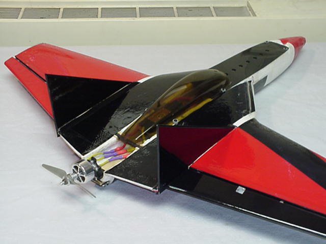

ORIGINAL: theb1bman
Nice I can't wait to see it go!!! I think I am going to build another CF funjet for those speeds I just don't know if the prototype is up for it. There's a few things I want to change and clean up on the molds and how I put it together
What are you altering ?
I dont believe my FJ pictured will be contending for max speed honors, more of a reliable fast flier.
Whats your best opposite direction pass average on the prototype ??
Only list the setup (motor, batt, prop, ESC) if you wish to.
What happened to the prototype ?
ORIGINAL: theb1bman
I will be fixing the mold where the rear canopy meets the fuse. The fuse is about a 1/6 to wide and after sanding to make the canopy fit it got really thin and then my buddy Stacy dropped it right on the prop and it cracked all the way down the edge of the tray not a big deal at 100mph but 180+ I don't know and theres a lot of money in esc and batt
I will also be making a jig for gluing the top and bottom half together and making the servo pockets deeper and the ailerons way smaller to cut back the chance of fluter.
The Nemesis fluttered so bad last weekend in a dive in 45mph wind it brook about 2" on both sides of the elevator and I blow up a aileron servo in the Sunracer doing the same thing and toughs control surface are 1/4 the size of the Funjets The air speed indicator reading was 250.5 mph in the dive that brook the elevator but I think I got it fixed to get a good doppler recording
