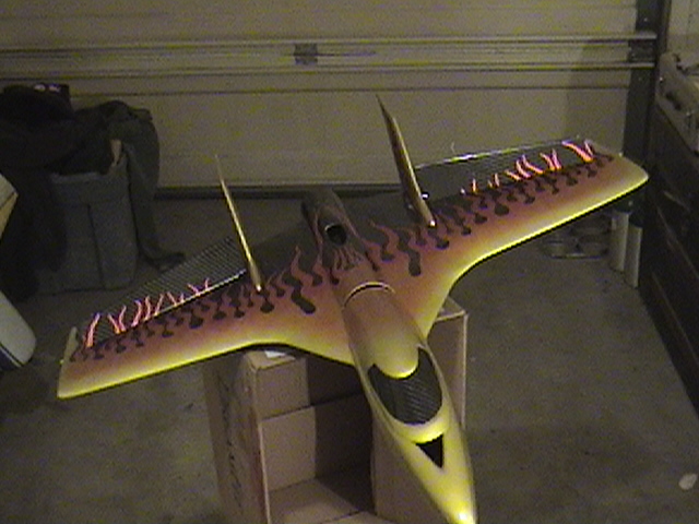

Funjet complete
Video .....if youtube will load it....... to follow Thursday
I did have it flown at Joe Nall on the electric flight line ....... which was not being used much as this event is mostly glow and gas....really big planes
It did generate about 8 people coming up and asking questions
Cp
Cp

I will get the FJ Ultra for sure...I just love puting LED strips from HobbyCitty and letting them rip all night long...

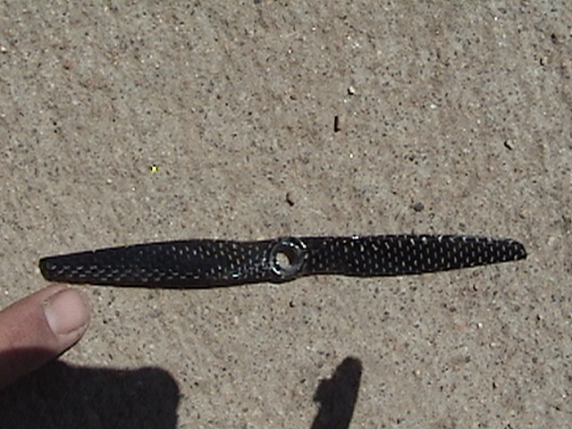

I have also been working on a Carbon fiber prop to handle more rpm wattflyer's 100mph club dopplered it 11mph faster down wind and 2mph faster up wind VS a APC prop
