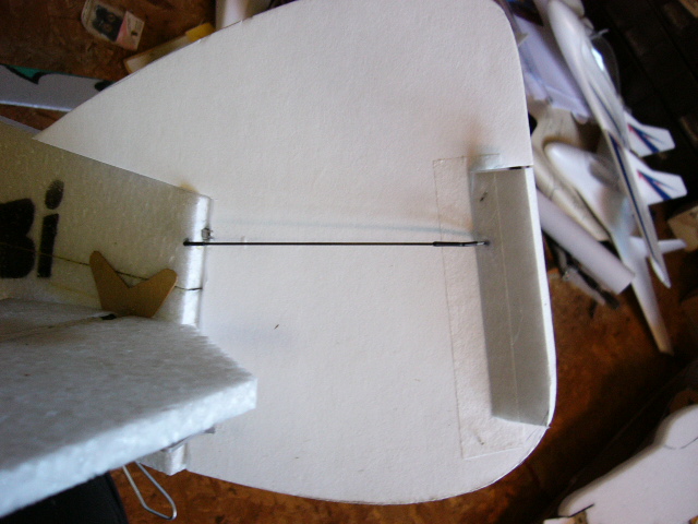

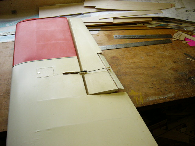

Old 12-20-2011 | 06:12 PM
Posts: 4,925
Received 5 Likes on 5 Posts
From: Kingston, ON, CANADA
Default RE: Let's talk about servos - Whatever is on your mind
I'm using this booster tab on the oversized rudder on my old Zoombi. Servo is a HXT500. Works very well taking the load off the servo.

Old 10-24-2012 | 03:28 AM
Posts: 4,925
I use booster tabs on a few planes. These are on a 1/4 scale Corby Starlett on the ails and rudder. The other is on a foamy Zoomby and a few othars with an oversized rudder. Both were tried with and without to see the difference. In all cases it was like putting an oversized servo in them with much more speed. I don't know why they aren't more prevalent in the bigger 3D planes where they're using two and three servos in the ails. Could save a lot of weight in servos and batts.
Gord.
ID:	1814414   Click image for larger version
ID:	1814415   Click image for larger version
