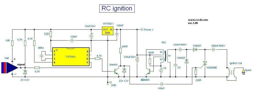

Hi Jake.
Will the selection between the two curves be accessed by a jumper on the timer board?
If so, I'll have to make changes to the board. Let us know which pins will be used. I can make minor adjustments to the etch pattern to accommodate the jumpers. Making it jumper selectable I think will be the best choice, going between chip pin inputs and a ground connection. Right now, since I use a socket for the chip, to test curve changes I remove the chip and replace with a changed, programmed pic chip. Not that hard, but time consuming. Jumpers would be the better choice.

I figure only the inflection points need to be stored. The actual value will then be calculated on the fly. Some of the calculation can also be precomputed if needed.
A big limitation of the 683 is that it can't write it's own memory. Otherwise we could compute the table and store it in flash. We'll just have to see how things go, it is possible I'm overestimating what is possible. I'll never know if I don't try.
Looks like you've got the timing maxed out already. I'll probably have to increase the osc to 8mhz just to cover the overhead of writing it in C.
I think it should be pretty easy to use a switch or jumper. I kind of like the idea of repeatedly switching back and forth between curves to see how the engine sounds, so maybe a momentary button would work well. You'd probably only need this for testing so just tacking on a switch as needed would probably work fine. With a momentary type setup you could also just ground a pin with a wire for a sec to switch back and forth.
What is the max RPM and max advance people want to achieve?
At 10,000 RPM, 30 deg. hall position, and 27 degrees advance there's only 50 instruction cycles available before firing when running at 4mhz. Even running at 8mhz that's only 100 instructions, and that's hardly anything to work with.

I'm working on a C version of your program. It was requested that I do a 683 version first. I'm still learning how to get around the hardware limitations of the chip.
Your code is very tight, so it will be hard to match it's performance in C.
I see there will be no time to do any calculation other than a table lookup for the curve. Still, there should be room for two tables in memory. EEPROM will just have to be for saving some other settings.

Sorry Com, I've been busy with school starting back up.
There's lots of ways we can use the timers and interrupts. We could poll the input pin or set it to an interrupt, you can use an overflow counter variable or try to scale the timer right.
I favor using the interrupts as much as possible so that processing can continue. We only have 1 MIPS to play with when running at 4mhz.
As soon as I have some working code I'll post it. If you have any C code please post it and I'll do a little debugging and simulating to see what's going on with it.
I can't wait to switch over to the 12F1840<font size="2">, which we can run at 32mhz for 8 MIPS of processing power, plus all the extra memory and peripherals. But doing this 683 version will make sure the code is tight.

I picked up a pickit2 type (Chinese clone) programmer from ebay. It supports the 1840.
http://www.piccircuit.com
I'm not sure what other programmers will work with the 1840, but the first thing I'll be working on is getting a bootloader running. Then you'll be able to program the chips with just a regular USB serial TTL adapter, which can be found for about $3 if you don't already have one. It should be a lot easier to tune things up when you can easily play with all the settings.
There's a bootloader called "ds30 Loader" that should work.
http://mrmackey.no-ip.org/elektronik/ds30loader/
I changed the settings around to run on the 1840 and it seems to compile fine, but I haven't tried it yet.
There should be no problems continuing to use the 683, but there's no way to do a bootloader since it can't self-write its own memory. There's also no serial UART so there's no way to communicate with it. The two chips are pin compatible, so there shouldn't be any changes needed in the timer board.
Nyemi's program does switch off the multi spark after a certain RPM. I think MSD is only really usable at lower RPMs since at higher RPMs your piston has moved a long ways before you can generate the extra sparks. There's also the current draw issue and how fast you can actually generate the sparks with from the HV side.
I assume he tested how fast you could generate the sparks and determined some sort of compromise. According to the simulator, the multi sparks are2.4ms apart. The assembly looks like it's running a 6uS loop for the multispark. This doesn't seem to make sense...
<div>10,000 RPM = 166.666 hz = 60,000 deg/sec = 60 deg/ms = 0.06 deg/uS</div><div>5,000 RPM = 83.333 hz = 30,000 deg/sec = 30 deg/ms = 0.03 deg/uS</div><div>2,500 RPM = 41.666 hz = 15,000 deg/sec = 15 deg/ms = 0.015 deg/uS
Somebody better check my math, or I need to quit using the simulator.
At 41.5 hz (just under 2500 RPM) the spark is delayed for 875uS, which should be 13.1 deg. That should be about 17 deg advance if the sensor is at 30 deg. This agrees with the excel ignition curve.
The next two sparks are 2.4 ms later. This would give a spark at 17deg BTDC, 19deg AFTER TDC, and 55deg after TDC.
So this might scale down to work well at idle RPMs, but at 2500 RPM I don't know that there's really any reason to send a spark at 19 deg after TDC. There's certainly no reason to send a spark at 55 deg after TDC.
We should have noticed from the video that even at lower RPMs the degree seperation between the sparks is pretty decent. Somebody please check my math and review the video to double check the angles. I don't know what RPM he's running at in the vid.
Hopefully some engine experts can jump in here also. What happens if you light your mix at 19 deg after TDC? Would this help in any way? The compression would be lower so the spark would have a better chance, but is there any real power generated?</div>

First of all, thanks for posting a lot of information here.
I am new to this hobby and I have been writing a timer code for CDI for a couple of months. I have studied scope data and codes found on RCU or the other site. So far, my very first version of code (POC
roof of concept) written in CCS-C works okay on a glow 4c-90 engine.
Jake, I have a question about triggering SCR gate. I am using the hardware that is similar to the schematic of RCexl, and the spark occurs when HV output's falling edge. (GP1 become high to low) But your code seems expecting the spark when GP1 set to High. How the turning-on of SCR works?
sGPIO.GP1 = 1; // Turn on HV output (GP1) bit in shadow
sGPIO.GP0 = 1; // Turn on LED/tach (GP0) bit in shadow
GPIO = sGPIO.ALL; // Update GPIO <- expecting spark here ?
__delay_us(Dwell_Time); // Load dwell time (uS)
sGPIO.ALL = 0; // Turn off all GPIO pins in shadow
Jay.

The code you posted is simply turning on the output to the SCR. It is triggered by an interrupt caused by the falling edge on GP2.
The hall sensor is normally at 5v. When the magnet passes it causes GP2 to go to 0V (low). So you could trigger on the rising edge if you want the interrupt to trigger just after the magnet passes. If you trigger on the falling edge, as I do in the code posted, you will enter the interrupt service routine when the magnet first triggers the sensor to go low. Either way will work fine, I just figure that triggering when the sensor first hits gives you a little more time.
The code section you posted is only called after the falling edge of GP2 triggers an interrupt which sets a timer. The code is called when the timer compare matches.
I probably didn' t explain that to well. Here is what happens...
1. GP2 interrupt is called when the magnet first triggers the hall sensor (falling edge since the logic voltage is reversed).
2. GP2ISR reads the timer value, which equals the time since the last sensor trigger (1 revolution). The ISR then looks up a value in the ignition advance table based on the revolution time and loads it into the compare module of the timer.
3. After the time expires the timer compare module triggers an interrupt, when the values match (the set time is reached).
4. This interrupt service routine (the code you posted) turns on the GP1 pin, which tied to the SCR. It then waits the dwell time and turns the pin back off.
That is the basic flow of the code. It is entirely interrupt driven. The sensor interrupt triggers and the delay time is set, when the delay time expires it triggers an interrupt where the pin is activated. And so on.
-Jake<br type="_moz" />

Jake,
thanks for explanation. Since I am C programmer on PIC for long time, I could read your program and understood.
The question is when actually the spark occurs. When GP1 is high or GP1 is low.
My test circuit fires spark when GP1's falling edge. So according to your program it means after dwell time (500usec).
Jay.

I tried to comment every line of code so that it could be easily worked on, but a general explanation will probably help understanding better.
The program is interrupt driven. The main function only initalizes the processor and turns on the interrupts. The actual main loop does nothing at all, it's just a while(1) loop with no instructions.
There are three interrupts. GP2 falling edge, Timer1 compare match, and Timer1 overflow.
-[Timer1 Overflow] Timer1 is a 16-bit timer that runs at 1 uS per tick. It overflows every 65ms if not reset by the GP2 interrupt. If it overflows we know that the sensor on GP2 has not triggered in 65ms. Each overflow we add 1 to the TMR1_Overflow counter. If the counter goes over 7 we know that the engine is turning at less than 120 RPM (2 RPS), and we declare the engine not running.
-[GP2 Interrupt] happens once every revolution when the sensor activates. We then store the value from Timer1. Then we take the value from Timer1 and use it to look up a delay value from the ignition advance table. Then we reset Timer1 and load the advance table value into the Timer1 compare register.
-[Timer1 Compare] this is called when the Timer1 value increases to the Timer1 compare value. We then know it is time for the spark, so we turn on GP1 (SCR trigger/output), wait for the specified dwell time, and turn GP1 off.
And that's it! Pretty simple huh? It took me many hours, and several false starts that turned out to be overly complicated dead ends, to distill that pure simplicity.
If you add the other features to that basic outline you'll understand all of the program. I didn't explain the MSD code, starting code, or calculation of the speed at RPMs below the table values, but that's all just extra trimmings.
The main thing to understand is that Timer1 ticks at 1uS and gives us the uS per revolution. The Timer1 value can be accessed as a 16-bit value or two 8-bit values. Because of this we can avoid all sorts of slow math that would bog down the processor.
Using the high value (top 8-bits) we automatically already have the uS per revolution / 256. So instead of using 360 degrees per revolution we just figure on 256 digi-degrees per revolution (1dd = 1.4 deg.). This also automatically gives us the uS per digi-degree! All of this is done by simply taking advantage of the way the timer is set up, no math at this point at all!
So now all we have to do is multiply the timer value by the number of degrees we want to wait before sparking and load it into the compare module. Multiplying is slow, so we use a table for the faster values, and only calculate the delay at lower RPMs where we have the time to do so.
Hopefully this all is clear enough. Feel free to ask questions. I wanted to explain the digi-degree thing before it caused too many problems. There's probably a proper term for them, but I don't know it.
1 revolution = 360 degrees = 256 digi-degrees
degrees * 360/256 = digi-degrees
digi-degrees * 256/360 = degrees
1 digi-degree ~= 1.4 degrees
1 degree ~= 0.7 digi-degrees<br type="_moz" />

lovefool... You actually caught a bug. GP1 should be switched off to trigger the spark.
I've fixed this in v0.9b3...
The only thing changed is the GP1 polarity bug.
Thanks for catching that lovefool! I'll put you in the credits in the next release.
