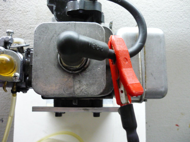

ORIGINAL: gr8flyer55
Rob,
What sparkplug size does your Aprilia use? 5/8 hex or 3/4 hex? I'm building another ignition for you to try..finished the whole ignition for your homelite engine complete with plug wire and a case..just like I sell. If you'd rather I left the sparkplug cap and boot off, I can do that also, but tell me the wire length you'll need..
Rob,
For the Aprilia I need a hour to see how long the lead must be.
The ignition and candle are behinde the airfilter and other bodywork.
It's a crime to replace the candle, you can't doit if you are on the runway.
I think / hope 10 or 15" will be enough, otherwise I replace the ignition.
For the Homy I think I have enough of normal lenght.
The flashlight.
The flashlight wil be triggert at the same time the SCR is triggert.
But why want you change it, the LED do the job very well (I think ?)
If you want a "tool" for it, put a LED into a (alu) tube, and you have a real strobe.
........or have you make a board change on the pin output of the flashlight ?

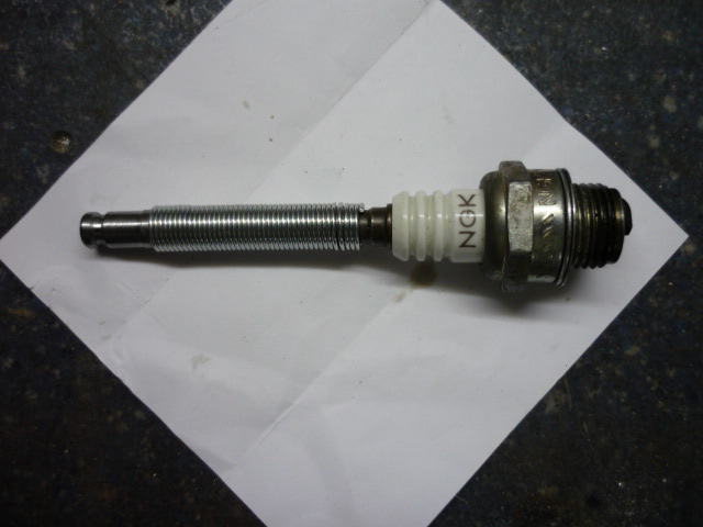

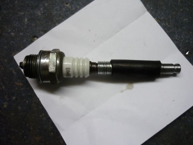

#486
Joined: Jul 2010
Posts: 404
From: Alkmaar, NETHERLANDS

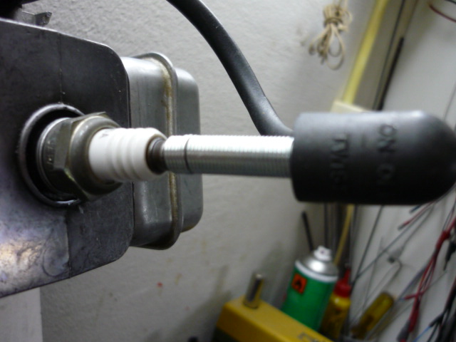

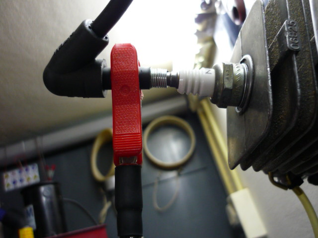

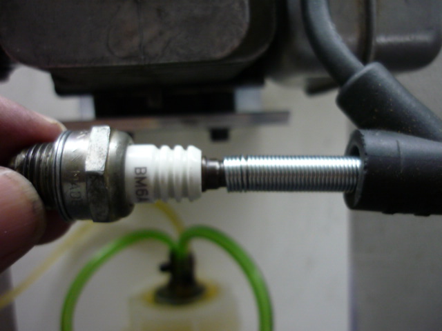

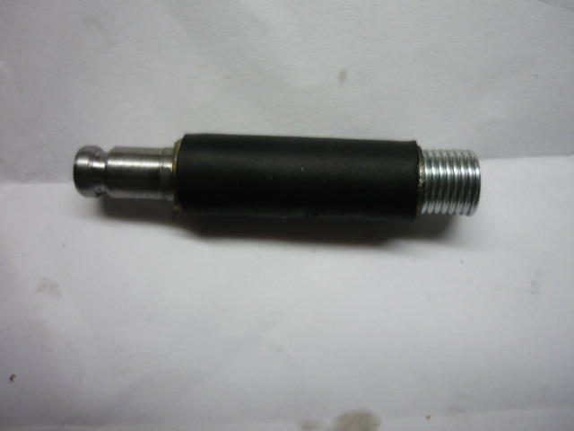

Rob, I too have experimented with different ways to connect it for a good strong positive signal. This is what I am trying to figure out. We need an interface connection to directly plug in for the signal, full strength to make it bright and reliable. A cheap led flashlight is a good light source which I have tried and it works perfectly.
I have many ways to do what need but involve complicated hookups. We just need a simple, easy to use, foolproof, system that anyone can have success with. A users tool, not an experimenters nightmare.
We could make it an accessory item. That is the add-on approach which will work.
One more item we need is the direct rpm readout to accurately check rpm with respect to timing. I have my own way of doing this with an optical tach pointed at the prop. Also had worked by pointing it at the timer's led and reading it, multiplying the reading by 2 (my tach is set for a 2 blade prop- 2 interuptions per revolution). This would be fine except now with the led on the board being so dim, doesn't work at all. Maybe using the RCExl inline tach is the solution there too. Just a thought.
Put a simple spring between the candle and sparkcap, and isolate the !!!!! metal from crocodilclip !!!!! you can pickup the spark for 100%
Some old strobelights use this kind of pickup the spark.
http://www.electronics.gompy.net/strobelight/index.htm

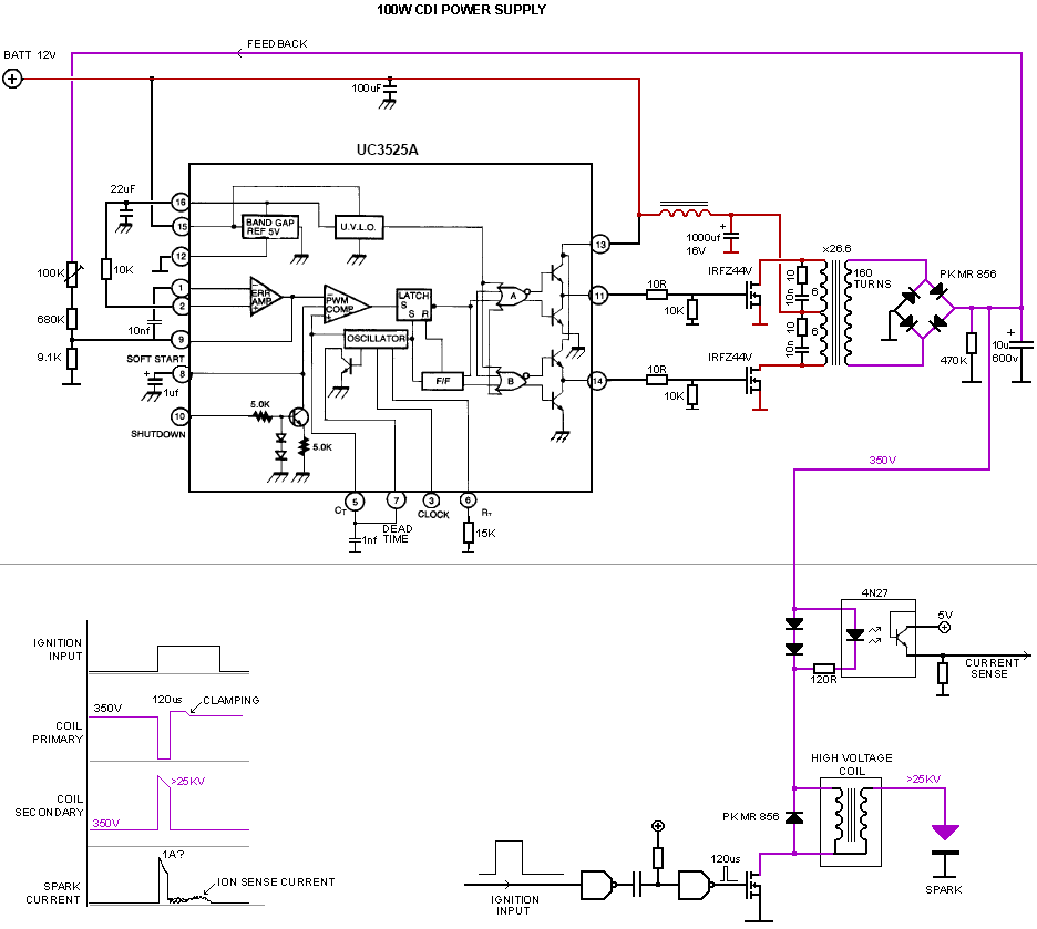

ORIGINAL: nyemi
<span lang=''en'' id=''result_box''><span class=''hps''>Hi,</span> <span class=''hps''>everyone</span>
<span class=''hps''>Sorry</span><span>, but</span> <span class=''hps alt-edited''>work</span> <span class=''hps''>does not leave</span> <span class=''hps''>me time</span><span>.</span>
<span class=''hps''>Specifically</span> <span class=''hps''>I'm sorry</span> <span class=''hps''>you:</span> <span class=''hps''>Gompy</span>
<span class=''hps''>Printer</span> <span class=''hps''>circuit board is</span> <span class=''hps''>still experimental</span><span>:<span lang=''en'' id=''result_box''><span>http://docs.google.com/file/d/0BxQHq...RWbXdHUDQ/edit</span></span></span></span><span lang=''en'' id=''result_box''>
<span class=''hps''>I use</span> <span class=''hps''>Sprint</span> <span class=''hps''>Layout</span> <span class=''hps''>5.0</span>
I got allready the layout, but I'm missing the componentnames / types on the layout.
There are also more components on the layout the schematic will show.
The schematic is not complete or on the PCB there are to much components.
I hope you have some time to complete the schematic or PCB for me.

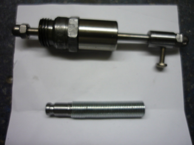

Engine makes 4514 rpm with a 20x8 prop, I don't have (can get) a 16x8 prop at the moment.
I can't start the engine by hand, I need a startrope.
BTW, the tool on the picture is a TDC-tool and also a compression checker.
If you turn the prop / shaft, the pin wil be in and out if the comprssion is OK.
If you turn the prop / shaft you can also see and mark with the ring the TDC.
If the pistion goes up and down, you can read the distance and calculated back to degrees.
Nice to use if you don't want or can't use a degree disk.
The distance between TDC and UDC of my Homy is 28.41 mm
1 degree will be 28.41 / 360 = 0.07892 mm
If the ignition must be 30 degrees BTDC, the calculation wil be 0.07892 x 30 = 2.36 mm BTDC
With a caliper it's easy to do.

Thats the first thing I want to know, how much current consum the CDI.
For my bike it isn't a problem, the generator will load the batteries.
Batteries into a plane don't have a generator for backup, empty is empty.
If the tank is full but the batteries are empty, we missing some point.
But befor I'll rebuild something else I want to know the specs from the board John haven make.
I think to build for test the schematic below, all factories are usuing this kind of schematics.
For John, is this the flashlight / strobe you are loooking for ?
BTW, If you want to use it, Jake have to change the program to get a extra LED-input to send a puls to the LED output.
Changing the C into this schematic will also change the lenght of the puls.
