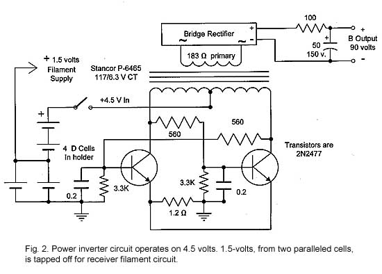

Modify Johns transformer for the new HV-board.
Remove the 10 winds of the flyback and split the 20 winds primary into two peaces of 10 winds.
The hole transformer is 15x15mm, it's work for a Swiss watchmaker

Rob, that looks promising!
If we are splitting the 20 winds into 2 winds of 10, is this for a FET push - pull oscillator circuit? That would seem a logical choice for how you made the transformer. It should be a powerful hv circuit.
John

With a transformer wind 1:10 and 4V8 I get 88 Volt to load the capacitor.
Theoretical it must be 96 Volt (2x 48 Volt), so the designe is ~90% effective, not bad
You transformer is with the modification wind 1:40, so the output Voltage will be (4x 96) x 90% Volt = 345 Volt
With load the Volatge can be a littlebit lower but I think still enough.

<span lang="en" id="result_box"><span class="hps">Congratulations</span> <span class="hps">Gompy</span><span>.</span>
<span class="hps">I have always</span> <span class="hps">said</span> <span class="hps">that the</span> <span class="hps">push - pull</span> <span class="hps">oscillator</span> <span class="hps">circuit is</span> <span class="hps">a good solution</span><span>.</span> <span class="hps">The efficiency</span> <span class="hps">of over 90%</span><span>.</span>
<span class="hps">Here</span> <span class="hps">the transformer</span> <span class="hps">drive</span> <span class="hps">circuit is</span> <span class="hps">simple</span><span>.(</span></span><span lang="en" id="result_box"><span><span lang="en" id="result_box" class="short_text"><span class="hps">See</span> <span class="hps">circuit</span> <span class="hps">diagrams</span><span>)</span></span></span>
<span class="hps">Not</span> <span class="hps">used</span> <span class="hps">Choke</span> <span class="hps">coil.
</span></span><span lang="en" id="result_box"><span class="hps">Easy to</span> <span class="hps">zoom out</span><span>.
Link:www.energeticforum.com/renewable-energy/10936-flip-flop-inverter-using-low-voltage-input.html</span>
<span class="hps">I</span> <span class="hps">ask</span><span>.</span>
<span class="hps">Use</span> <span class="hps">air gap</span> <span class="hps">in the transformer</span><span>?</span></span>

Other reason will be the GS-Voltage, with 5 Volt the Gate push the DS all open.
Because they want to use a low Voltage batterie pack a FET is also the perfect component.
For use with a 12 Volt accu it's no problem, but 4V8 is a problem.
Thats also why I want to use a 2S lipo pack, a littlbit more Voltage to play with.

I was thinking about a controled pulsdriver who I can switch on / off.
The PIC is also possible, low rpm - less pulses and high rpm more pulses.
This will also means less components and controled current by use.
But first I have to test more with transformers and the schematic I use.
I know the FETs are working and the schematic isn't critical in components.

The schematic is not secret, it's a normal push pull schematic you show.
It's even based on your ZVS schematic but with differend component to use iot with 4V8.
Now I try to find the "ready to use" hardware any one can make or buy.
Winding a transformer is not everbody can or will do.
And I don't want people gone build some not good working hardware.
