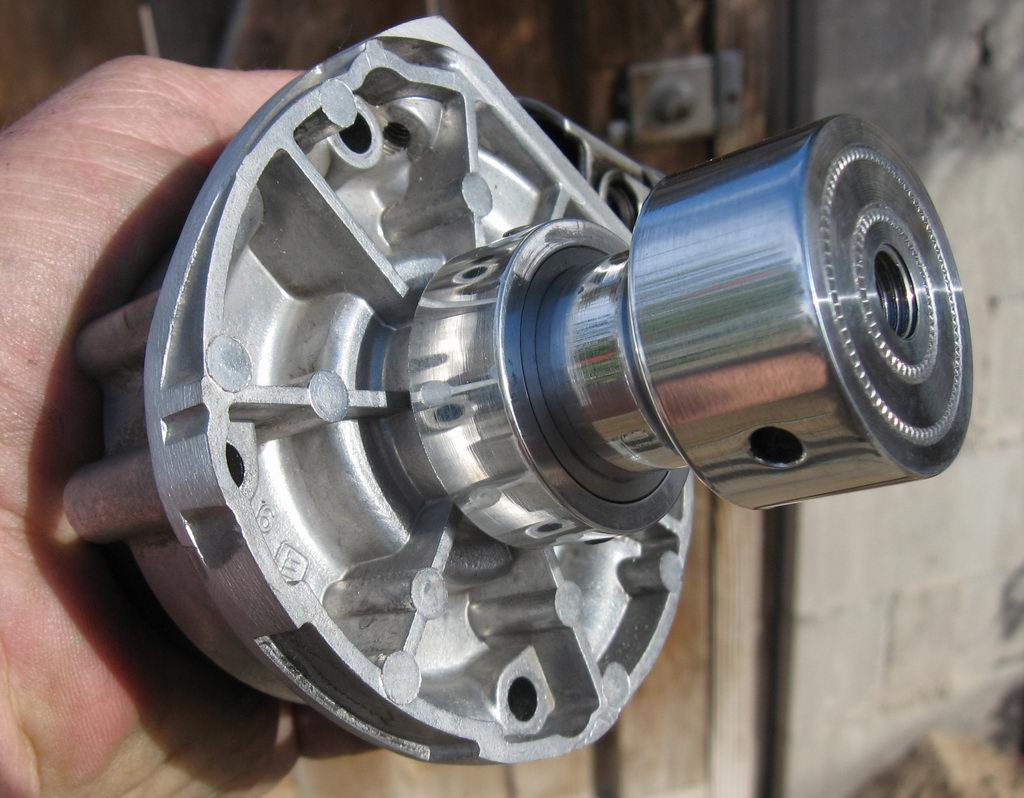

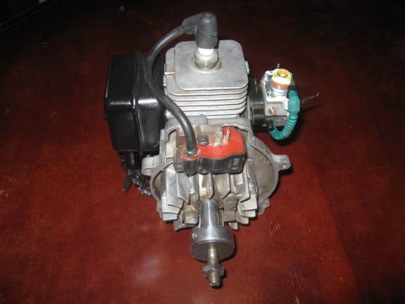

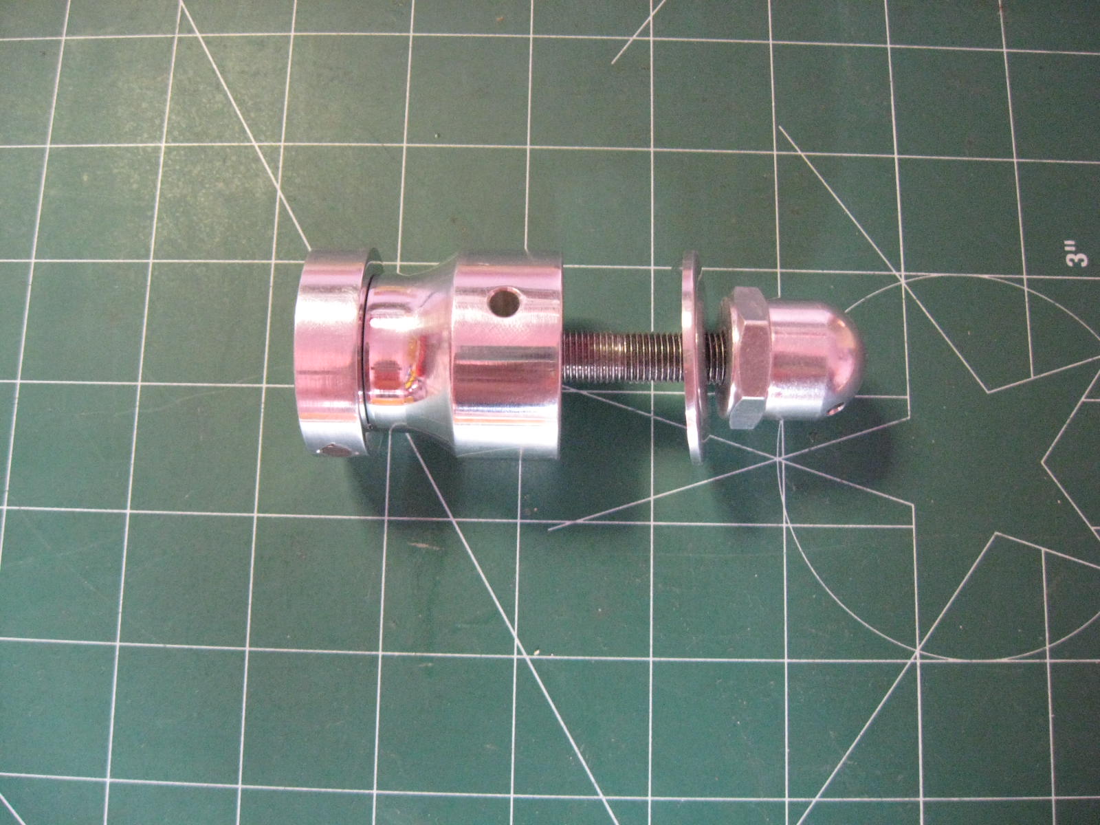

No, normally they thread onto the crankshaft, then have a stud coming out that you mount the prop to with a nut. As I mentioned, yours is the long shaft engine, so you either need the long shaft prop hub, or you need to shorten the shaft, re-thread it, then you can use a short shaft prop hub.
Here's a couple of pics of prop hubs. One is on an Echo 58cc that I converted to CDI ignition, so it is made for use without the magneto flywheel. The other one is on a Homelite 30cc with a magneto. (Short shaft)
AV8TOR

Do you think if I show the people at the mechine shop some photos of the adapter and take them my engine they could make something for me? Also I imagine that to re thread a shaft and to make the adapter you use a lathe and a welder.
-sam

You don't need a welder, but you do need a die to re-thread the shaft, and a lathe to make the prop adapter. $40.00 is probably about as cheap as you're going to find one actually. Did you contact Ken at www.lambertsrc.com?

I didnt contact him but I will try tomorrow. Should I get the crank shaft cut and re threaded or should I just buy a long shaft adapter. I know that the longer the shaft the more vibrations but how bad would it be. Also I am going to try to take apart the muffler and modify it tomorrow but how much of a loss of performance is there if I leave the muffler stock.

I always cut the shaft and use a short shaft prop adapter. I feel they are more secure.
The stock muffler robs a LOT of power. You need to gut it.

No, those will not work at all. You need a proper prop hub. Remember, safety?
Yes, get the muffler clamped in a vise and use a flat head screwdriver to start that crimp coming undone. The hardest part is getting it started. Once you start raising the crimp, it is easy to work your way around a little at a time and get it bent up enough to get the muffler apart.
AV8TOR

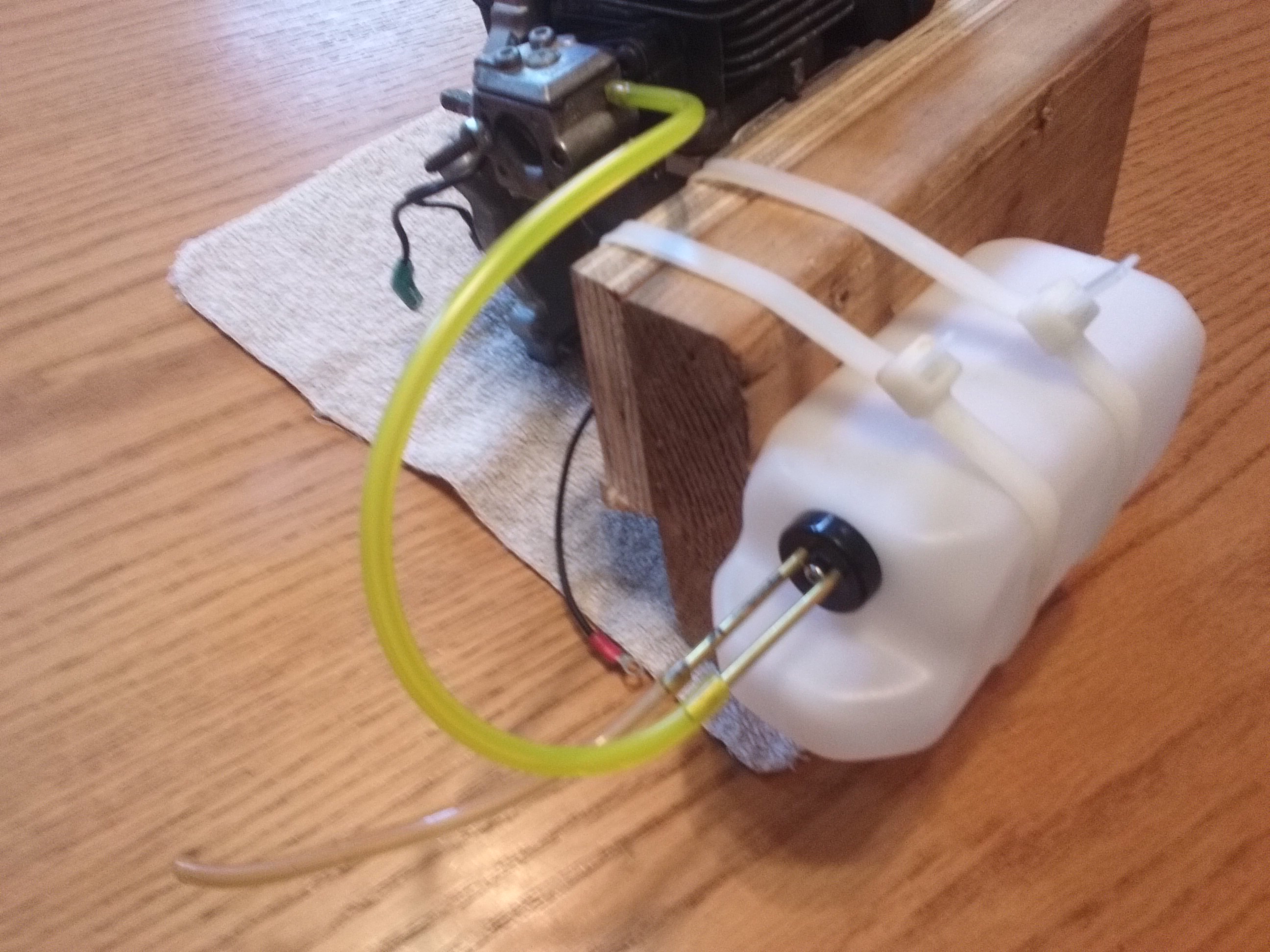

Called JAG engines and Dale(the guy who owns JAG engines) picked up. So I asked if the short shaft adapter would work and he said that it would since both the ryobi 31cc and the homelite 30cc have 5/16 shafts and have the same thread. So I went ahead and ordered the adapter, the prop washer, and the prop bolt. All for $31 shipped. He said that he wouldn't be able to make it until Monday after work and he would ship it Tuesday. So hopeful I'll have the adapter by Saturday the 18th.
I got the 16oz fuel tank that I am going to use in the plane built and connected it to the motor so now I just have to get the shaft cut and re threaded. I(well not me some one else is going to cut it)was going to cut to 3/4 of an inch based on the photo of the prop adapter. I might do the cutting and drilling on the muffler today and am thinking of two 1/2" holes for the outlet tubes. For the tubes I was going to use this this.
-Sam
